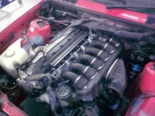

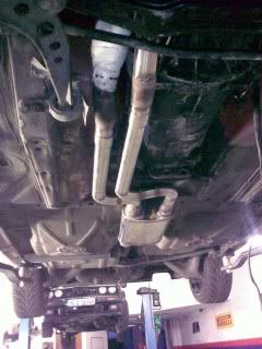

Its nearly there now, The Engine is in and the Exhaust is finished, I hope it wont be too loud there is a good big magnaflow box in the middle , and two other sets of UUC boxes but they are all straight through:D.
got a good bit done today , got the two speed fan hooked up and side lights sorted out ( loom starting to show its age ) and fog lights wired up as bmw intended . The cooling system plumbing is finished , Fuel lines plumbed up .
Unloader relay modification done , new feed to fuse box done , senders for oil temp and pressure fitted and wired ( more of a pain in the arse than you would imagine but the oil filter housing is m12 female thread and the gauges senders are 1/8 bspp male thread and with the plenum there is not a whole pile of room)
the c101 plug is removed ready for the conversion over to x20 , so we sould have noise over the next couple of days . Should be seeing road in the next couple of days :cool:

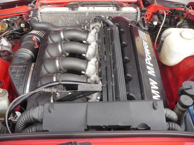

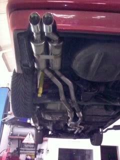

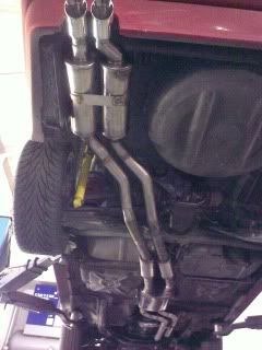

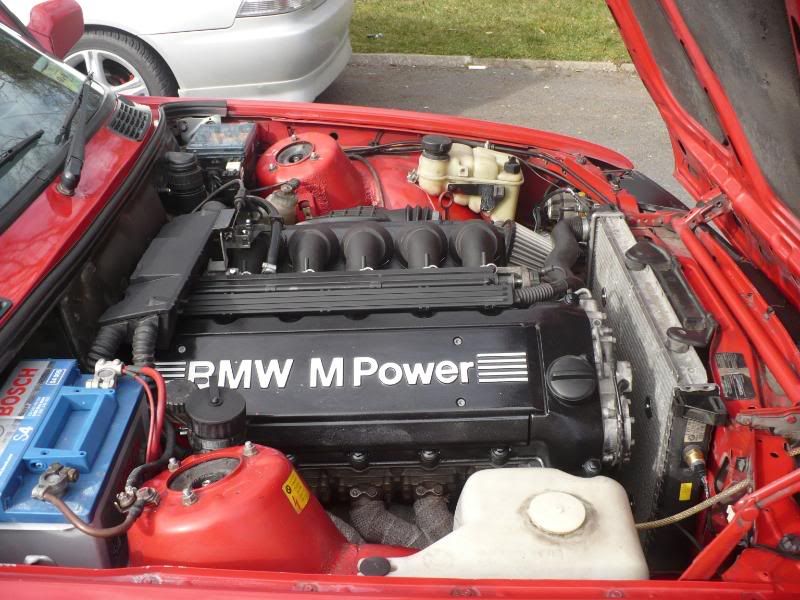

Its Finished now, ill take some more pics of the Car when i detail it, its very badly swirled, but heres some pic's of it in the engine bay the exhaust note from the UUC system is unreal,ill put up a sound clip soon
Here's Some pic's of the engine bay, Ill get more of the whole car, when i clean it :D

Looks good and sounds awesome....you need to relocate your battery in the boot....imo.....looks like a tidy job....good luck with it..... 8)

/// KAMI wrote:Looks good and sounds awesome....you need to relocate your battery in the boot....imo.....looks like a tidy job....good luck with it..... 8)
Ya ill have to get a kit and move it, it can fairly move im over the moon with it, good tight car to drive now, the V,maxx coilovers are a good set up not to harsh and the handeling is great

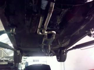

Looks lovely! Have you got any pics of how the rear exhaust manifold clears the steering column?
feens
Posts: 460
Location: Longford
Post Mon Mar 22, 2010 12:10 am
blue30 wrote:Looks lovely! Have you got any pics of how the rear exhaust manifold clears the steering column?
Ill Get some for ya ill put it on my mates Lift, it barely misses it, its very Tight winkeye possibly 4-5mm in it, as i wanted to retain the Z3 rack, was a complete ballbaraker and took up most of the build time, as it had to be done, re-done and done again until it fit without fouling, The car feels fantastic on the road, ive drivin it all week without any problems at all, the work is top notch, couldnt be happier :cool:

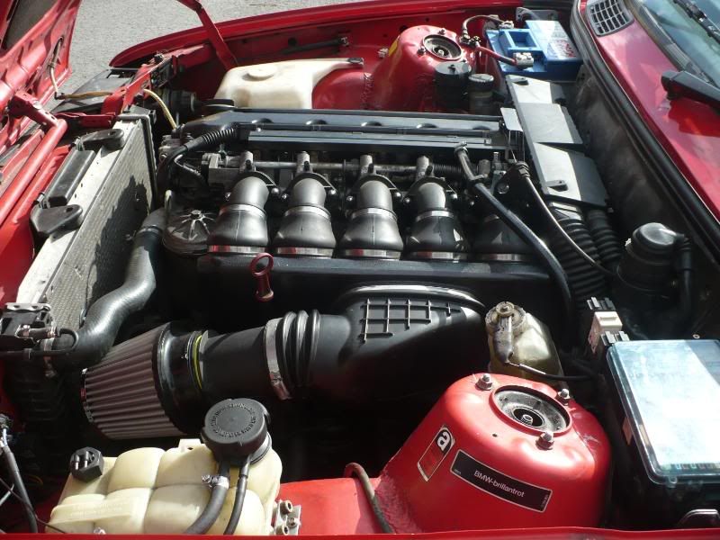

Right its been awhile since i post anything here, i really wanted to detail myown car and tidy up the engine bay before i put up pictures and i have my car ready for the E30 meet in Wicklow on sunday i spent a good few late nights this week on the car so here she is in all her glory,
Interior to sort next and it will nearly be finished:o
