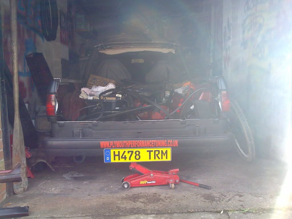

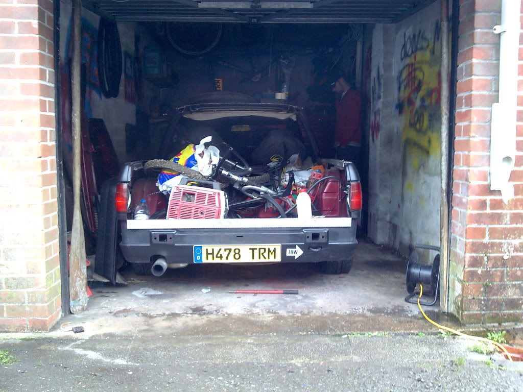

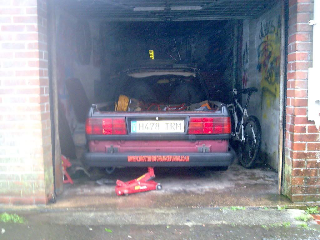

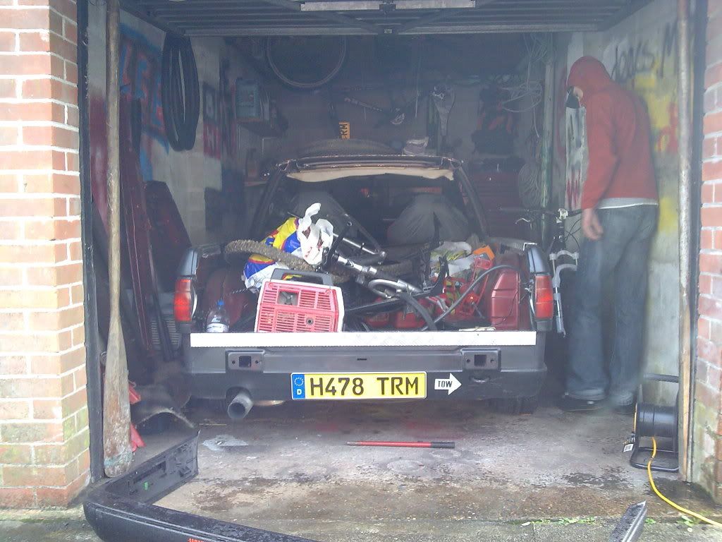

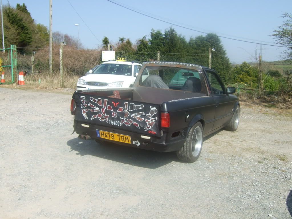

little update........... was originally gonna keep the original rear panel but decided it had to go as most e30 pickups ive seen all keep the original rear panel and original lights and i wanted mine to be different so...............
ive cut out the rear panel, chopped up the rear lights. , i was gonna remount the bumper lower down as in one of the photos but have now decided to debumper the rear.
the section of rear lights ive kept will now be the stop and tail lights and i will mount indicators in the lower panel where the bumper mounts used to be

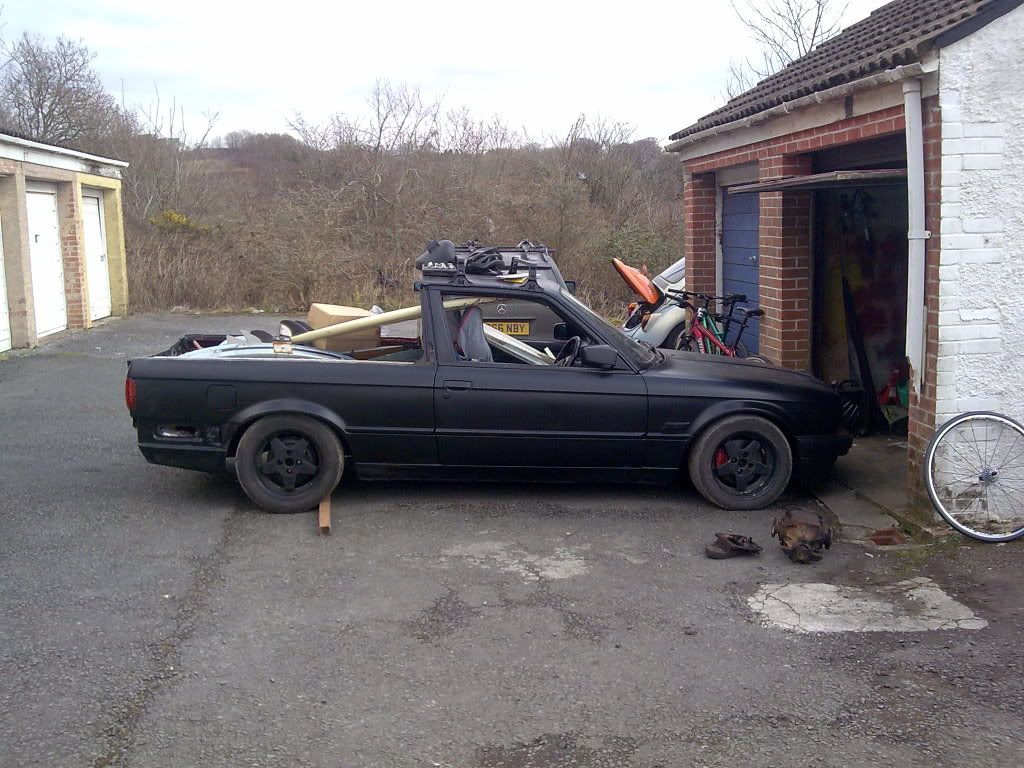

progress and updates have been dire due to the winter weather and lack of facilities with light and power! however as of 1st of feb im renting a unit with a mate of mine and progress should then be swift, ive aquired an M20B25 from a mate of mine and that will be transplanted into the wagon.
Now trying to decide what colour to paint it!

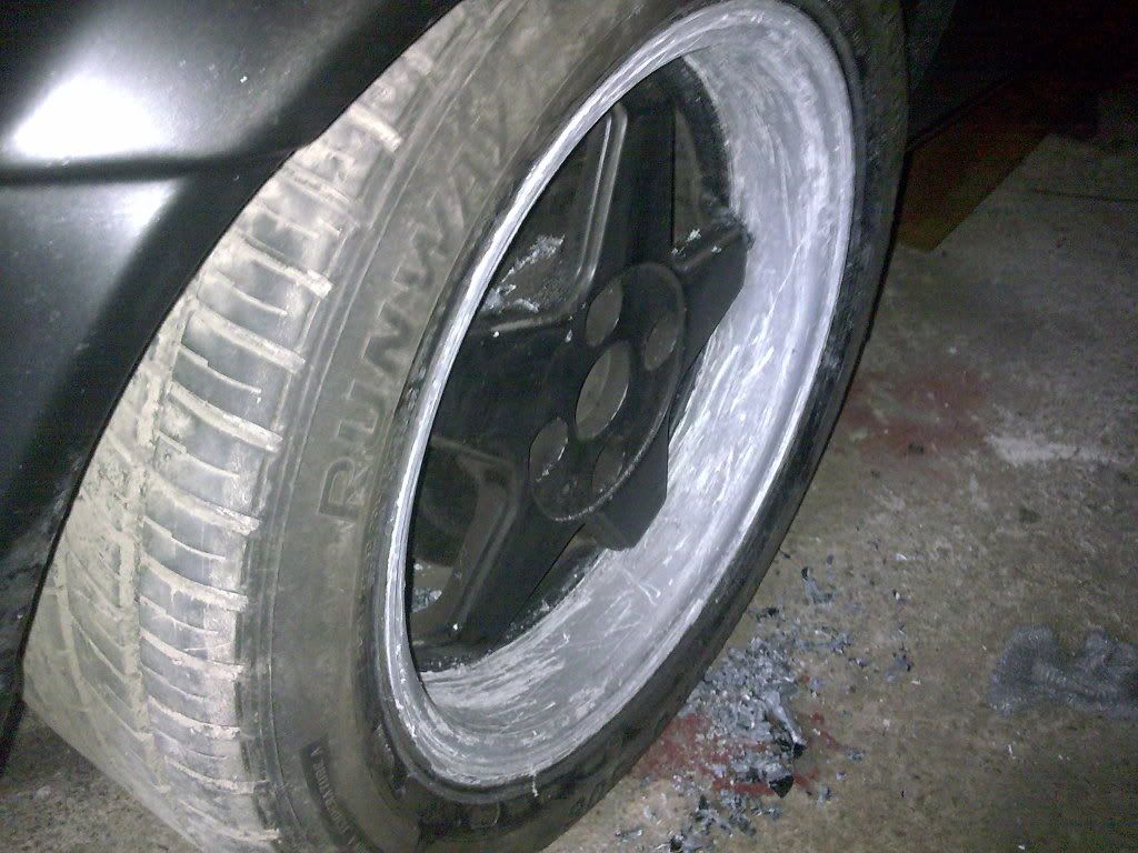

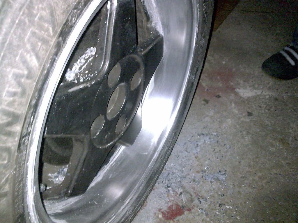

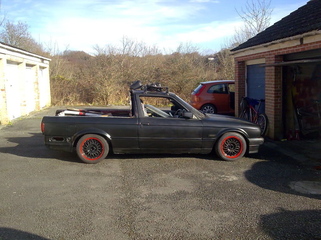

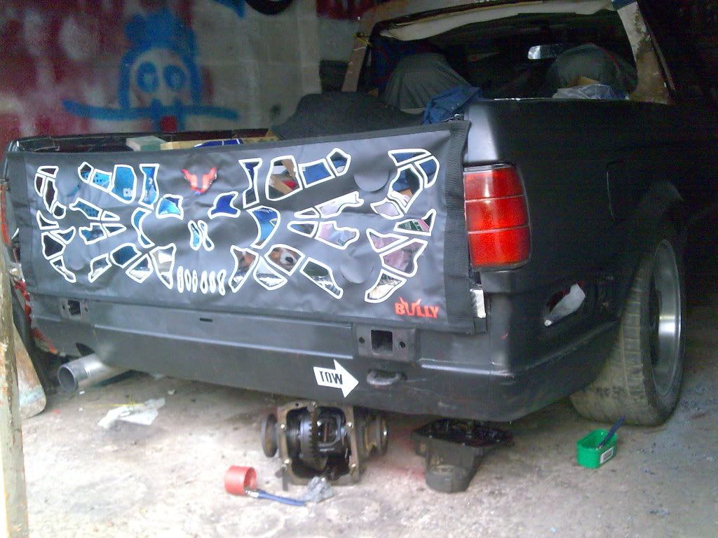

well few minor updates, got shot of the BBS and now have the deep dished wheels shown below, when i got them they were painted 100% black so ive started to paint stripper and polish the dish. also fitted a tailgate net although in the future i do intend to make a proper drop down tailgate.

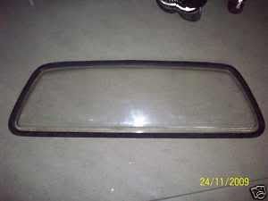

Rear bulkhead is ready to be welded in and i have a mk1 vw caddy rear window to fit into into it

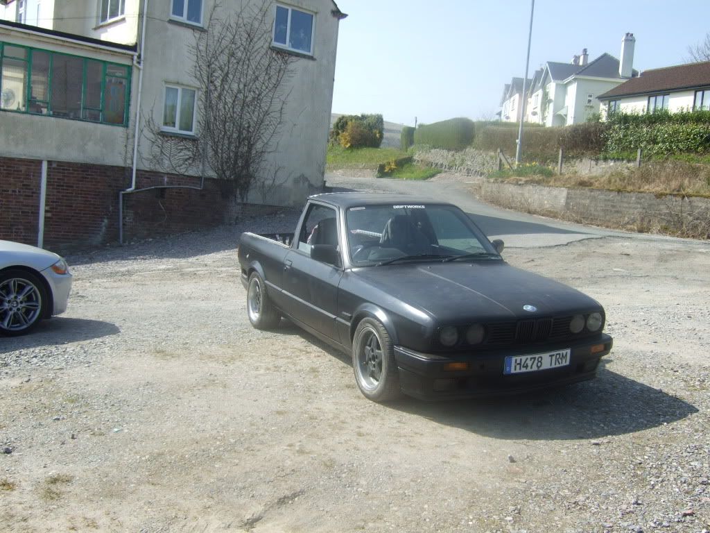

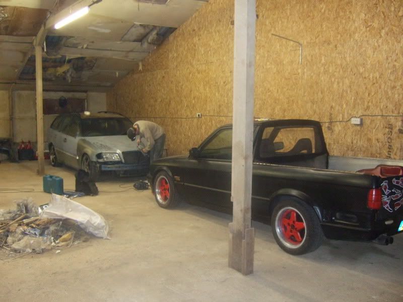

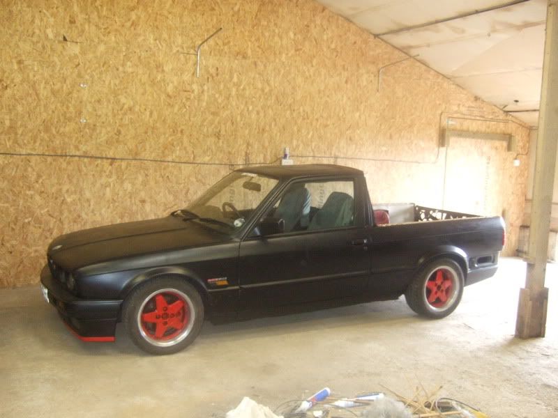

Well here you go, few more pics, the 2.5 m20 is now in and its out of ther workshop into the light for thr first time in a while.

looks pretty sweet pal. good work

Its getting there, slowly, my aim is to have it finished for the bmw show at santapod later this year, my problem is i have too many projects on the go and not enough time to devote to them!

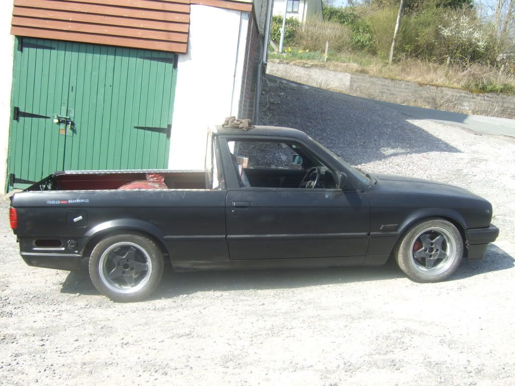

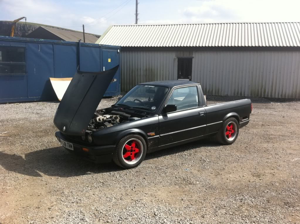

Sat May 08, 2010 8:05 pm
schnaarf
Posts: 1076
Joined: Sun Jun 24, 2007 11:00 pm
Sat May 08, 2010 8:08 pm
Good work! What have you done about the rear lights?
pauldeacs
Posts: 542
Joined: Tue Jun 28, 2005 11:00 pm
Location: Plymouth
Sat May 08, 2010 8:26 pm
chopped up the standard rears and installed a stop and tail bulb/holder in what was the indicator section of the original rears, tinted the plastic red. installed seperate indicators
