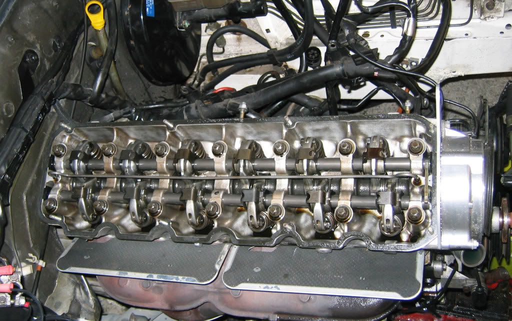

Right: Spent today on the actual car stripping out the engine bay ready to remove the engine. I am soooo lucky to have a nice dry large area to work over there. It's a fair distance to mothers so i have to remember all my tools but it's worth it. To give you some idea of the space I have to work in, heres where the car is stored in the winter and where the engine replacement will take place.
And I managed to get to this stage today so all I want to do now is whip the head off, remove the starter motor and she's ready to come out. I wimped out when the cold got the better of me I'm afraid.
Dave you have PM re the cam cover and inlet manifold.

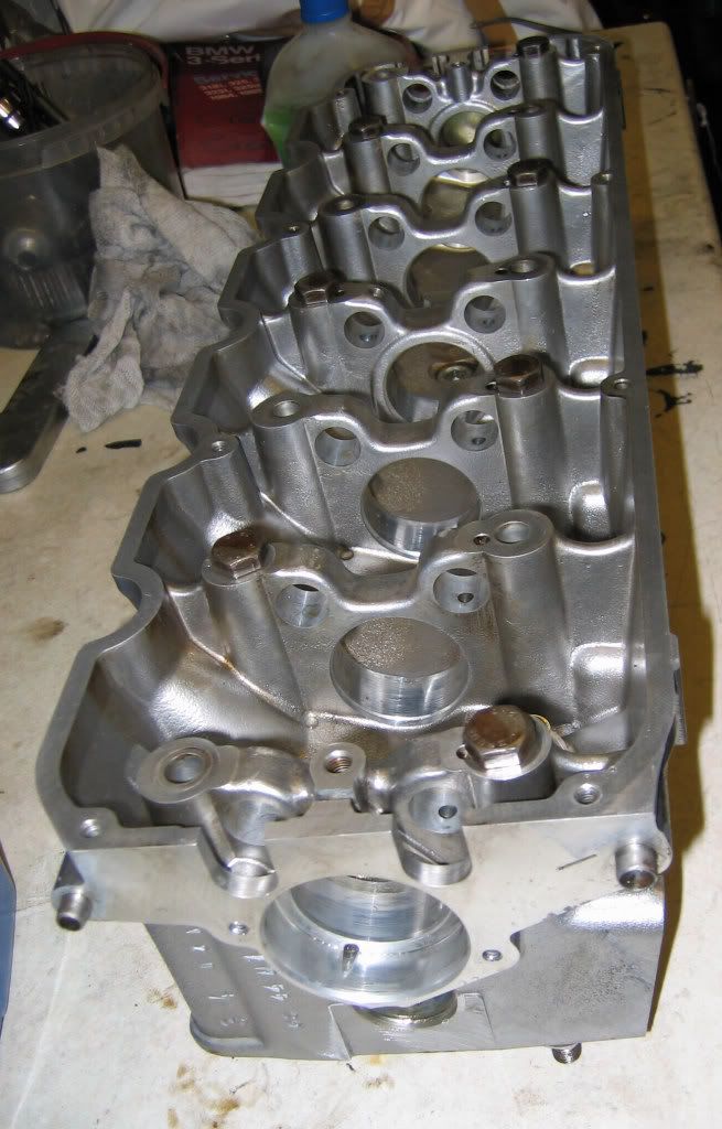

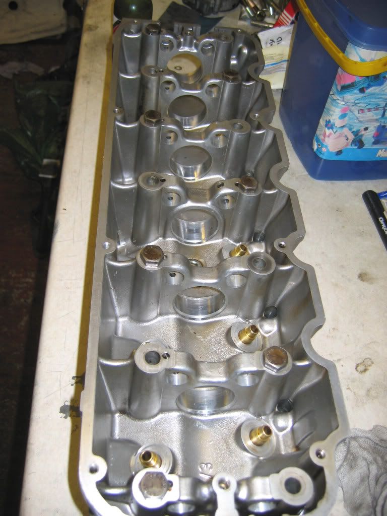

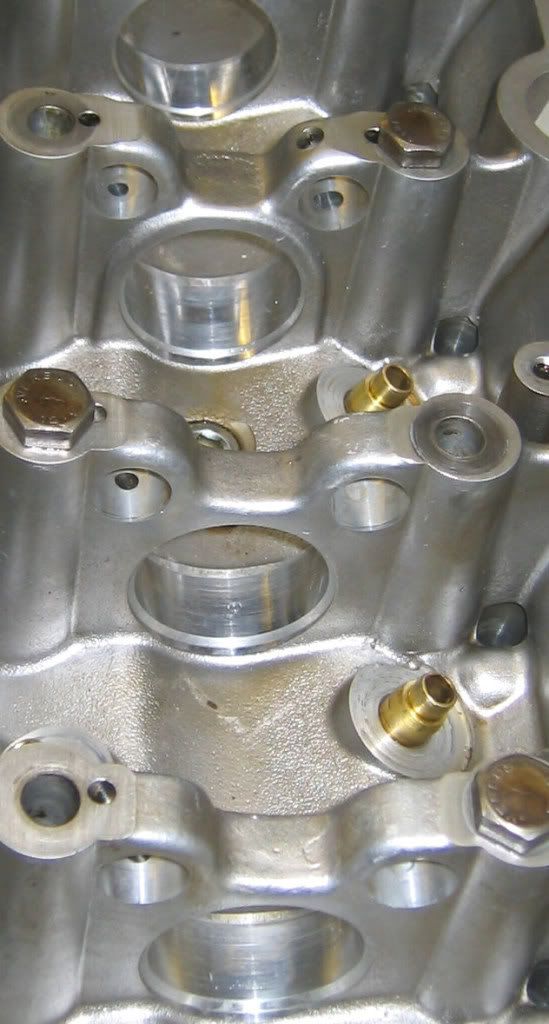

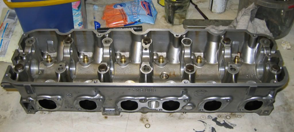

Tonight was spent stripping the head that Si has supplied. And very good it all looks too! I just hope this pressure tests okay. There is absolutley no signs of any failure coolant wise which to Si and I seems strange as PYF was using coolant. However as stated before this was a brand spanking new head supplied and fitted by BMW about 4 years ago. Si' still has the reciept which IIRC had a bottom line figure of just over 2 grand. Had about 60k up and is full of genuine BMW bits fitted at that time. It's date stamped the year 2000 which I reckon must be one of the latest castings out there. Every thread is as new, no helicoiling needed here
Here it is stipped and de greased. Needs a final clean up with thinners but this do for the pressure test:

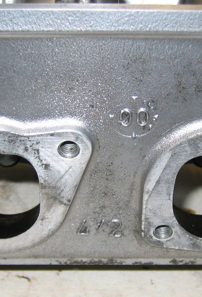

Date stamp

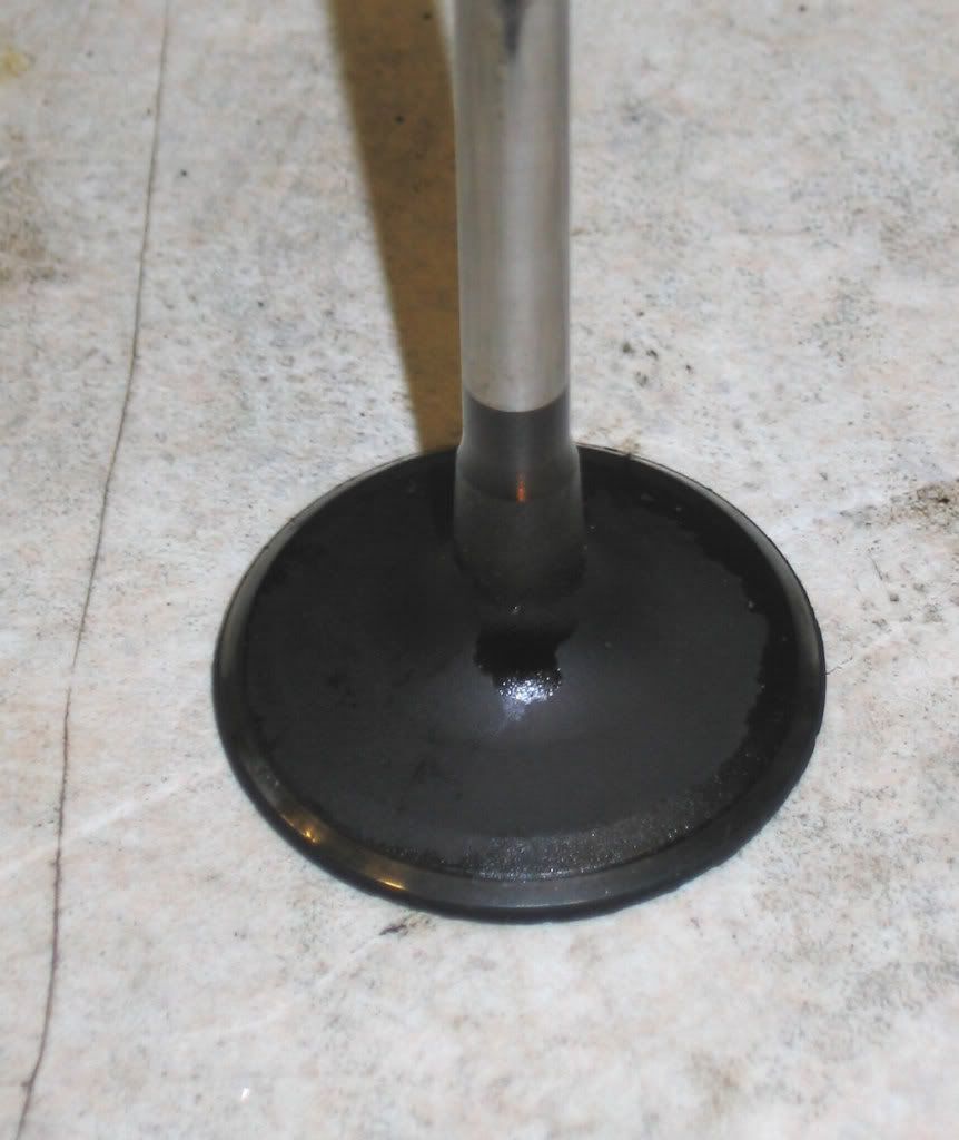

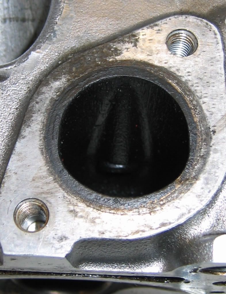

And the only faults found so far are
Evidence of valves stem seals just starting to weep.
and an exhaust gasket leak on No.5
i'll take it in for a pressure test later in the week and if alls good, I'll have a very light skim to clean the face and reassemble using new valve seals and cam oil seal and ring.
I'm lovin it!!!!
Date stamp

Wow what a clean looking head! It's an inspiration mate. I really like the idea of creatin a minter. I removed the injectors from mine the other week and I noticed a lot of external crud around where they are housed.Here it is stipped and de greased. Needs a final clean up with thinners but this do for the pressure test:

The only way is to to strip it really and clean it by hand. You can degrease it and pressure wash it as we did si's and it makes a big difference but the only way to get it clinical is to strip it.What is the best way to clean the outside of my engine and remove crud that could find its way into all the exposed bits?

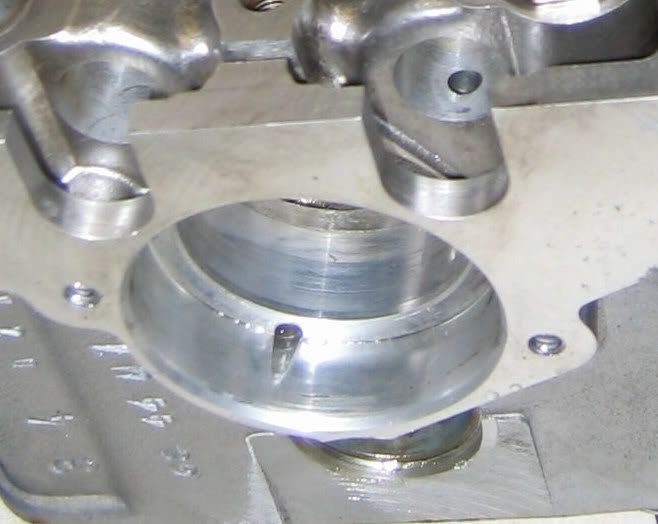

Trev was there any wear/scoring on the mains on the camshaft, as the main bearings on the head look good. They seem to score badly on older heads that i've stripped.
Pillock for letting you have it if it's good but i suppose the 3 M20 heads i have will do! lol
The head was very clean to start with and v.quiet. The engine did smoke a wee bit round the ring so the stems might be my fault

None whatsoever Si. I havn't cleaned the cam yet but theres no lips on the lopes and no scoring on the bearing surfaces. First to go would obviously be the running surface in the head as it's alloy but heres a couple of cropped shots of the cam bearings and theres no significant markings on it.Simon13 wrote:Trev was there any wear/scoring on the mains on the camshaft, as the main bearings on the head look good. They seem to score badly on older heads that i've stripped.

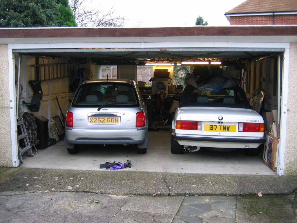

Are you talking about the whole engine Trev? In one evening? Thats the stuff of hero'sB7 wrote:once I have all the parts, you can build one of these in an evening.
Top job
PS I like your runaround in the garage
- Posts: 22697
that aint cracked, should of kept it for my 2dr! hey ho
- Posts: 15841
What muumys Micra? That thing has only got about 20k up. It's like a brand new one. 1.0 auto as wellJesus325iTouring wrote:Are you talking about the whole engine Trev? In one evening? Thats the stuff of hero'sB7 wrote:once I have all the parts, you can build one of these in an evening.

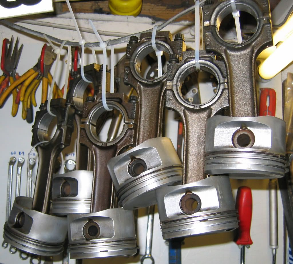

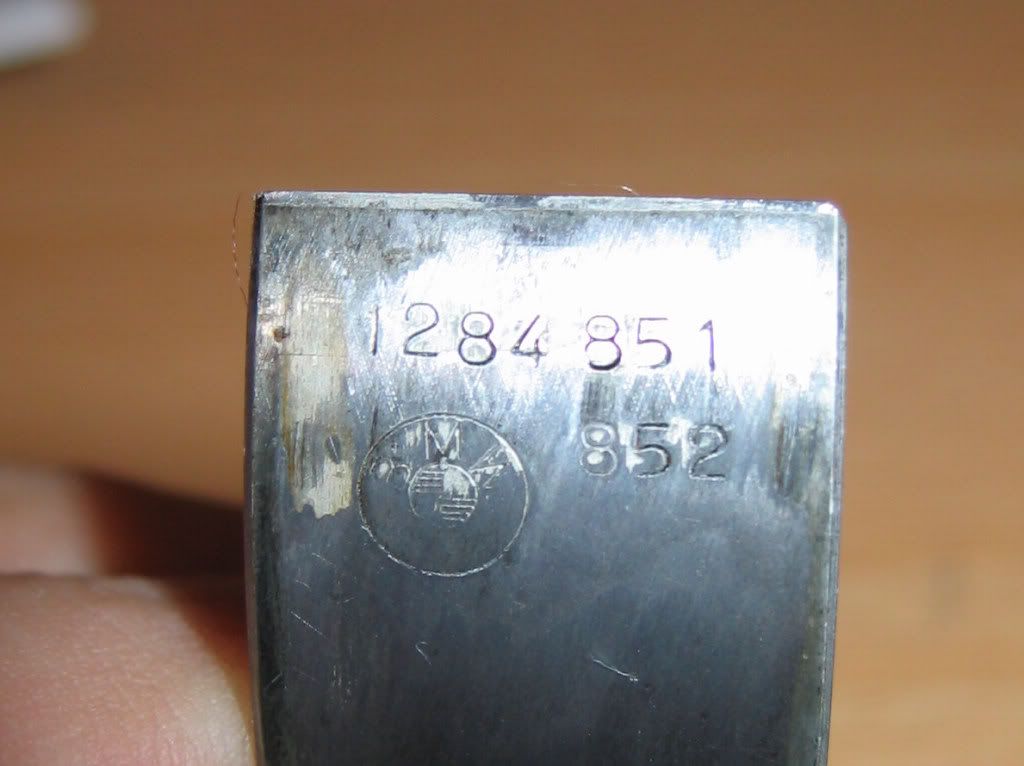

Okay. Heres a query for the M20 builders amongst you? The big end shells are currently genuine BMW. The number checks out on RealOEM as 44,75MM(+0,25) which is fine. Spoke to my machine shop today (he's currently got the head in for pressure testing) and he cannot supply anything other than standard sized shells. So that'll be another reciept from BMW's then.
However, I've checked the shells again and it has 2 numbers on it see below
Now the 1 284 851 checks out to be a red shell (end cap shell) on the following link and if you transpose the 851 to read 852 (1 284 852) it checks out to be a blue shell (con rod shell). Both shells came off of No.1 rod. Yet OEM states it should have one of each?
http://www.realoem.com/bmw/showparts.do ... g=20&hl=15
But what do I order? 6 851's and 6 852's or 12 851's as appears to be fitted at the mo?
851's are half the price by the way. I'll strip the other 10 shells out tonight and check the others see if some of them are different.
Anyone got any idea?

Have you spoke to Tee?
- Posts: 15841
Not yet. I reckon it should be upper shell blue and lower shell Red.bss325i wrote:Have you spoke to Tee?

Cliffy this is the bottom end
Trev i've got all the part numbers for big/main end shells i'll have a check
like i said the other night they are all supposed to be the same colour i think

Cheers Si. They are all the same bearings fitted.Simon13 wrote:Cliffy this is the bottom endTrev i've got all the part numbers for big/main end shells i'll have a check
Thing thats confusing me on the OEM diagram is that they list 6 x No.5 Blur bearings shown in the conrod side and 6 x No.6 Reds in the end caps.
If they are all reds I'm laughing but if I need blues as well they are twice the price! I've just been searching the net and can't find a company that can supply +25's

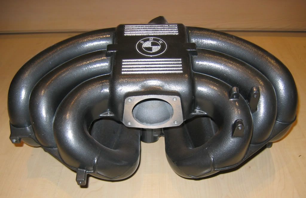

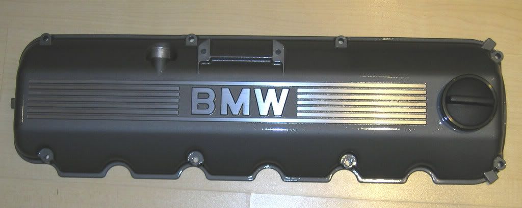

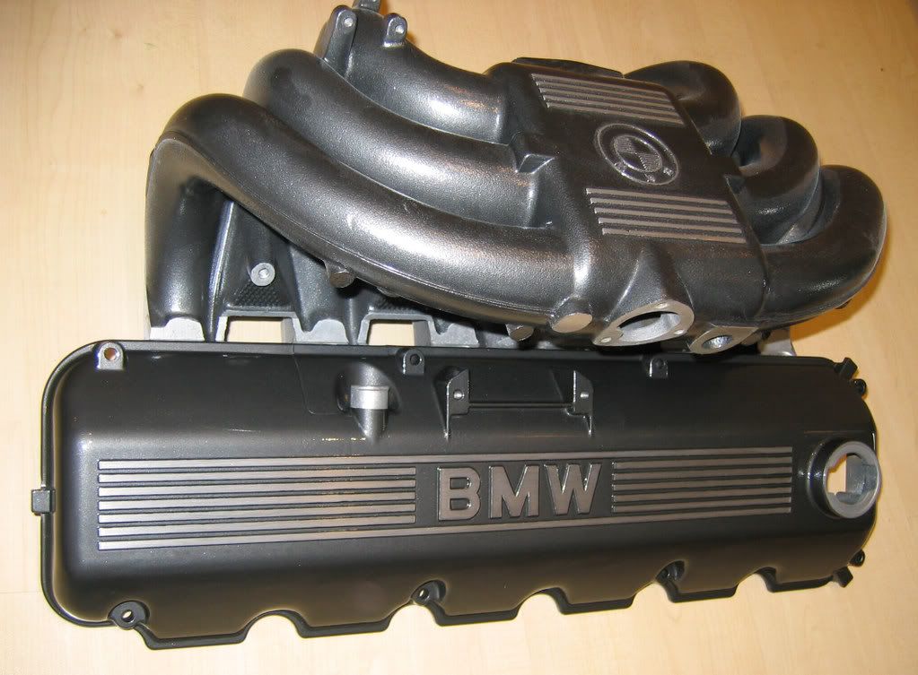

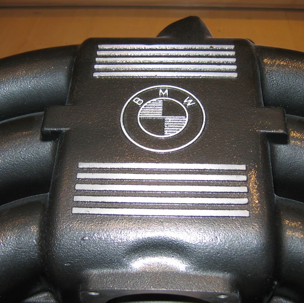

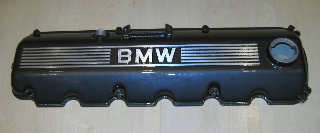

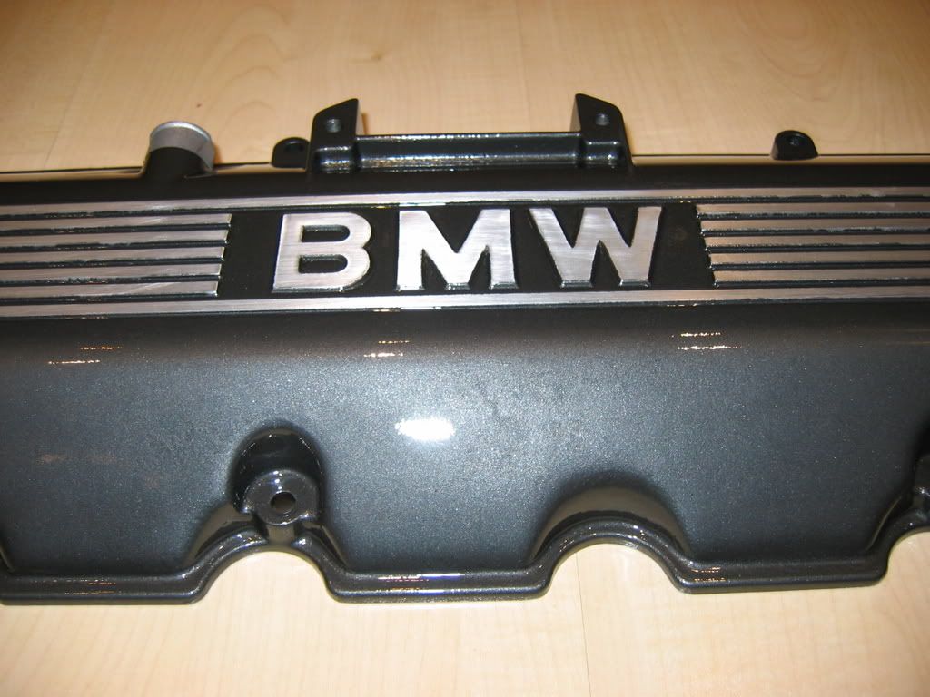

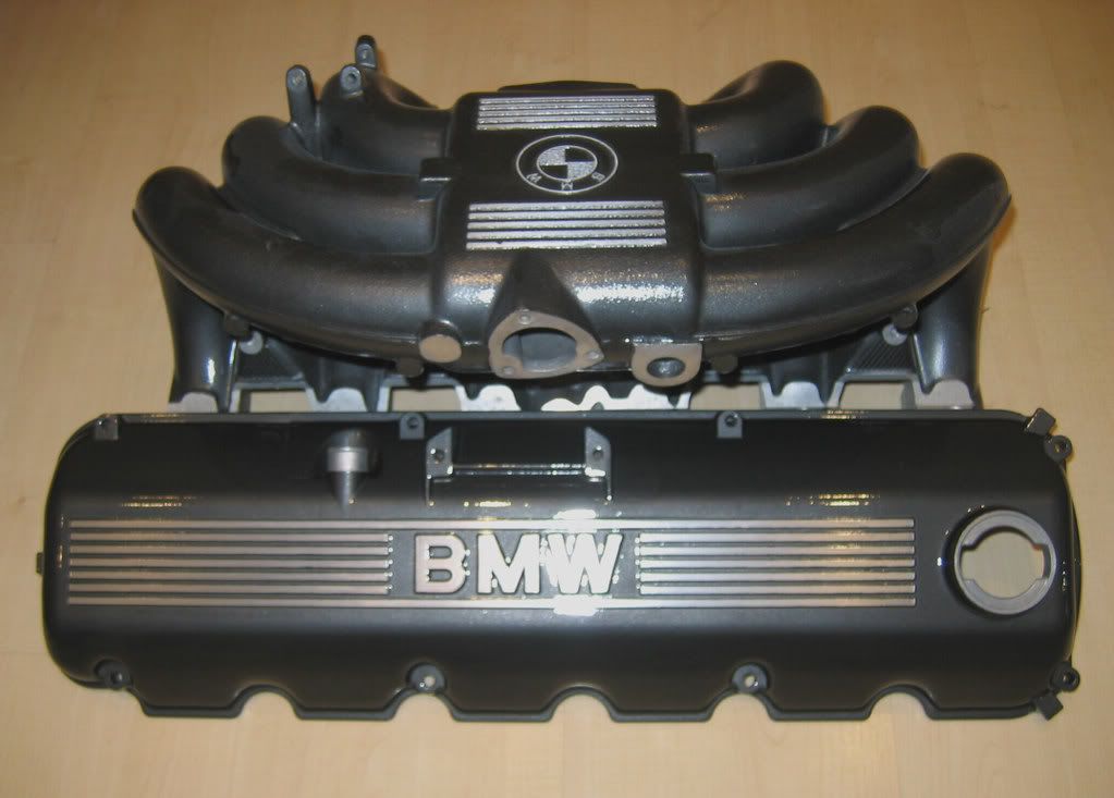

Okaaaay! Things have been a little slow on the engine front due to me ordering shed loads of parts and general other commitments.
However, I have now mixed and painted the new cam cover and inlet manifold to what hopefully, is a closer match to the original Alpina Grey. The old one always was a bit too light, nice but too light.
See what you think.

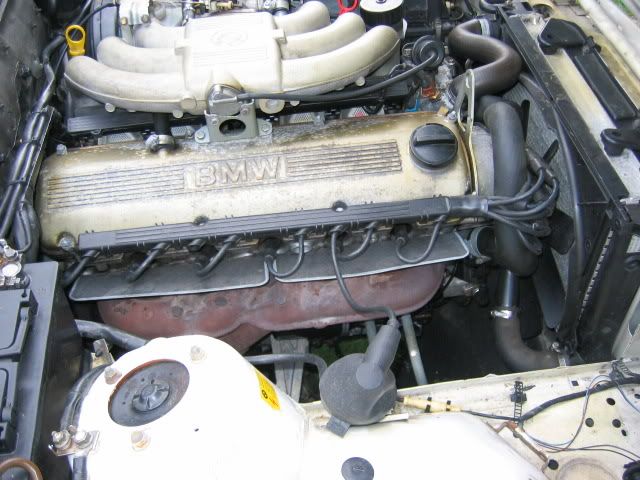

You're probably bored with the shots of how it was but purely as a comparison, heres the old and new back to back. first is old light grey, followed by new dark grey.
heres another shot of the pair from a different angle.
See what you think.
- Posts: 22697
thats got be nearly on the money! Lovely as always
- Posts: 16806
- Location: Norfolk
shoot me, but I prefer the lighter ones

i want that engine bay, what colour is the engine rocker cover and that??Demlotcrew wrote:B7 wrote:
