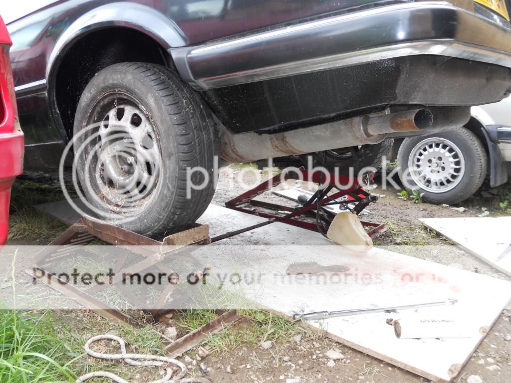

Also got to use my 'new' ramps too, which are great, once the car comes off them, i'll get them painted up like new :cool:

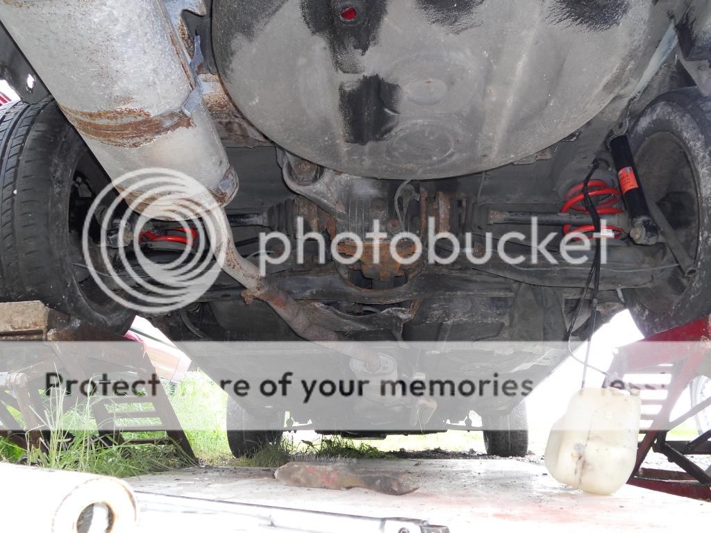

Pictures of the underside 'before'... I'll get a finished picture once im done under there
New Ramps :cool:
Underneath 'Before'
Very very rusty tank 8O Glad its coming off...
Thought about getting a new exhaust but its the cost at the moment so doubtful. Would be great to have a stainless but not happening this year. I noticed Duke has a 320 exhaust for sale which looks cleaner but there isnt actually anything wrong with the one on it... :mad:

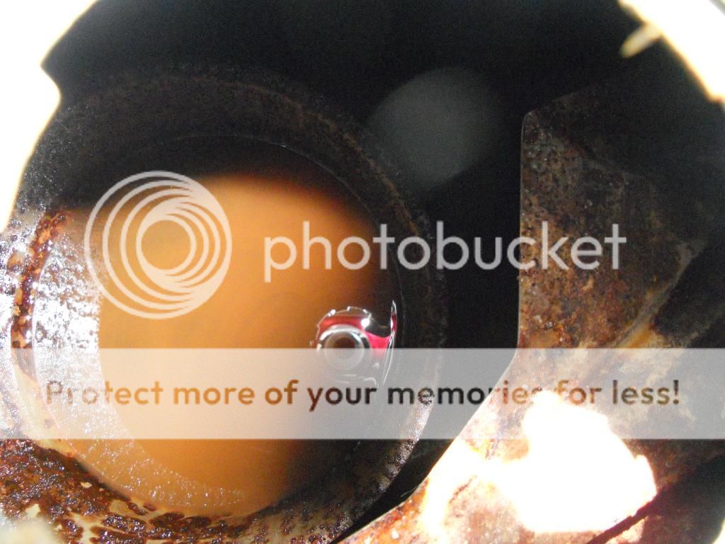

The old Tank is off, which isnt all that simple to get off :? Have fun, anyone else thinking of doing it!
The tank is extremely rusting on the inside, I'm debating on chopping it open at a later date just to see the extent of the rust and to where it started.

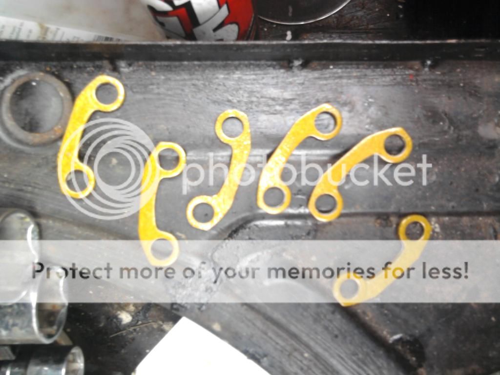

The fuel level sensor/sender thing was the early plastic type with the filter at the bottle, which was also split so was allowing the rust to get through. I do have a slightly later version to go back on which is the metal type but basically the same thing :D
Hopefully over this weekend, the replacement tank is going to be sand blasted so that I can paint it up and not have to worry about it again, also got a few other bits to get done and hopefully some powder coating but not 100% if its happening yet.

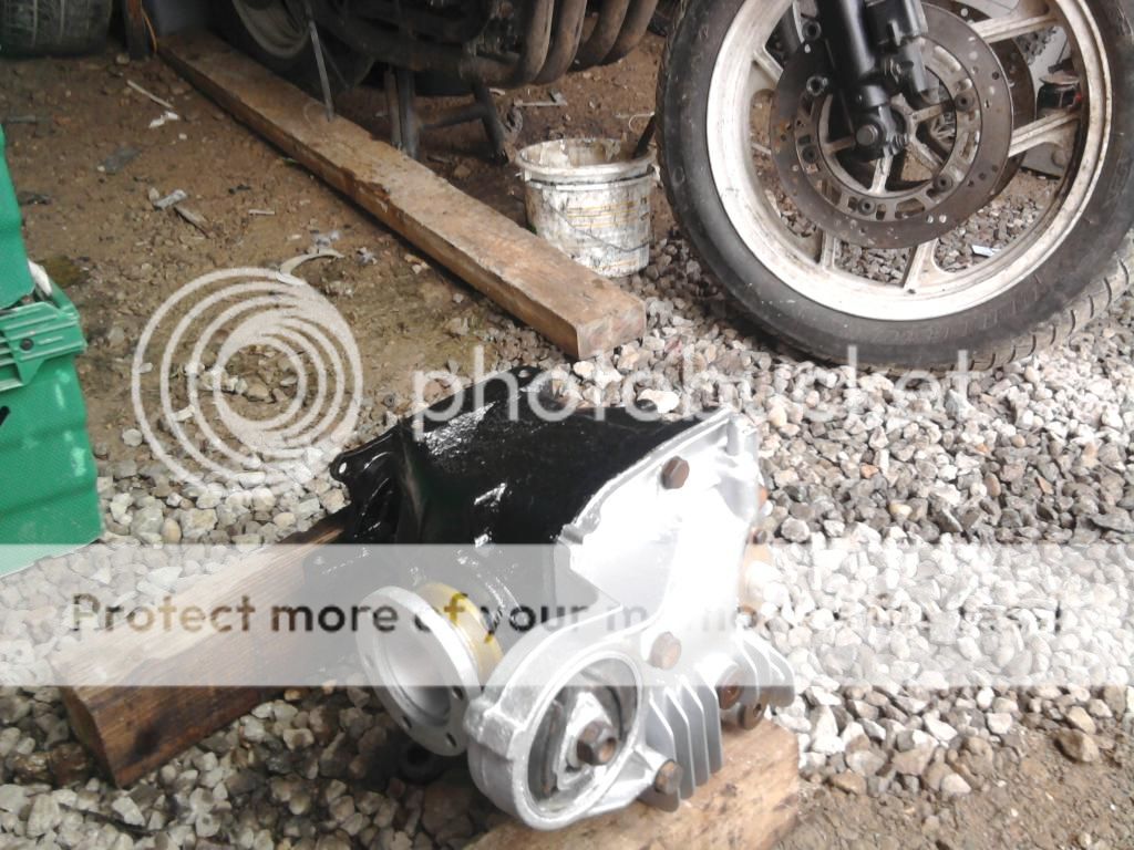

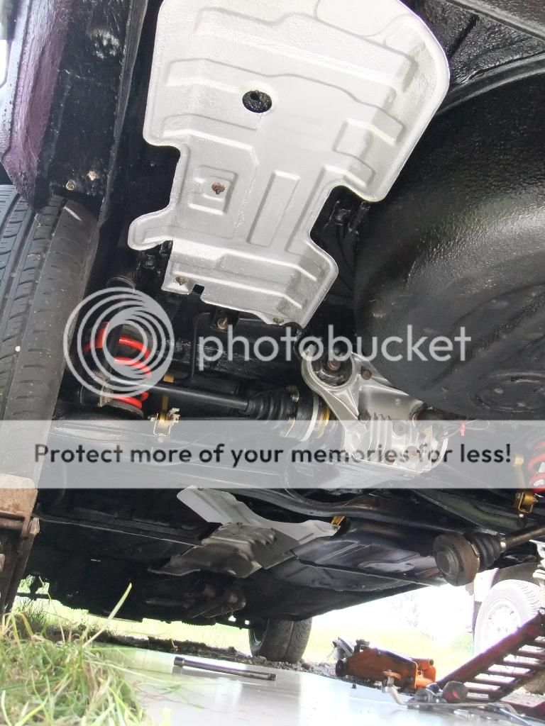

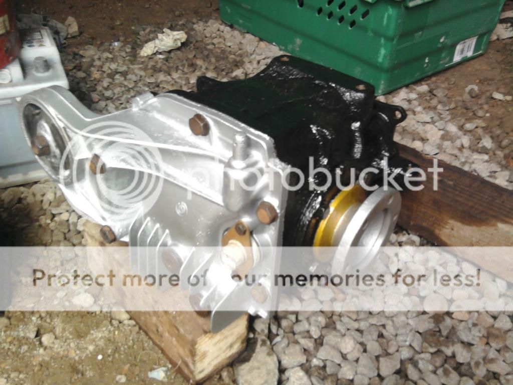

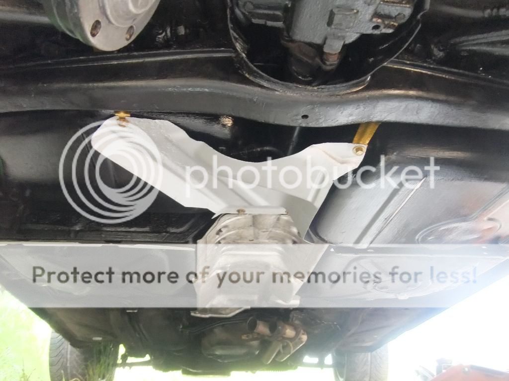

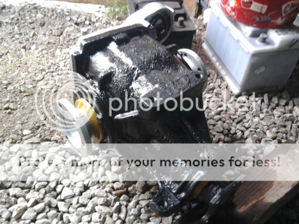

Small update, my phone takes pictures... Although not very good ones so I couldnt get it to focus for under the car.
Got a picture of the diff though and thats all
Poor quality pictures but its all I have til my camera is back from being repaired.
The whole rear is undersealed now, the rear beam and arms have been hammerited. I didnt managed to get anything powder coated as my mate let me down... As he lets everyone down :( Sorry to anyone else waiting on him for anything...)
Replacement tank has had 3 coats of hammerite, same goes for the filler neck and pipe cover that sits in the rear arch.
So need to get it all back on once I clean up some new brackets for the tank from another tank but the rainings coming in so wont be getting anything done just yet :(
Also need to fit a rear anti roll bar so that will be added too.
Need to take off the driveshafts to give them a good clean up.
Then all back on :cool:

Slowly getting it back together,
Rear end is back together now bar one drive shaft as the jubilee clip thing had come off so the rubber had come back slightly. I've regreased it and threw a normal jubilee clip on there for now, but need to get a proper one on there as it wont spin with that sort on :mad:
Getting the diff back on was a pain in the arse as it wouldnt line properly, but got there in the end...
I did get the fuel tank up and on, then realised I needed to attach a hose from the passenger side on the top... So had to drop it back off again, but didnt take long.
I'm suprised on how easy it all was to do to be honest :cool:
The rear beam was brushed up with Hammerite. I'll be getting another one blasted and powder coated as well as disc brakes for the rear at a later date and i'll switch it all when its off the road next, as well as replace all the bushes etc.
Andy from down the road, who I posted pictures up of his Sport a while back brought down some exhaust sheilds he had hammerited silver, but then didnt use them and bought knew... They came in handy and were good enough for El Turdio :cool:
Painted up the drop links and fuel tank brackets in tacky gold too winkeye
Doubt it will stay clean for long though...
Next plan is, down on the ramps and the interior back in, and hopefully start her up... Then back up the ramps and get under the front to underseal whats left and figure out whats leaking from the gearbox/engine area :cry:

Thu Jun 28, 2012 9:56 am
Kedge, do you have any of the clips as well? :twisted: Its one of them things that I have got to go out for that take ages to find and cost 20p or so... If you've got one, and the tool, that would be awesome :twisted:
Grrrr - Get under there and strip it all down! It doesnt take long at all. I didnt remove the beam or anything, just the tank and diff. The rest I removed the scabs and undersealed etc. A few days work but well worth it :cool:
Although I do think the silver on the back of the diff plate wont last long :cry: When putting it back up, some of it on the edge came away :? So... When I change the rear beam at a later date, i'll be getting that off and hammeriting it as the silver was only sprayed

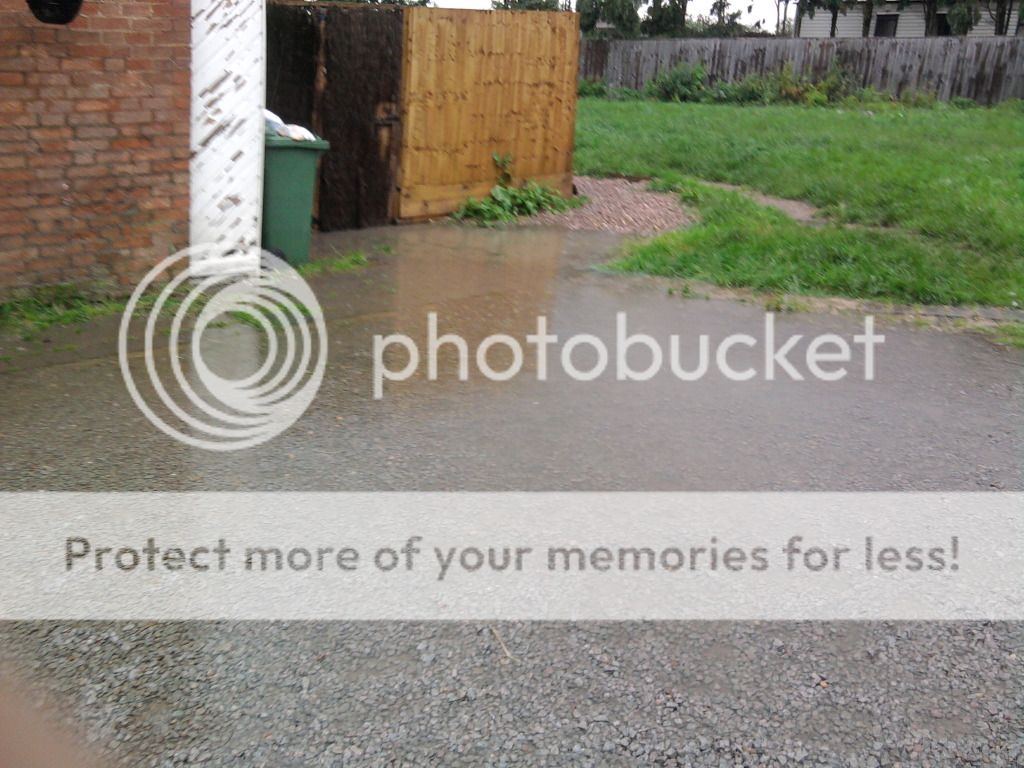

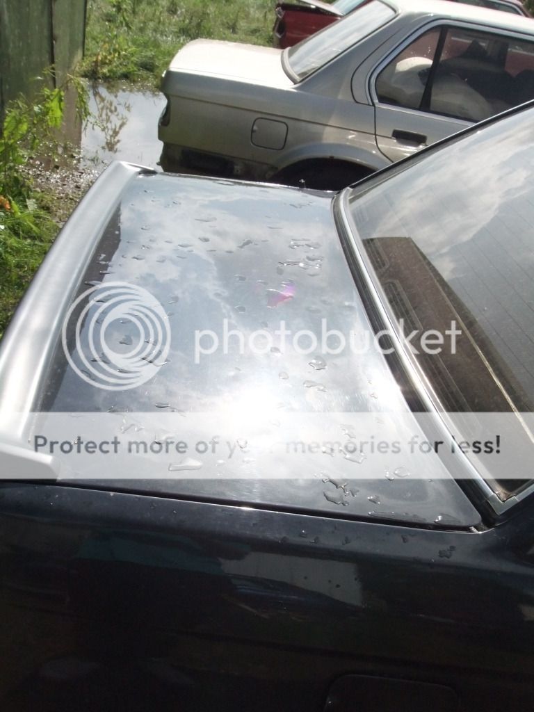

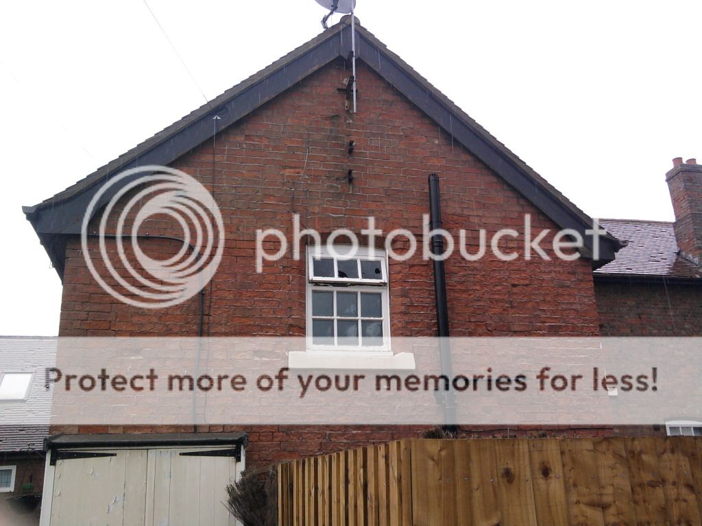

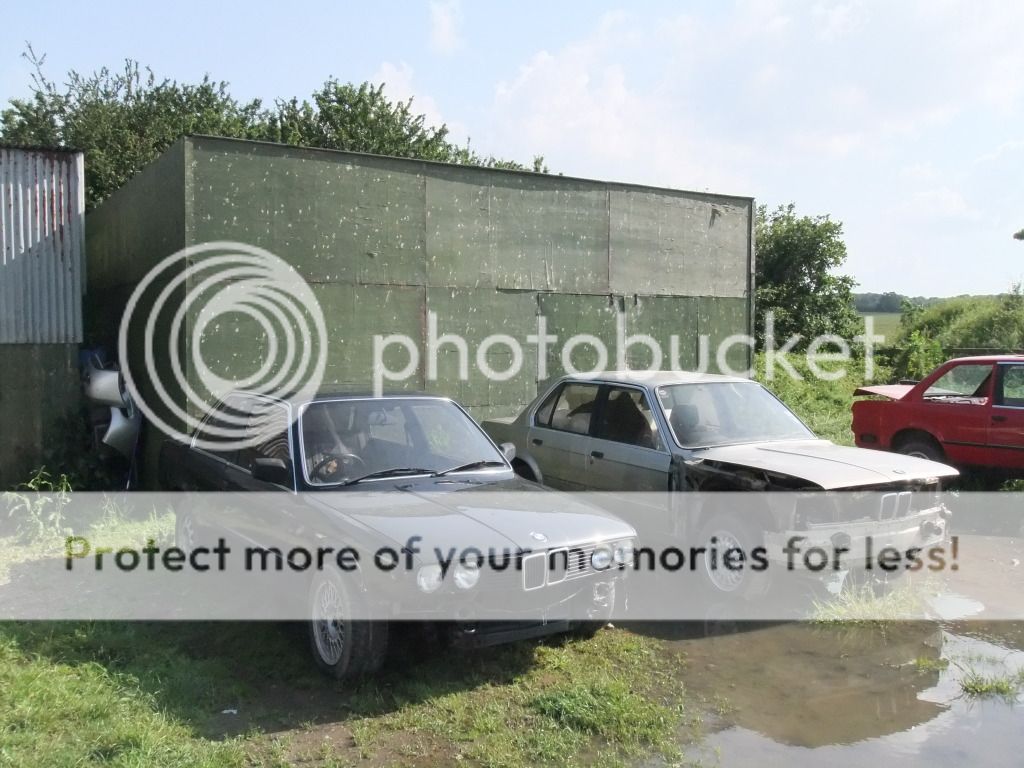

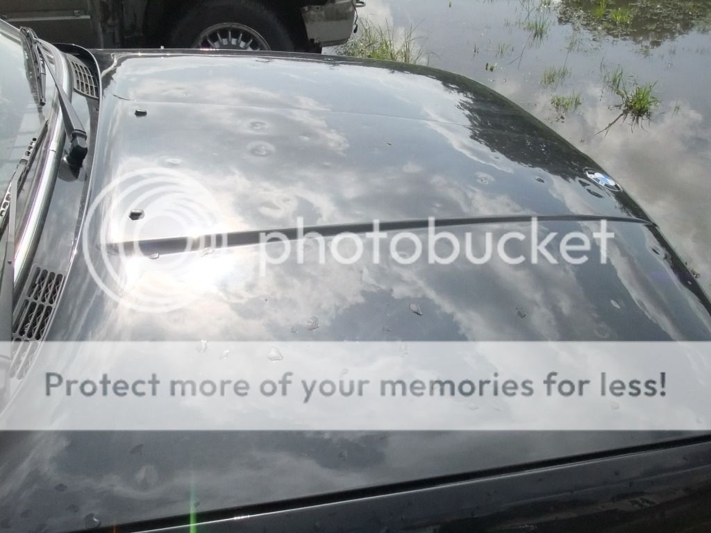

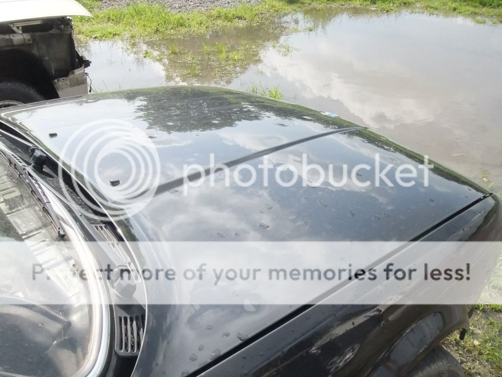

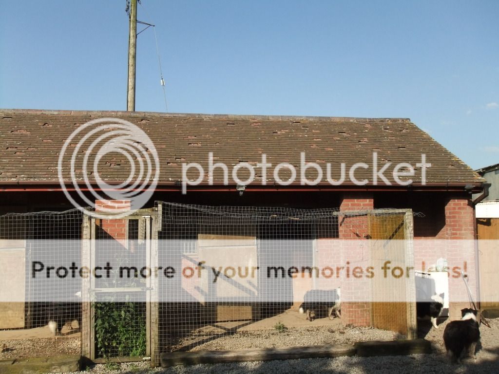

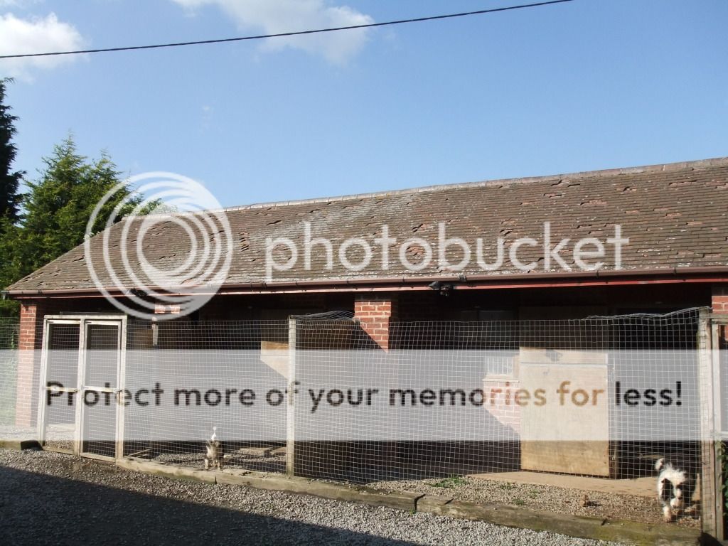

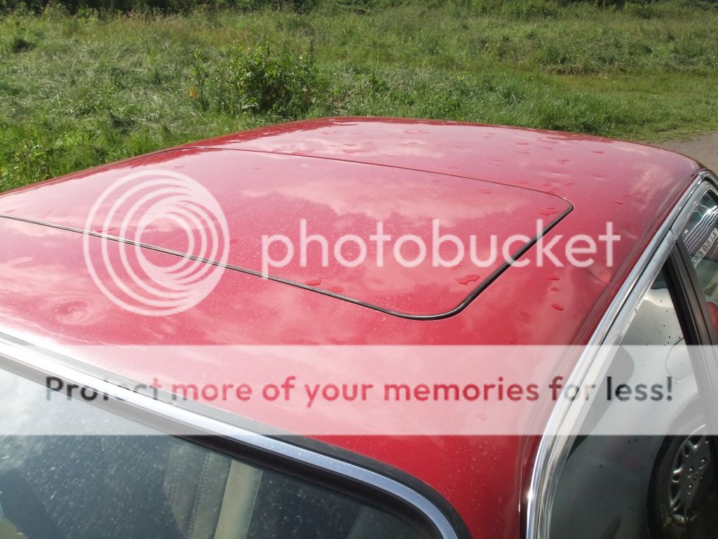

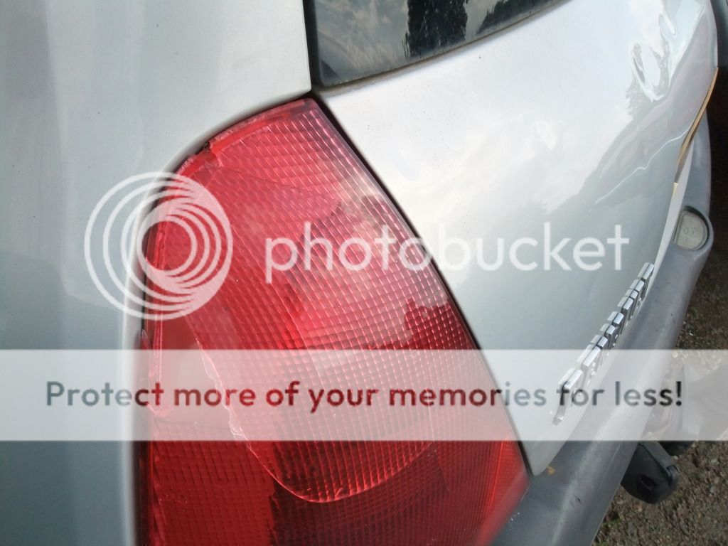

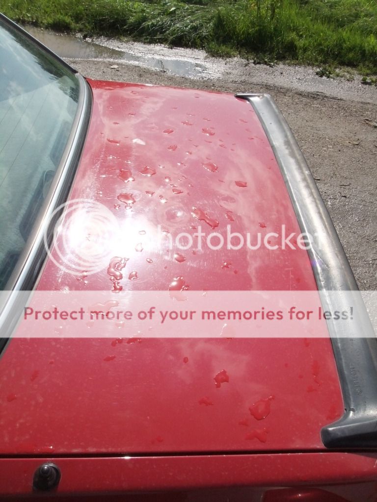

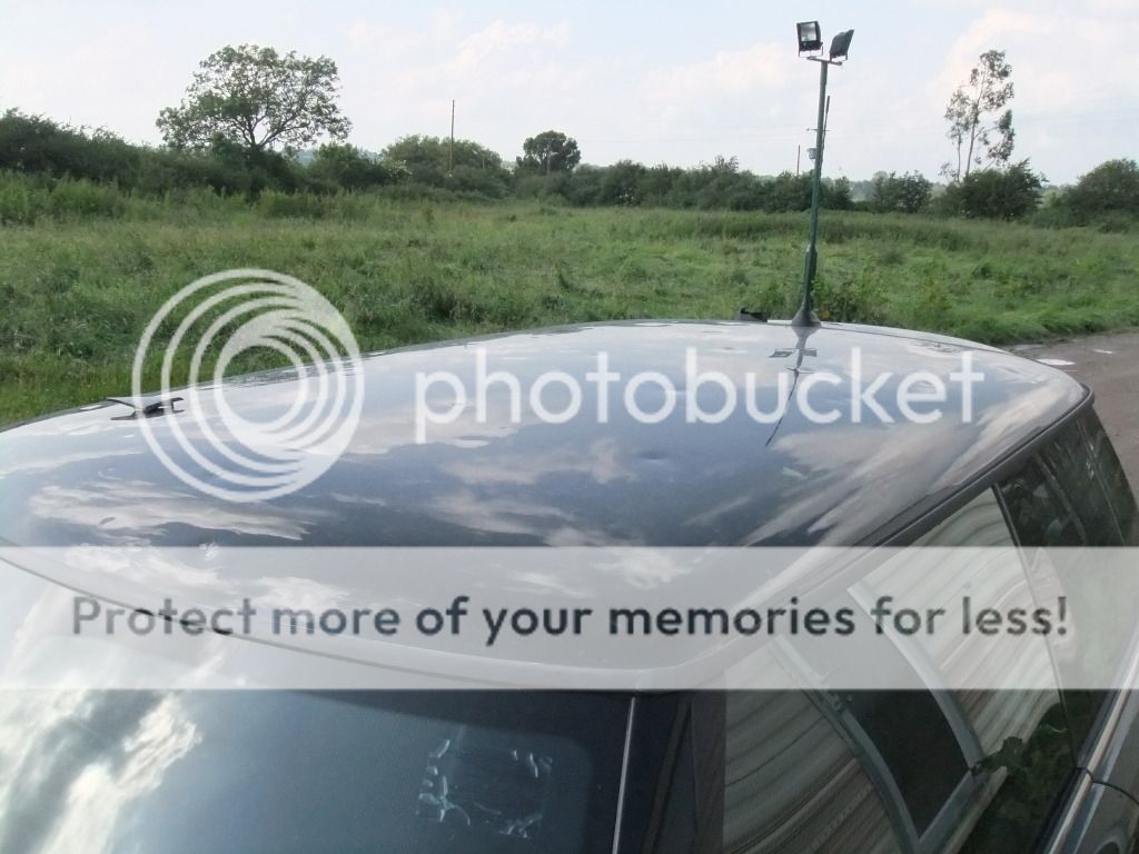

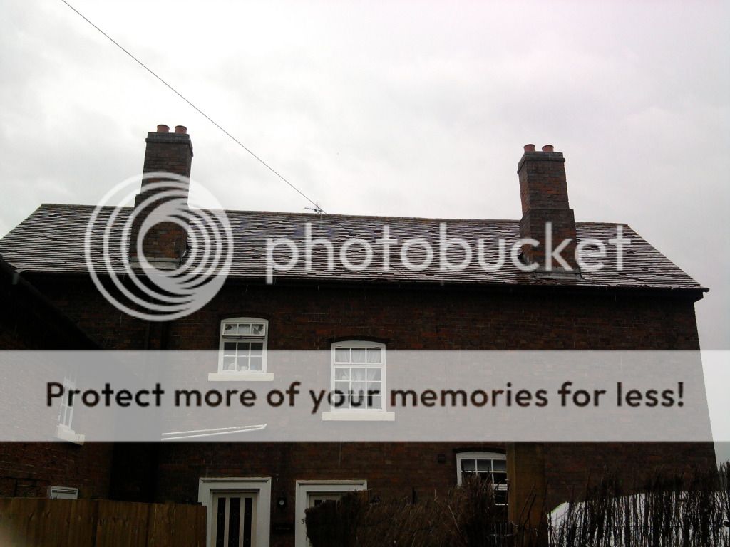

The Aftermath from the hailstorm we had
Rickys car
Mini
Unit front got hit, it was fully green before
House roofs and kennel roofs

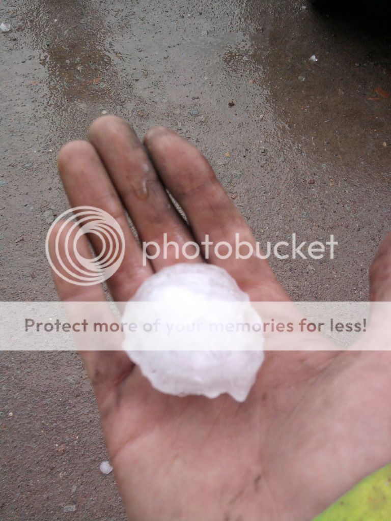

The hails, this was an average size one, theyre were some massive ones.
Kedge
Posts: 7702
Thu Jun 28, 2012 10:01 pm
Still amazes me seeing this, so glad we only got the rain here! :eek: :cry:
Instagram - Kedge85
Duke137
Posts: 7207
Holy shit! :eek:
that's fucked the job up, :eek: I hope your insured Jim ?
Rtaylor2208
Posts: 3004
Thu Jun 28, 2012 10:05 pm
Ouch that all looks very very expensive to get sorted out, at least the house and newer cars can go through insurance.
johnl320
Posts: 3125
Thu Jun 28, 2012 10:10 pm
That is horrendous, amazing how the glass held out on the skylights and windscreens, gutted for you.
I wouldn't be surprised if local farmers have some dead livestock after that, looking at the size of those hailstones!
polsta
Posts: 10322
Thu Jun 28, 2012 10:17 pm
fooking hell 8O 8O unbelievable mate, i feel for you , weather in our country is getting worse/more freakish by the year
, the underside of the car is looking super there, quality work
Thu Jun 28, 2012 10:29 pm
Christ Jim, I hope you have a decent insurance policy in place :(
Jim320i
E30 Zone News / COTM Team
Posts: 10627
Thu Jun 28, 2012 10:32 pm
Roof tiles are already on the order so got 500 odd coming so gonna be on them soon as they arrive... Luckily, Ricky is off work too so we can crack on and get on it soon as they arrive.
The cars, only the mini and the red chromie were insured... :mad: The red chromie, they'll just right off, the mini, the insurance will be sorting...
My chromie, the missus Clio, 2 breakers, a old mini were not insured as all off the road :cry:
Those windows on the roof, one was cracked, but only the corner part so thats always good... Thats were I actually was at the time, we ran back into there, watched in amazment, then started getting a bit worried so had to close the curtains just incase the windows came in, stayed away from all glass but nothing broke in that part :cool:
Still cant believe the damage to the chromie :cry: I'm gonna try and ring one of those dent removal companies tomorrow but I have a feeling they're gonna be fully booked up round this area for a while... Not sure they they charge per dent either... That will be expensive
I counted
28 dents on the boot
54 on the roof
87 on the bonnet
14 on the sides
8O
Ricks had 170 we counted... I won that one winkeye
