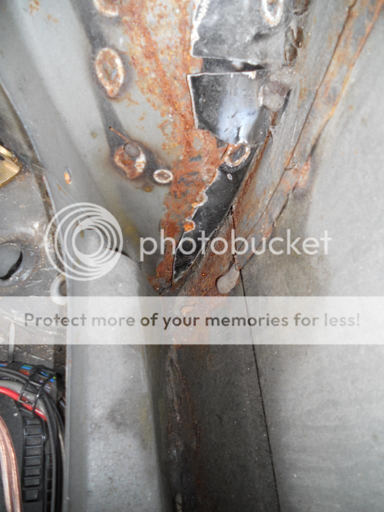

I've just pop back in... Since the loom is all pretty much detached inside the car if gave me enough slack to pull the fuse box forward and out the way to inspect :D
Suprising, not all that bad! Scabby where one of the threads for the foam cover is attached and a little bit in the corner but of the outer wing but other than that ''''ITS GOOD''''
I will need to get a replacement foam bulkhead bit for behind the fusebox though as that was fell to peices as I was pulling it out...

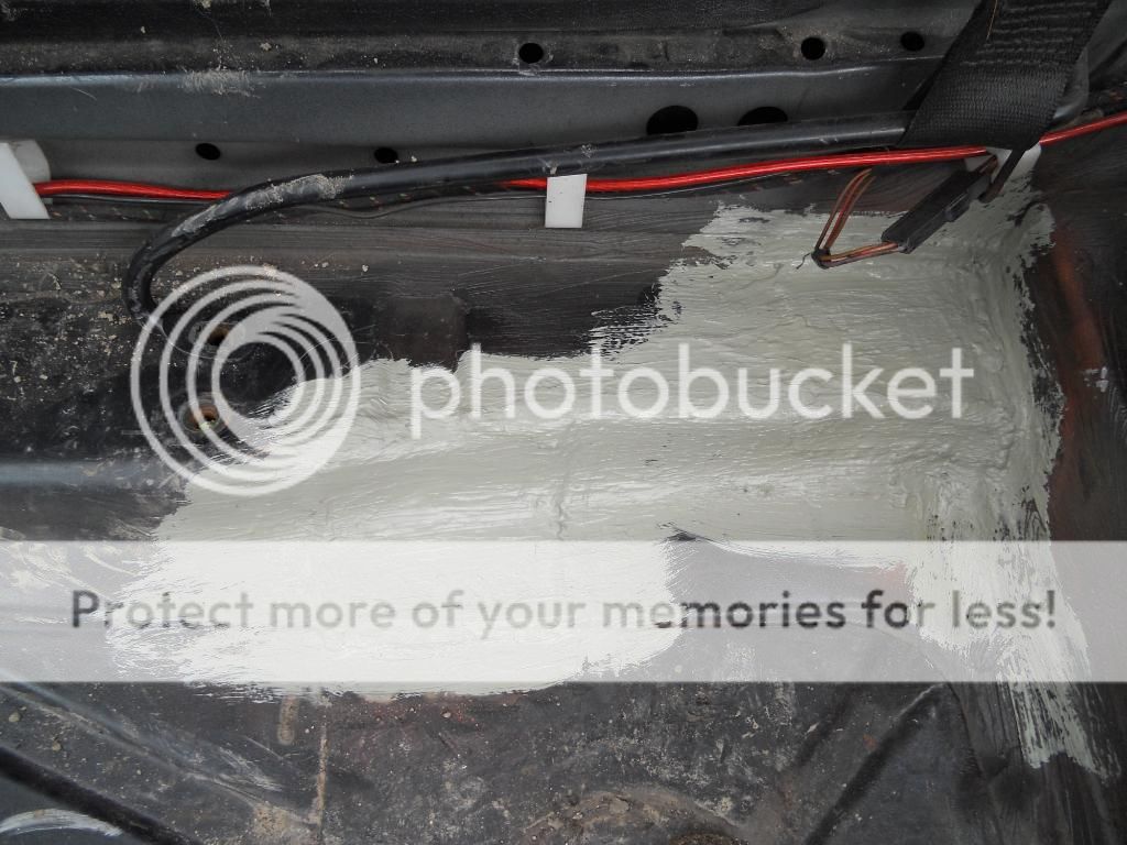

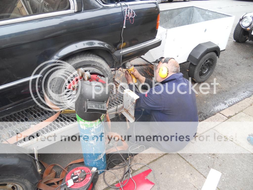

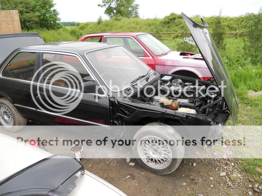

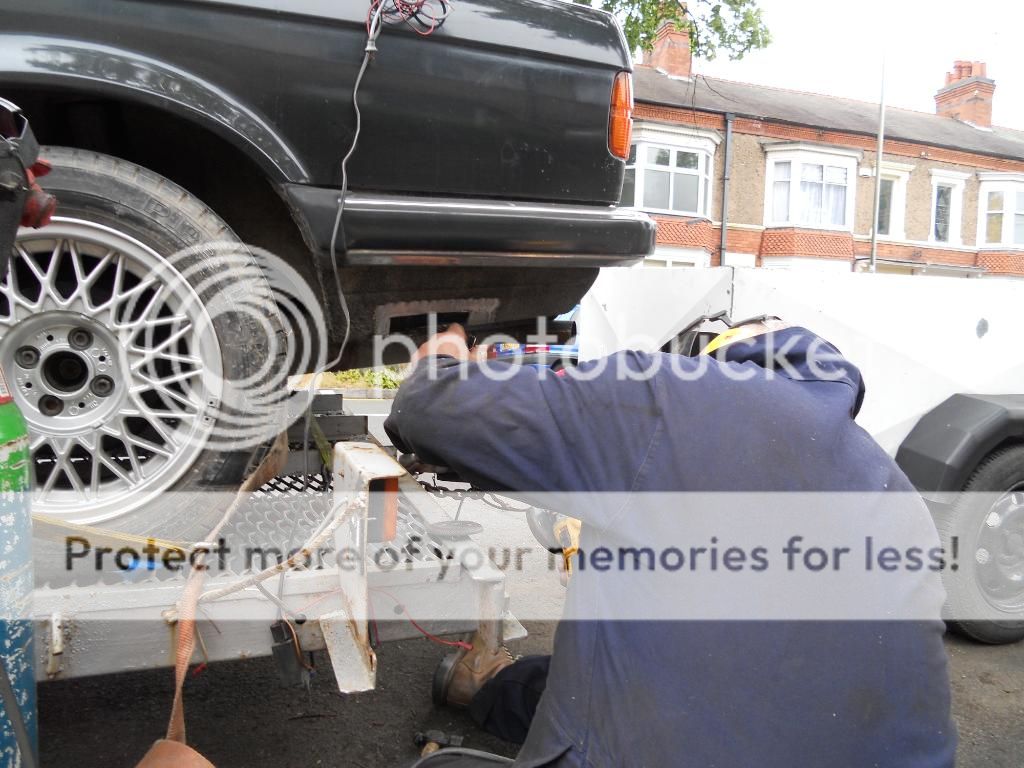

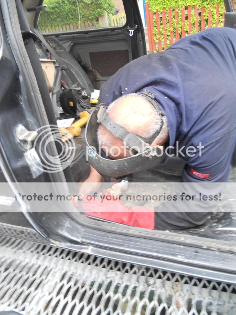

Finally managed to get it off down my dads for a bit of welding. :cool: They're not to the zone standard as the queen wasnt present like with others cars when having work, but we managed alright :D
The welds themself arent all that great to look at, but they're in places you can see any way so I can live with it, if anyone thinks different, I do not mind you paying for this to be done :roll:
On the day of welding, I forgot to get lots of pictures :cry:

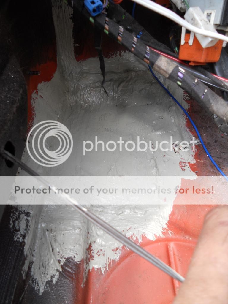

We chopped out what needed chopping and plated over it, then coated it in seam sealer, didnt look great but its done the trick so wont be getting any worse.

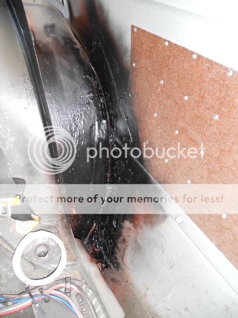

The 2 inner rear arches, we grinded back but they didnt need touching so I treated them with the rust stuff, then coated then in seam sealer. They look terrible, but they're solid, which is all I was concerned about.
Anyway, some pictures...
Ready to go
Getting stuck in...
These are the only ones I got while we were down there
The view from my tea biitch station :?
Now for the uglys :eek:

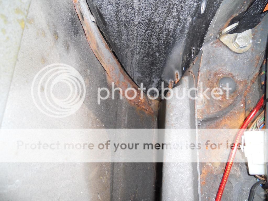

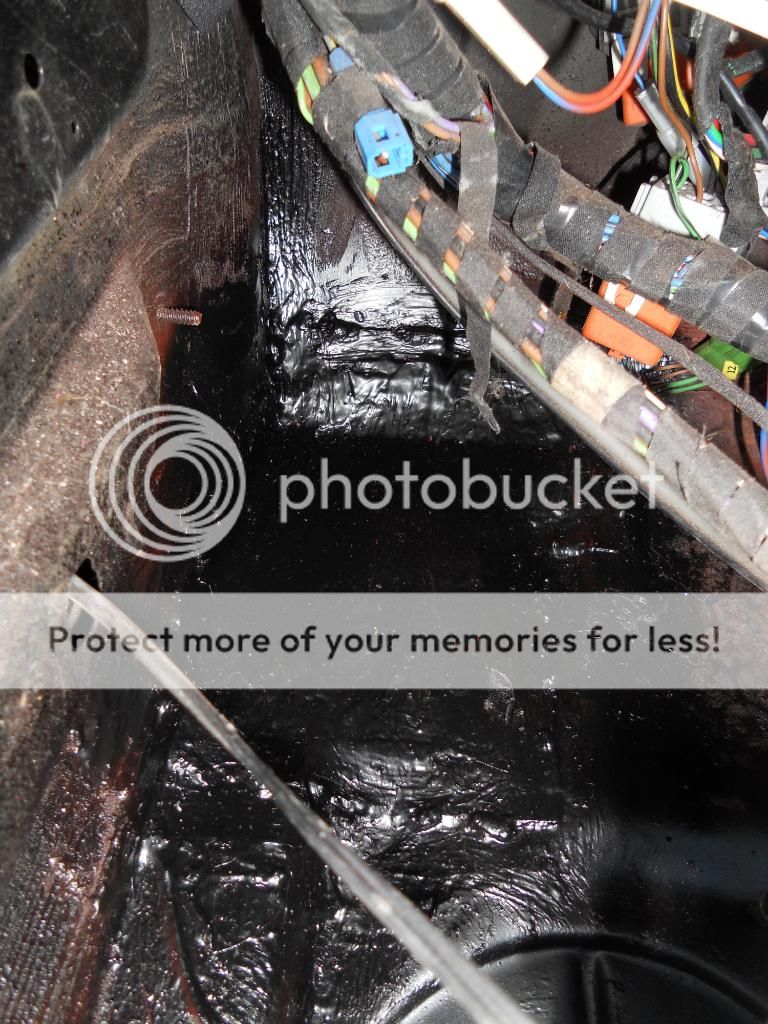

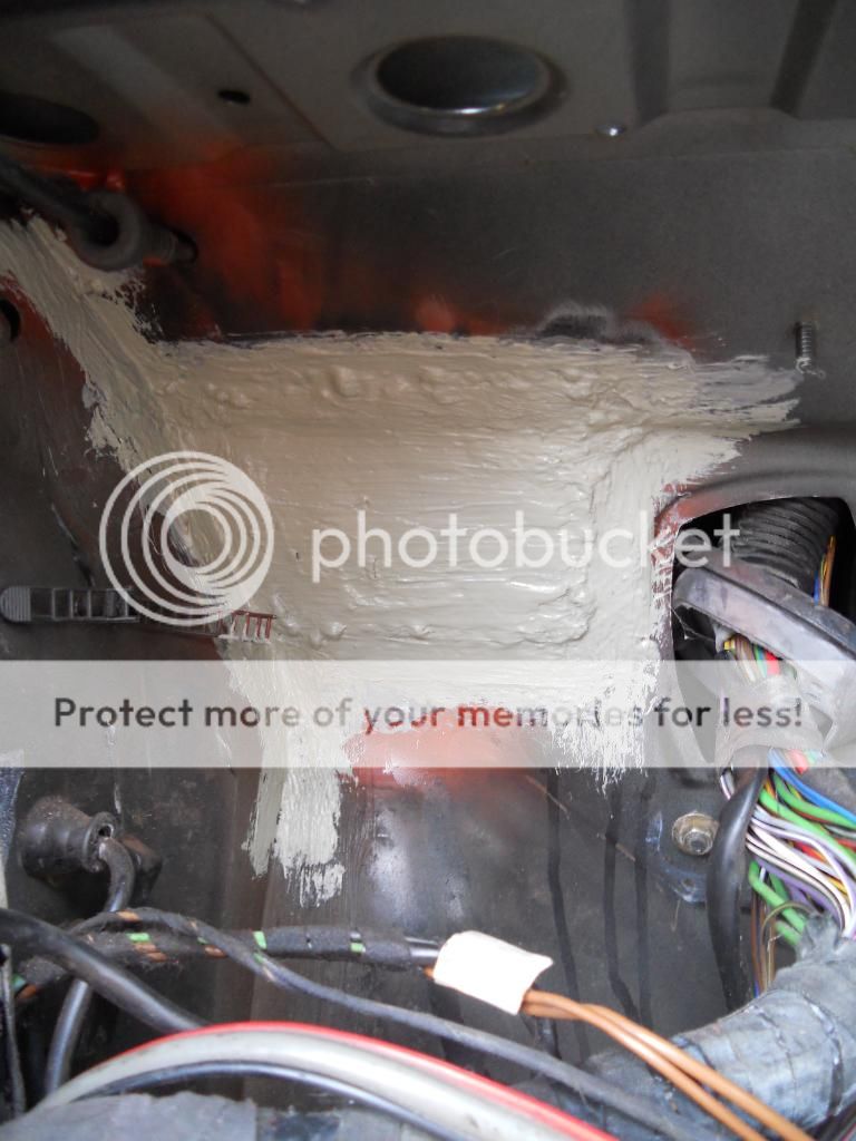

Bulk head... I didnt use metal with the threads on for the loom as this is what rusted last time so I'm gonna figure that part out when I get to it, but im sure it will be ok where it sits once it goes back together
Behind the driver seat
Patch on the floor
Rattle canned up
Caked with seam sealer...

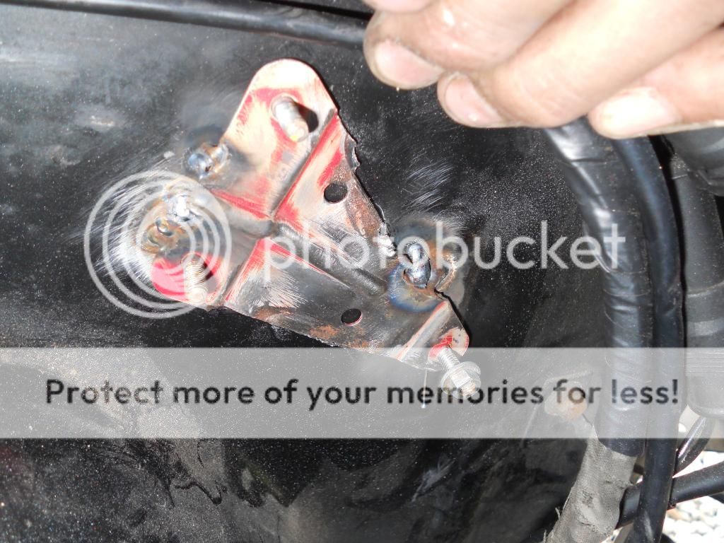

Cruise control bracket welded in too, need to paint it in still

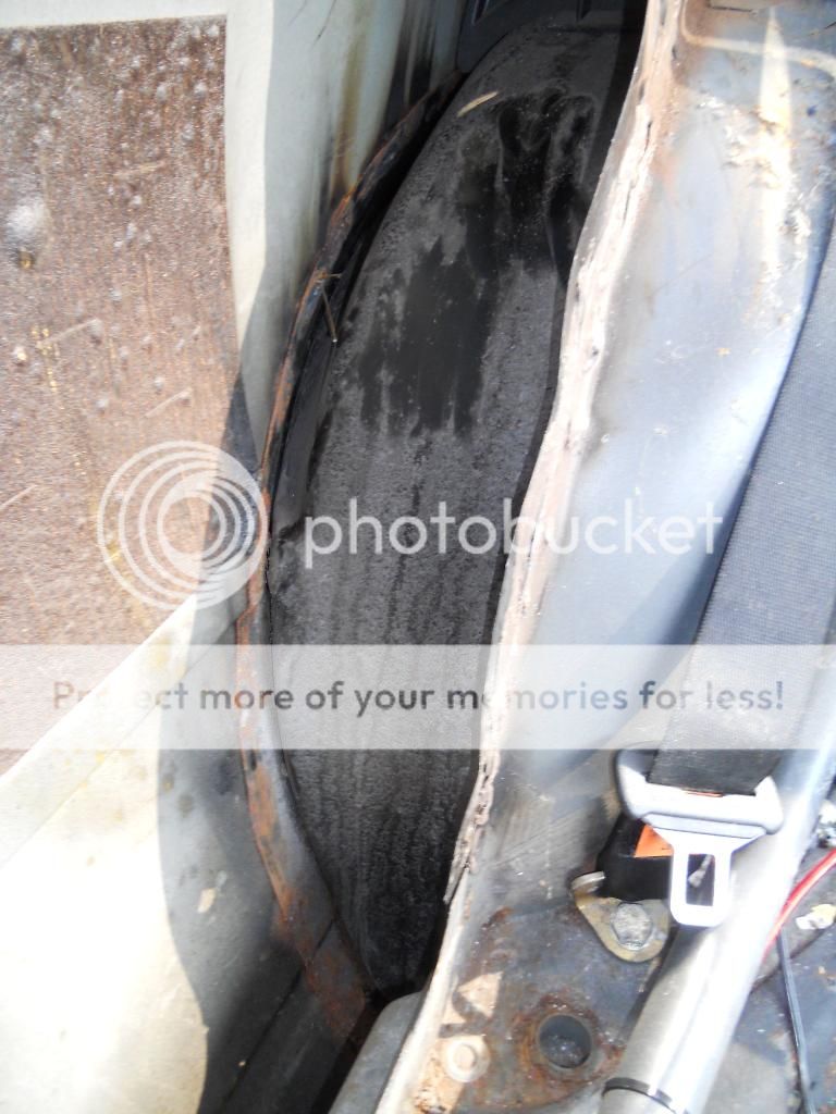

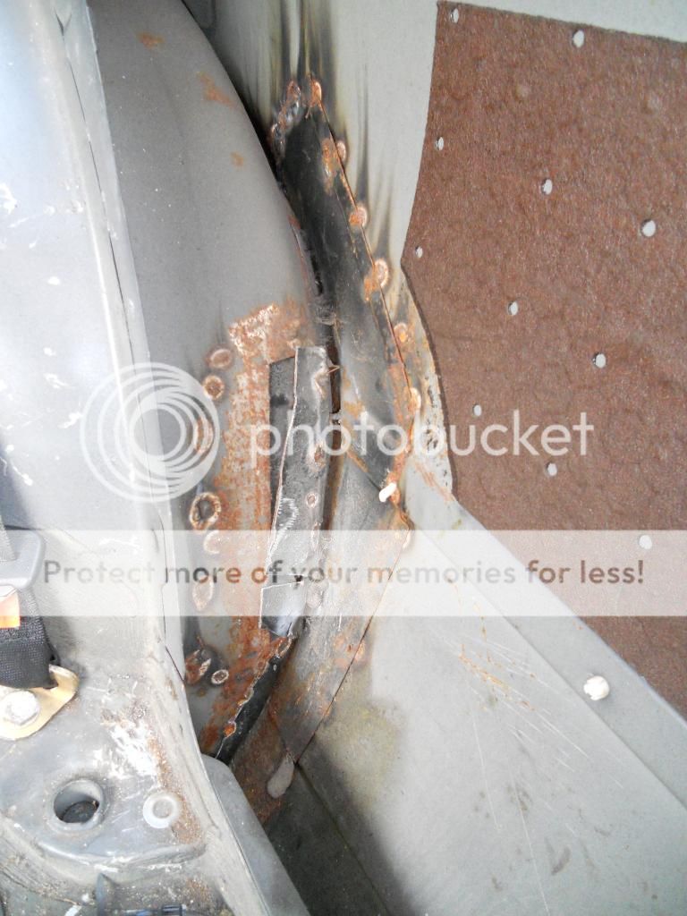

Outer part we chopped and welded, which was the only one we 'seam' welded

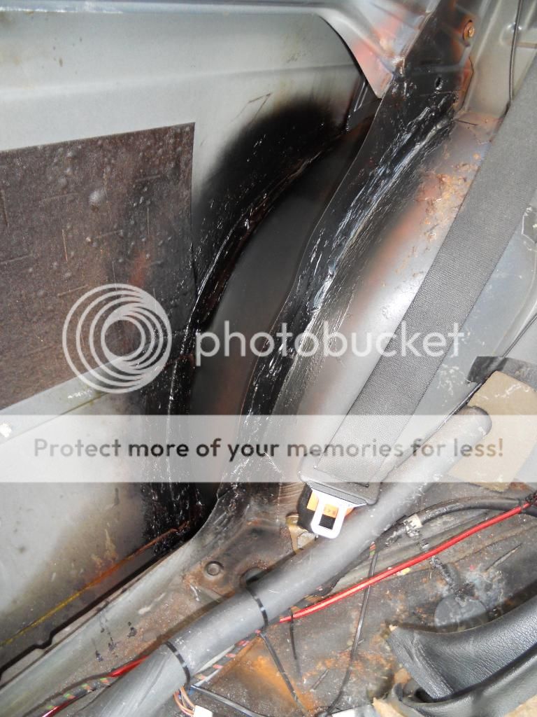

This was the inner part of the arch, which is a fairly big plate that had to go in :cry:

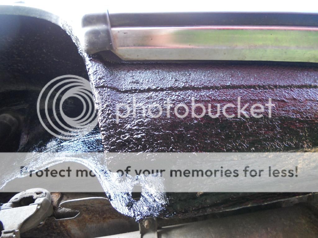

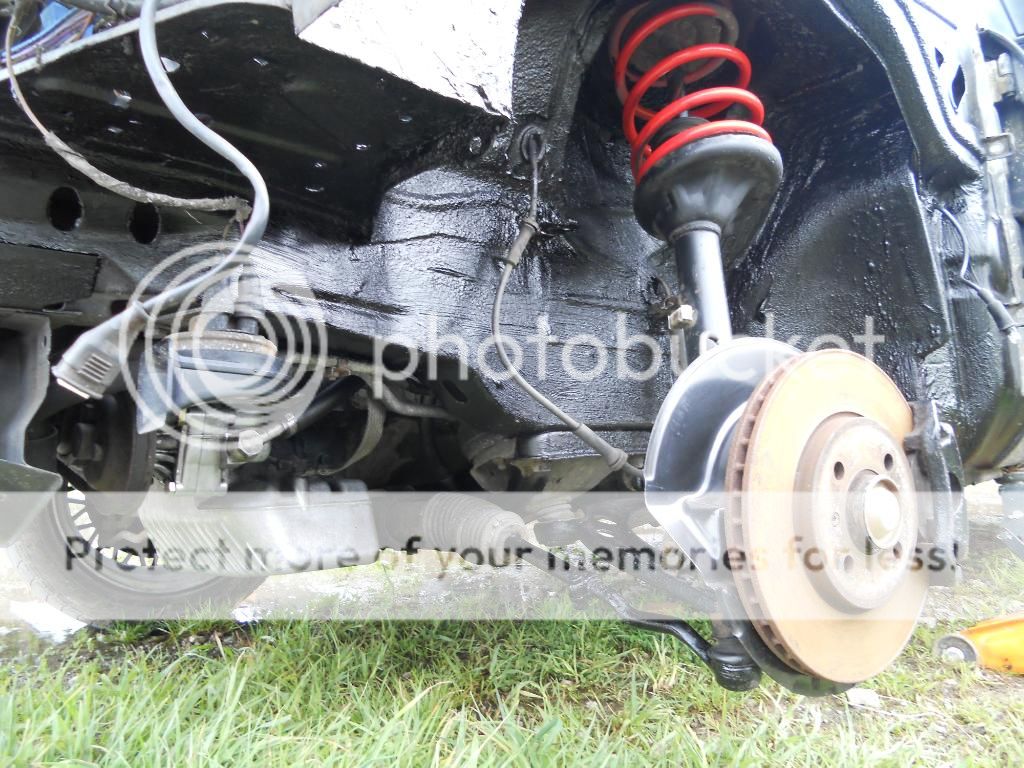

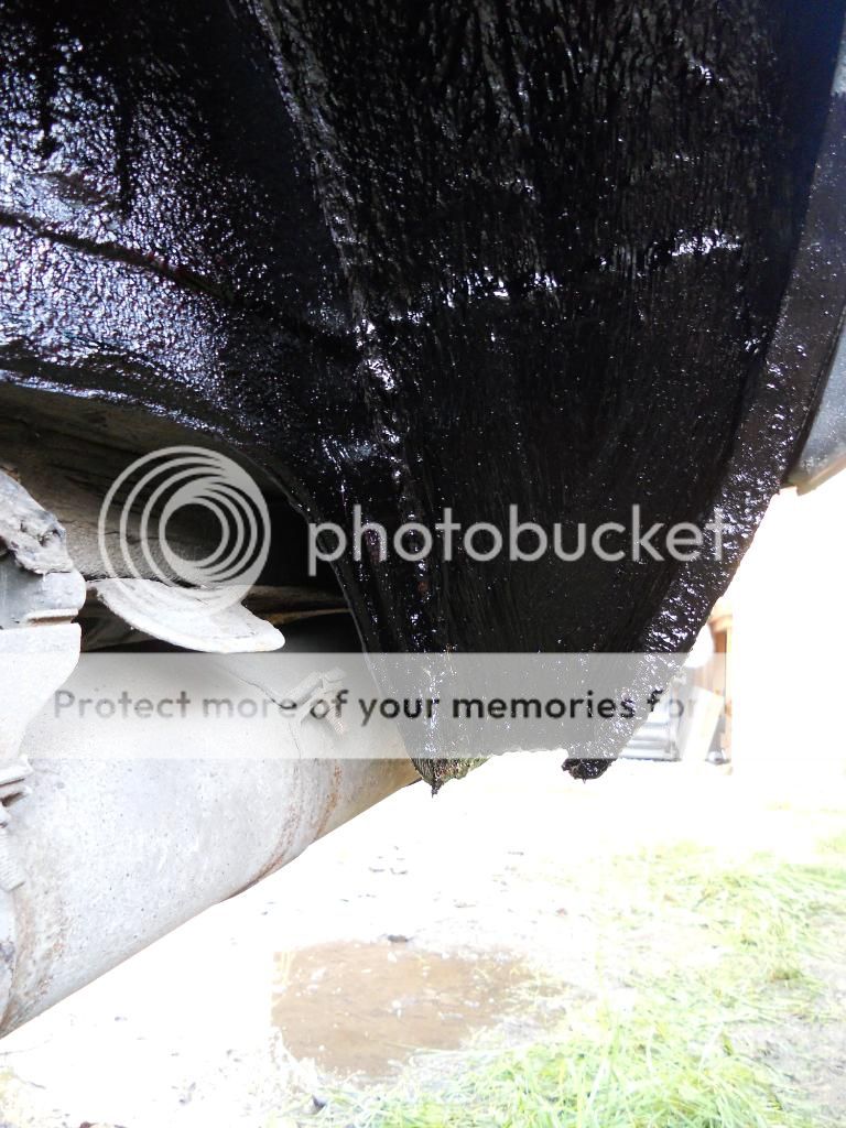

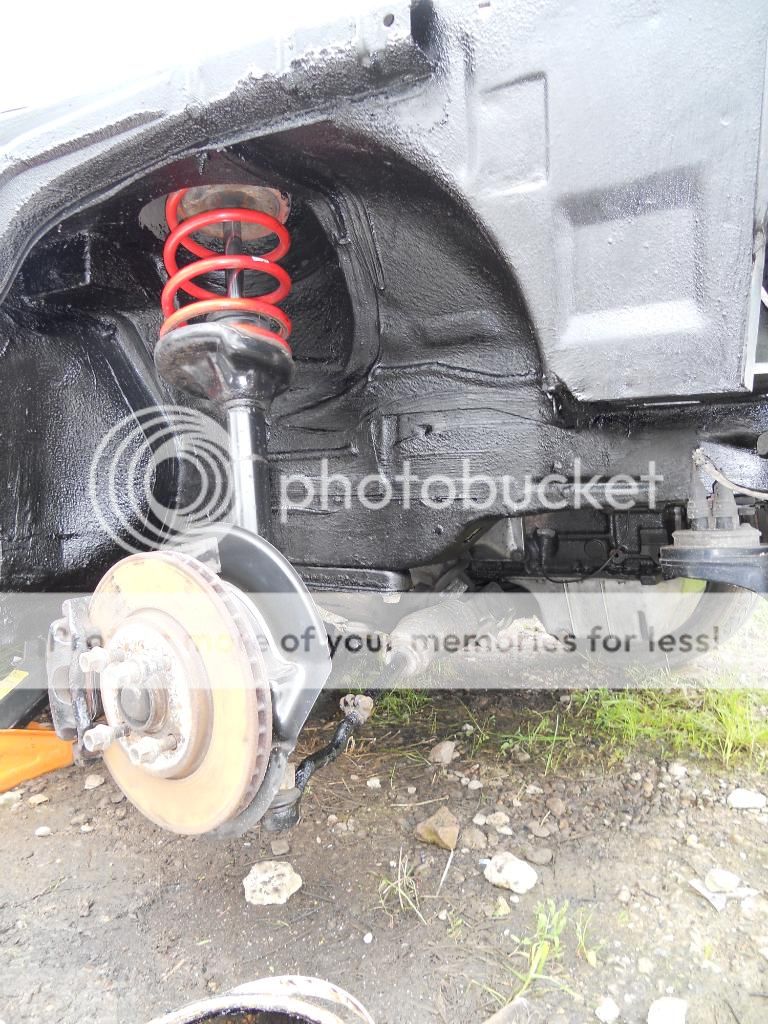

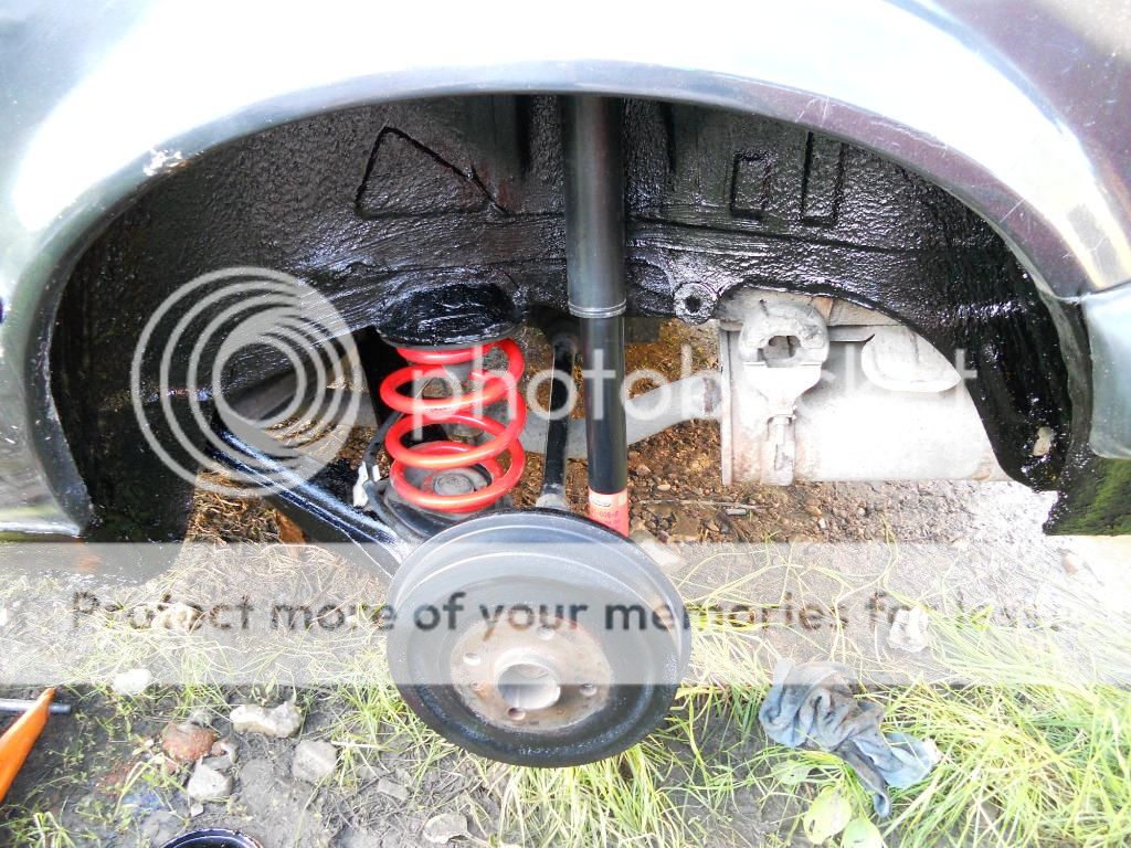

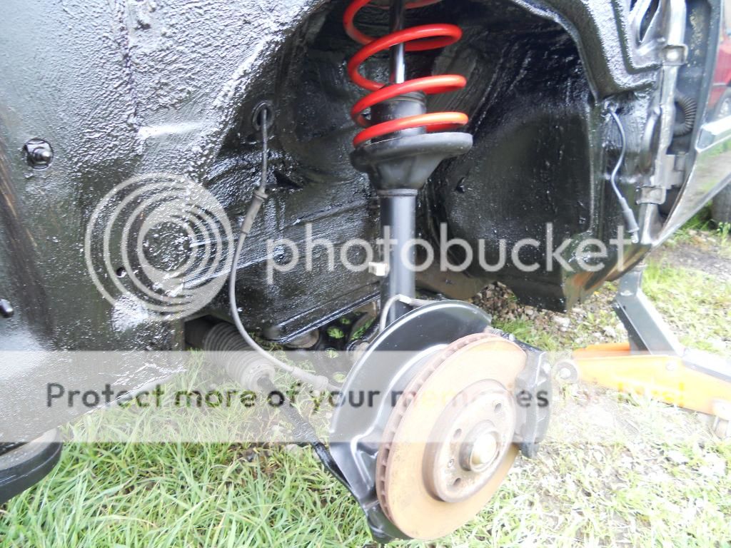

Started undersealing the arches too and gonna get the underside done in the next few days

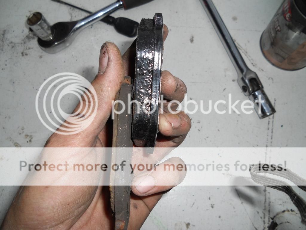

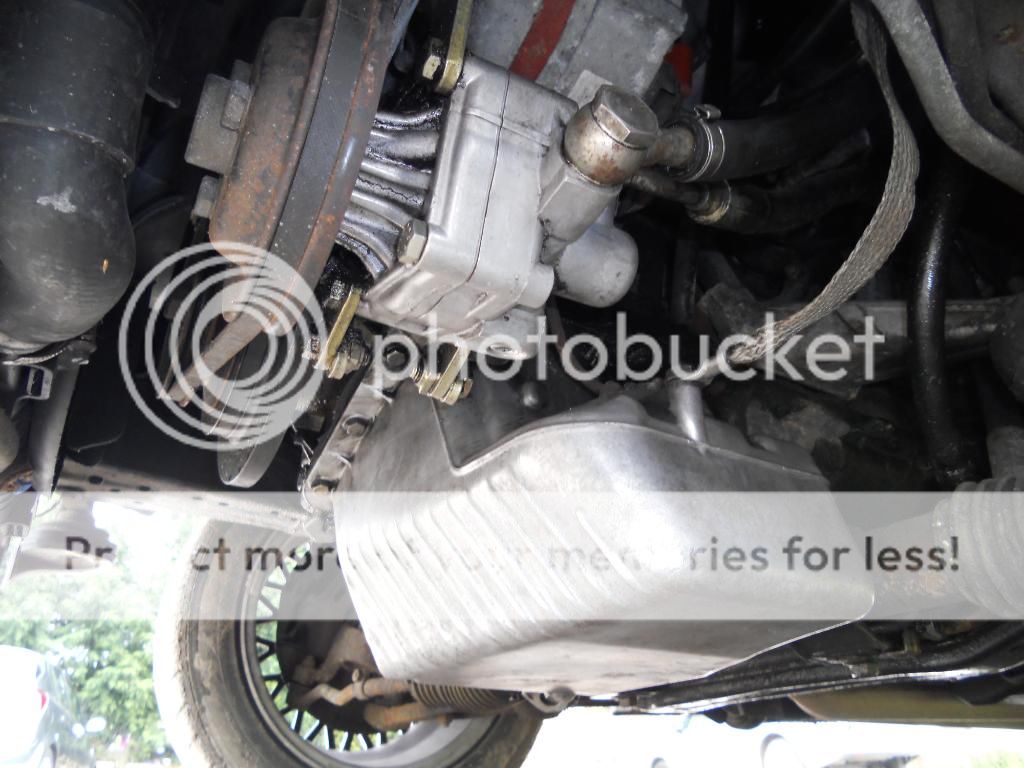

Spotted that the brake pads where a little low 8O
But had some brand new mintex ones in the box that came in a breaker so popped them on
Cleaned the sump a bit too

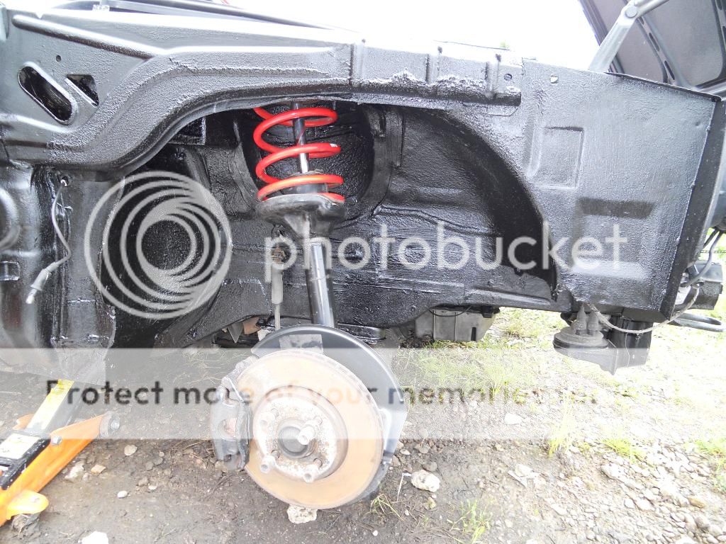

I wire brushed up the insides of both wings and coated the lip in underseal as well just for safe keeping and the bases where caked too.

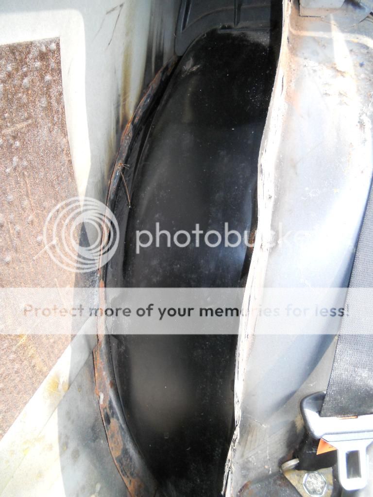

Still need to finish the driver side rear arch as started wire brushing it up a bit more revelled even more scabs which I missed the first time :cry: And I want to change the filler next and the cover thing that sits in there too so got some spares I need to paint up etc before hand.
Also took a good look at the sills too and I think im gonna have to have the driver side replaced completely as its not the best :( But it can wait for now, once it comes off the road next, I shall think about getting some quotes for that.
So, need to finish the rear arch and then get underneath her and underseal her up a bit more, just to make it nice and presentable, as well as start putting everything back in, and retro fit the cruise control.

Good work Jim!!!! :D
I wouldn't worry about the weld not being perfect, so long as the rust has been chopped out that's all that matters, it's not like this is a rare car or a garage queen and like you say, the repairs are in areas that won't be seen.
