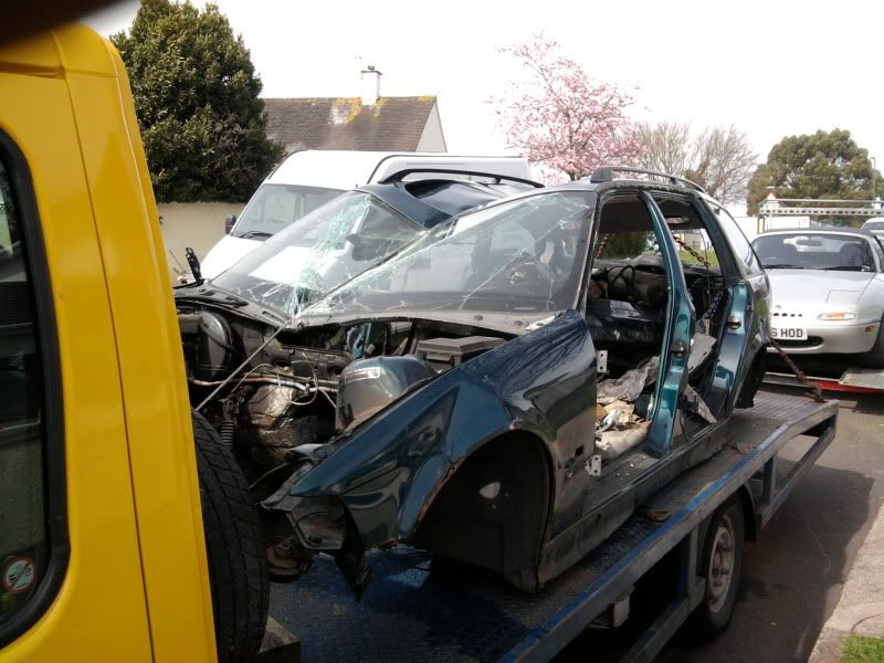

I'm not going to lie... despite the amount of ventilation holes and the buggered rear topmount, the car drove brilliantly on the way home. Lovely and quiet... i would consider buying one with less rust.
Fri Apr 02, 2010 5:27 pm
8) dont give into temptation winkeye

Have you driven an e36 alex? I was really impressed tbh for a £400 car.
Spot the tyre though the arch :?
Pretty much ready to pull out now!
Sat Apr 03, 2010 8:05 pm
That is most definately THE most rustiest E36 i have ever seen! 8O

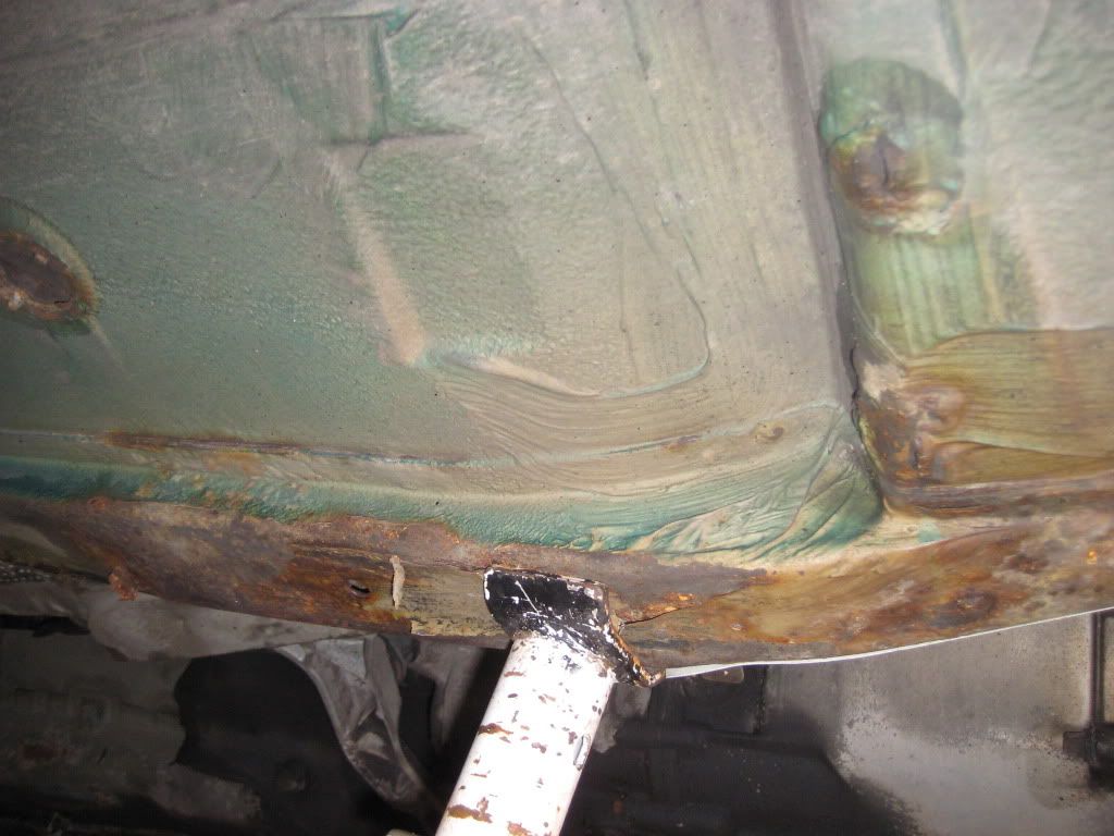

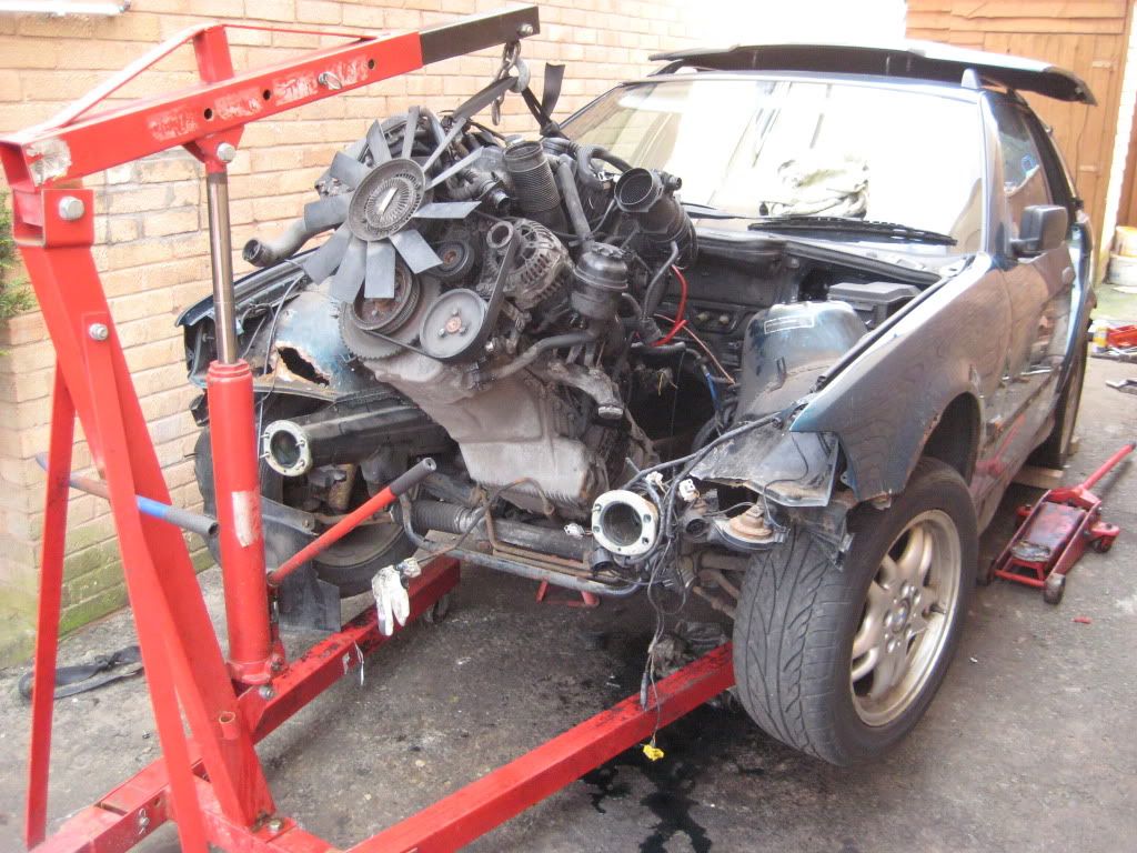

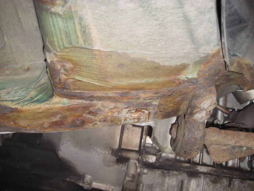

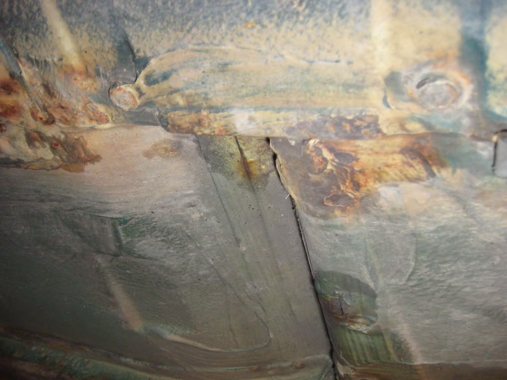

When I was under it today I was shocked.
Front wishbones are actually pure rust and the TCA bushes are dissintegrated.
Floor to sill(at least on O/S) is severly bubbling too and I reckon a little tap with a little tapping stick would see the lot collapse :D
Beggars belief how this thing has kept going through MOT`s as there is no way its rusted so badly in the last year or so!

Mon Apr 05, 2010 6:44 pm

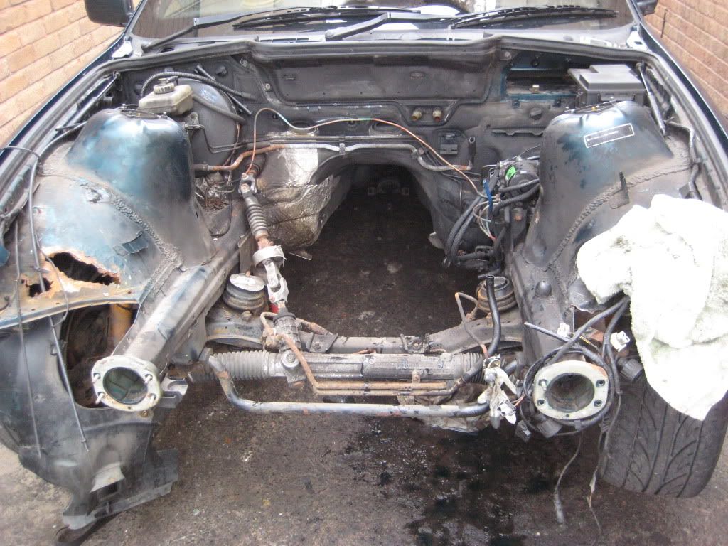

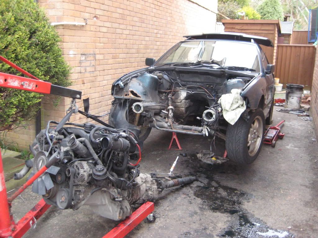

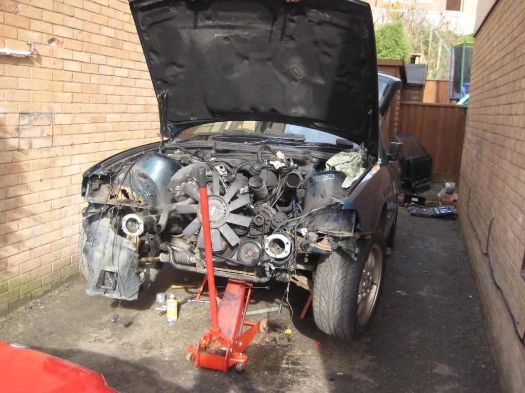

More updates!!
Ive been poking around the suspension and i think its all koni dampers. The rears still have the koni sticker on them.

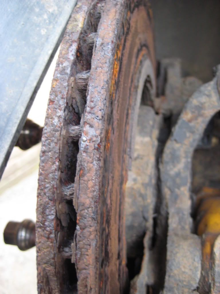

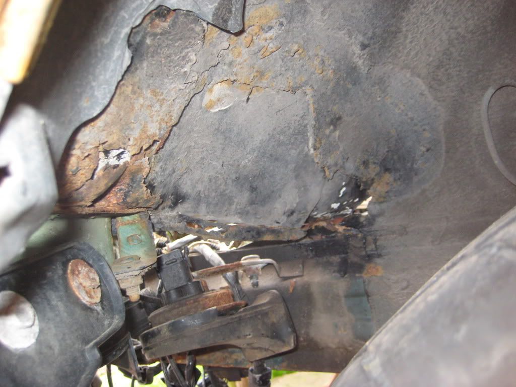

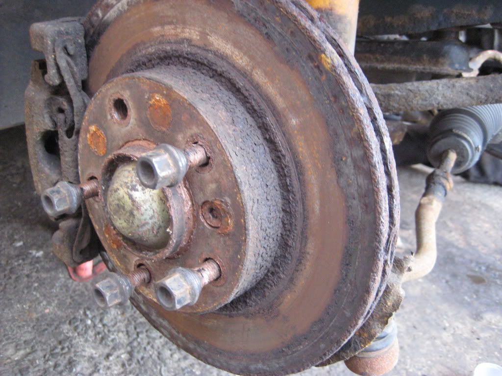

Even the brake discs haven't escaped...
Only just about solid enough for a axle stand...

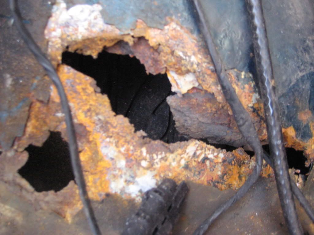

This is behind the plate on the passangerside suspenion strut
Bye bye rustiest e36 ever :wave:

Cool pics Paul :D
Spent 2hrs after youd gone clearing up and cleaning the drive down,feel like death now lol.
Going to crack on getting the compact together over the next few days so might get started on ripping the old lump out before the weekend which will give a good headstart.

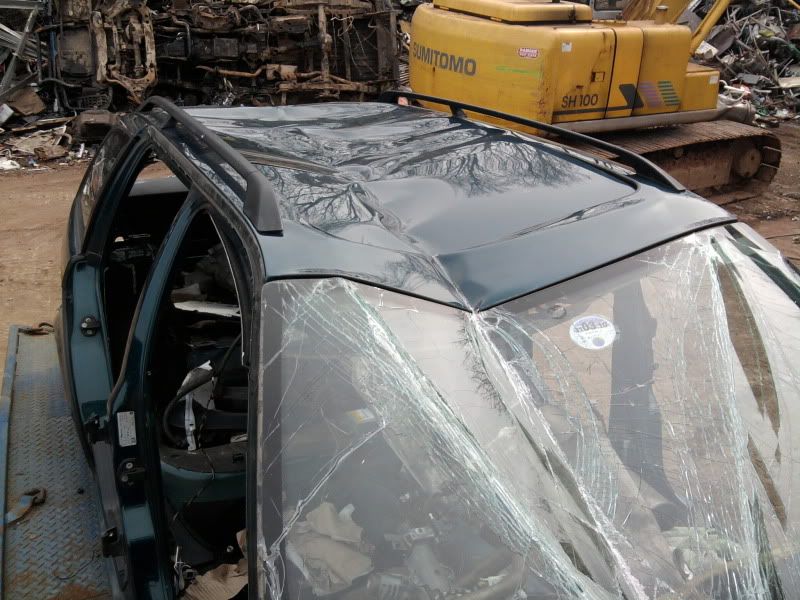

RIP e36 touring :(
After seeing this, i fancy having a decent e36 though

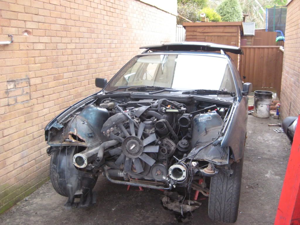

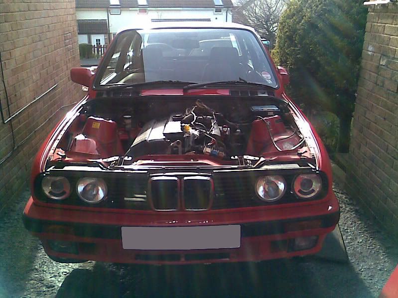

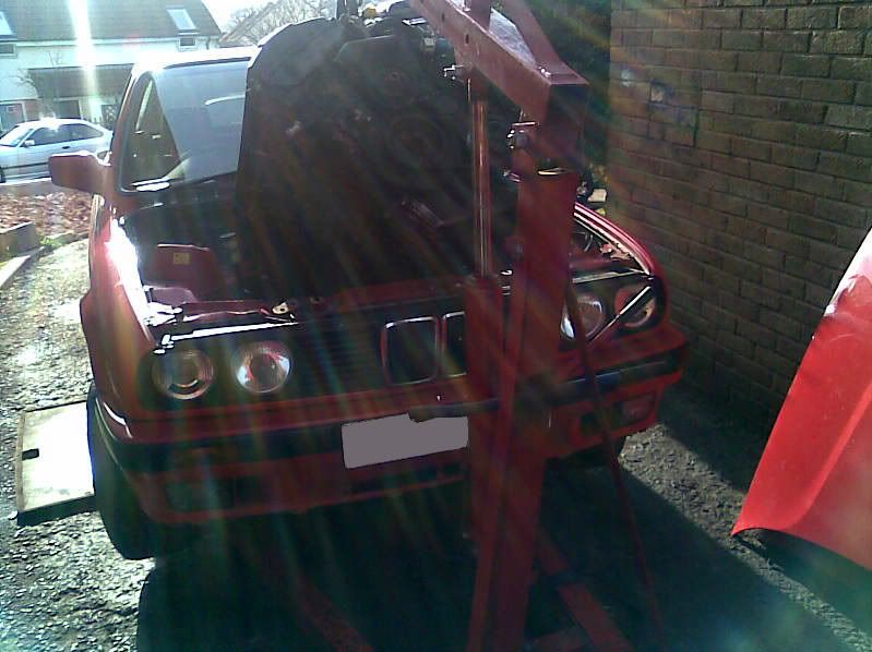

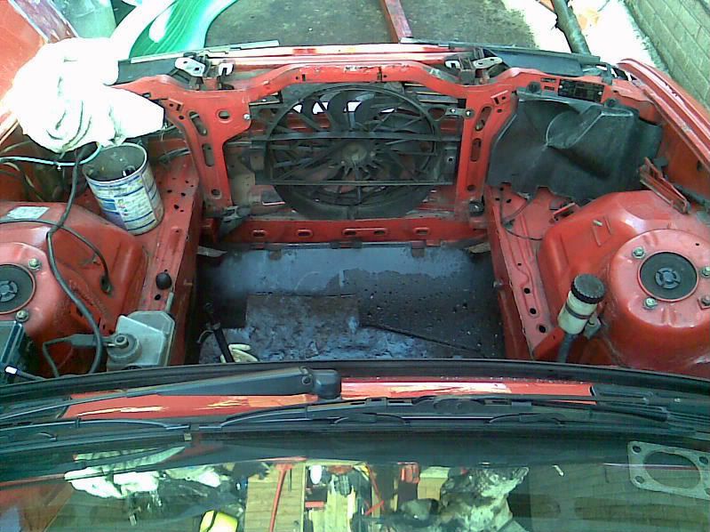

Eko has just sent me these photos... seems like the car has come full circle in 6 months / 12 pages!
Not bad for 2 hours work!

Paul,that bonnet sat on the concrete isnt yours,its the old Compact one :D

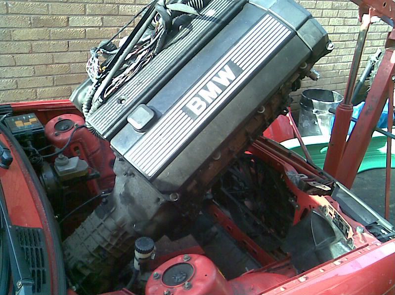

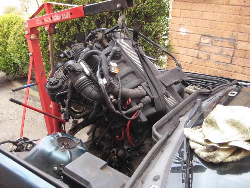

Fri Apr 09, 2010 9:41 pm
Small but major update!
M50 sump/new thermo and Allly housing/waterpump/M20 flywheel and clutch all fitted :D
M52 gearbox bolted back onto engine so all ready to drop in the engine bay in the morning.
Where do I put the pipe coming out of the oil seperator which DID go to the M52 dipstick tube originally?
Cook318IS
Posts: 4587
Location: Torquay
Fri Apr 09, 2010 10:03 pm
Not bad progress tonight then :D
Is this what you mean?
http://www.e3024v.com/board/index.php?topic=51.0
eko
Old timer
Posts: 11531
Location: South Devon
Fri Apr 09, 2010 10:40 pm
Yeah thats the one.
Shit so ive got to get the M50 tube drilled and welded :roll: ............Chris :D
