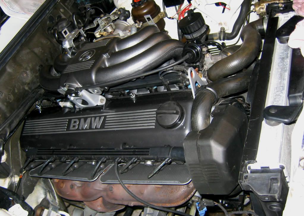

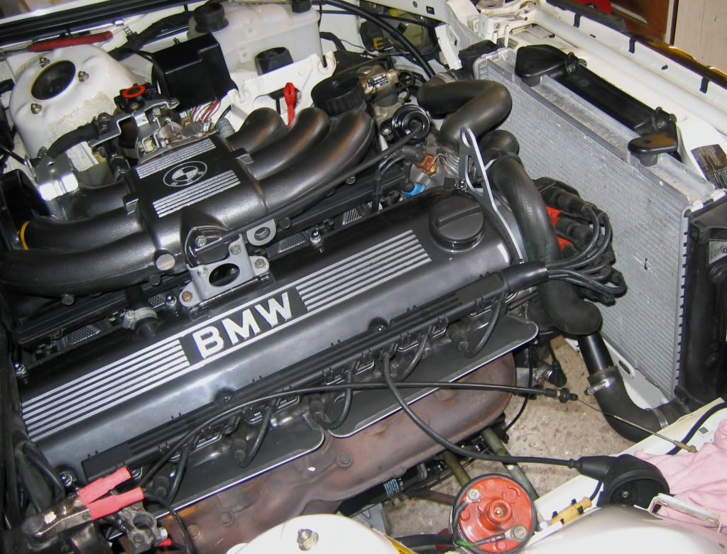

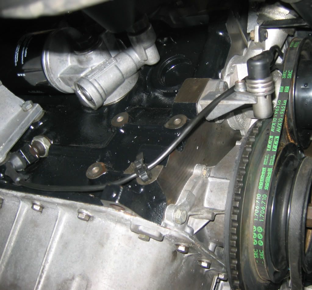

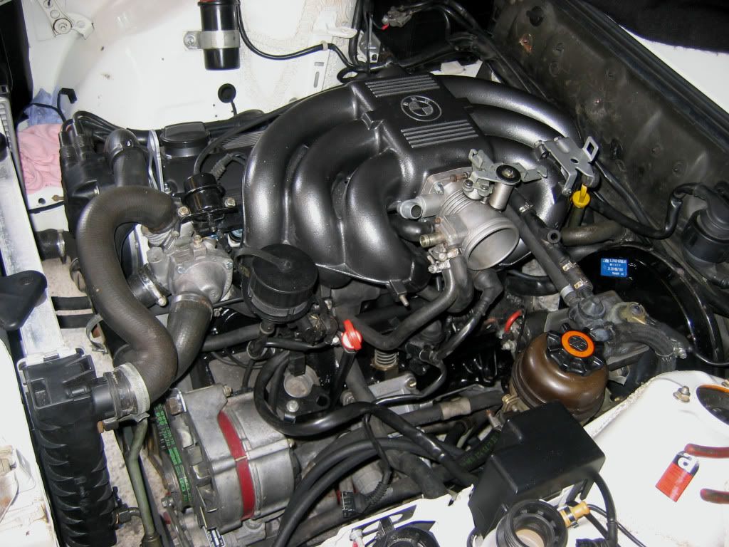

Heres where we are at the moment. All very pretty but pointless if the c*nt won't start!

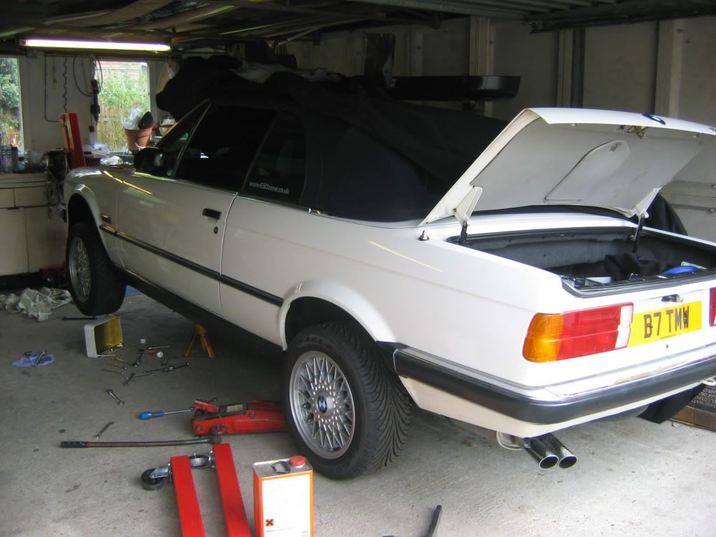

And heres how I left the bitch!
Posts: 15841
Post Sun May 10, 2009 10:21 am
e30topless wrote:might seem like a daft question but did you plug the gearbox wiring in properly from the gear selecter :? that plug could stop it turning over
You're thinking inhibitor? Thought of that as well but I don't reckon you'd get a click. The starter motor is definately seeing power on turning the key. If the inhibitor was the problem, no power would get to the starter?

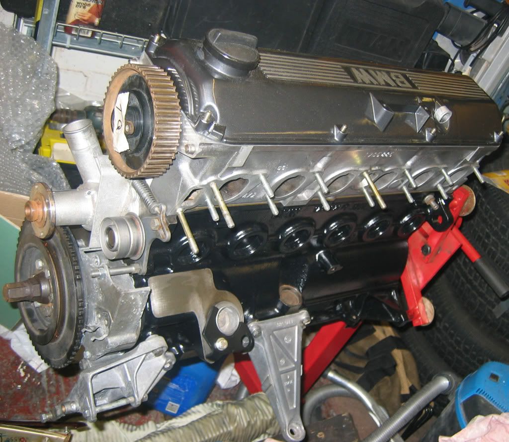

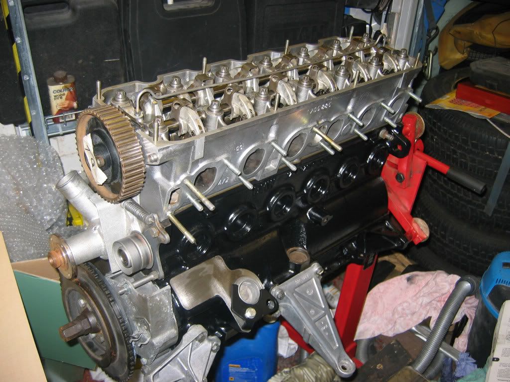

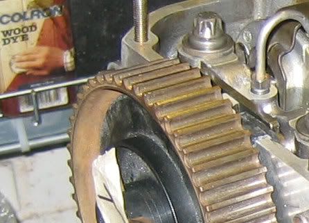

Heres the anomaly of all time!! This shot was taken JUST before the cam cover was put on. The VERY next photo I took is with the cam cover on.
If I crop that photo heres the peice in place.
and heres the very next photo i took! Look at the surroundings. exactly the same as the shot above.
Yet it's not in there now. I'm starting to question my sanity :x :x

The mysterious mystery of the missing cam retaining plate...defo there in your piccie,so where has it gone....
