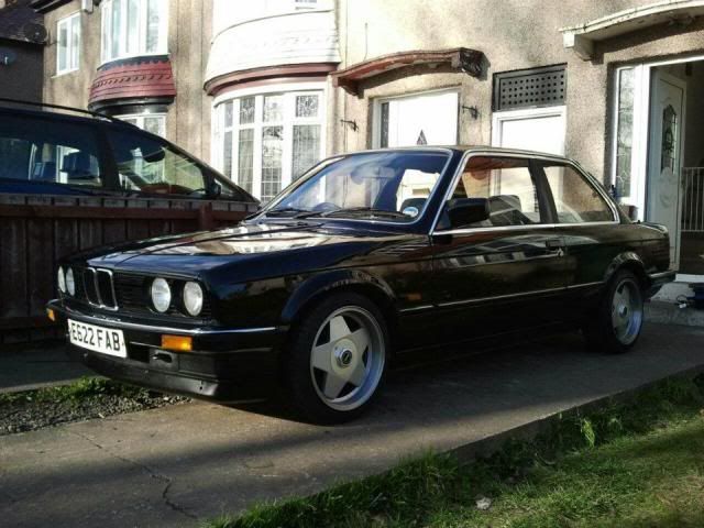

i adore your E30, some brilliant detail work on the engine, well done, what a gorgeous car. I want mine up to this standard at the end of all the hard work, mine's a 2 door chrome bumper too

Yours looks tidy in the picture. Whats your plans with it?

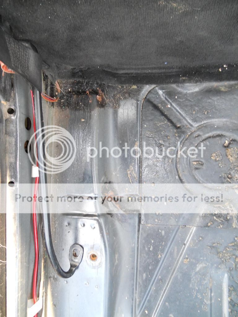

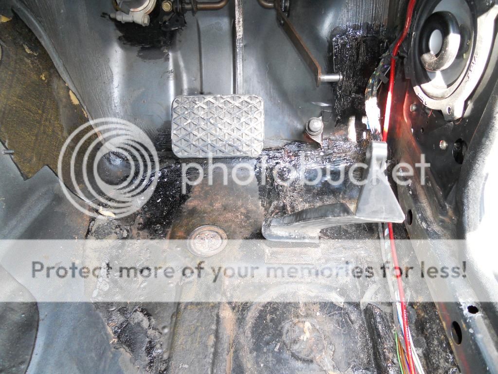

Weathers been crap recently, and the unit has been a mess which has put meoff stripping the interior out but today I thought I'll just crack on and worry about it all later.
Weathers been crap but I made some progress :cool:
First thing was to get the seats & carpet out so I could see what the damage was.
I knew it had previous patch work from when I last took the carpet and noticed it but never really thought much of it...
And small little blemish where someone has landed on something?

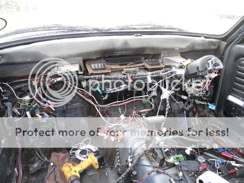

Anyway, I couldnt see the hole I found on the passenger side arch but I could feel it if I poked my finger up... So then attempted to move the loom around, then though, fook it, get the dash out...
Which I could now see the extent after moving/pulling away the bulkhead sound proofing
:cry:
BUT... Its not all that bad :D
Needs cutting out and patching back in so shouldnt be too hard... Would be stupid to just give up because of this hole now, considering its there and accessible :cool:

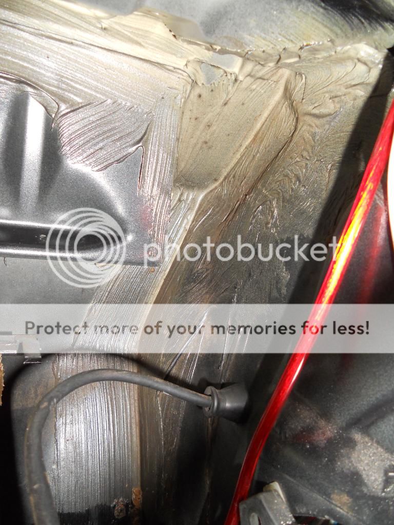

I'm hoping someone who is a bit more clued up on welding can tell me if that loom needs to come out still to weld this area or could it be welded with it in place?
And a quick nosey at the other side
Which made me :D
Think i'm gonna pull the heater matrix while i'm here and just check it out to be safe but everything else looks fine behind there :D

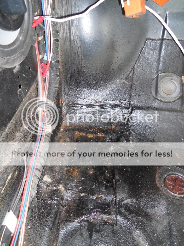

The patch welds to the footwells I might get someone to look at and just double check them to make sure someone hasnt just patched on top of rust as I have no clue about the extent of the previous rust.
In all, its not as bad as I was thinking it would be and it looks pretty fixable...

Plenty of work there still mate, doubt you will have this on the road again this year, that top bulk head rot is more serious than you think, it looks a bit awkward and looks like it creeps on to the next panel....
I would be more concerned about the bit above it where the bonnet catch cable goes through and treating that that area is a real b*stard to get to with any kind of tool!
Before you try and repair any of it, get yourself round them rear arches, the worst bit is where the inner arch meets the inner sill, outer sill and outer arch behind the rear beam bushes.... Also where the rear bumper mounts are at the back of the arch can be hiding a world of pain
Don't give up!!!

Where the bonnet catch goes through, I hit it with a screwdriver to see if it was solid and it was, looks a little worse in the picture than it actually is but I think its treatable...
Nextstage is the rear part just to check it over, hopefully I find what ever might be lurking, but once its all been found its being loaded on to the trailer and off to be welded :cool:
I'm wanting it back on the road for this year so hopefully I can get the welding sorted, then the respray will have to wait :cry: But all depends on what else I find
