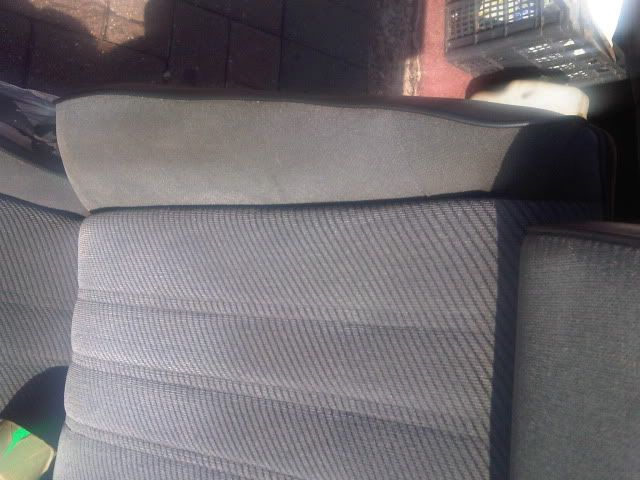

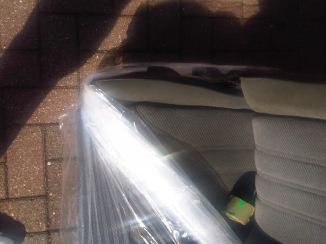

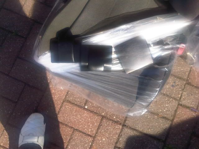

Had a call from the trimmers today to tell me to come and collect my stuff :
Repaired upper bolster - unfortunately there wasnt quite enough grey cloth to make up a full piece so they have had to put a small join in near the top. Its not perfect but I can live with it and its infinately better than the holed material that was there before.
Lower bolster also re-covered.
Both parts also have had new black vinyl outers.
Sunroof motor cover and tailgate hinge covers painted black
Sunroof inner panel - just need to try and find the little holes where the pop-rivets go to put it back in :mad:
And the money-shot 8)

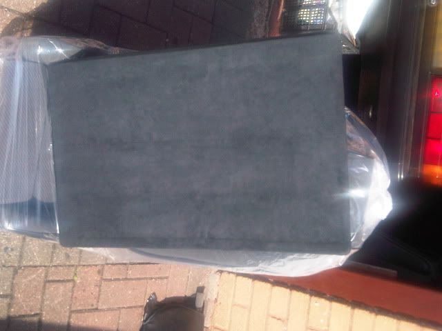

Base board stripped back, new foam backing, top quality black suede.
Very very pleased with the results
It was not cheap - took the trimmer 3 full days to do the seat and the headlining from start to finish - but got a result far better than I could have hoped to achieve :cool:
Now just got to get the fooker back in the car without damaging it :evil:

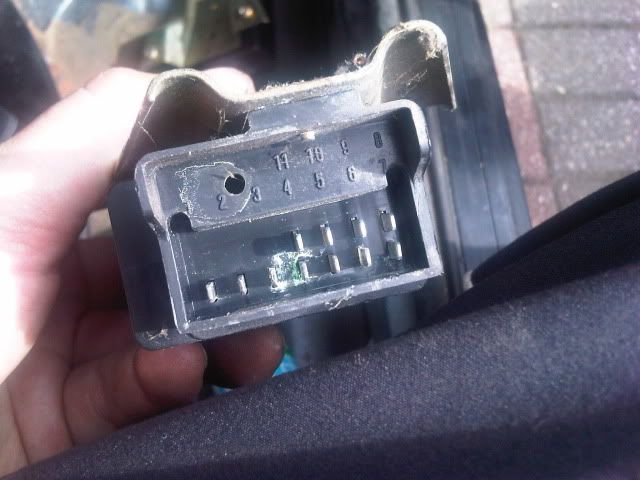

Had forgotten about the central locking - have got the ECU from the chrome turd to swap over for starters.
Thu Sep 01, 2011 9:41 pm
After taking the doors off I can pretty much guarantee it will be corroded wires/connections.
Module could do with being taken out for waxoil duties anyway, ive got a portable compressor you can borrow if you need to

Fished out the central locking ECU - central locking has never worked at all since I bought the car.
You can see 1 pin has corrosion fur on it.
Swapped it for the spare ECU from the bronze turd and it came to life :D
Unfortunately not working 100% - From the drivers door it locks & unlocks both front doors, drivers rear door and tailgate. Passenger rear door lock does nothing at all.
Lock/unlock also works from the tailgate lock but Not from the passenger door lock.
Needs further investigation but I have spare motors so should be able to sort it.

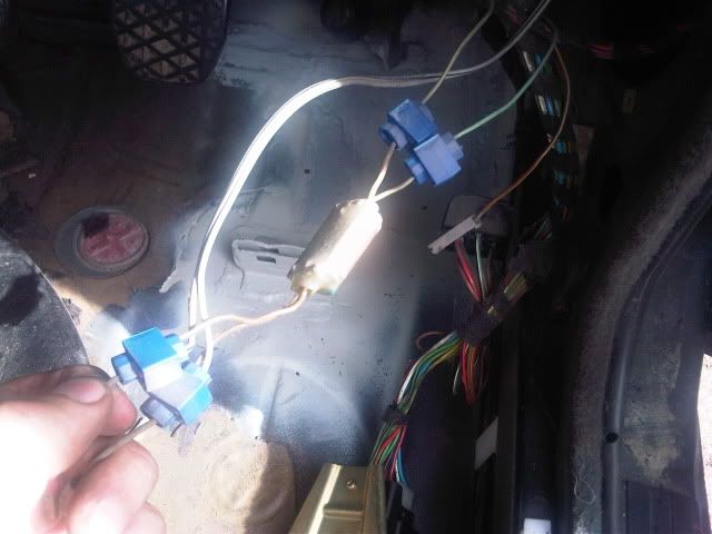

Seems to be plenty of plugs not connected to anything :mad: - Anyone know what these are for ?

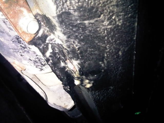

Any visible rust underneath is getting a couple of coats of jenolite followed by a couple of coats of black smoothrite finished off with a smothering of waxoyl.

The big plug is for the interior light delay relay.

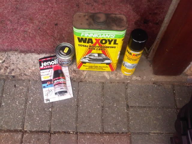

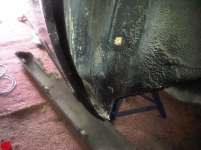

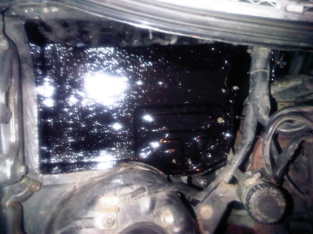

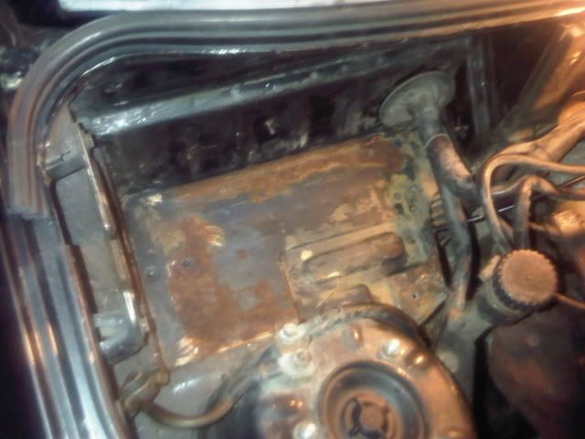

Bit of rust-prevention action today :
Before
After
Underside of batter tray just in case :
Wire brushed the scabby bits of the wing and put a bit on there too - it will do until I can afford to get it painted
This is a bit fooked - wire brushed it and painted but its still not great - It will do until I can find a better one :
The never-ending tin - realised I bought this in 2001 to paint the battery tray in my XR3i 8O

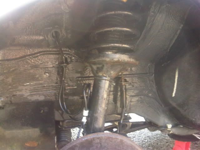

Also fixed the uneven ride height at the back - drivers side spring wasn't seated properly on the trailing arm rubber pad :D

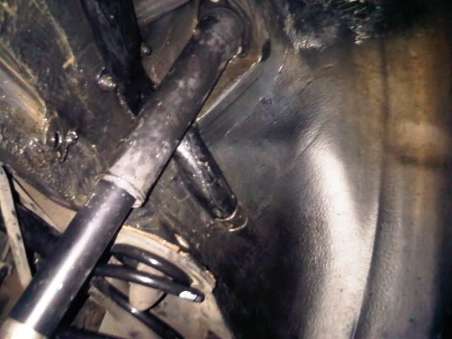

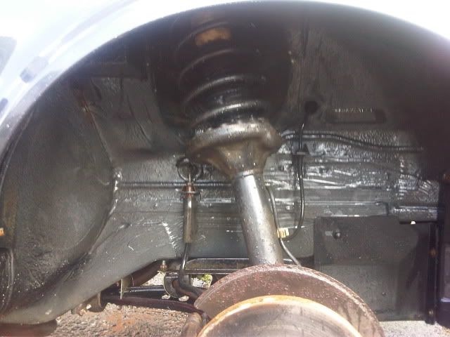

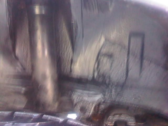

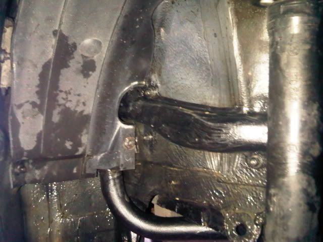

Full on Waxoyl mode today :
Did the whole innner arch with by brush rather than spraying it on - really well covered now.
Put the Filler nech back in properly, waxoyled it, copper grease on the threads of all the securing screws and then waxoyl over the top ( not that I plan on taking it apart again anytime soon )
Also done the sills - painted the jacking points with smoothrite and then made sure they got an extra thick covering of waxoyl as they are the only exposed bit when the skirts are back on.
Done the drivers side front inner arch too - brushed as far as I could and used an aerosol to soak any bits I couldnt reach with the brush.
Took longer than expected but feels good to have one side done :D
