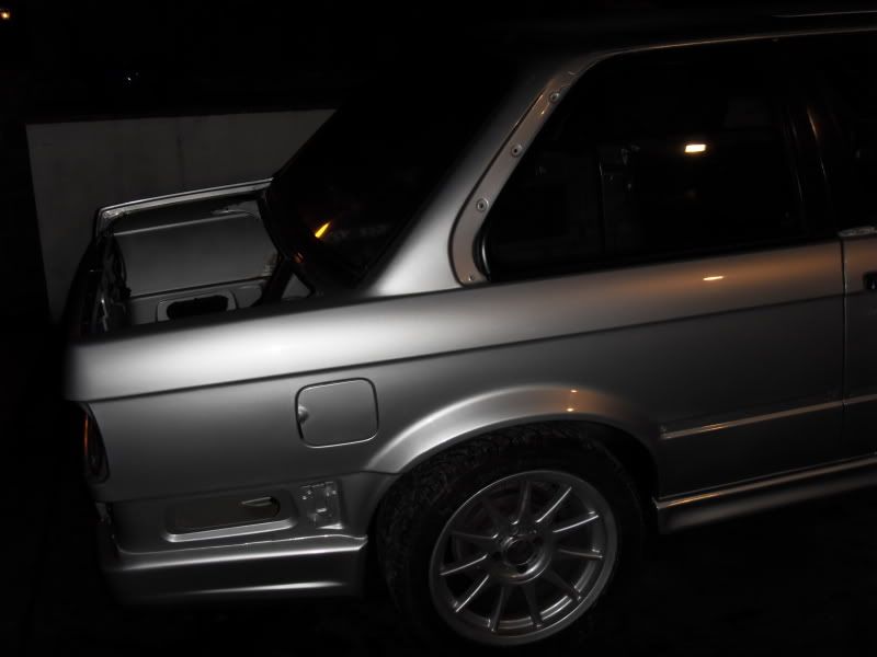

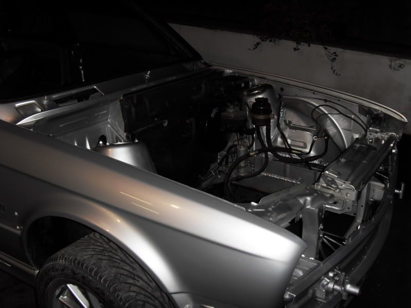

what a night, problems with car trailer, no electrics :mad:
didn't finish work until 7, by the time i got it to my garage it was pitch black.
it has to stay outside for tonight, so i fitted all the windows and put a car cover over it, trouble is i am so busy with work it will be next week before i can get a start on it :(
tony the painter has really pulled it off with an amazing job

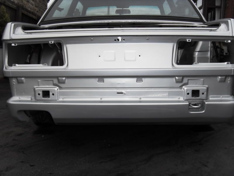

managed to get a few snaps ! :)

someone robbed the boot and bonnet lol :D

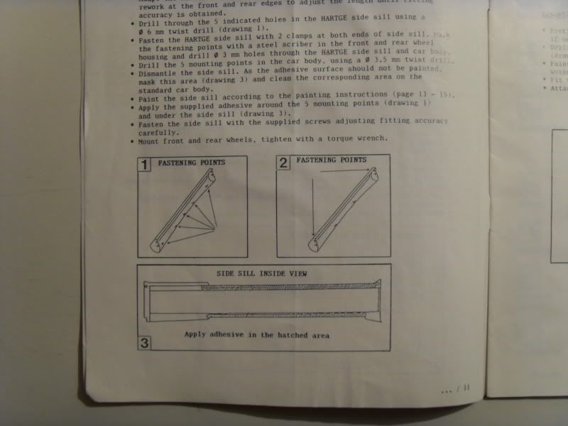

P.s did you get your sideskirts swapped round?
thanks :)

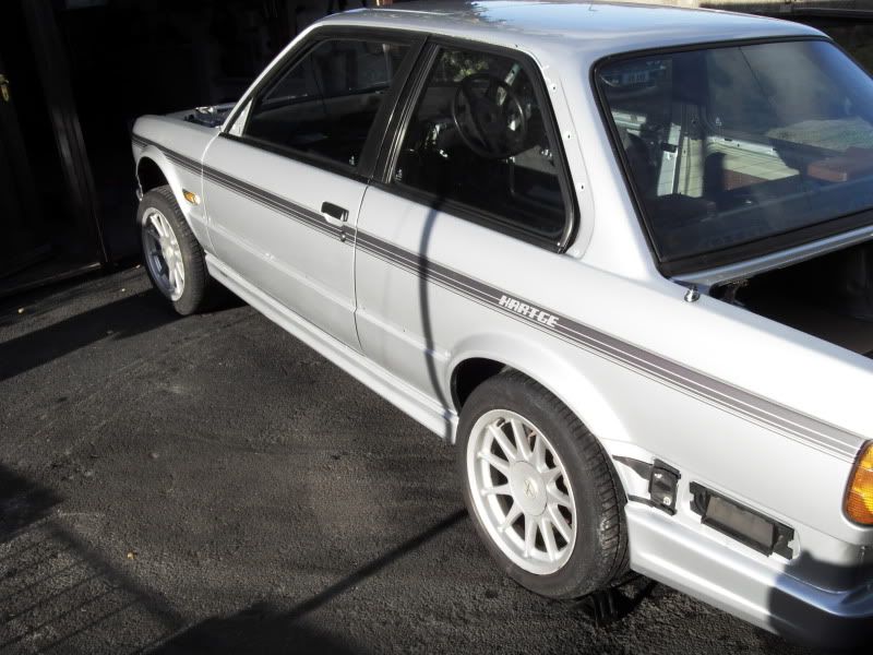

I already have the stripes they will go on this sunday if the rain stops !
the sideskirts are on with tigerseal and won't be coming off without a huge fight !! so i will leave them like that.
I fitted them that way because the original car came like that and all the pics I have of facelift cars have the badge on the front, but there is nothing in the fitting instructions about this , ?
I think it looks right and the shape of the skirts seem to flow ?

I followed the Hartge bodykit instructions I have, very very carefully
which looks like this,
not sure if it's right or wrong but they look great !

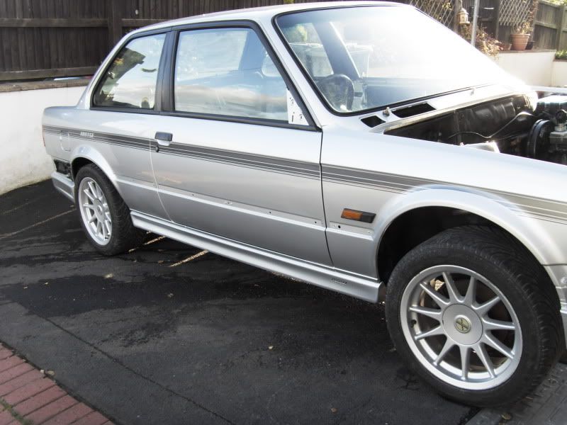

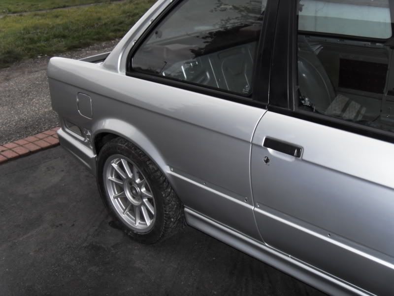

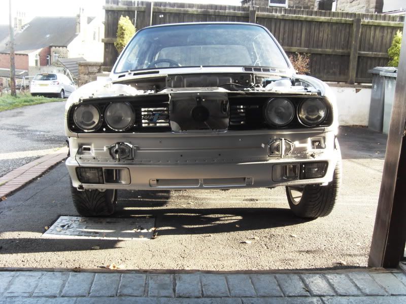

todays fiddling, had to work but got home in time for an hours messing before it got dark :D managed to fit a few bits of trim,
tommorow I will attack the wiring, something I hate but it needs to be done :(

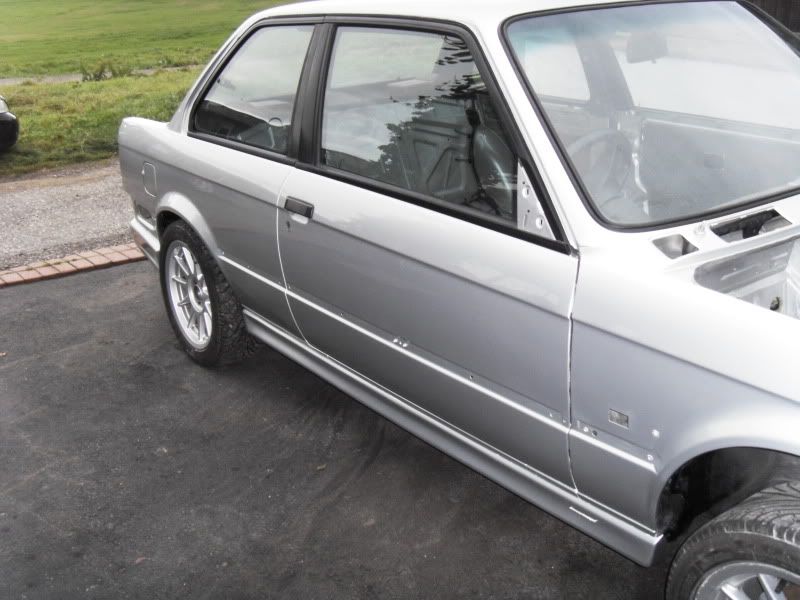

anyway here's a few pics of todays council activities :)
lights and wiring done

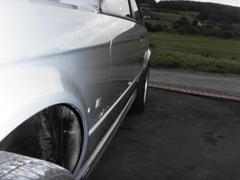

Hartge stripes fitted,
what a biatch to fit/get straight but worth it :D

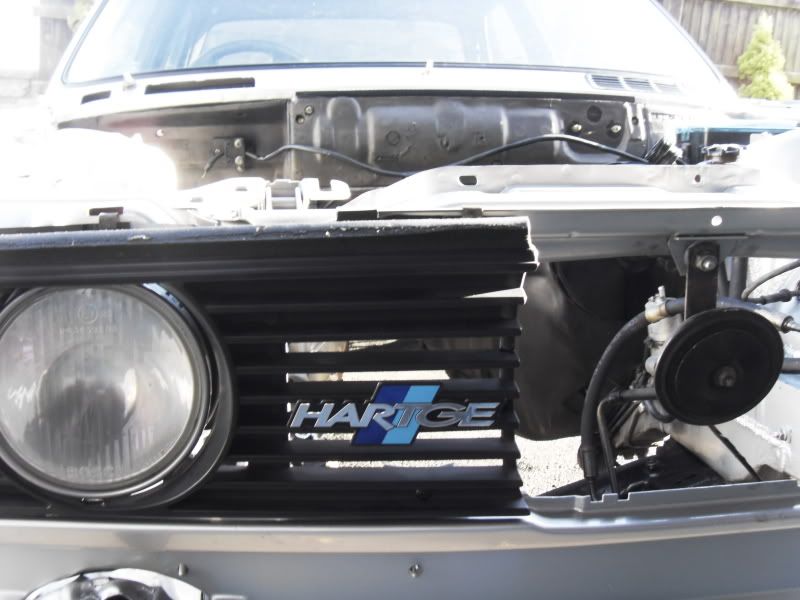

I put a new hartge badge on the grille not too sure on this,I have the old one but it's not the best condition,
and managed to get it in the Garage I should sleep better tonight :wink:
