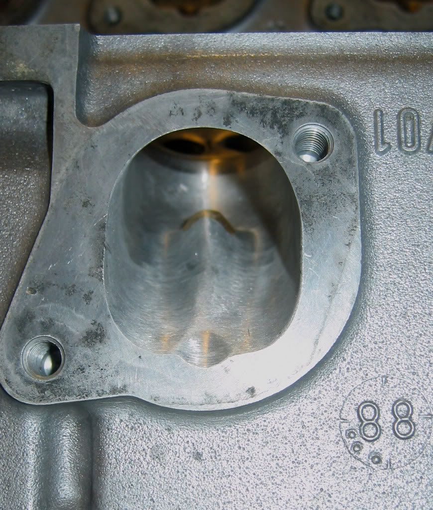

1st up we have the inlet port on the original C2 2.7 head.
And heres the 2.5 heads inlet after the man from horsham fiddled with it. They appear to have taken more meat away either side of the valve guide mount.

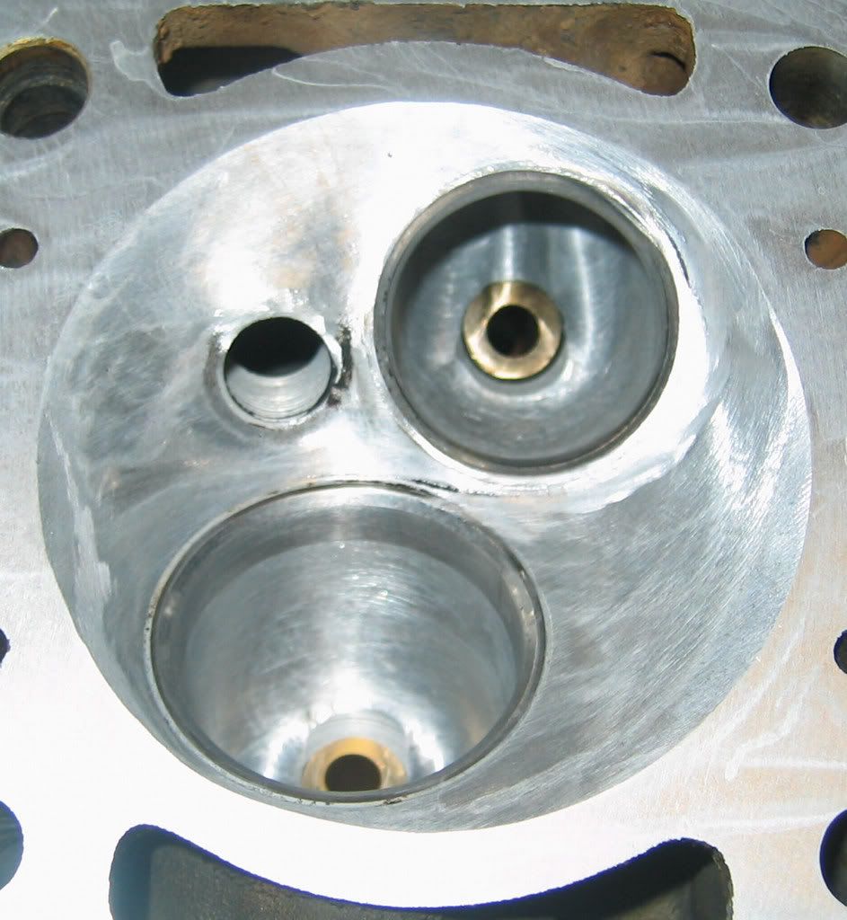

Original C2 2.7 combustion chamber
And the reworked 2.5's
Uncanny ain't it?
As a reference, heres a standard 2.5 chamber to compare
Exhaust ports appear to have been left as was bar a slight clean up. As we discovered before the exhaust ports on the C2 head were perfectly round almost gasket matched.
Personally I reckon this is as close you're gonna get to an original C2 head.

Thats pretty serious.
Nice finish on the ports, are you going to use standard pistons with those chambers?

SUMPCRACKER wrote:Thats pretty serious.
This head is for the Alpina bottom end/pistons isnt it? :?
Posts: 15846
Post Wed Mar 11, 2009 5:30 pm
Yeah. It it will run the custom mahle alpina slugs.
Post Wed Mar 11, 2009 6:41 pm
which have an upped CR to make up for the meat removed from the chambers

^Yes thats what i was worried about, an extra 20ish cc in the head is going to drop the compression quite a bit.
Post Thu Mar 12, 2009 10:47 pm
pina slugs are 9.7 so the CR is in the rightish area for some power.

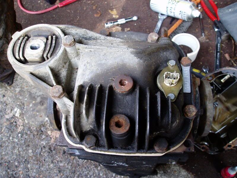

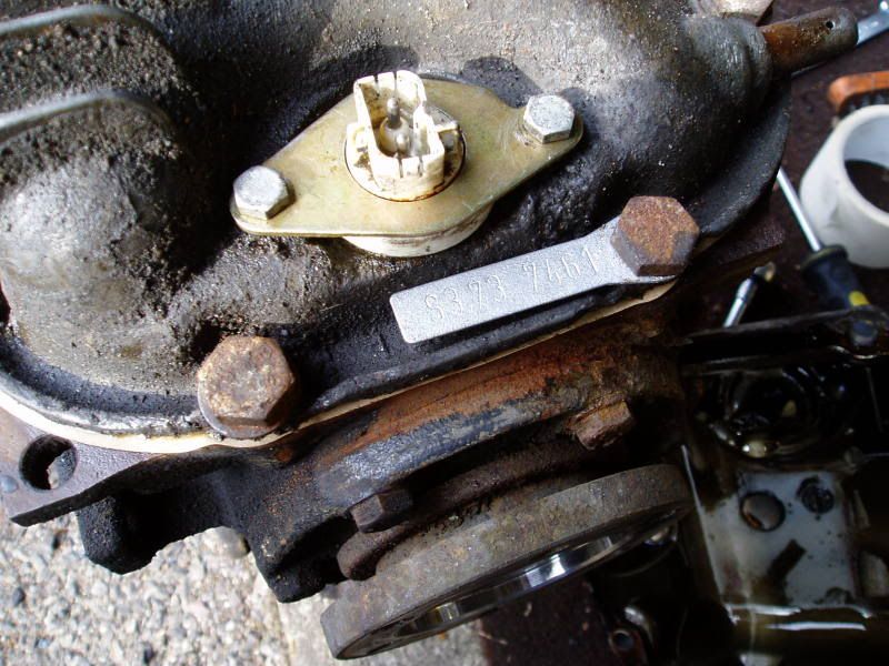

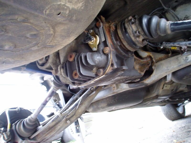

Ah the diff! I sold the original LSd for the car in a quick moment of madness (3.91) and then thought maybe that was a bad idea but........I've got this 3.73. So in it went! I mainly wanted to see what they are like as i've never had one before and the extra RPM in each gear and slightly lower cruising RPM's is going to be a welcome. This has come from a 115k auto car, low milege auto LSD's are where its at!
Also i've changed the backplate for a spare i had with the tougher ZM3 diff bush fitted
In she popped, fell back in this one!
