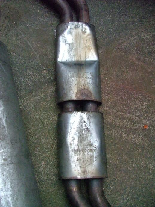

Don't know about brackets but you can get just the tips from Scorpion, I've 2 new ones here to replace my dtm tips. Is your middle section scorpion also? Mine must be a M3 middle section with scorpion tailpipe

Full M3 system with 50mm bores.
Not my first choice but it was so cheap I couldn't resist.
I'll be custom making tailpipes mate.

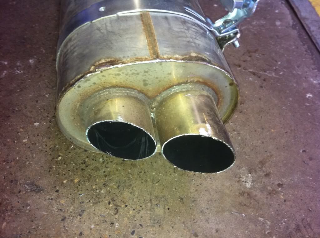

The tail pipes and daft support bracket will be cut off near the box.
I haven't decided what tailpipes to fit yet. I might just get Scorpian to send me some new lemans style ones yet. I have a daft idea about having some angled ones in the style of the Chromie 325 system. I'll have a think.
Lee any info on brackets would be great. I'm after stainless brackets if poss. 8)

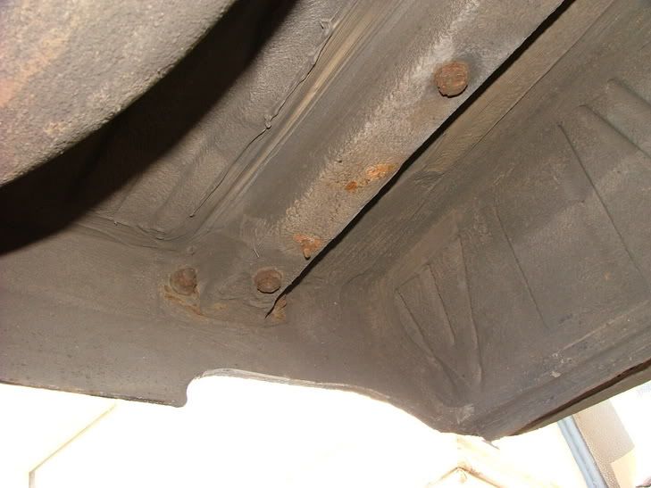

This is a post from my thread.
http://www.e30zone.net/modules.php?name ... &start=450
gareth wrote:looks a lot nicer than my scorpion M3 exhaust :)
forklift damage from the M3 breaker it came from
I've had a look abut can't find any pics of my rear hanger... anyway I used the M3 hanger and made up a bracket that bolts onto the shell using the rear bumper mounting bolts you can see on the floor:
Just a cut of 1.5" angle with the upper part of the M3 hanger welded on: the lower half is shown here still bolted to the back box.
possible all a bit anal but i thought i'd use that rather than the strap type hangers :)

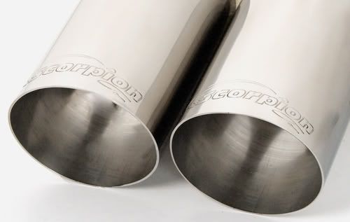

What do we think of these?
I like :cool:
60mm tailpipes from Scorpian

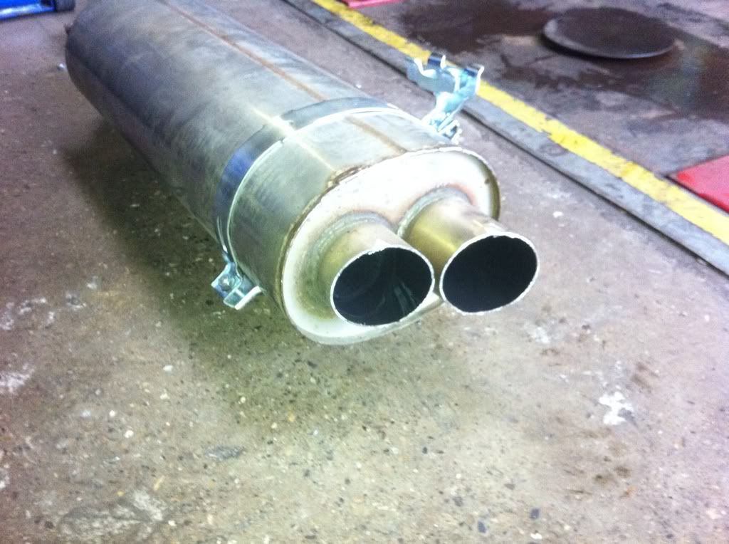

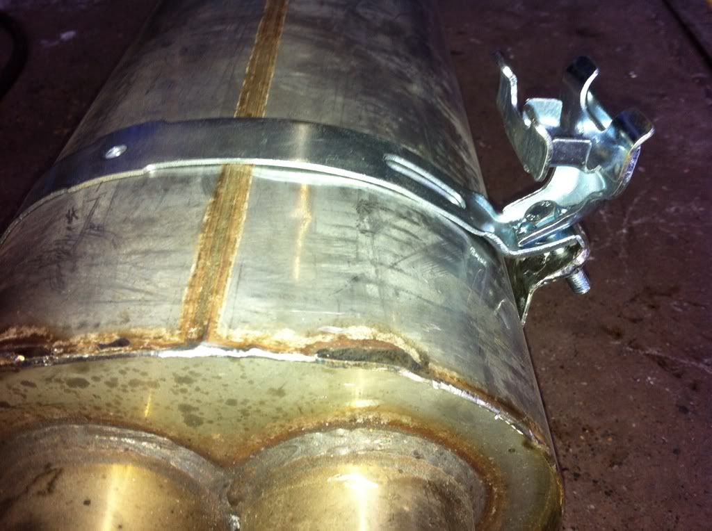

Had a quiet half hour at work so I made a bracket out of 2 I found in our stash.
Then took the bulky support thingy off and angled the tailpipes.
They may need trimming back but I'll do the rest on the car.
