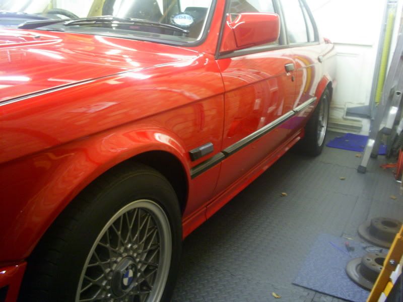

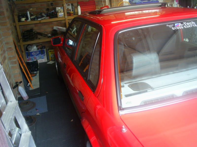

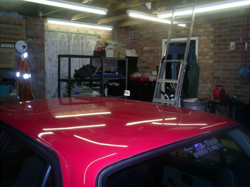

Significant update, Mission control has expanded...
Double garaged rightness, not actually done anything except drive the car in and close the door, all free time is being spent unpacking boxes and tidying!

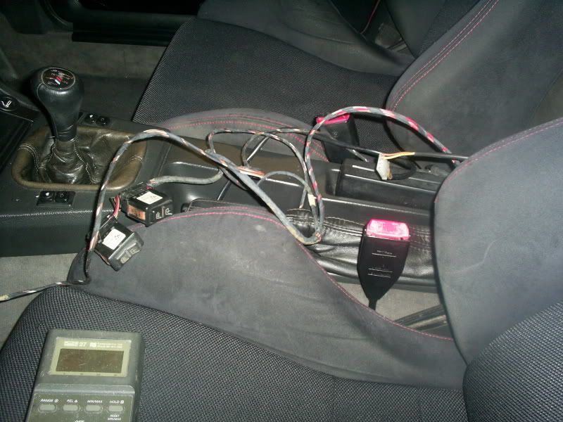

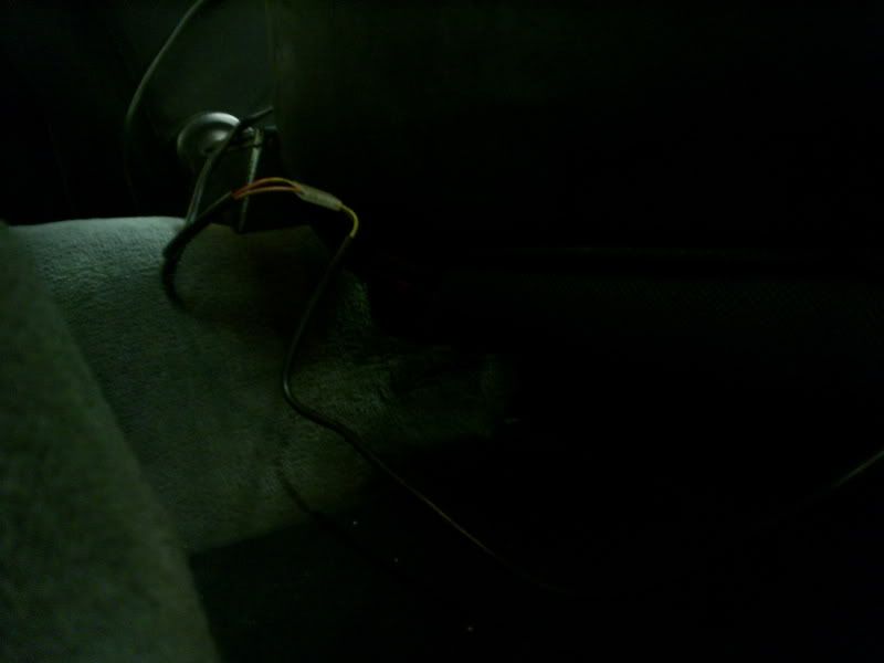

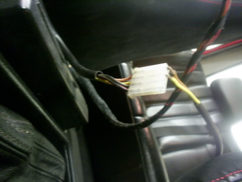

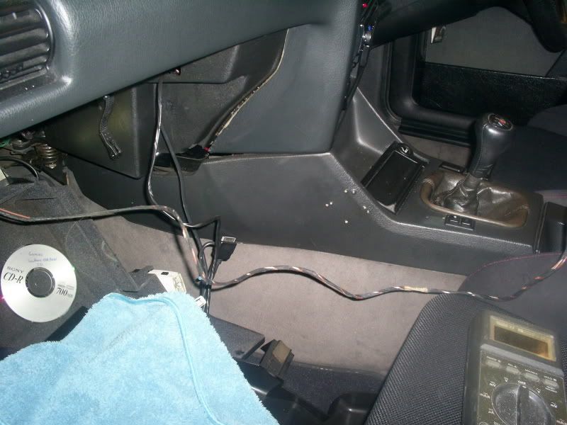

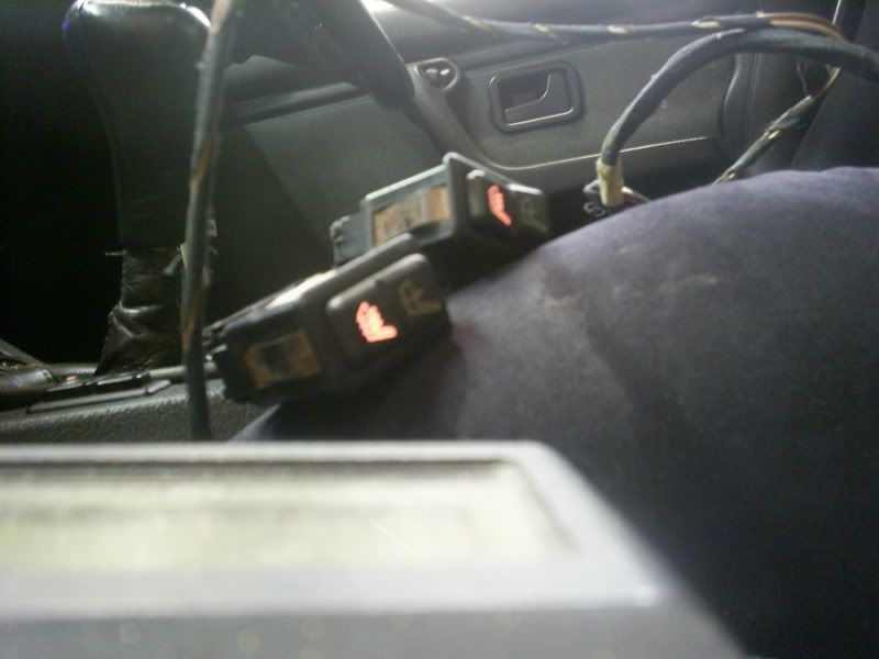

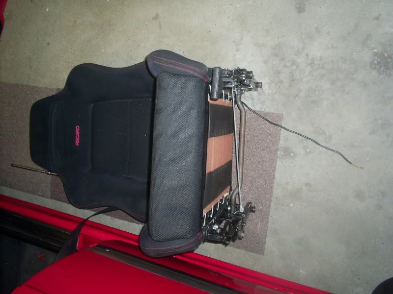

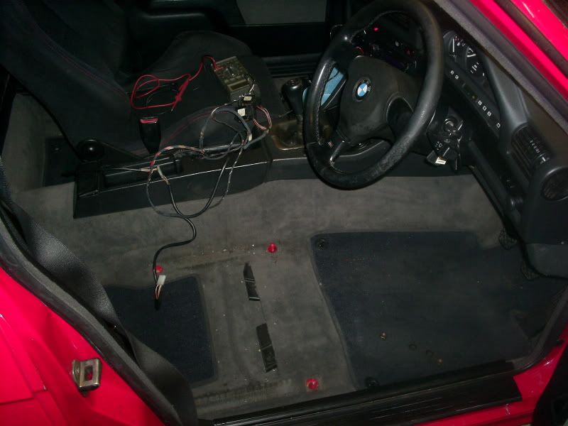

A delivery earlier today ment i could test the heating elements in the recaros,
Good advice;
e301988325i wrote:Stock E30 BMW loom has 4 wires going to the seats.
brown is earth both passenger and drivers side, to one side of the connector, call it number 1)
On low setting,
Between 1 and 2 - 0v,
Between 1 and 3 - 0v,
Between 1 and 4 -12v,
On high setting,
Between 1 and 2 - 12v,
Between 1 and 3 -12v,
Between 1 and 4 - 0v,
edit for reference - on high setting pin 4 becomes earth.
This is how to do it,
Pin 1 earth - clearly to common earth,
Pins 2 and 3 high setting +12v - connect together and join to orange,
Pin 4 low setting +12v - connect to yellow,
The high heat circuit has a resistance of 3ohms and the low heat circuit a resistance of 5ohms per seat set.
Loom plugged into accessory socket and earth attached,
Mess,
More mess,
Poooower!
Bodgery!
And the mission to find the base loom...
Leaving a fairly productive mess,
The seats and loom are destined for the M3 but better to know they work, just need tosomething a bit better with the seat/switch plug 'interface'.

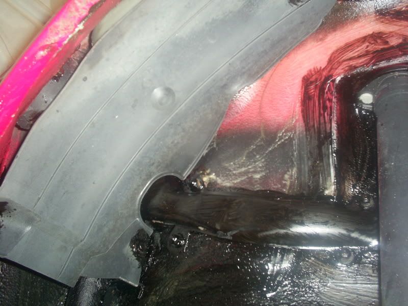

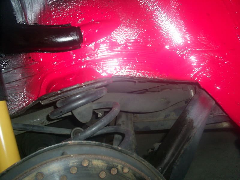

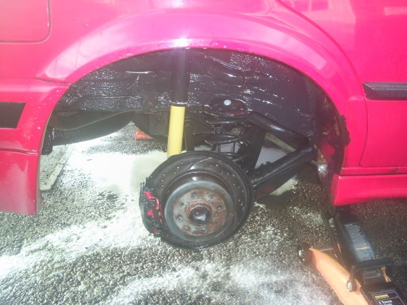

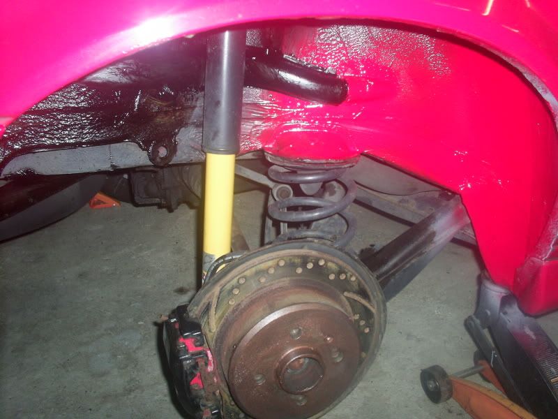

Was bored today so decided to give the offside rear wheel well a birthday,
Lots of scrubbing with TFR revealed nothing too serious though the arches themselves will need grinding and painting pronto,
so zinc primer+stonechip+red for the front of the well and black hammerite/waxoil for everything else,
If i'd done this when i bought the car i expect things would have been far far less grotty but all things considered it was/is fairly good,
Good afternoons work anyway :)

Tue Jan 17, 2012 8:27 pm
Sorry for the thread highjack :o: , but that cover bit, that bends along the wheel arch behind the shock, yours looks new and was just wondering where you got it from as i could use a new one?!!
goosiegander
Zonegoose
Posts: 2544
Location: East Anglia
Tue Jan 17, 2012 9:46 pm
Simon13 wrote:no holes!
You've just jinxed me for the other side coont! :P
Nath at BBB was kind enough to do a very very tidy patch up of the galvanised section to pass last year's mot, its lasted very well but i am under no illusions that if the turd is in it for the long haul proper arch work will be required on both sides.
The decision will come when i can be arsed to have a proper look at the back of the sunroof cassette, if its grotty in there shes off to China! Fingers crossed though Si :D
As for the breather tube cover, it was a bit grotty but a quick going over with a wire brush wheel on the worst bits and some direct to rust hammerite cured that, albeit tempoarilly, with a liberal coating in waxoil to boot!

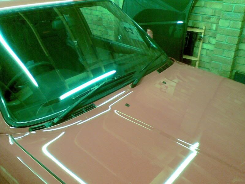

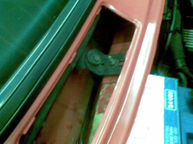

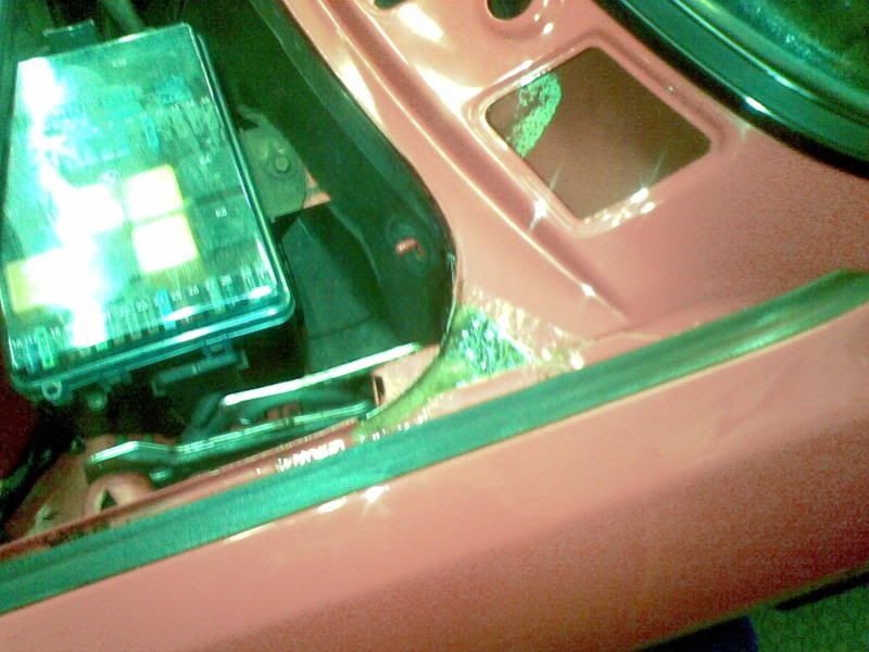

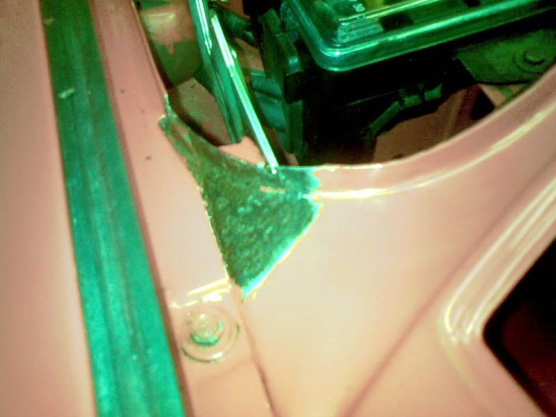

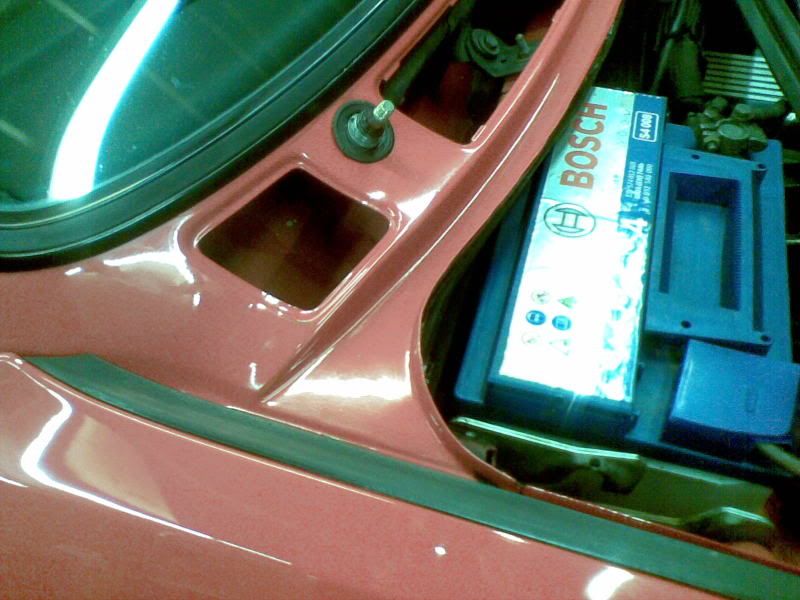

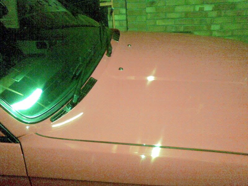

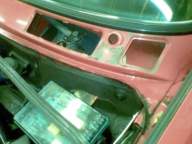

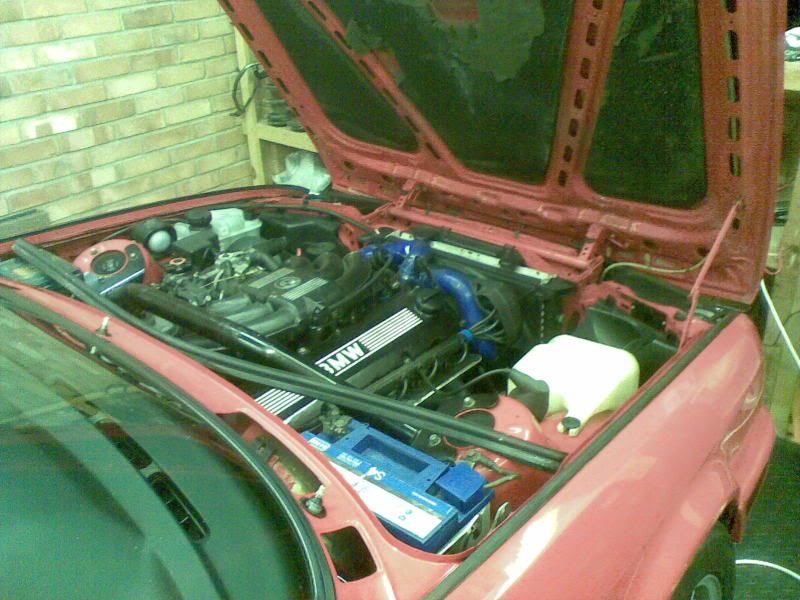

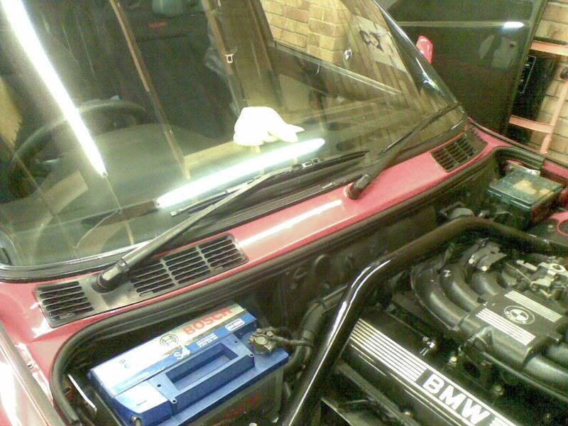

Was Bored, scuttle was annoying me,
disassembly and cleaning
Good under the screen
Some surface crap found here
Tempoary waxoil and some cleaning...
Other wax applied, greased the wiper linkage as best i could but the arms don't like coming back to park unless encouraged by an extra tap of the controls...
Apologies for the shit pictures and the council engine bay...

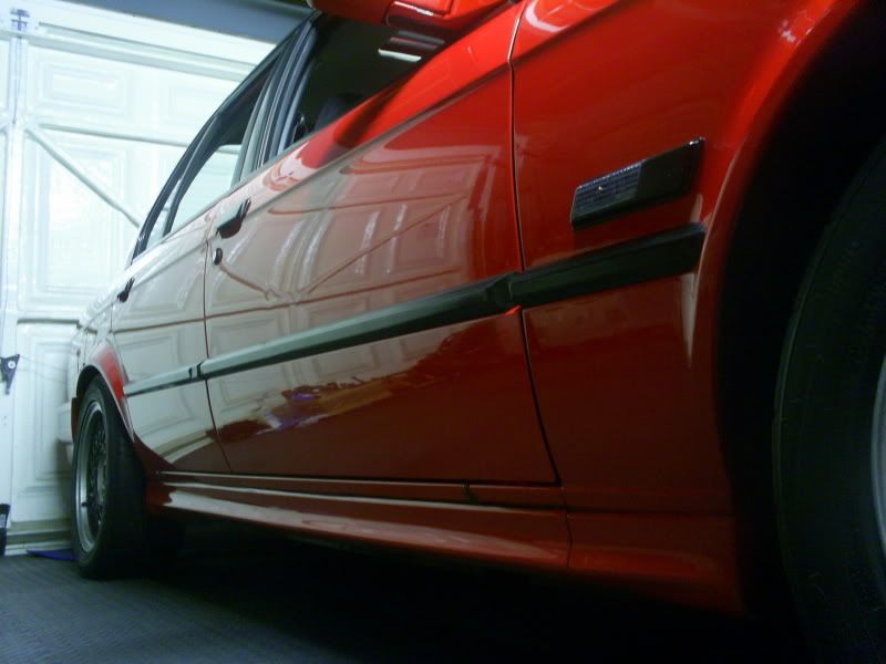

Wed Feb 29, 2012 10:36 pm

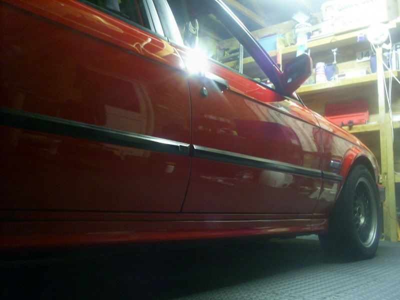

Drivers side cleaned (not including sills) and given a single coat of wax,
Slightly better camera...
The turd isn't quite dead yet :D

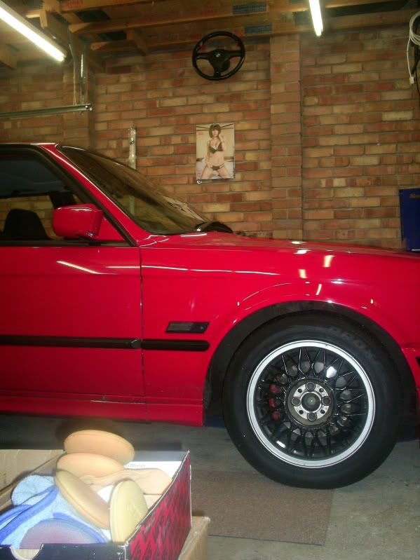

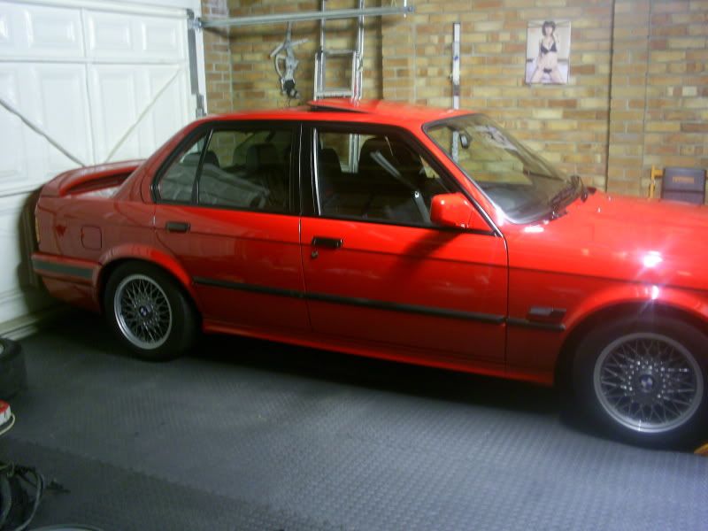

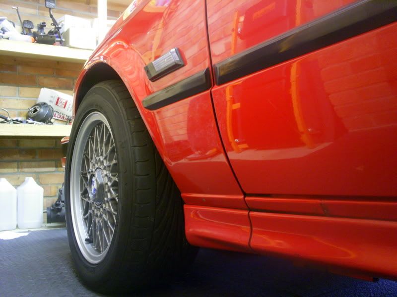

New wheels on;
Dezzy
CR24v it's a lifestyle
Posts: 11974
Location: Middlesbrough
Mon Apr 02, 2012 9:53 pm
Loving the Rimz mate.
Look's great :cool:

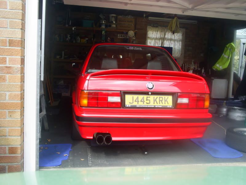

Minor update as some of you are aware, the 2.8 is going into storage and meanwhile care of those nice chaps at BBB the moordoor is sporting this:
...oh wait thats not very clean, right...
Thats a bit better! :D
Happy to say that it goes like a 'scalded cat' and sounds like an instant ASBO at any speed...
