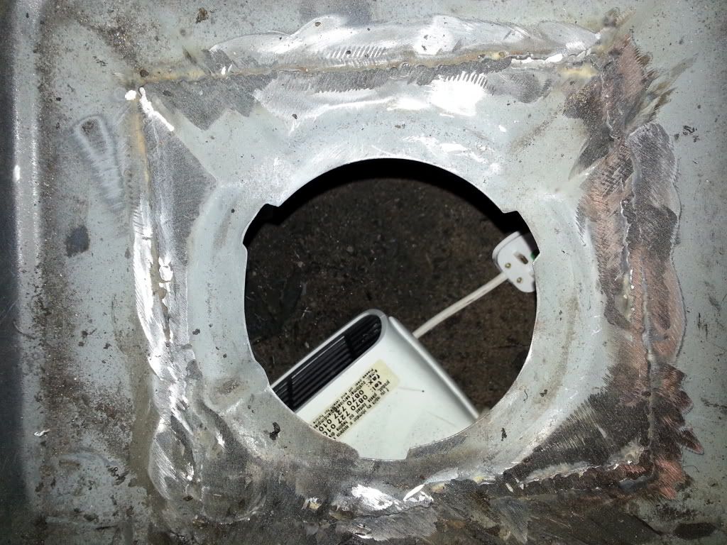

Kedge wrote:That all looks fine and once you grind the welds back, seal and paint no one will ever know. The only one I'm a little unsure about is this;
Looks like there is still some rust that's not been chopped out. :?
As for the bungs, I'd just keep them OEM. No point messing about welding them in. My car is nearly 28 years old and still has the original bungs and they are fine, anyone who's spunking thousands on these turds isn't going to be using them as daily runners through the winter and that is was has caused these issues, lots of salt, water and neglection. So long as everything is prep'd properly, sealed and painted properly they will be fine. If you are set on welding, just do it the same way that the small bung has been done.
For finishing the floor I'm going to be using zinc primer, fresh seam sealer, a base coat and then heavily lacquer it all. I've used Hammerite Smoothrite in the past and wouldn't let it near the E30, really don't like the stuff, POR15 Chassis Paint is a far more superior product if you wanted to use something along those lines.

If you can get in at it and grind away the worst of it then fertan, prime, seal, paint then waxoyl it should be ok. No need to go to the efforts of making it look OEM under the carpet, no one will see and it'll be a more durable finish anyway.

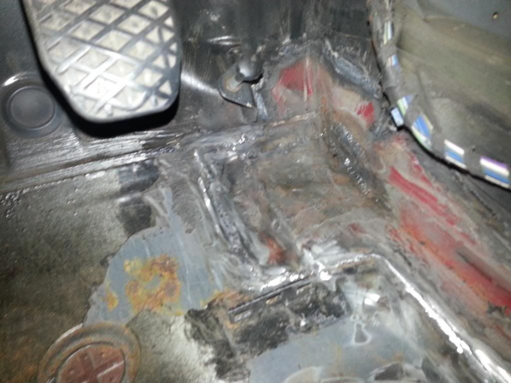

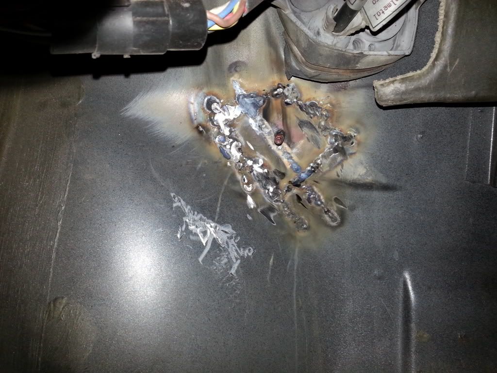

Made another hole tonight... :cry:
Phil came over and we went over the pieces, chopped off the jacking pads and he cracked on with the osf corner, I started checking out the little scabby patch in the rear of the boot.
1.8 Zetec running bike carbs 8)
Took out the vapour tank, looks good behind it but the other side of the scab in the boot now looks like this!
Phil didn't get the front floor welded up tonight but did get the piece almost there so should go straight in on Weds.

Meatballs82 wrote:Made another hole tonight... :cry:
This is what I'm dreading on my IS if I ever get started on it. I'm coming near to the end of a evening welding course so shall hopefully get to blow some holes in her soon...:o
Good to see more progression Matt..

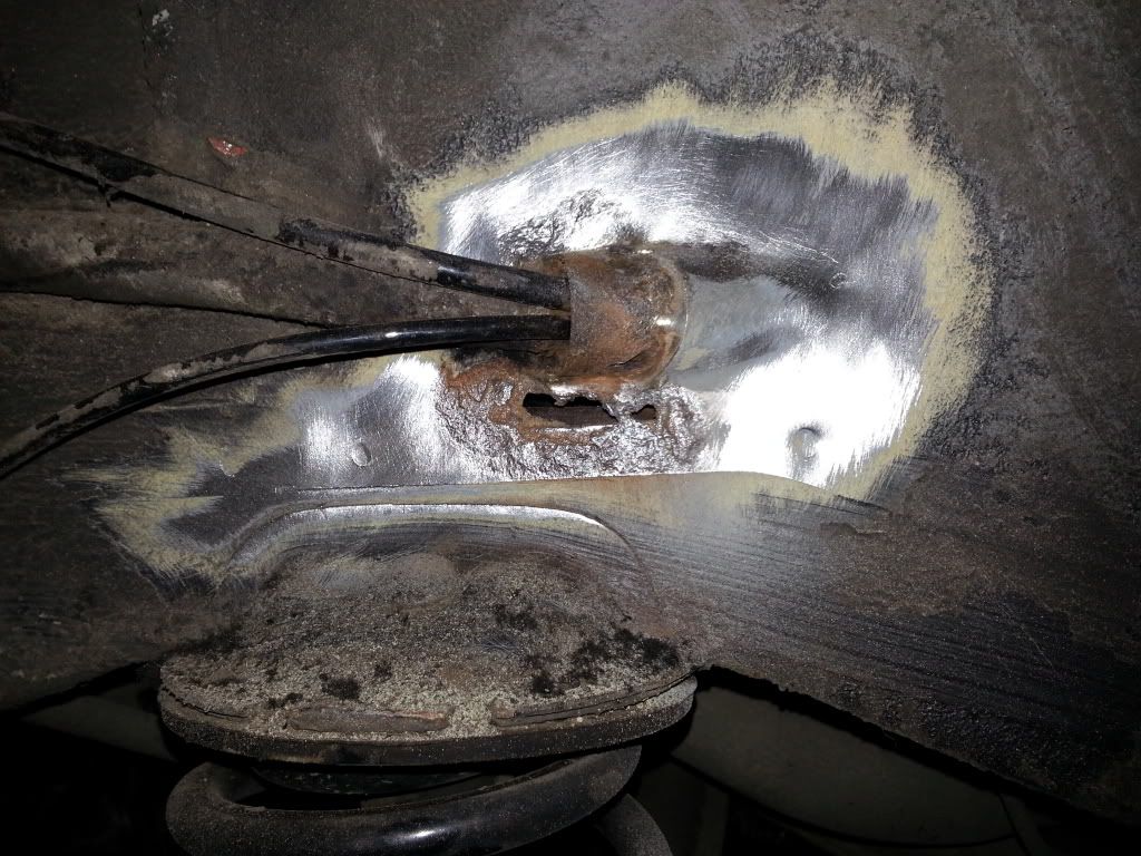

Oh and get it back to bare metal around the bottle brackets, you've seen how mint mine looked but it was still just starting to go once it was back to bare metall.

Sorted, sent him the screenshots from Beardymatt & Scotts thread and he reckons he can sort it that way. Happy days :D
Meatballs82
Posts: 1136
Joined: Tue Jan 11, 2011 11:00 pm
Location: Northamptonshite
Thu Jan 10, 2013 10:59 am

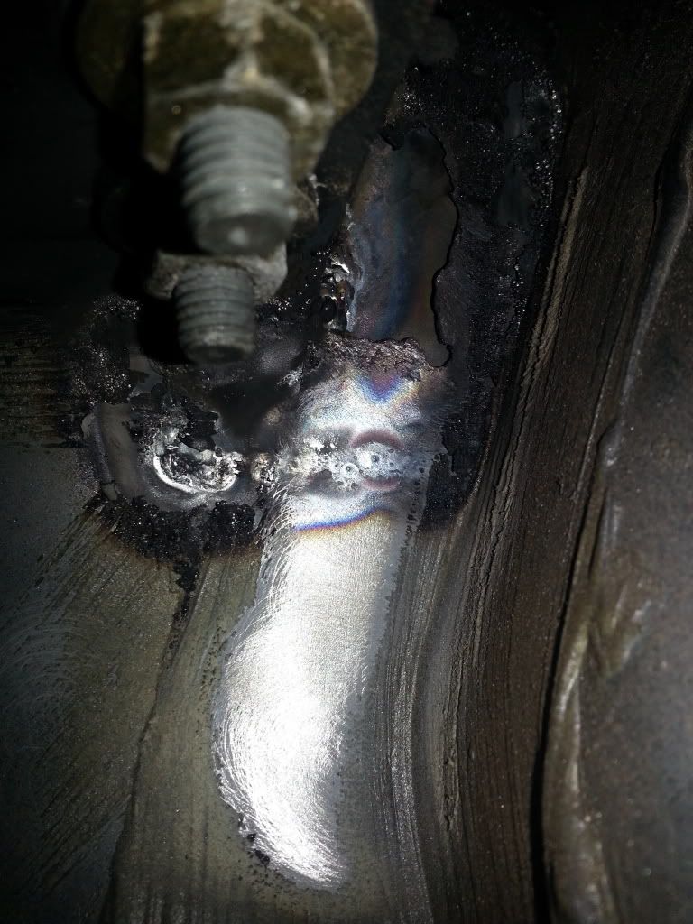

Nipped down the garage lastnight to find I have one less hole in the floor!
I cleaned up the welds
and covered it with Polsta's (second) favourite fluid winkeye
will go down tonight to make sure its gone off, key it up with some scotchbrite and get it primed ready for sealing tomorrow.

Mate, get the whole floor back to bare metal first, I'm going to try finishing doing that to mine this afternoon. There WILL be rust under the seam sealer on the front seam.

Meatballs82 wrote: I cleaned up the welds

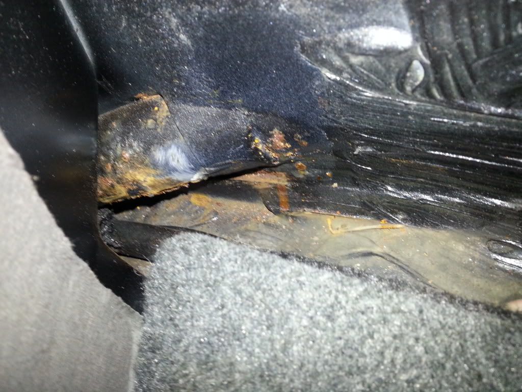

as kedge says, get the whole floor back, see the surface rust by the bung there undeer where the deadening was, there will more than likley be more than that lurking to be found, get the lot taken back

After my afternoon curled up in the footwells I'd say on the drivers side you need to be stripping the paint right up to the pedalbox. I found surface rust right up the bulkhead even though the paint looked fine as you rubbed it back the brown kept appearing on that ridge between the brake and clutch pedal.

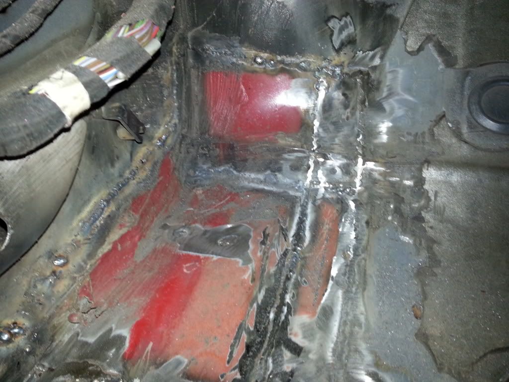

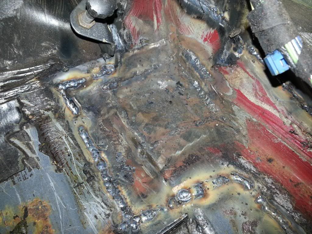

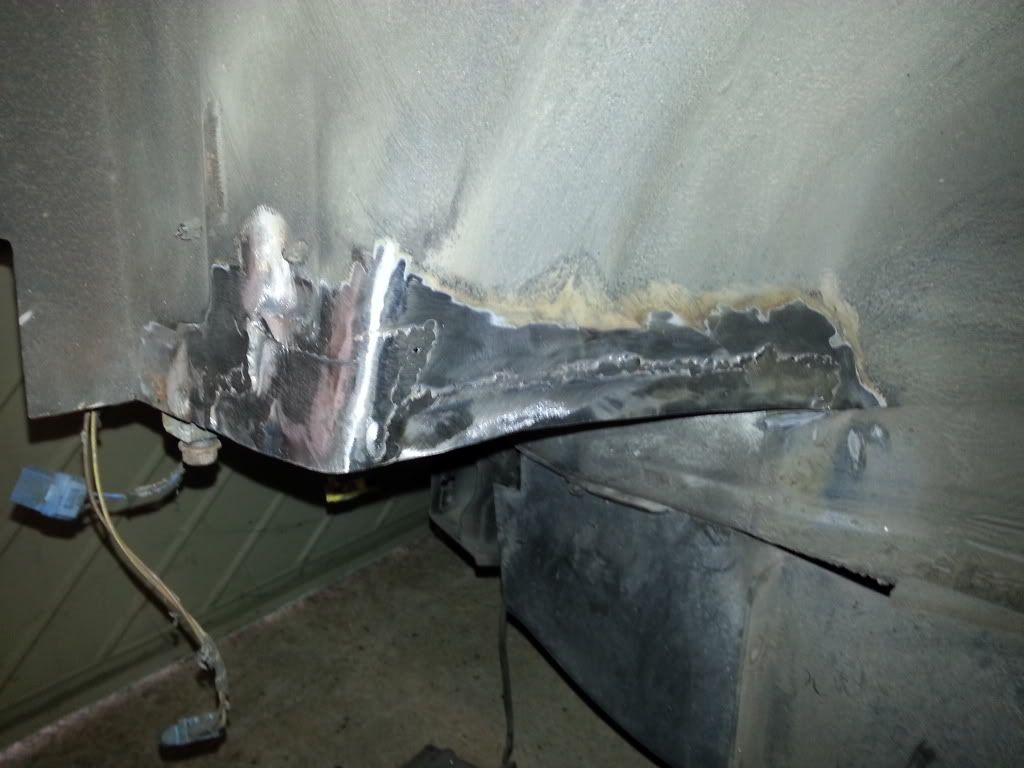

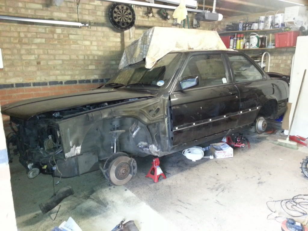

All the weldings finished now, all turned around in a week which is sooner than I thought! 8)
Phil had finished the drivers side by the time I got to the garage lastnight, I'd already primed everywhere underneath during the day so we got the sealer out. Used a whole £20 tin of 3M seam sealer just on the driver side :eek: didn't take any pics of this stage, hands were plastered and we wanted to get as much done as possible but it looks to be sealed well.
We got the car turned around last night and almost had the nsf floor finished, started again at 9 today to finish it off.
Action halted for today soon after Phil left, my £16 Toolstation angle grinder gave up the ghost on the last bit of weld to grind, it has taken a battering in its short life! gonna take it back and invest in one a bit better on Monday I think!
Ran the battery power cable back in to the engine bay, reconnected the battery and started her for the first time in 2 months, fired back to life on the first turn! Happy days. 8)
Next job is prime and seal the rest of the welds, finish stripping the floor inside and get it all painted up nice. Hoping to get that done through the week so I can get sound system wiring in and then the start dash and interior next weekend.

Nice work Matt - jealous of your garage space :mrgreen:
Meatballs82
Posts: 1136
Sat Jan 12, 2013 4:21 pm
capri_rob wrote:Nice work Matt - jealous of your garage space :mrgreen:
Its not mine, Its my parents. I have a garage at my house but its tiny and has no power. Somehow talked dad into letting me borrow his for the winter!

:cool: Looks bloody good dude.
This has come out very nice too :cool:
How much has all the welding cost now then? And do this guy travel far? winkeye No doubt my future chromie will be a rusty sh1tter so will need a welder

Nice progression Matt.. You really are keeping it to your schedule.
Is that the leading edge of you front inner arch? There's usually two tabs with holes in to hold the arch liner there isn't there? I only ask as I have this job to do soon.
Like the camper style pop up roof option :D

Jim320i wrote::cool: Looks bloody good dude.
It looked just as good on the other side but I haven't get any pics of it yet, its all sealed up now.
All in all the welding has cost £220
