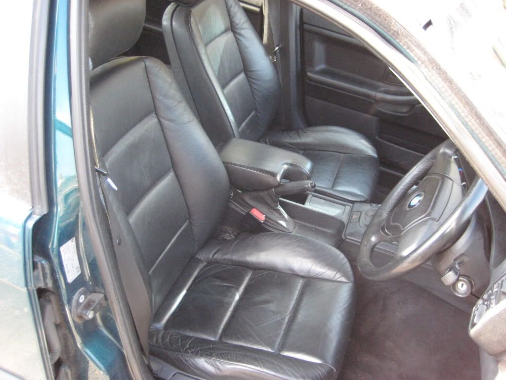

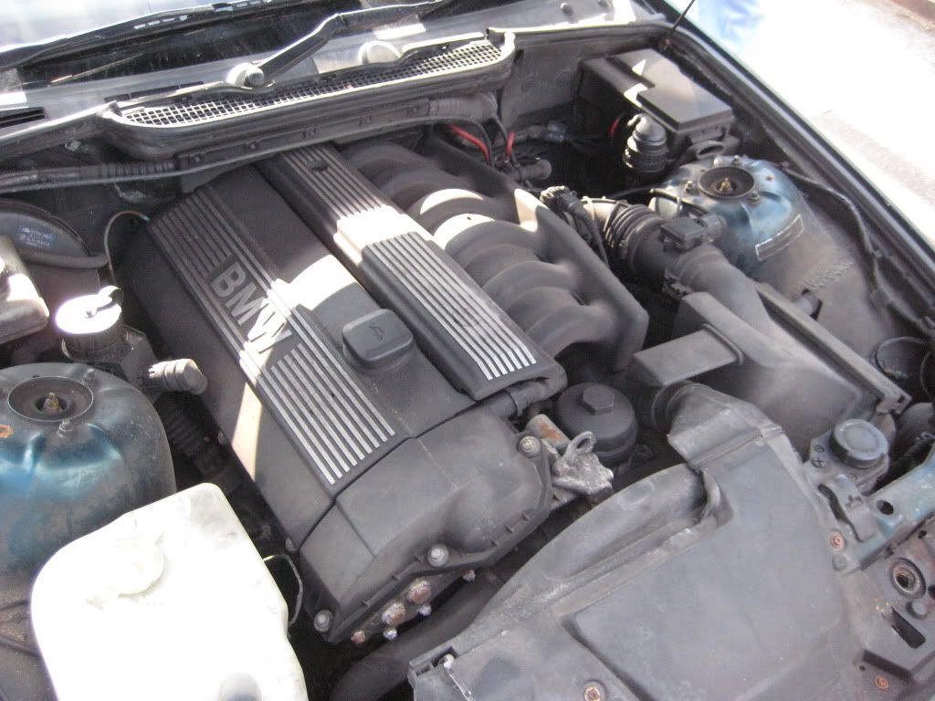

My m50 is shitting itself badly. I fired it up today, it struggled to fire up, engulfed the area in some lovely blue smoke, rattled like f!ck and ran VERY lumpy.
Good job i picked this up today then isn't it!
Immaculate leather interior :D
M52b28 POWWWAAH!
The car has done 171k and the engine was changed by bmw under warrenty at 94,500 miles - confirmed by bmw. Its really quiet, pulls well but its in need of a service.
Im probably going to use the m52 gearbox. What gearlinkages do i need, e36 m50 325i rings a bell ? And how bad would a 3.64 diff be as a stop gap until i pick up a better suited one?
:banana:

Good work
I got £200 back for the leather seats out of the 4dr I raped, also £60 for the OBC

I've got a mate interested in the leather interior, exhaust system is wanted by a zoner, the rad is wanted by another zoner and my mate wants the handbrake gaiter. The wheels arent too bad with loads of tread - infact i think the rears are almost new.
Post Sat Mar 13, 2010 4:00 pm
why not use the rad in your E30, unless you are already using one the same size. They drop straight in and are waaay deeper than an iS rad.
Should be a nice straight forward swap, you've already got the M50 inlet manifold for some nice top end gains. Just the wiring loom to fettle.
What did you have to give for the E36? PM me if you'd rather not say on here

My rad is already a 328i one :D. Yeah just need to sort the exhaust out again for the two lambdas, wire the ews and engine loom in and i want to use the m52 gearbox.
£400 winkeye

nice one, reckon you'll end up with a free M52
Exhaust is worth £50 for the cats alone at the frag yard.
As I never got to properly drive my M50 I'd be interested to hear about how you feel the M52 compares once it's done. I was very impressed with mine whilst it was briefly living, should be faster in the pov spec chromie shell too :twisted:

You'll probably know though. M52 gearbox = 328i prop? e36 m50 325i linkages and lever holder jobber? And obviously a 3.25 diff when i can find a decent price one, i presume the e36 one wont fit?
Posts: 28646
Post Sat Mar 13, 2010 5:37 pm
Gearbox/prop/linkages yes
The E36 diff wont fit but rebuilt into an E30 case would be perfect for a road car

Cheers dan :D I'll probably brave using the 3.64 diff until I find a suitable one. Don't fancy raiding a slipper and I could do with the conversion being done over a weekend. Or ideally before the third of April

It will try and jump off the dyno with that diff :)

much better, best off all you will have an m50 inlet manifold for the m52 8)

M52 FTW!
Much better than the M50, the front end feels lighter with it too which is a good thing. You won't regret the conversion..... :D
