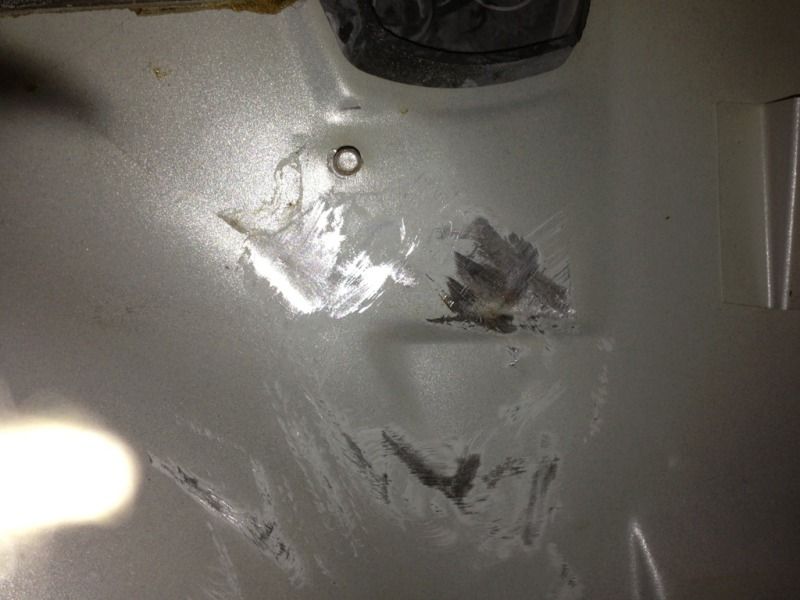

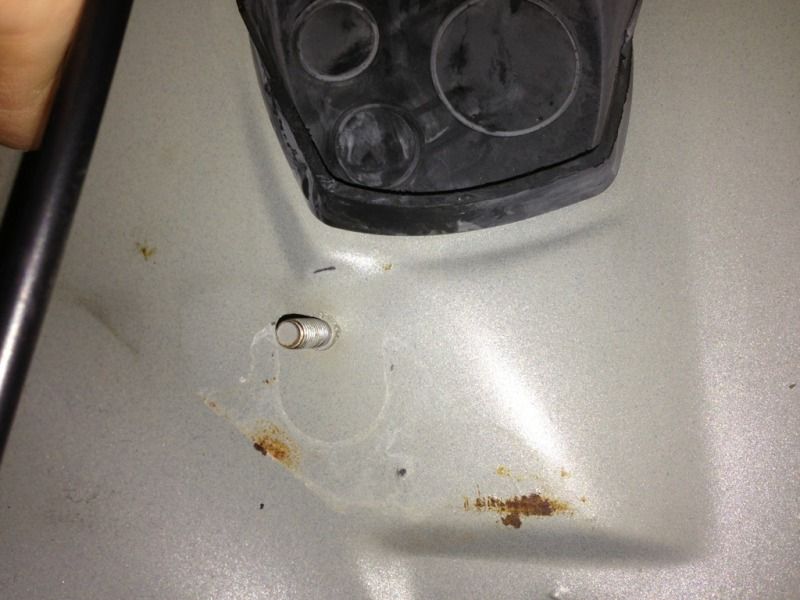

Brake servo is out, did have to come out as there's no way new insulation would go back on with it still losely in postion, no great shakes though. Pleased to report it's sweet behind that side on the bulkhead (the brown is just glue);
Then out to the otherside and the reason why i'm having to piss about with this added hassle.
From the inside;
From the outside (the brown gunk from the glue makes it look worse but it is getting chopped out past the thread at the top);

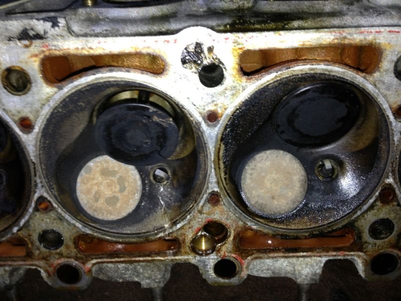

Head was pulled off yesterday and then the block this afternoon, here's a fer pics of how the internals look. Looks OK to me, nothing to suggest the metallic noise it developed was it starting to eat itself inside out.

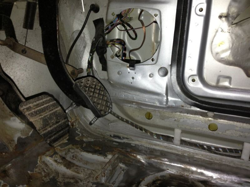

Then I went on to giving the drivers side footwell some closer inspections as there was some very light surface rust I already knew about needing to rub back and paint but I soon found myself poking at the sound deadening and found it was coming up really easily to my surprise. This also led me to pulling up the seam sealer where the floor meets the bulkhead.
Here's a picture of what was found partway through the removal of the seam sealer, I'm sure you can already guess what it is though!!
The start of the clean up though revealed it's nothing serious at all, I'm sure most out there wouldn't be so lucky though!
The whole floorpan will be taken back to bare metal and then zinc primed.
