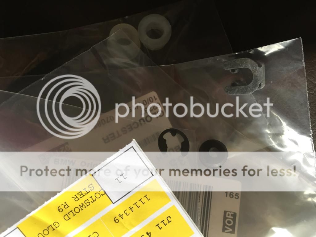

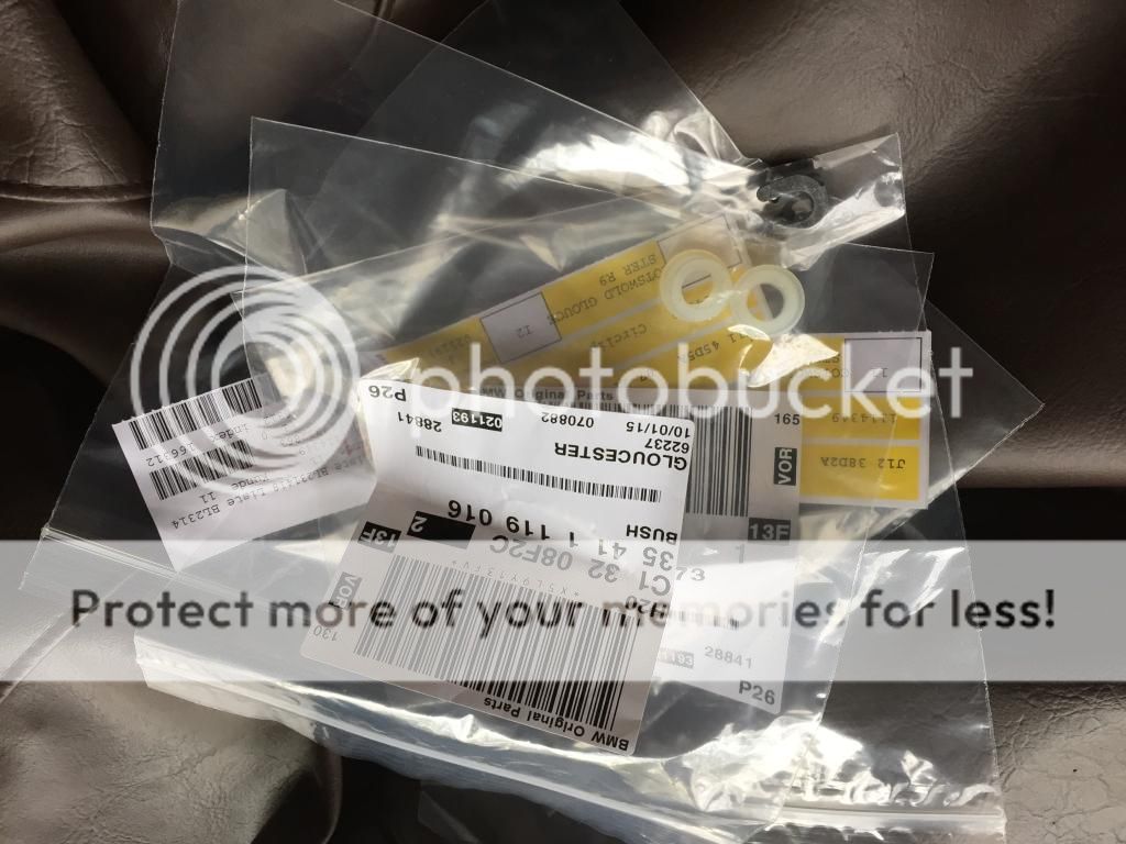

Meanwhile, the accelerator cable is a retrofit/legacy from before.
So even though a new / correct part number cable has come from Cotswold BMW, the feedback was that for the bracket made on the carburettor, the bowden cable is short.
So have to figure this new conundrum out
The bits and bobs at the accelerator pedal end also arrived.
Cable and plastic bits waiting for a genius to solve the cable length problem.

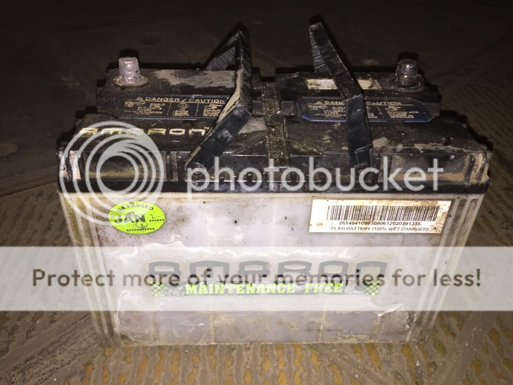

All the electrical gremlins were sorted with a new 80amp Exide in the boot.
The garage had fitted a 65 amp battery, without checking the correct size and the AC was cutting, there was a charging problem.
Threw out this:
Threw out this:

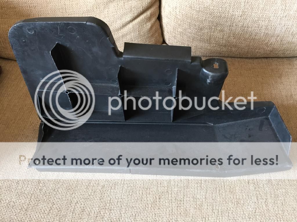

The Facebook Zone page worked for once.
Bought the battery in boot cover from Al English. Arrived without an issue, except a small bend in spite of no bubble wrap.
After the new battery went in, so did the protective cover.
Sajid1 on here sent me the replacement for the cracked under speedo plate.
Using it every day, and still manages to invoke stares, thumbs ups, smiles and waves wherever I go.

Did the pre-facelift E30s come with inner arch covers? The plastic stuff that I see in later models.
If they did, wonder what the garages have done with them.

in the front yes, on the rear.. just a small one that protects the filler neck ,
- Old Skooler
- Posts: 14014
- Location: Canterbury
The front arches should have liners, not sure about the rear arches.
Do they really protect the front arches? Will go through a lot of trouble importing them, only to know that the double Waxoyl plus rubber spray that I've treated it to will be enough.
