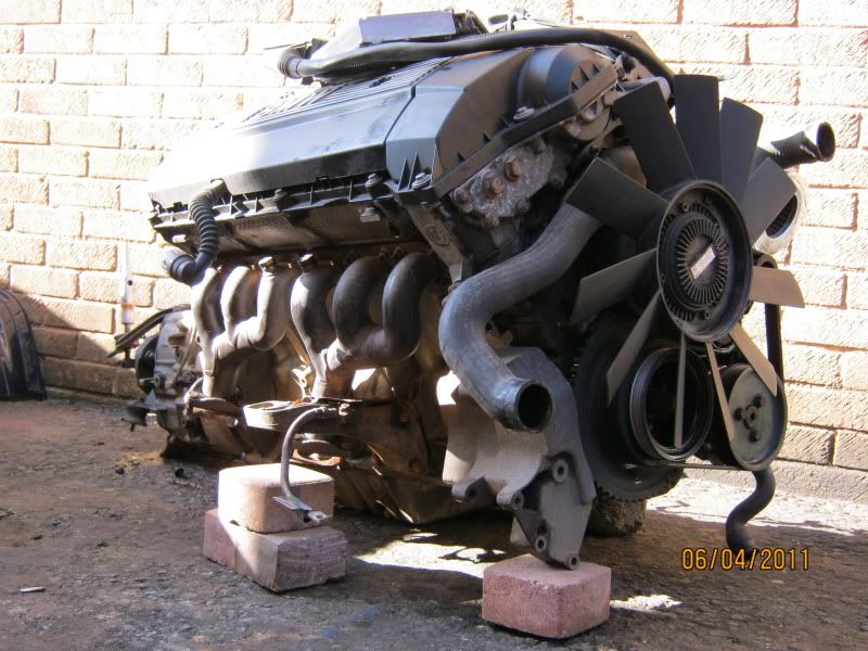

M52 out.
Weekend should see more progress
eko
- Old timer
- Posts: 11531
- Location: South Devon
Constructive day today.
Fitted new waterpump and thermostat along with ali housing.
M50 inlet and sump done.
Lightened M20 flywheel and clutch firtted and gearbox bolted back up.
Engine is now ready to drop into the car so ill crack on with getting the M40 out in the morning.
I have a suspision the M20 starter ive got is shagged so might need to sort that out later.
Also ive fitted the M20 Brown temp sensor but cant remember from doing Cooks what needs doing with the wiring for it but I can sort that when its in the car.
Oh and im a c0ck.
didnt I go and leave the fooking ignition key in the scrap donor when it went to the crusher
I have still got the EWS kit from the M50 but ive also got a Red label 413 DME which should bypass the EWS anyway.
Ready to drop in.....

Sorry that should have said Silver label 413 not Red.
Not sure if its M52 cpmpatable though?
- Posts: 28647
- Location: Staffs
Wont work mate, will run like sh1t. Still got the logbook for the car? Get a new key ordered, valet key is under £20 and has a chip in it
