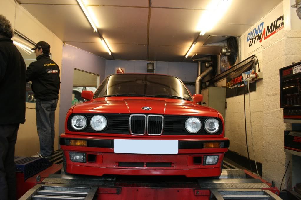

I'm abit nervous about tommorow... its back on the rolling road again!
I'm hoping for a better result than last time. Watch this space!!

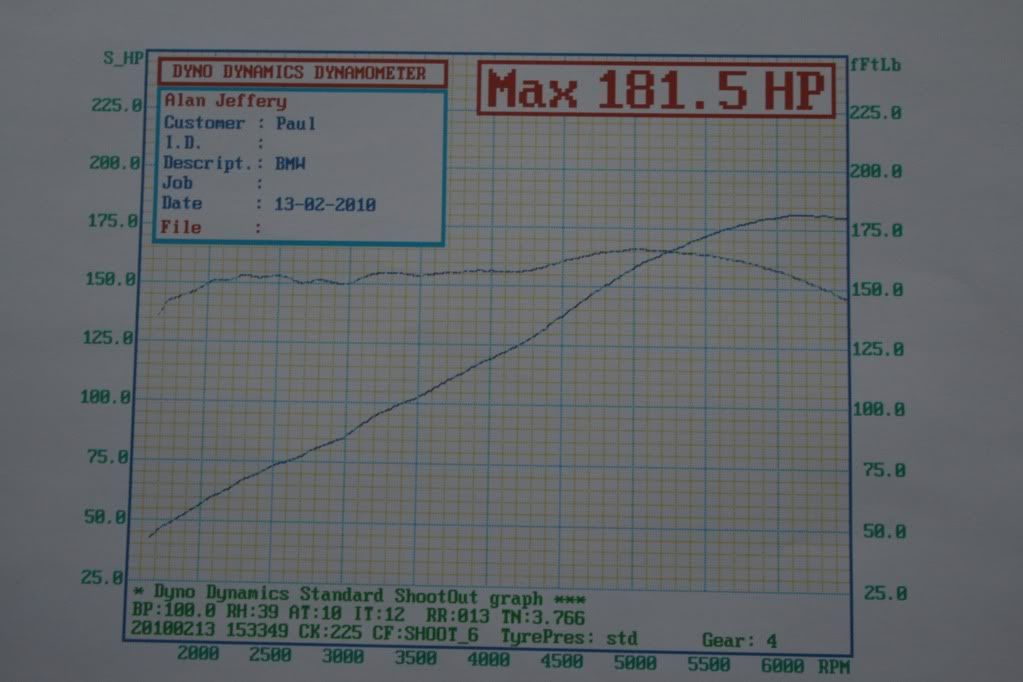

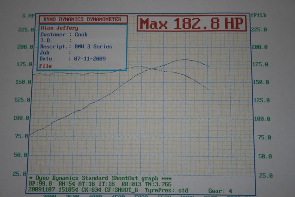

The results are in... and its down on power
Although there is no dip in torque or BHP now with the chip.
Before:
After: (no longer got a restrictive airfilter, new lambda + chip)
I've got a couple of photos to still upload too
Before:

Oh dear... IT temps were lower as well!

I am disappointed, im not going to lie. I had to wait for 3 hours in the freezing cold for mine to get dynoed because everybody had Fail Wheel Drive cars - i was the only RWD carJhonno wrote:Oh dear... IT temps were lower as well!
next step... another chip or wait for a 2.8?

People always bad mouth cone filters.. BUT.. My turd made 297bhp with an unshielded K&N, and a dodgy exhaust! On a reputable dyno..

I think i was the only person today who actually made a loss.
The ITG filter its got on now made a difference to the old k+n one i had on it.
The dyno i use is very accurate and is known locally for being pretty spot on.

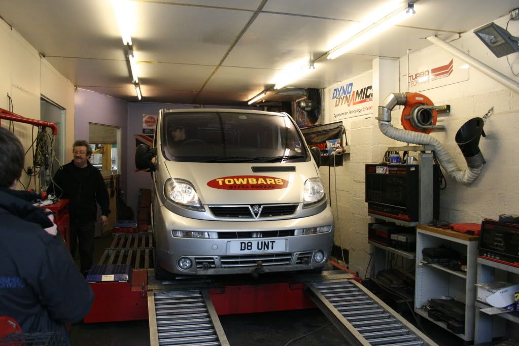

I like this photo, it makes the car look clean. It almost justifies washing it in 3degrees at 8am
epic lol of the day:

that's hilarious, had the vivaro had any work done?Cook318IS wrote: epic lol of the day:
I love your car by the way, spec and finish to die for, it's a real inspiration as I'm going to be starting my m50 soon.

Nope! it was completly standard. Its dyno graph was literaly like an "n"

Paul,could it be a case of the rolling road out of calibration?
Either that or the chip.

I can't see the calibration being too far out, everybody else seemed to get pretty much spot on power. clio 182 which never has 182bhp had something like 179bhp - the dyno chap said he hasn't seen one get that close to 182bhp from standard yet
Even if it was out of calibration i should of still seen an increase surely? maybe it needs an s50 manifold?

its always the chips that will be losing you power not the cone!

Paul, did you have chance to warm your oil up given you were waiting for so long, thick oil could have lost you a bit!Cook318IS wrote:I am disappointed, im not going to lie. I had to wait for 3 hours in the freezing cold for mine to get dynoed
Ps) Where's the dyno?

The car had been running for about 30-45 minutes before it's run. I only go to alan jefferies in Plymouth

what exhaust are you running? a standard e36/e34 m50 325i/525i surely has a bigger dia exhaust than a e30 system?

Its m52 manifolds to a 3 piece m20 'zaust. The e30 stuff sounds louder than the e36 stuff but i dont know if that has anything to do with centre box size. OB's m50 made about 194bhp on the same dyno and he is using the same setup as me AFAIK.pauldeacs wrote:what exhaust are you running? a standard e36/e34 m50 325i/525i surely has a bigger dia exhaust than a e30 system?

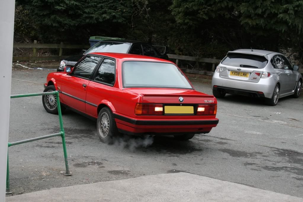

Went for a few photos this afternoon
spot the dent below the rear quater window
i may go out again later and get some shots at night
