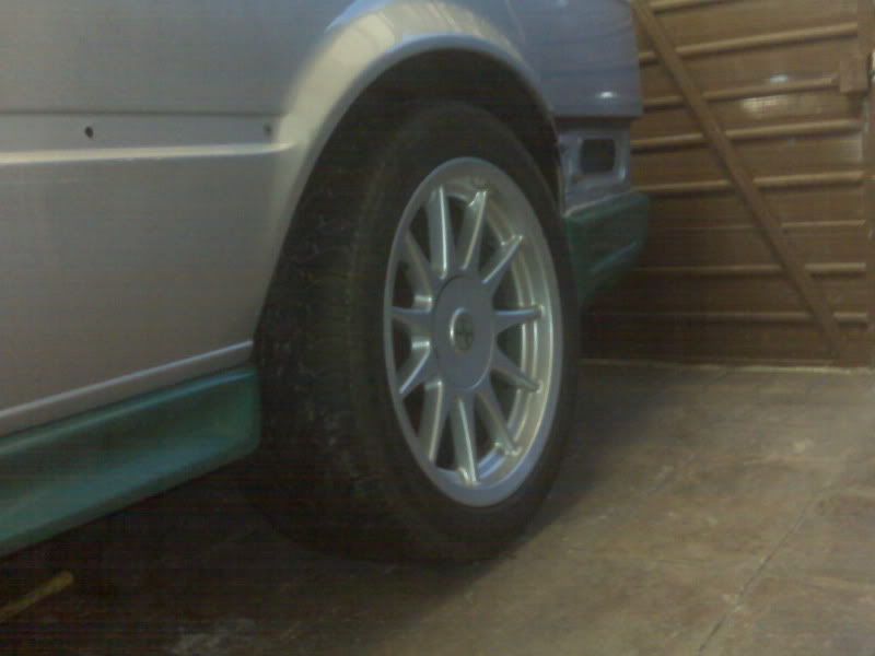

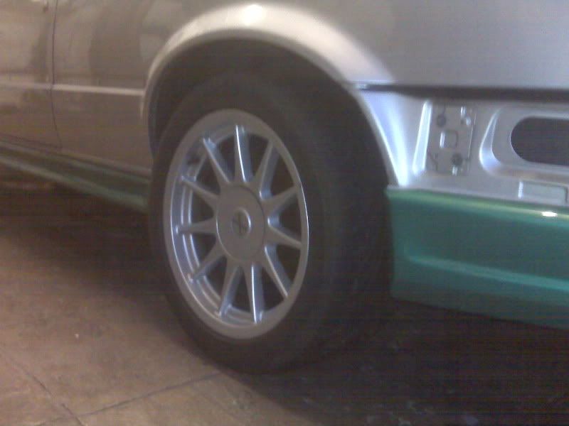

I picked up the wheels for this turd at the weekend 536 mile round trip !
(many thanks to Theo for hanging onto them for a month or 3 :o: )
couldn't resist fitting them to see how it looked !!
very very pleased another step nearer to getting this thing done !!

Looking good. Well done for going for the 16" wheels, best wheel out there.

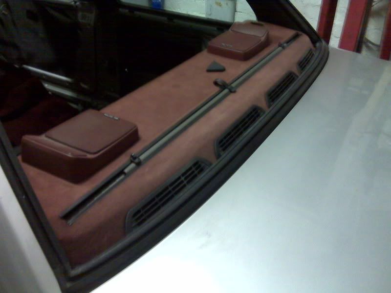

this arrived from Germany today, I love the origional BMW speakers I Haven't had these before I hope they sound well
But...I am now wondering about a full Black interior :roll:

Thu Aug 06, 2009 11:40 pm
some rare tasty morsels going into this :cool:

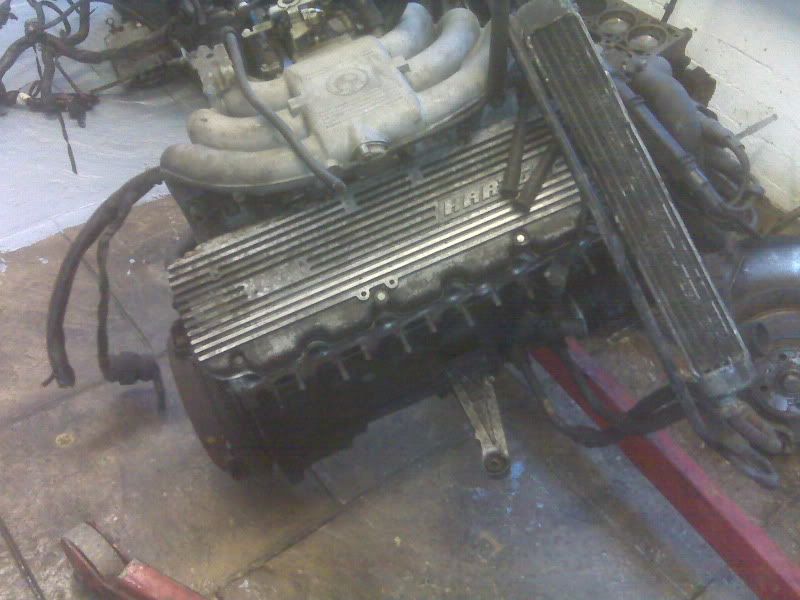

well now it has gone for paint I can start on the oily bits :)
the engine in the origional green car was past it's sell by date with marks on the head and pistons and big scores down the bores :(
so a good known m20 b 2.5 was bought from a good freind (sweep) with a view to fitting a TD or ETA crank
but then.... I heard about a H27 that was breaking down near stafford 8O jumped in the van and 200 miles later this was purchased ...
A genuine H27 lump
there was no way of knowing for definate if it was a 2.7/stroker the car was un-drivable and we couldn't fire it up after vandal damage on the wiring so i took the chance and handed over the readies,
how glad I am that i did :D
the stroke is about 10mm longer than my B2.5 :rock:

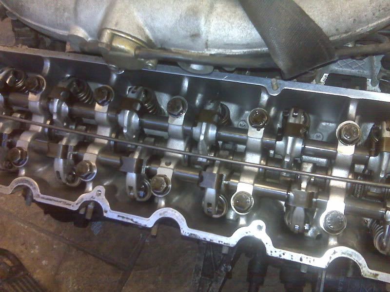

and it had this lurking in what seems to be a new head ?
an almost new Shrick cam

I wonder if the head is reworked chambers,ports etc. Surely if there is a schrick in there its been rebuilt at some point? not that thats a problem
Pull it to bits so we can see pistons! i reckon they'll be identical to alpina 2.7 slugs bar compression ratio differences
Is there a part number on the cam? hartge used a 270 ish cam? might be a 284/272 but who knows!
Sun Aug 16, 2009 1:19 am
Simon13 wrote:you can whip the engine into bits any day!
the head is not a BMW item there are no markings on it ?
the inlet ports are massive and shaped differently to any i have seen (they look steeper ? ) valves are slightly bigger
it's a strange one but it is like brand new and it will be used on this build it's in lovely condition,
the cam also has markings showing 774 ? that must be a shrick thing ..

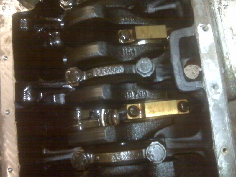

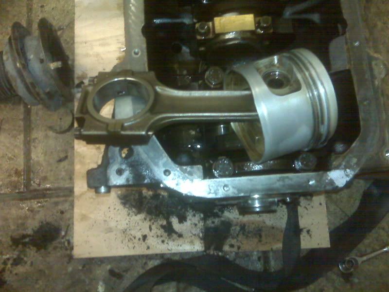

Sun Aug 16, 2009 11:56 pm

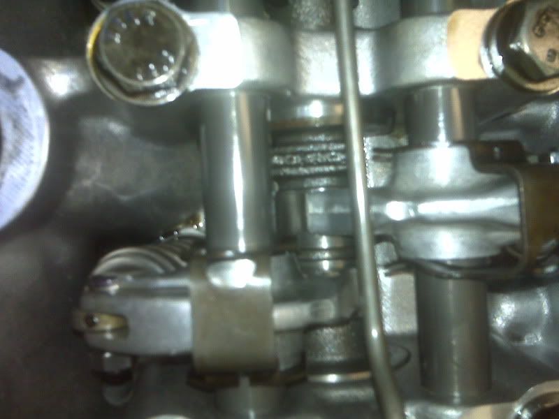

sump off pistons out :eek:
can anyone shed any light on these ?
do they look the same as standard 325i ?
TD crank ? I need to do some research :?

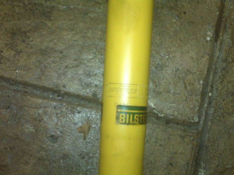

I also got the front legs from the H27 just because they were there, and the calipers were nice and clean
and was very suprised to see these inside :D
oh...and these markings on the springs :)

Is it possible that the cam says 274 and not 774?
Suprised Hartge stamp bilstein shocks!!
Also, no they dont look like 25i pistons at all, the indent pocket is smaller and the pin is closer to the edge. Nice.
