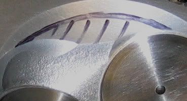

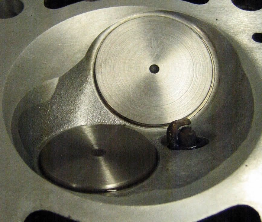

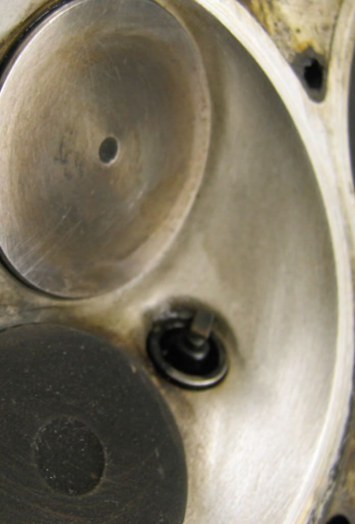

1st up heres a STANDARD 2.5 head. note the combustion chamber shape
And heres the C2 head. Massive difference. The little man in the brown engineers coat in Buchloe has taken a considerable amount of meat away, note both sides if the valves. On the plug side they've smothed it out. the biggest differences are opposite.
And heres a scketch of how much meat has gone

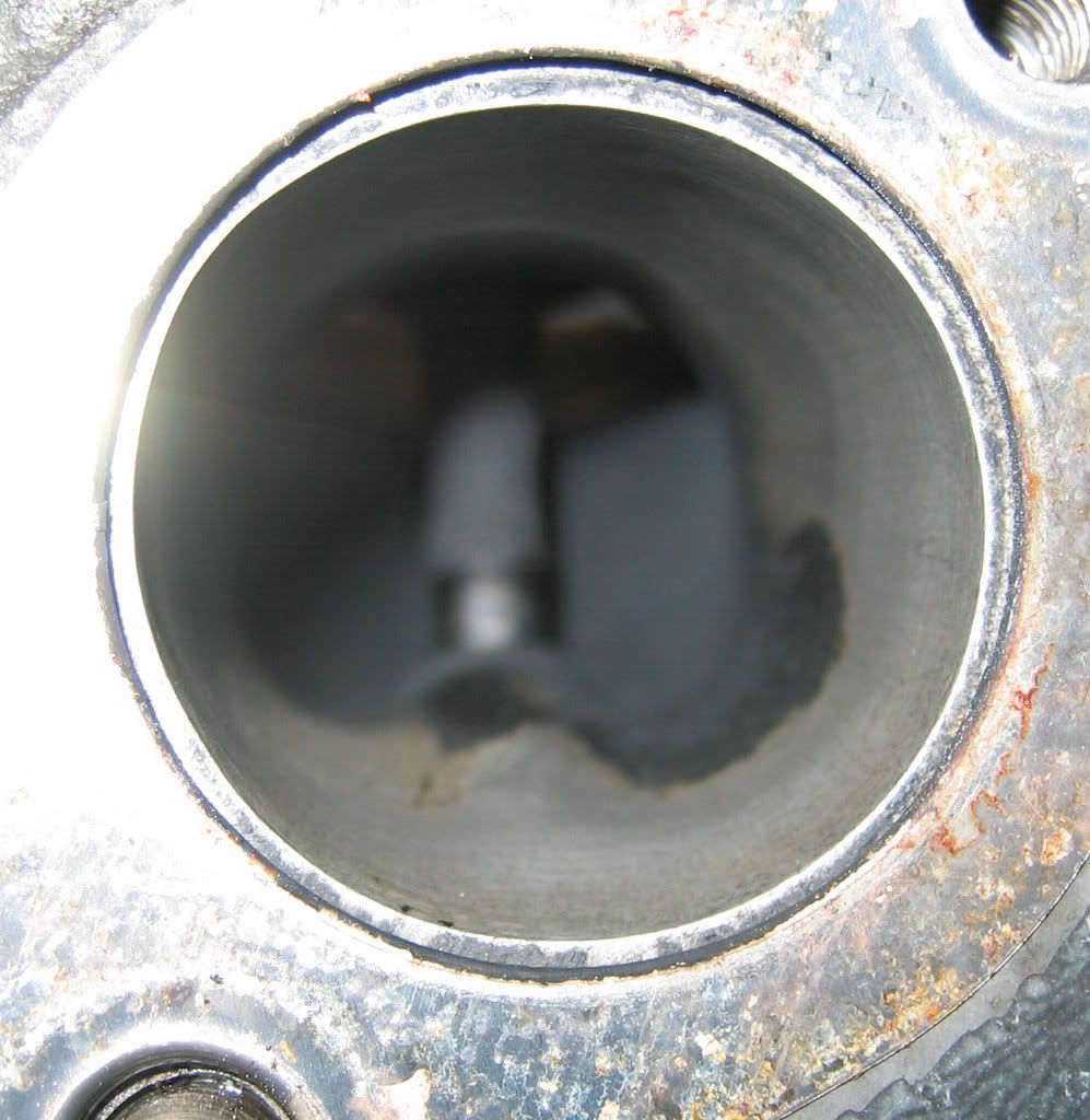

NEXT up we have the ports. The inlets on the C2 have just been smoothed out. No enlargement of any kind. HOWEVER, check the exhausts.
Standard 2.5 with gasket to show comparison. Note how it's not perfect round. from top to bottom it measures 31mm and from side to side it measures 32mm. from the top left to the bottom right (it's widest point) it's 34mm.
Alpina has maxed out this widest point to a perfect 34mm all round. Not they've not perfectly matched it to the gasket but left plenty on there.

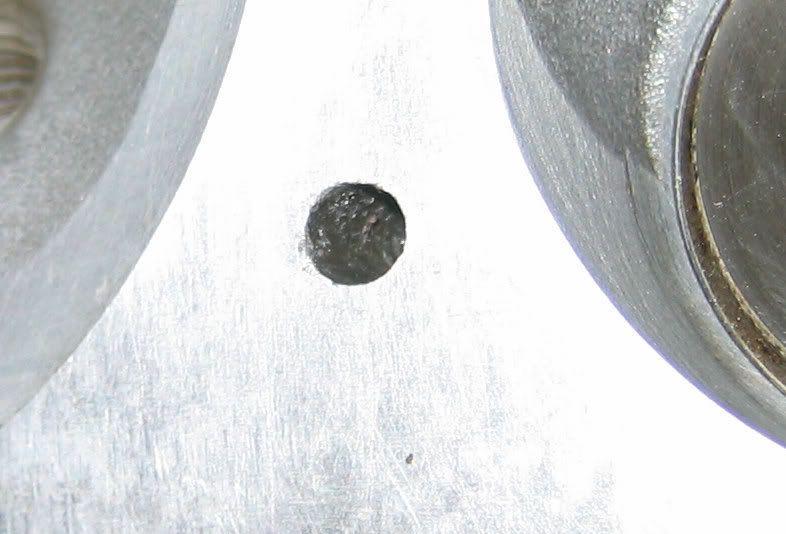

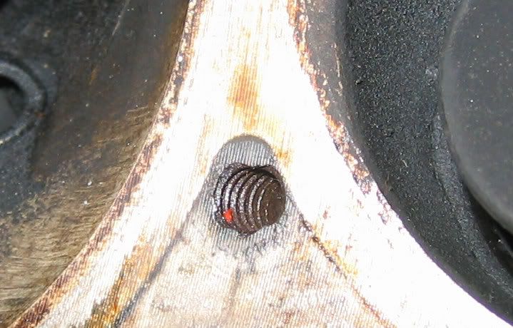

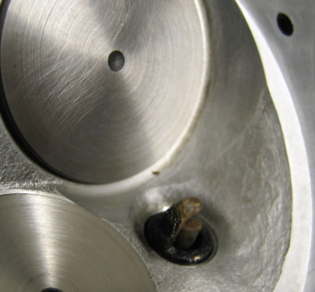

and heres an interesting point. The tiny steam escape holes between the chambers are threaded in the C2 but rough cast in mine. We wondered is there an underlying reason for this? But I reckon Si, you hit the nail on the head with the filling the water jacket with inert gas (or something?) when they weld the head to stop the build up of weld in the water jacket and so restricting flow. They would have to seal all escape route's
And there you have it. We finally know the head work on a C2

The threads could be for tooling purposes!?

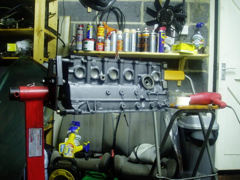

Also due to recent adverse weather conditions ive been busy/bored so i've spent an immense amount of time on the engine

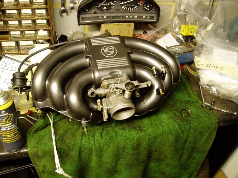

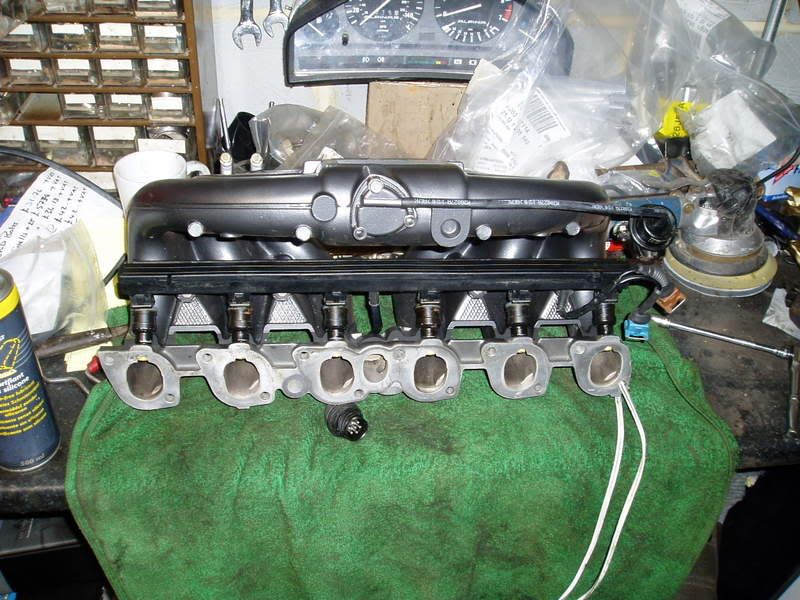

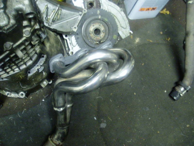

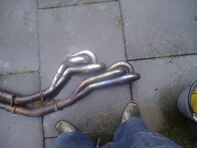

Cleaning up the Racing Dynamics 6 Branch - this has taken f**king hours!
I've painted the mild steel flanges with some black high temp paint also
Inlet and rocker painted courtesy of Trevor B7 cheers bert. So inlet all built up, i had the injectors cleaned also
Black painted again black
but it's grey! it says with some proper heat it will cure and go black i hope so!
ready for some shells............

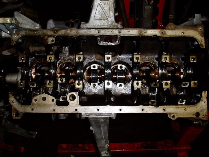

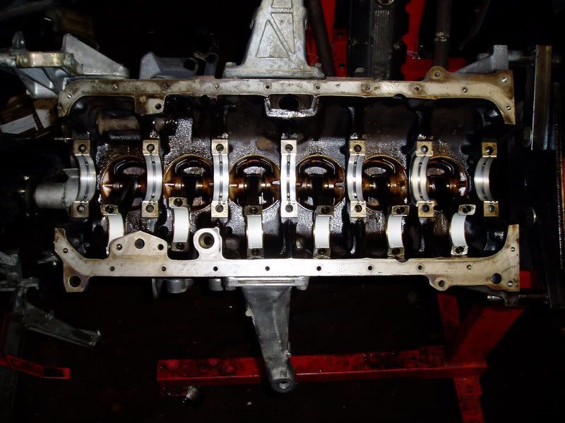

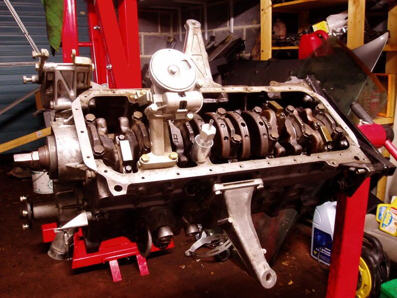

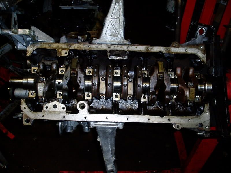

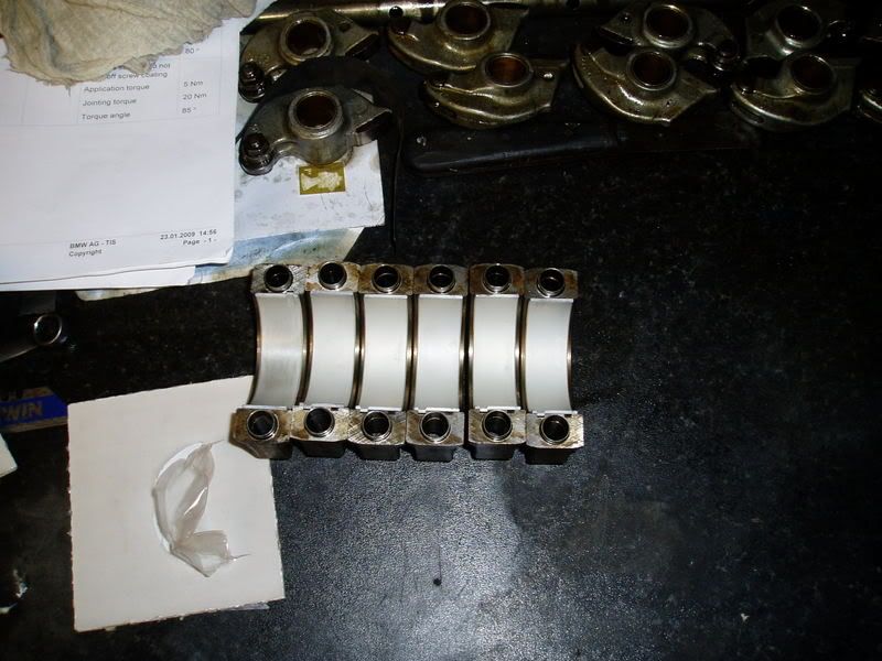

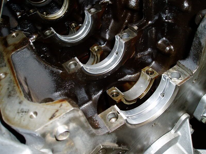

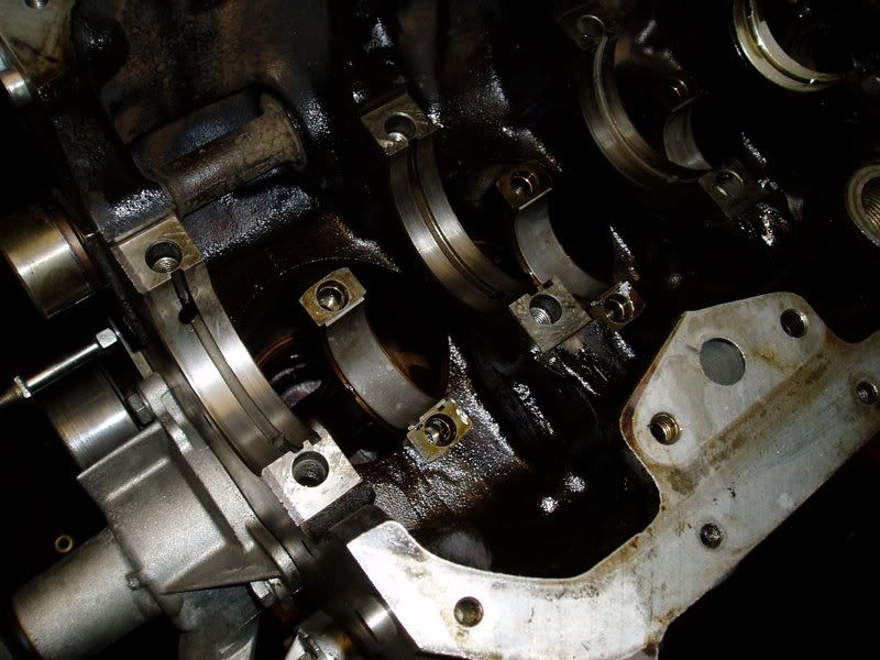

main end shells in the block
big end shells in the conrod caps
Shells all in now!

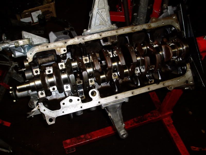

liberal coating of engine assembly lube

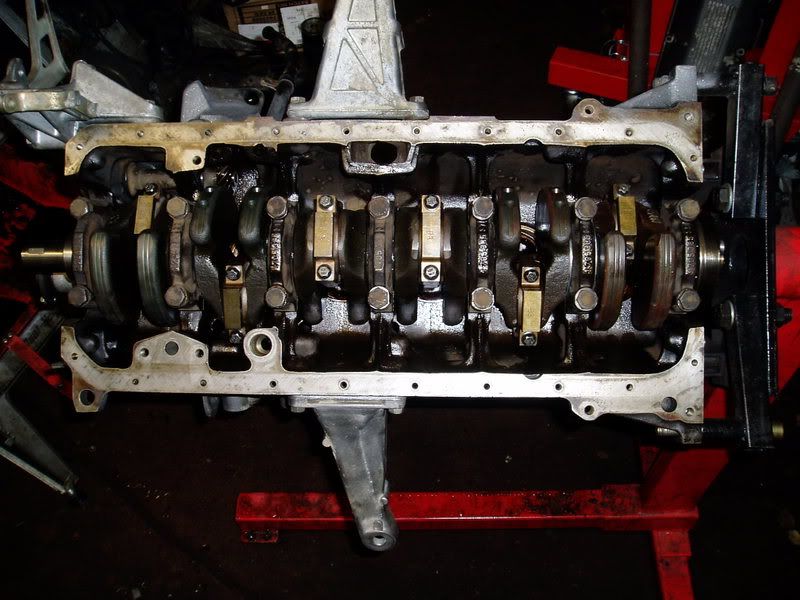

Crank in
big end caps on and 5NM application on the bolts
Main end caps on and torqued up along with the conrod bolts

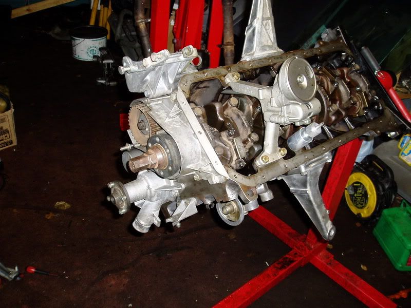

front end stuff on water pump, brackets new seals in front cover

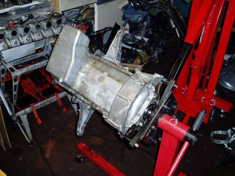

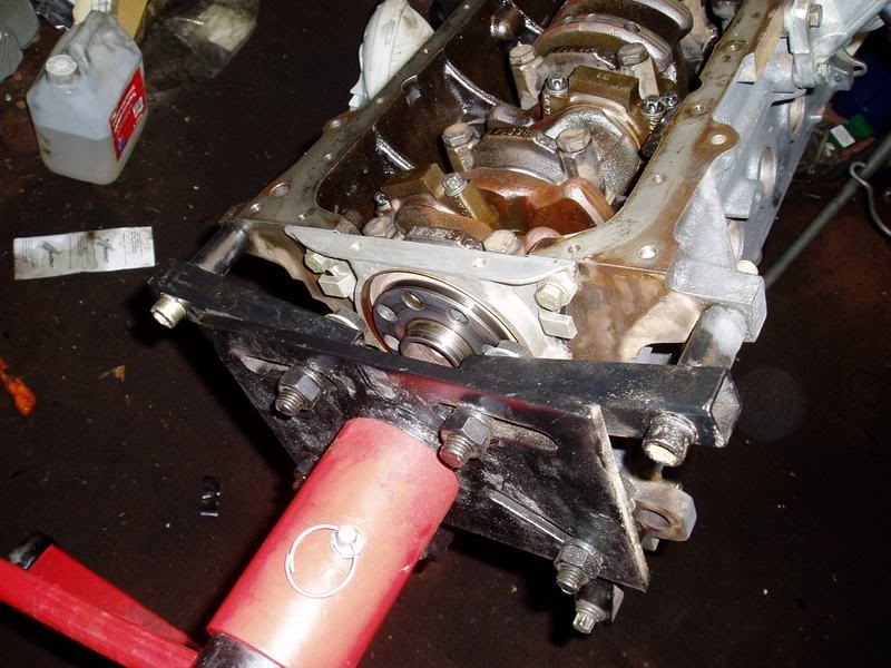

New rear crank seal and gasket on, i had to take the lump off the stand and strap it onto the crane for this as i couldn't torque the nuts up properly otherwise! pain but hey ho
Oil pump on, this was from PYF's second engine it's only covered 2000 miles. Plus that other shine silver thing can't remember it's proper name!
And finally sump on again, doesn't look much but it's taken a while. Most of it cleaning parts up i'm getting there. Shells where standard sized ones from BMW those plus the rod bolts best part of £300 with discount
should be good for another 150k i hope!
Shells all in now!
Crank in

good going Si !
rear main seal looks to be fitted the wrong way around though ?????
Original performance chips, original works not unlicensed copies
Email FTW
- Posts: 22697
bollocks! your right want a fookin plank
i just went out and looked. Distinct lack of concentration going on there.
That rear seal is £20 on it's own

At least it was spotted before you dropped the lump back in Si. Another good reason to post pics when carrying out work like this. Fair play to Ant.

Sorry Simon, didn't mean to pi$$ on your parade dude
I fear the front cover seals are also back to front, I can see the springs in the pic no ?? didn't see it before now
What mains did you use in the end ? the ones for the M21 mill ?

Ant, never thought of M21, but the part numbers of all the old shells were 325i ones mains and big ends, so thats what i've fitted
looking on real OEM the part numbers are different for M21 mains, i'm guessing they would be under more stress in a diesel due to much higher CR. The Td crank in a petrol lump won't be giving them as much grief no?
- Posts: 22697
just checked real OEM again and part numbers for shells on the 324td,eta and 325i lumps all share the same part numbers for mains and big ends it looks
I looked at the 324d first time which lists different part no.s for it's shells

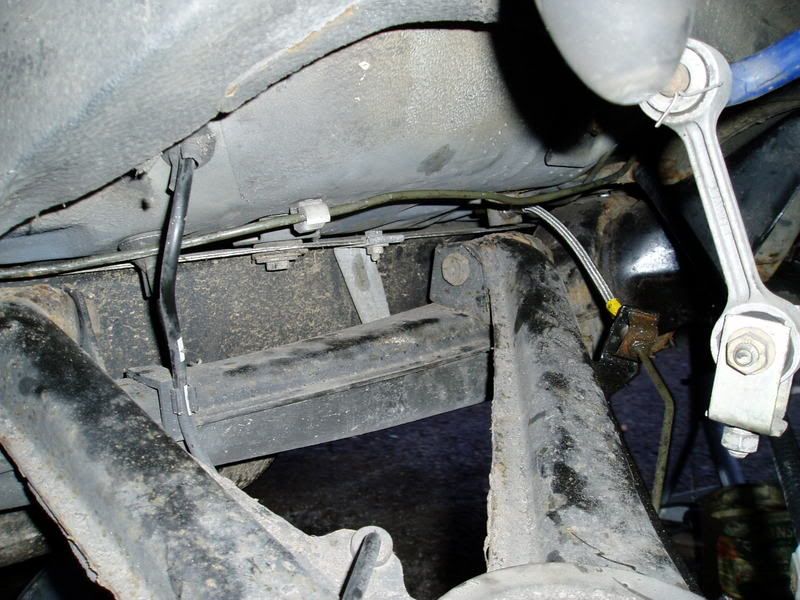

Cracking on with the fierce jobs at the moment, with the head away and awaiting a camshaft i can't do anymore on the engine so

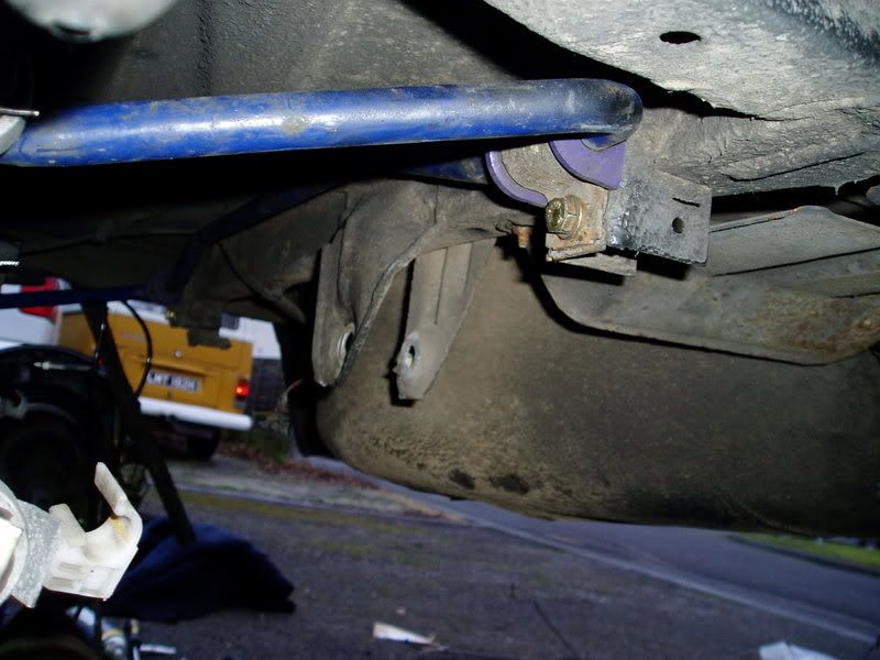

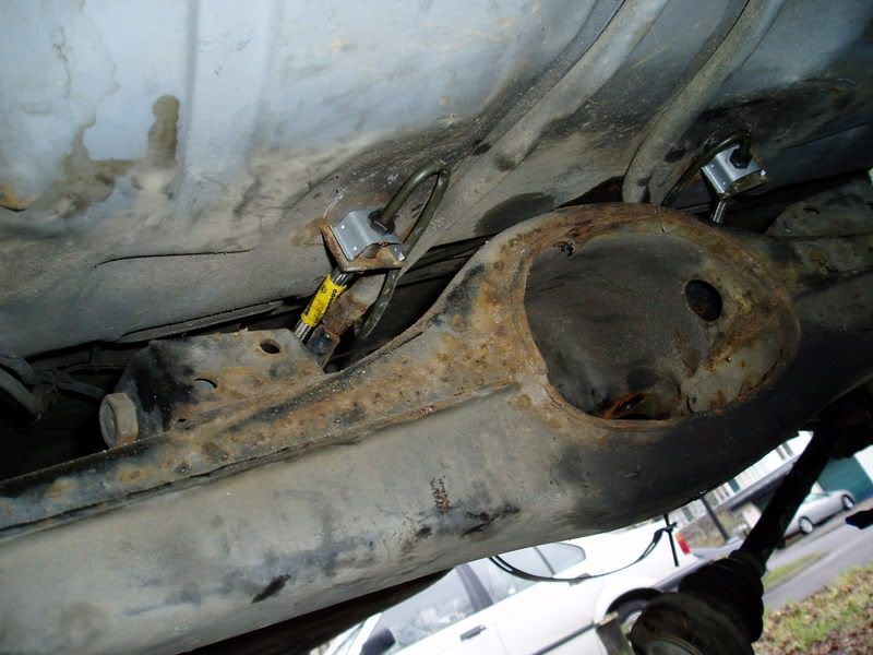

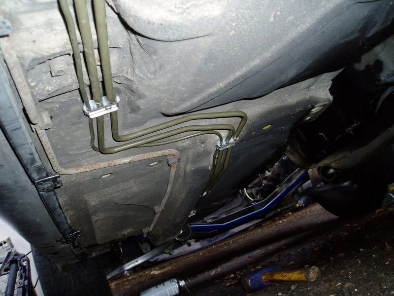

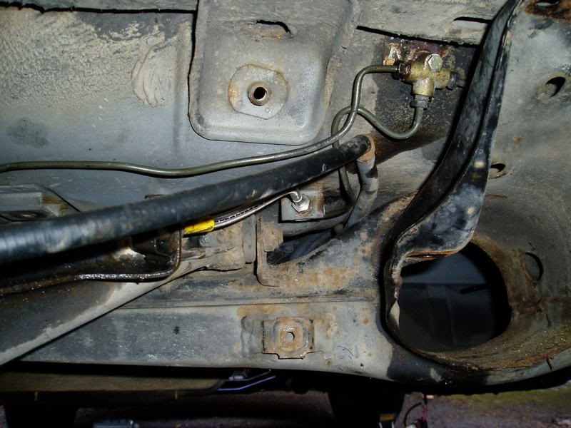

This job is horrific. Getting the old 10mm bolt which holds the old T-piece on can be a total nightmare like today! Half the rear end needs to be removed also, ie fuel tank,prop, exhaust which are all sad jobs!
Front to rear brake pipe isn't funny either

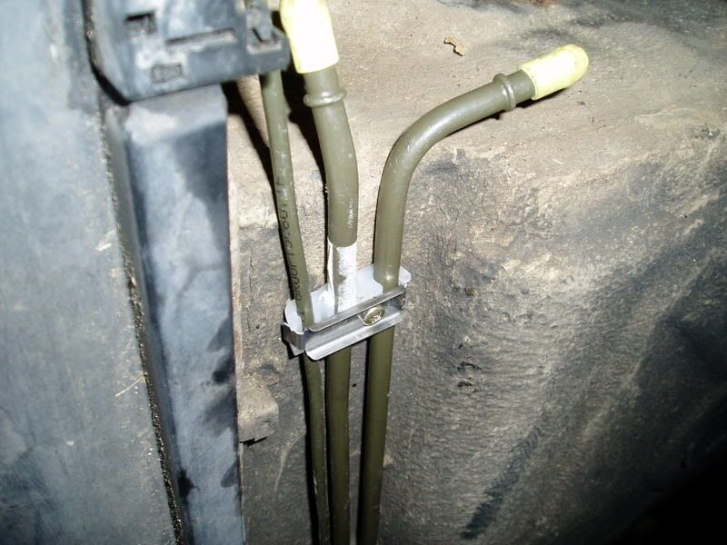

The old fuel lines where pretty ripe and turns out an advisory on several old MOT's along with the brake lines. I've had these pipes and brackets a while for the 2 door but..........
Hartge rear bar on
Crap shot but the new fuel tank in also as the old one was well on the way round the seems and filler neck stub
All these bits came off PYF bar the fuel lines. Save me £££. Not much to see but it's these kind of things that 95% of E30's need doing now
Hartge rear bar on

Have you done the fuel tank yet - that is equally as horrific. Nice work though - isn't it about time you added a cabriolet to the Alpina collection hmm?

Doing the front to rear pipe and the fuel pipes is soul destroying but satisfying at the same time
