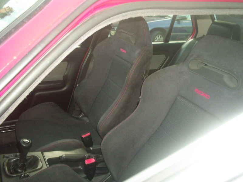

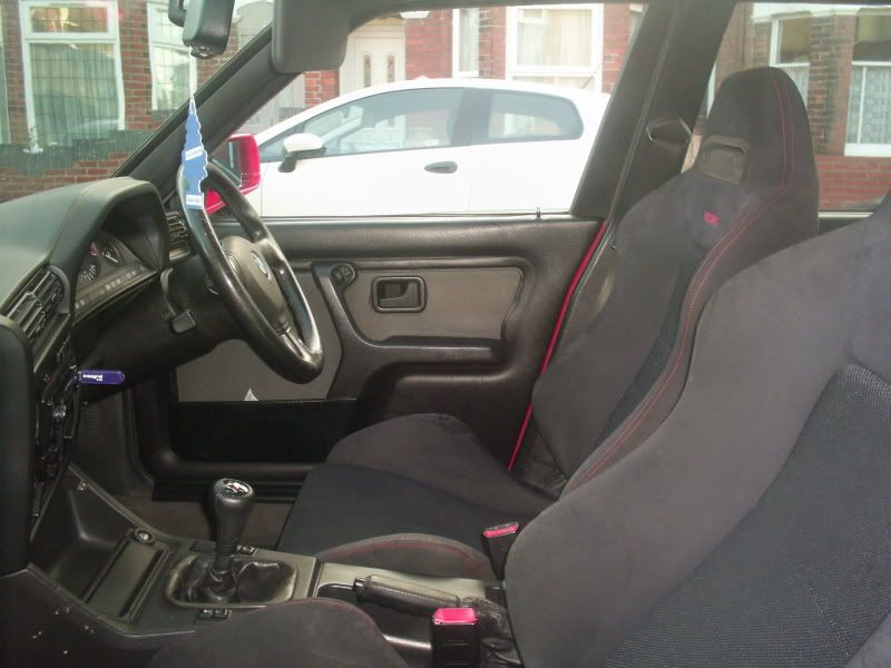

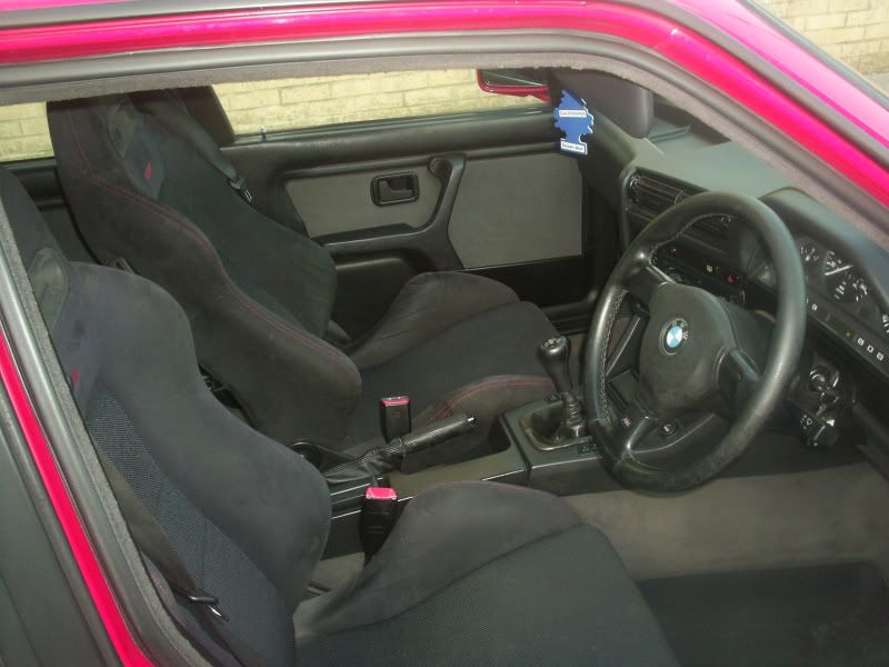

In the meantime, Recaro SRD's Mother-Fu*kers!
In a moordoor no less -HAHAHAHAHA!
Nice seats!

Thanks Barry, and thanks Jhonno for the seats!
