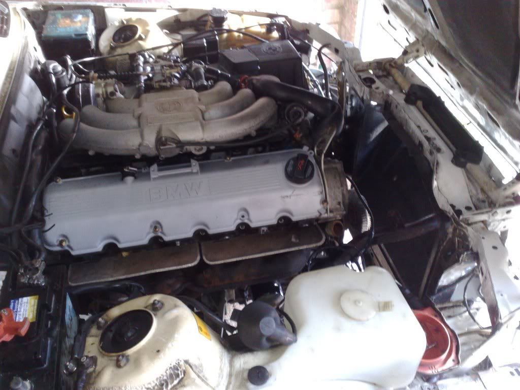

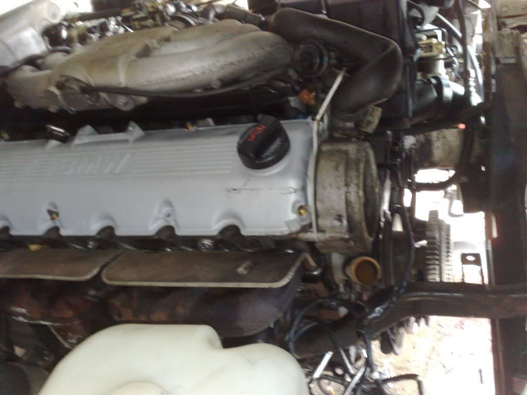

Done a bit more today, i Bodged the blowing exhaust manifold joint with some exhaust paste, sounds much better now all the bangs and knocks have gone since ive done it.
Sounds like a 6 pot again
http://s153.photobucket.com/albums/s240 ... 010021.flv

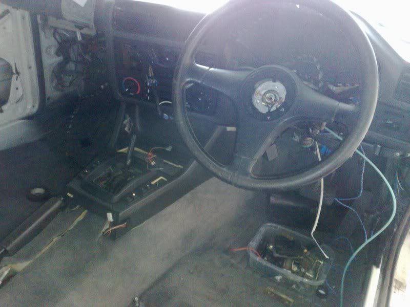

nearly sorted with wiring in the car, anyone know where the cruise control ECU goes????
Also after firing it up and letting it run for a bit i noticed water running out under the car, rad was pissing out water so i'am going to need a new one
i bet there expensive for autos too
got carried away once the rad was out and thought i may as well do water pump and cam belt, even though ive never done these before, ive read millions of guides and step by step things for the m20 and seems straight forward enough. Pas and Alt belt didnt look too good either neither did rotor arm but dissy looked quite good
although some of the pins had a bit of wear very slightly on the corners. the rad seemed to be full off orange rusty water and muck
wonder when it was last changed
also soaked the engine bay in Engine and machine cleaner then once it dried plenty of wd40, ive found it you do it the other way rond you get a dreadfull mess
also pulled intake off and soaked that in wd40 along with ICV, i wanted to use Carb and intake cleaner but halfaruds had ran out
thats as far as i got today

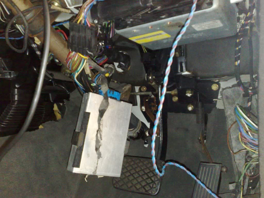

Alex the cruise control ECU locates on the left hand side of the car, open the glovebox and you'll see the bracket in the middle at the top, the one with the glovebox light and switch fitted, it sits just above that, there is a bracket to fix it down securely.
I have just fitted cruise this afternoon to my new moredoor, i wedged the ECU in just fine without the bracket......

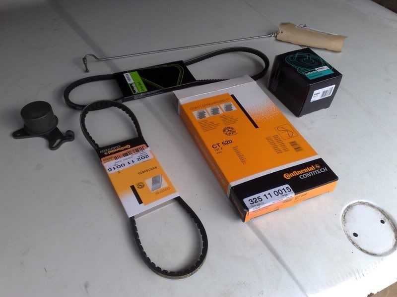

about to order a timing belt and water pump

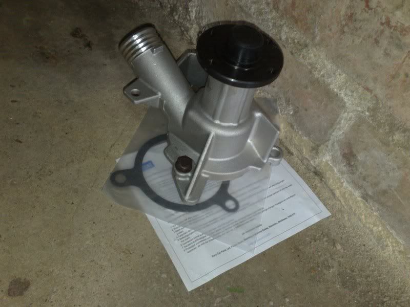

whats the difference, first one looks like it has an extra outlet
http://www.eurocarparts.com/ecp/c/BMW_3 ... 155e6&WATP
http://www.eurocarparts.com/ecp/c/BMW_3 ... 317d8&WATP
i assume i will need to order the gasket too

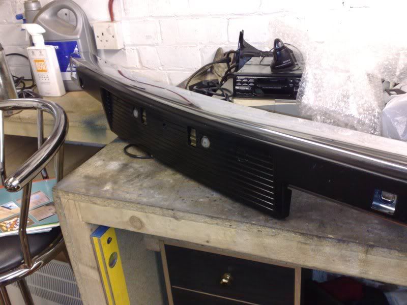

Getting the lot, alpina front spoiler, 16" pina wheels, pina plaque, grill badge (just bought oneBlitz wrote:Alex are you putting an Alpina front spoiler on yours. If yes are you getting Alpina wheels or sticking with BBS's?

I also noticed I prefer the earliest pina front spoiler to the later chromie one.

one is pre and one is post face lift the pre facelift one has two inlets for water and the post facelift has one one inlet for water.Alex wrote:Thanks, will probably just get a new bmw one though.

yep i figured that out
got it sat behind me in a huge ecp box

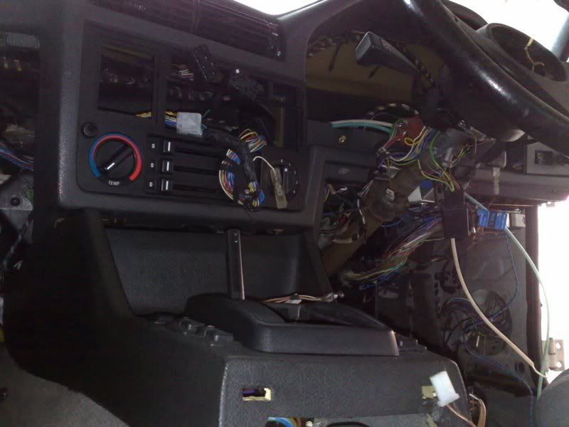

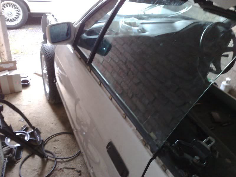

got the window mechs all working, heater surround panel is fitted, along with front part of the center console, spent ages cleaning it with microsfibre cloths etc

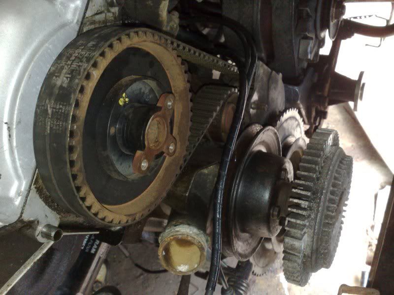

, fitted wing mirror, nearly got access to the timing belt, i should make sure i have the correct tools next time i go out
any advice on getting the viscous clutch off, i did it on the IS last summer but god knows how i'am going to do it this time, it just spins
i tried to get the water pump off with the viscous etc still on but have only managed to get 2 of the 3 nuts off, the other is further down past lower timing case by the looks of things

this is how interior is looking, slowly getting there, cant wait to pick the interior and wings up in 2-3 weeks

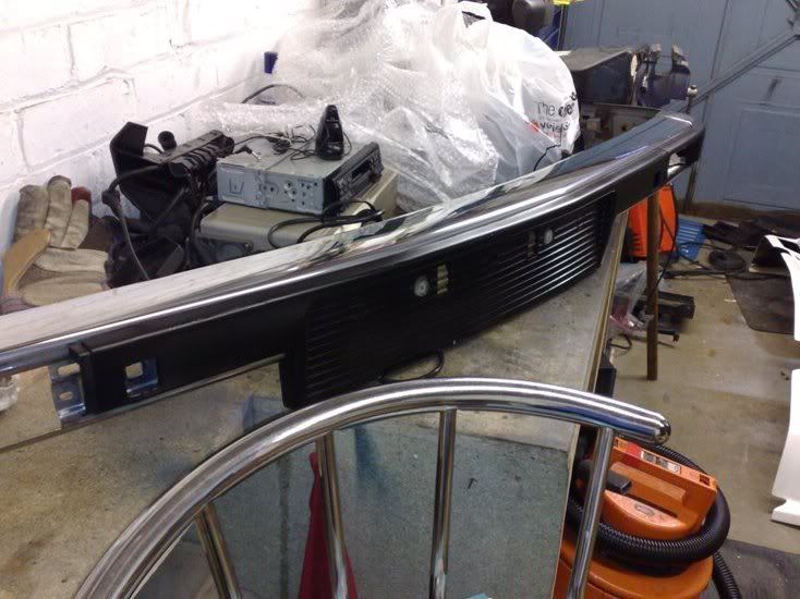

i used 3m stainless steel cleaner on the chrome (it was in the boot of my old 318i chromie and is awsome at cleaning chrome)
