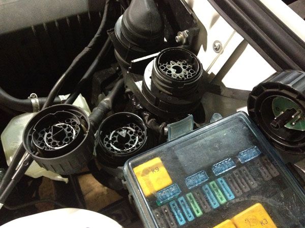

crossie
Posts: 472
Joined: Mon Sep 05, 2005 11:00 pm
Location: York
Sat Mar 23, 2013 11:38 pm
service plug = fault code fixer!
winx
Posts: 1099
Joined: Wed Jul 30, 2008 11:00 pm
Location: almost certainly not working on my E30...
Sat Mar 23, 2013 11:44 pm
crossie wrote:Image
Ah thanks for that, I thought the plug on the right was for that.

Sat Mar 23, 2013 11:55 pm
sorry -no idea on the left one

Have you already wired the C101 and got rid of the old X20?
If so the other two plugs will be for traction control and autobox

DanThe wrote:Have you already wired the C101 and got rid of the old X20?
Yup this one is spare so I'll bin them, cheers Dan (again!)

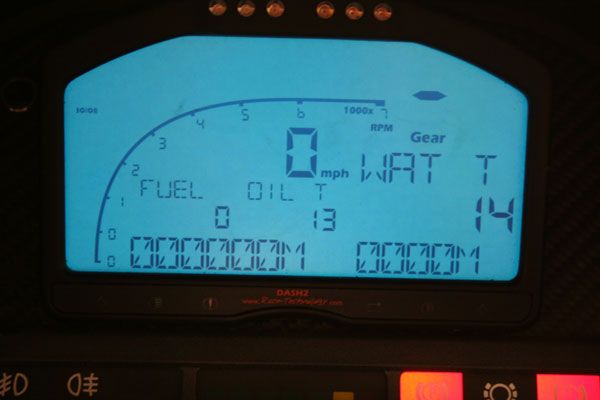

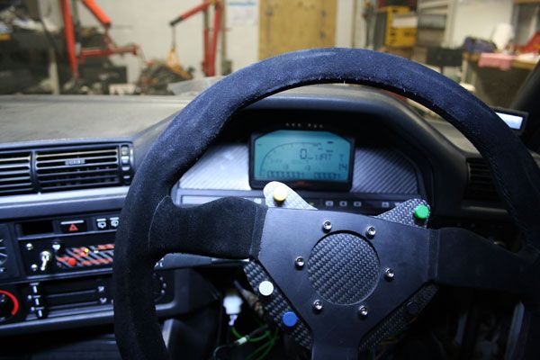

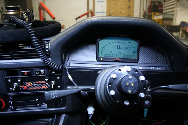

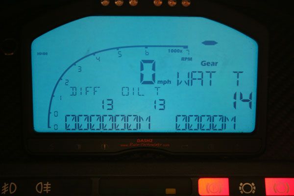

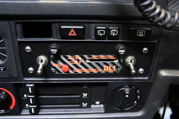

Almost finished wiring in the dash and mounting the logger, just speedo and fuel level to finish.
View with wheel removed:
And wheel on:
Probably the screen I will use on the road:
And on track to start with:
Once I get used to it the lap timer will probably be up, its got some serious stuff like being able to show 'time slip' between current lap and best lap.
Logger in place:
I tried a plastic blacking plate but it was too flimsy so used sheet ali for the front and made a back plate for the 4 bolts to sandwich the surround. The logger and the dash both need 0.5 amp fuses and I have heard a few people having problems with the dash very occasionally freezing so I have fitted switches for the logger and the dash so they can be switched independently of the ignition as well as working with it.
I hope to find this really useful, I can log diff temperature for instance to look back after the day and see if I am managing without a diff cooler, same for engine oil etc etc.

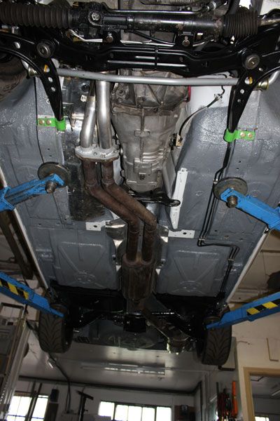

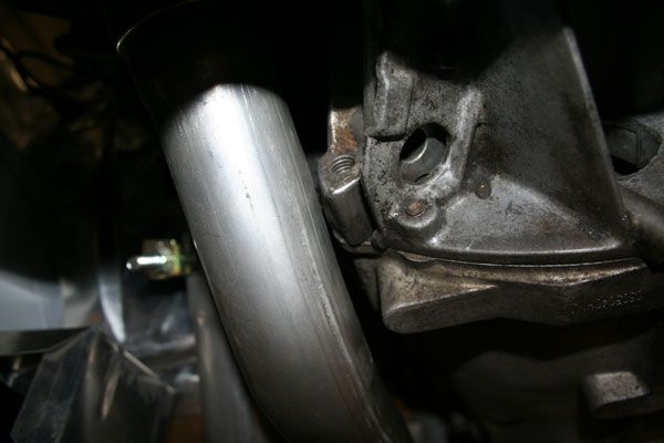

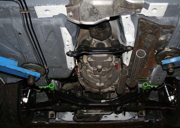

Started to bolt up the DanThe exhaust as next job is welding on the M3 flange for my existing system. Both downpipes interfere with either the block or gearbox so quite a bit of grinding was needed! This is much better than it looks:
More stuff bolted up:

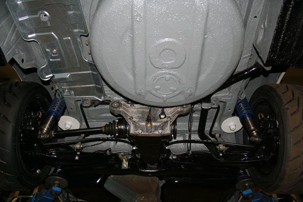

Rear end coming together, just a drive shaft to fit:

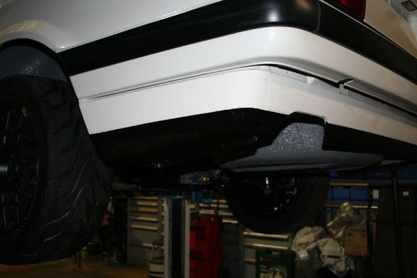

Now the undersealing is done stuff like the new tank mud guards could be fitted and brake/fuel pipes bolted up for good:
I also gave the rear end a quick refurb as the white was looking distinctly yellow and the black grey!
Starting to feel quite close to getting it to the MOT, might even be this year!

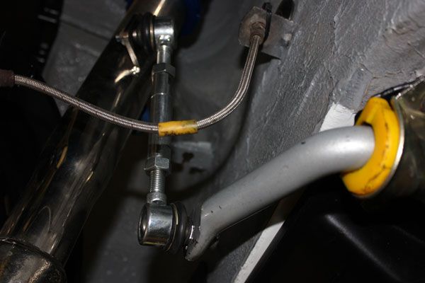

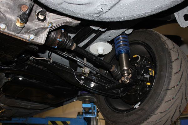

Fitted the other driveshaft:
Bought an ARB from here, can't remember exactly which one it is now but was something like Whiteline I think?

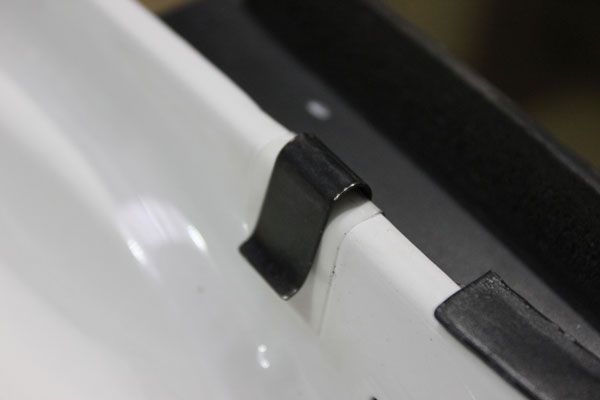

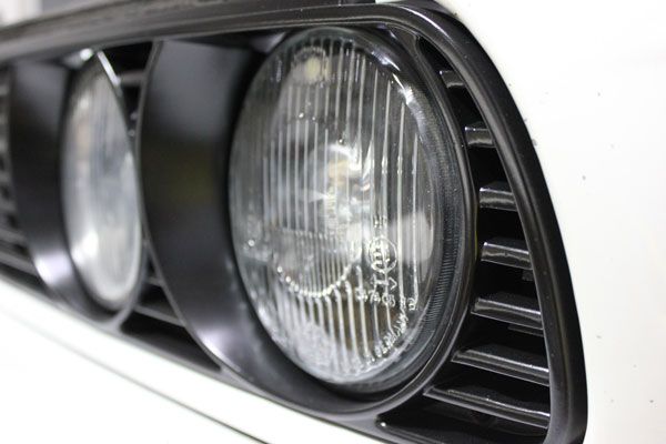

Painted the front grills to smarten them up a but, still cant decide whether to do the kidneys white as they were or black??

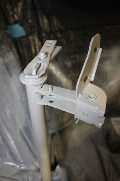

Then fitted the clips that hold them on. As the bay has been painted I didn't want to scratch the paint so used a small offcut of helicopter tape to protect it:

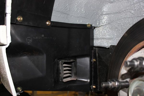

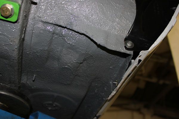

Was fitting my old arch liners and decided they were a little scabby so rang BMW... Only 1 of each side left in Germany so VOR'd them :):):) As is my illness I also had to order all the clips and screws new as well.

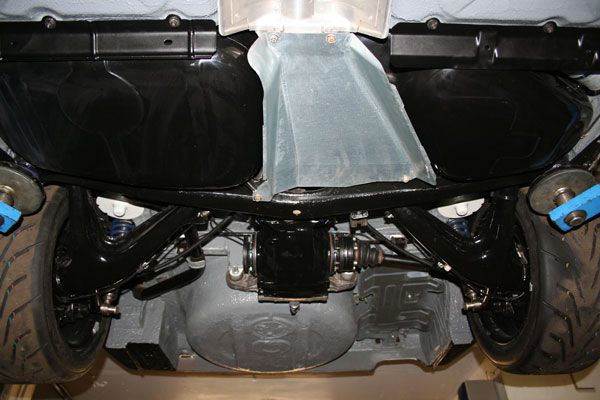

When I did some welding underneath I removed the lifting pads but kept the angled part, so although it wasnt the original fixing the arch liners will bolt up:

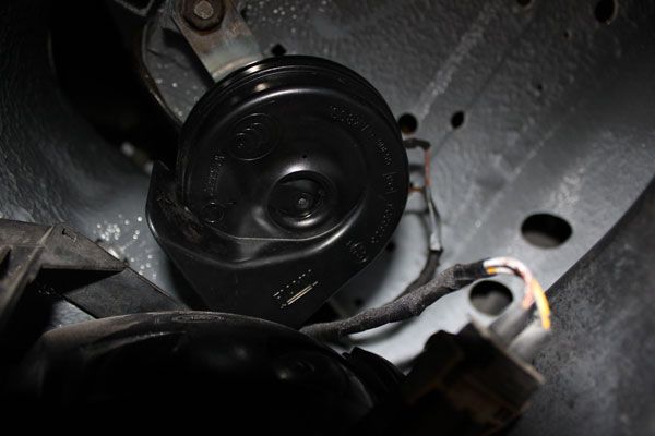

Horns looked rank so had these in stock from my Land Rover days, new one on each side, twin tone of course!

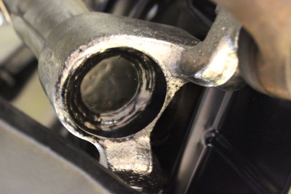

Whilst under there I found that the bottom of the brand new Gaz coilovers were rusting. I guess they didnt blast them properly before coating them so I scarfed it back and painted them black:

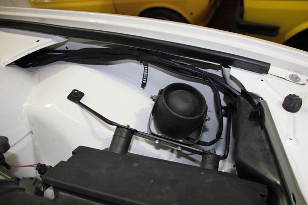

Fitted the siren:

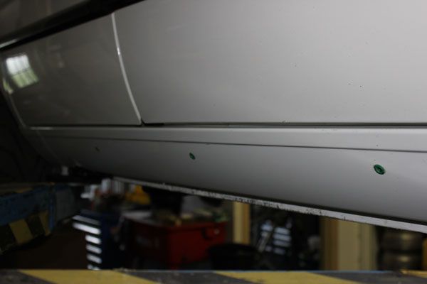

Cleaned up both sills ready for SE sill panels
DanThe kindly swapped the downpipes for ones that would fit an M3 flange, so welded it up and fitted the zorst.

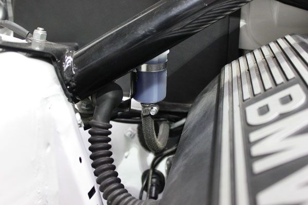

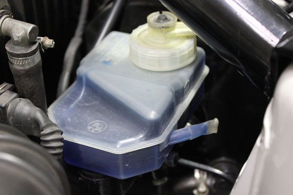

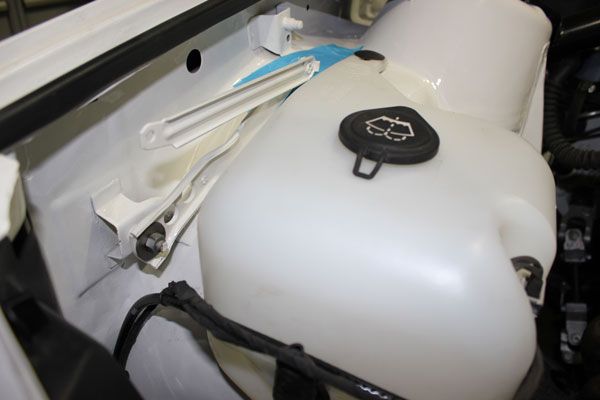

Fitted the washer bottle and re-wired the pump as it had been in the battery tray with an IX bottle before, also painted the bonnet strut and bought the correct fixings:

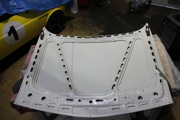

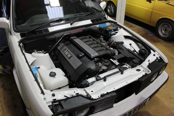

Spent Aaaaggeeesss cleaning underneath the bonnet and removed the rust where the bonnet hinge fits:

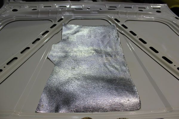

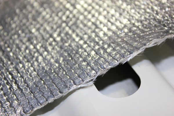

Next job is to make some insulation panels for the 3 cut outs, not for sound insulation but just to reflect some of the heat of the painted top surface:
We use this stuff on the F1s at work so it should be good enough for me!

The fan won't cut in so need to try and work out why. The fan works but I think it is the fan switch (new from BMW...)
Bay as it stands, blue tape around the fuse box is from where I was tracing fan wiring and didn't want to damage the paint.
So there we have it, as the car stands tonight it is pretty close to an MOT!

winx wrote:
Jon_Bmw wrote:Trackday at Abingdon on the 21st? :)
There will be a trackday at Abingdon this year but don't have the balls to book it before the car is MOT'd! I'll be in touch when I do, I know Theo is interested and Barry wants his missus to drive his knuckle dragger on track at Abingdon as well...
Thanks to the others for your comments, we are getting there. The paintshop at work have just delivered back a lurvely IS front lip for me so that might go on tonight.

winx wrote: Image
Where do the bolts screw into behind this panel? Do you have any photos? I used an adhesive to glue in an aluminium panel there but as soon as I pulled on it, it fell out :mad:
