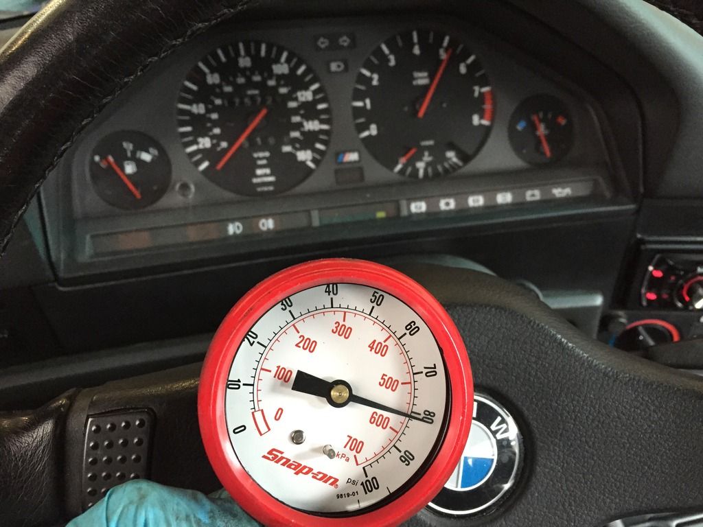

So I've now covered approx 1000 miles in it and it's been rock solid until yesterday when it failed to start after an hours drive. A hard tap on the starter motor and it span into life so a new starter motor is in order.
With the ring trip looming ever closer and I thought it prudent to check the health of the engine a bit more than a visual inspection of the top end.
First thing was an oil pressure test so after a run to get the engine up to temp I took a reading. Bmw specify 7-28 psi at idle and 57-85 psi at Max rpm. We as you can see in the pic above it was just over 80 psi at approx 5500 rpm and did not climb higher than that with any more rpm so pretty much perfect oil pressure! Happy days!

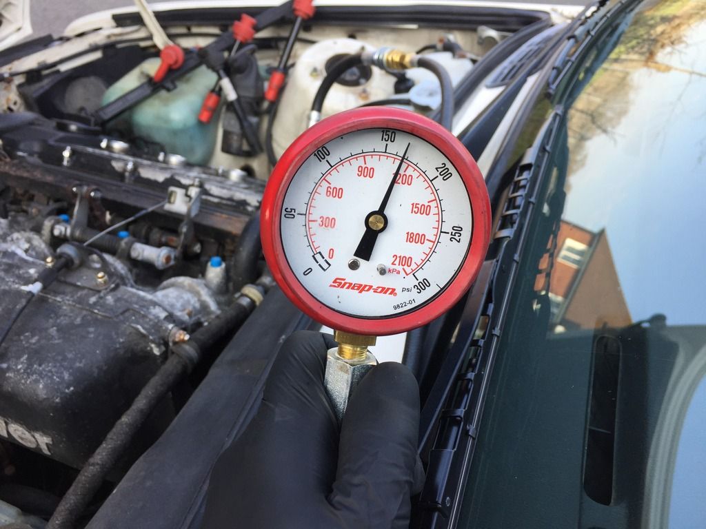

Next up a compression test resulted in a pretty even 160-170 psi across all four cylinders and going on BMW's specified data which is 10-11 bar minimum (145-159 psi), it within spec. Now from what I've read of other people's S14 compression tests, some seem to be getting up to and over 180 psi but I guess given the high mileage it's not too bad and most important of all, heathy enough to take on track without fear of it grenading itself. I hope!

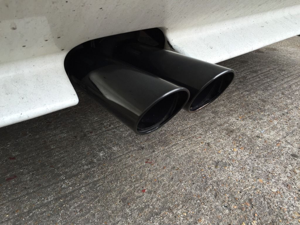

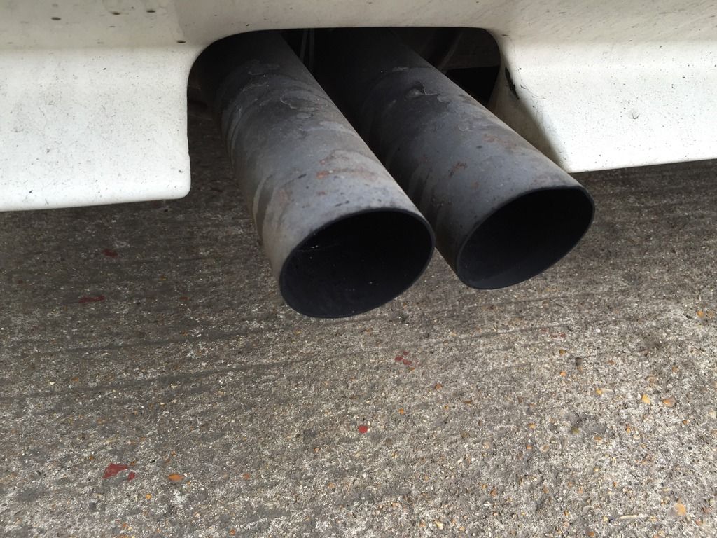

These bare tail pipes were letting the side down so as a reward for not being a tired old nail of an S14 it got a pair of oem shaddow line tail pipe trims.
Much better!

Do you do the compression test with the throttles shut? Probably why your reading is lower than others

Hmmm, that is low Barry, did you have a nice booster on the battery, is the starter ok?

Dan, yes throttle wide open.
Andrew, the battery is good but the starter is a bit slow imo and has started to give trouble as per my prev post. I need to put a starter on any way so I'll test it again after I've replaced so we shall see.

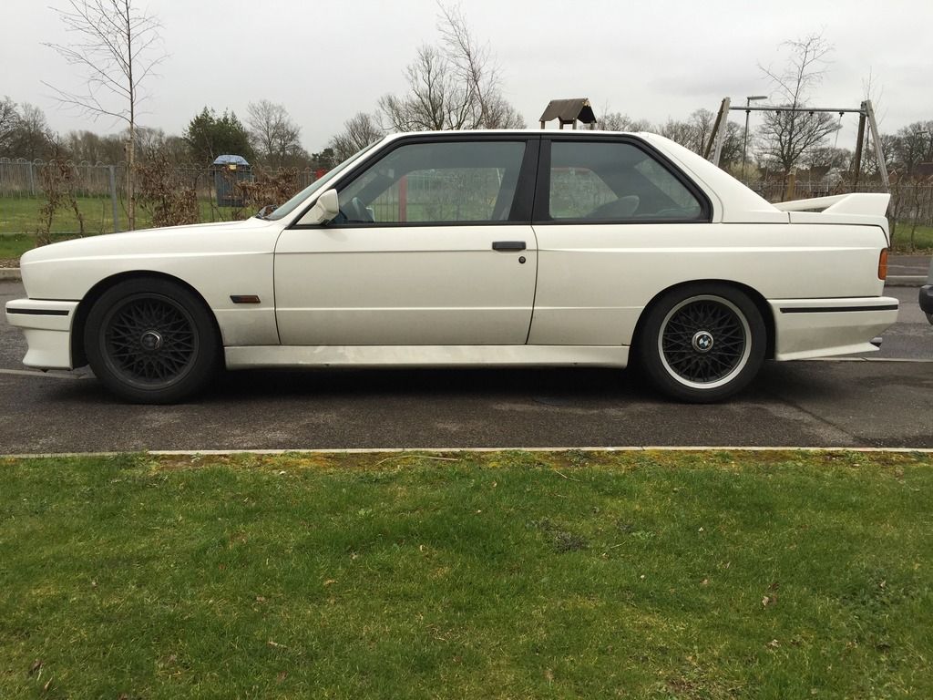

Sat Apr 18, 2015 8:41 pm
A minor update but the car was in need of some new rubber as the bridgestones were finished on the rear and starting to perrish on the front so a set of continental sport contact 2's in the correct 225/45/16 were ordered up.
Tyre availability in this size is now becoming very limited with choice now limited to these, some toyos, falkens or budget rubbish.
Luckily the conti's are a great tyre with awesome dry grip, good wet grip and reasonable wear rates. I had a set on my 325i with staggered alpinas as well as driving all sorts of other cars with them and rate them highly.
A stroke of luck came my way in that someone had a freshly lessons refurbished 16" BBS in sport Evo style of Nagaro centre and silver lip but was going to have them redone in Ceccotto style like mine were. Now i always intended to have mine refurbed to either silver or nagaro centred at some point as I was not keen on the black so by a stroke of luck, I swapped mine which needed a refurb for the freshly done ones in Nagaro!
£260 worth of refurb gratis, winner! :D
So new rubber on like new Sport Evo wheels topped of with some new genuine roundels.
Much better! :D
