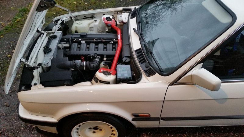

Sat Oct 31, 2015 10:22 pm
Well i'm in fookin love, i've had to change my pants 4 times already today, keep on doing a little man wee everytime i hit the load peddle!
Drove the car home 130 miles from Stafford, gorgeous engine, so torquey 5th gear acceleration is addictive. Because of the 3.64 LSD matched to e36 gearbox 100mph = 5000rpm but i reckon that'll be bang on on track. This will be a hoot and that was always the plan.
Brakes are spot on too which was such a problem prior to giving the car to Dan. Complete change of plan styling wise, the plan was skirts, big rear spoiler, Dan put on a new boot lid for me with no spoiler, i love the clean lines and i cannot bring myself to drill the perfect sills so i'm going for the wolf in sheeps clothing look.
Thanks Dan, I am one happy Muzza!

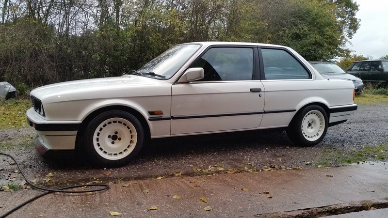

Sun Nov 01, 2015 5:23 pm
Muzz2676 wrote:
jimbom30cab wrote:Brilliant !! I bet that drive home was fun, you must have been a little nervous though??
It's a really, really nice car this, i did have a look round when i was Dan's place, one of the cleanest shells out there.
Have fun and enjoy
Drive home was huge fun, I was okay with the nerves as I had the missus with the 'ump and was in my ear 'ole as I was running late for getting my boy to a Halloween party :-)
It is a really clean car and that's why I'm not adding side skirts and spoilers. Bit of surface rust in the driver side rear wheel arch which I'll get sorted.
Washed and polished the car this morning and put in the wheel centre caps, went out this afternoon with a mate armed with the SLR to get some nice scenic pictures, bloody blanket fog dropped in minutes, couldn't see a bloody thing so gave up and returned home.
I let my mate have a go, he's an engineer at Ford's and designed the latest Focus ST engine mounts so he spends loads of time on track and road testing, he loved the car - the power delivery, noise, handling, in fact everything, he was stunned. The only criticism were high biting point of the clutch (agreed) and the bite of the brakes, although I think that is down to only driving modern over servo'd cars too much

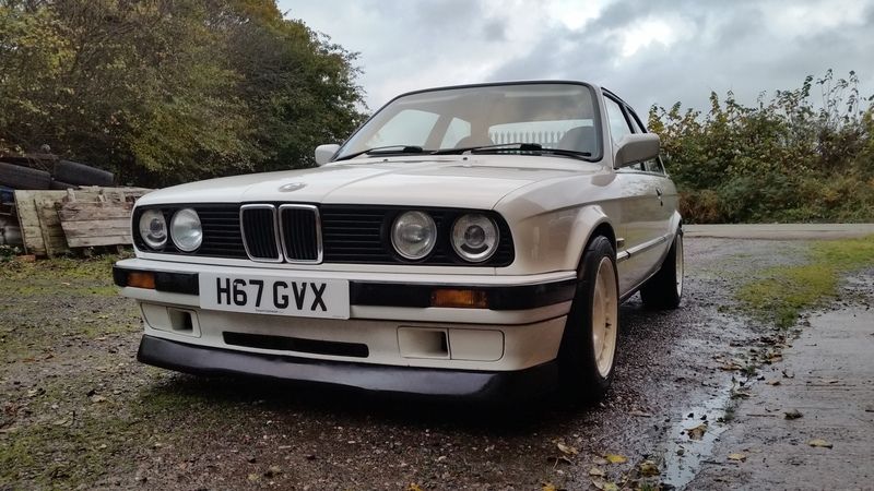

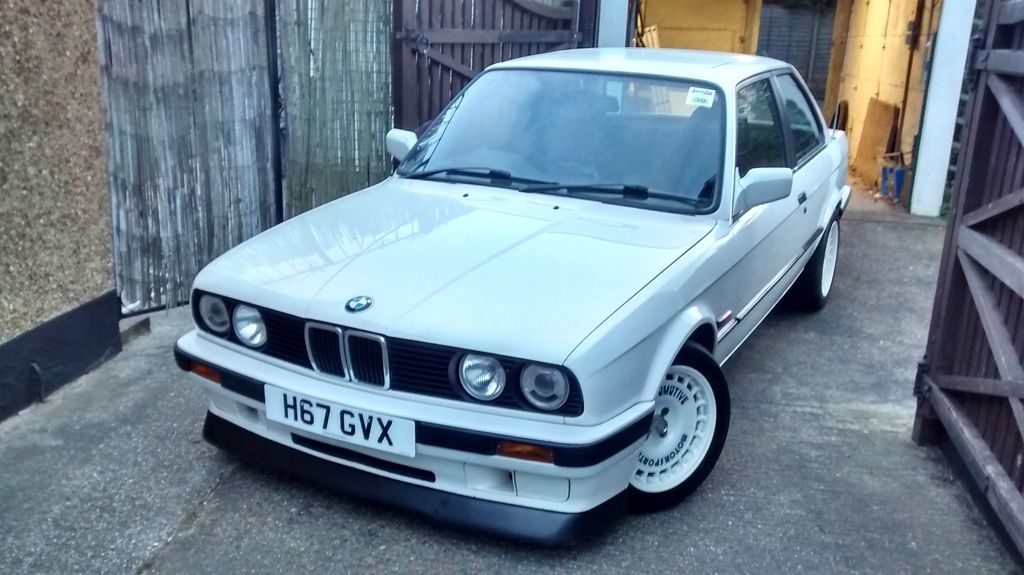

Fri Mar 04, 2016 5:03 pm

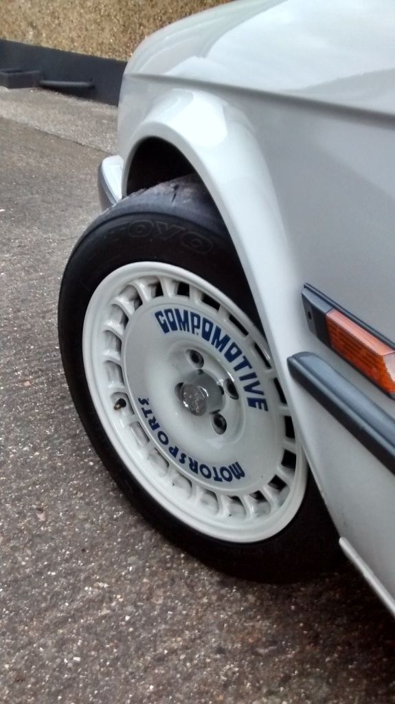

Little update, bought BC Coilovers 10kg Fr/ 12 kg Rear and added a few choice stickers.

Sat Mar 05, 2016 8:52 am
I love this car. perfect little track toy. Top job Ian & Dan!
My only small and extremely petty little quibble is the front wipers look crap... stick some standard bosch ones on instead of the crappy flippy floppy aero blades :D

Sat Mar 05, 2016 6:17 pm
P_VIDDY wrote:I love this car. perfect little track toy. Top job Ian & Dan!
Lol, never even noticed. Point taken and will rectify immediately :D
