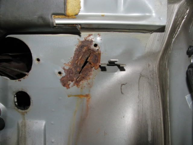

Alex wrote:Today started off well, plan was to get rest of interior back in but the enjoyment soon worn off.
goodbye bulkhead :-x
sometimes wish i bought a cheaper tech 1 :(
a cheaper one would be far far worse than what you have mate
that is quite bad, I expect it will get a lot worse when you start digging it looks to be under the wiper motor area above too ?
it's going to be hard for them to get in and weld this properly will be best to have the dash out and strip back the insulation ..also the fusebox will be in the way :(

That just goes to show that it doesnt matter how clean the car looks, On top and underneeth. These turds hide rot like any other 20 + year old car.
Its much better found now than when its taken a good hold mate.
Its a cracking motor, you wouldnt want a cheaper Tech 1. You would be sweeping it up in buckets by now :D

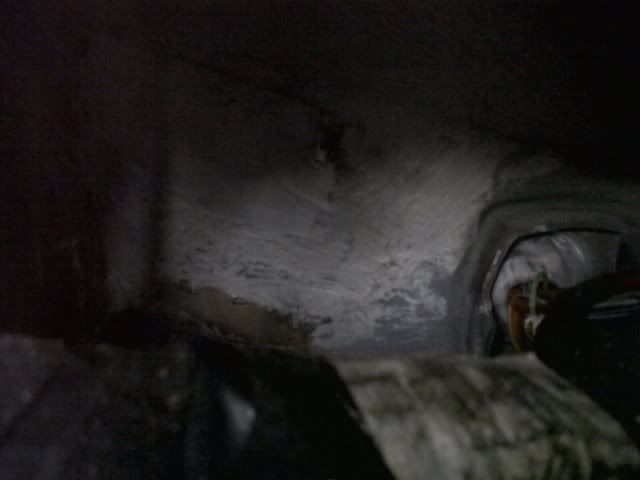

yer it does look difficult he looked at it for a few mins in the inner arch and from inside and gave me a quote but i expect the quote to double if not tripple when he starts digging
might remove the fuse box at the weekend and all the insulation

Alas this a really common weak spot on e30s. People need to realise that these are now old cars and the first job on the list when you buy one is to strip all the splashguards and trim out and look for and repair any nasties that you come across.
Nearly every e30 I now come across , even the very shiny expensive ones , have issues in areas that are not visible on first inspection .
The passenger bulkhead / glovebox area is all to common and very difficult to repair as to allow proper access the fusebox/loom has to be removed :(

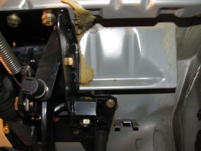

On the bronzit turd the rust was hidden behind the pedal box :
You can just see the edge of it on this pic but I didn't notice it or realise it was there until the box was out :eek:
Strangely though the Other side was absolutely perfect :

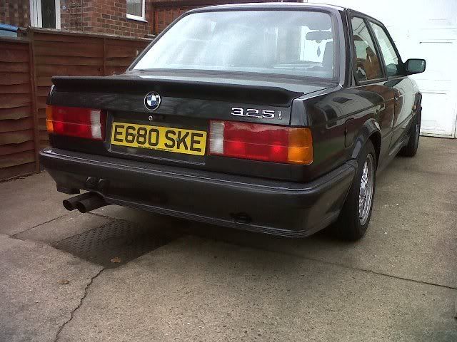

Not the best picture, but the welding has been complete. Its all been welded in flush and seam sealed. done an excellent job with it. Deffintly going to take my touring to him for the respray.
also added a 325i badge which really finishes the rear end :cool:

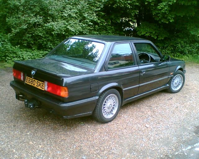

Alex wrote:
/// KAMI wrote:looks lovely mate....certainly looks better now then when i owned it.....
do you have any previous pics of it?????
I should have some il upload a couple.....
THE ULTIMATE DRIVING MACHINE
/// KAMI
Posts: 1811
Location: Bucks
Fri Apr 15, 2011 11:36 am
Heres A Couple I Found:
