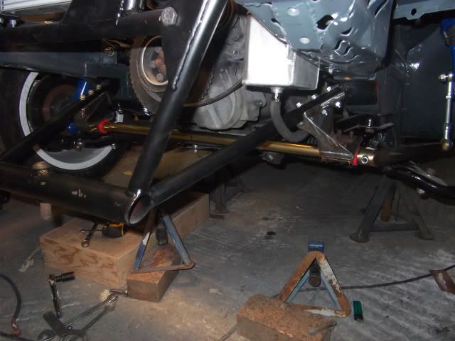

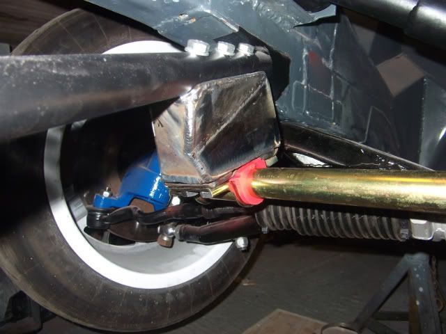

Spent all bloody day doing the stupid anti roll bar, As usual when you buy something that isnt meant to fit - it ends up damn dificult making it fit. But I got there in the end and it appears to do its job. good thing with this is that there are different stiffnesses available at only 19 quid a pop. The only problem now is that the brake fitting for the calipers just hits the tip of the ARB blade a fair bit before full lock is reached. No matter what fitting I use there doesnt seem to be a way around this, so looks like I have a decent excuse to go for some 300mm discs!

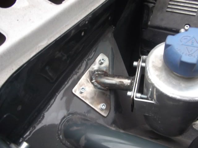

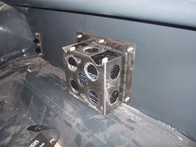

Will hopefully fab up the bracket for the battery and the header tank tomorrow. After that I can send a load of bits off for blasting before I paint them

Header tank bracket and battery tray done, hopefully the last of the fabrication :D
