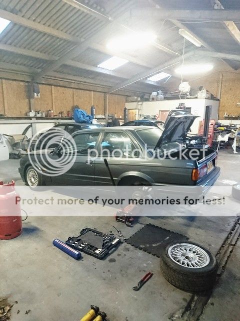

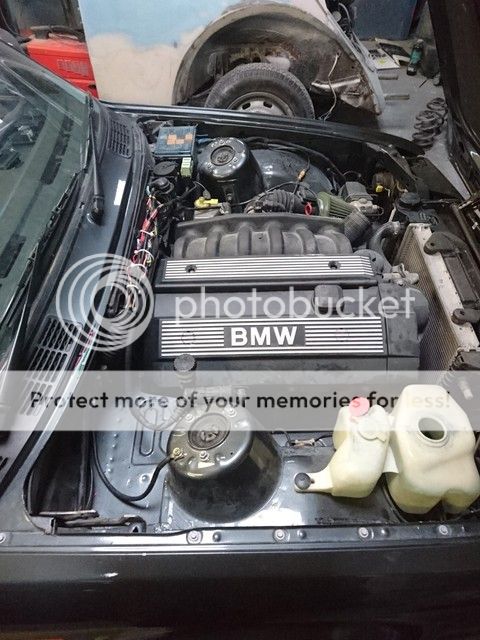

With the car now 'rolling' attention turned to getting it moving under it own steam....
Queue some hours with the wiring. Further tidying up still to come.
http://vid804.photobucket.com/albums/yy ... G_2632.mp4
I have wired in the EWS from the E36, mainly because i think its quite a neat and reliable security solution.
With the car moveable (albeit noisy due to a lack of rear silencer) it could finally go outside for its first proper bath in nearly 4 years.
Finishing touches to go 8O

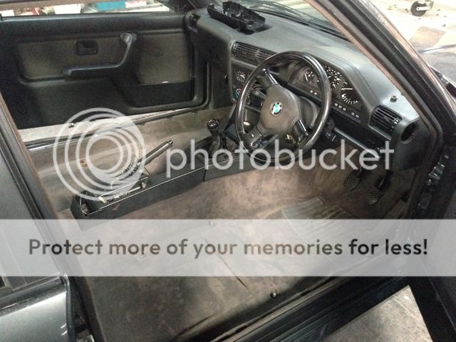

Last month we hit a momentous day. The Tech two passed its MOT, the first time it had been deemed road legal since 2007.
My dad kindly volunteered to take it to a local test centre on my behalf, and the car behaved perfectly for the short trip.
With most parts on the car now new or refurbished, the rest of this thread will now be finishing touches (barrring any disaster stories).
In celebration of its newly acquired DVLA status, i took my mum for a spin down the road, and immediately gained complaints regarding the rocking chair motion of the passenger seat!

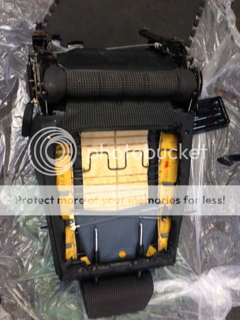

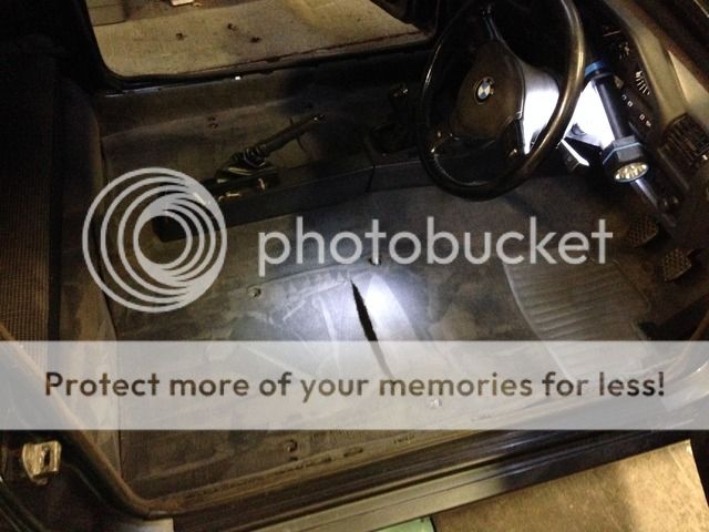

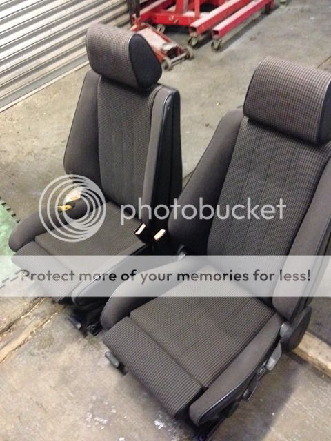

I pulled the interior out, stripped the front seats and found the usual missing and loose screws in the seat back.

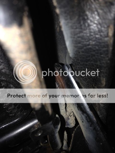

I also found the seat frame had snapped on the base, and unfortunately the same master mechanic who repaired the chassis with tiger seal seemed to have done the same to the interior.
I managed to peel the seat clothe/foam away far enough to sneak the welder in.
Now solid, but grubby from the resto work...

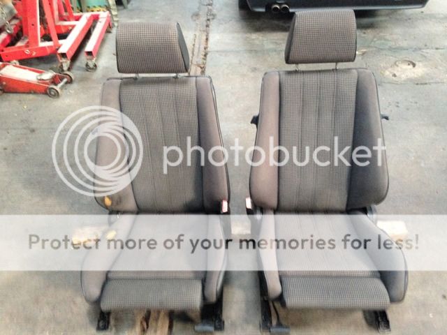

I stole the wet Vax from home and spent a day scrubbing...
New BMW badges arrived to finish off the bonnet/boot.
If anybody has the correct cloth to replace the bolster material on my drivers seat, can you please drop me a message?
I think im going to keep the OEM interior.

Those seats are not OEM for a tech 2 car, they're tech 1 seats..,
mattmk1
Posts: 213
Joined: Wed Apr 08, 2009 11:00 pm
Sun Dec 13, 2015 2:35 pm
Hmm i suspected the same to begin with. But then i was told that due to the car being an 88 build, it was blend of tech two/tech1. I.E using up whatever they had lying around at the factory.
tomson
Posts: 3600
Location: Bristol
Sun Dec 13, 2015 2:41 pm
Who knows, I've certainly never seen a facelift car with houndstooth though.
Have you got the build sheet for the car? That'll show the options & upholstry codes to be sure.
I personally doubt it would have come like that new and the rest of the car is so nice it deserves a proper interior :)
mattmk1
Posts: 213
Sun Dec 13, 2015 2:59 pm
Good shout, i just checked the build details...
Color Delphin Metallic - 184
Upholstery Anthrazit Stoff - 0269
Production Plant MUNICH
My rudimentary german suggests anthracite cloth?? Would that be houndtooth or was there another variant?
tomson
Posts: 3600
Location: Bristol
Sun Dec 13, 2015 3:03 pm
0269 is facelift type anthracite cloth so not the houndstooth you have :)
tomson
Posts: 3600
Location: Bristol
Sun Dec 13, 2015 3:05 pm
It's a dark grey with black diagonal stripe, I expect you know the style?
mattmk1
Posts: 213
Sun Dec 13, 2015 3:44 pm
Ohhh yeah i know it...its actually my least favourite interior haha so i might have to go for leathers instead.
Ill repair the houndstooth set and move them on, if i can sort the bolster its a very nice set of seats.

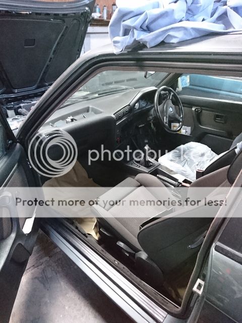

The interior is all now in, barring a decision on wether to swap to leathers (if i can find a nice set) or try to track down an alternative (z4M seats? or something on those lines).
The car then needs a bloody good clean and detail, iv never actually finished with the paint.

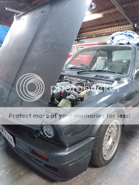

Beautiful day earlier so i trimmed down the excess wiring....
And gave her a damn good bath....
I can feel a photoshoot coming on, just waiting on a wheel refurb!

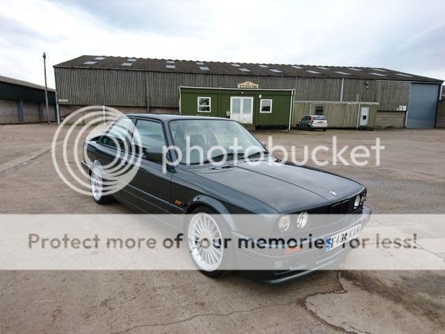

Little Update on the E30.

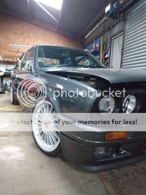

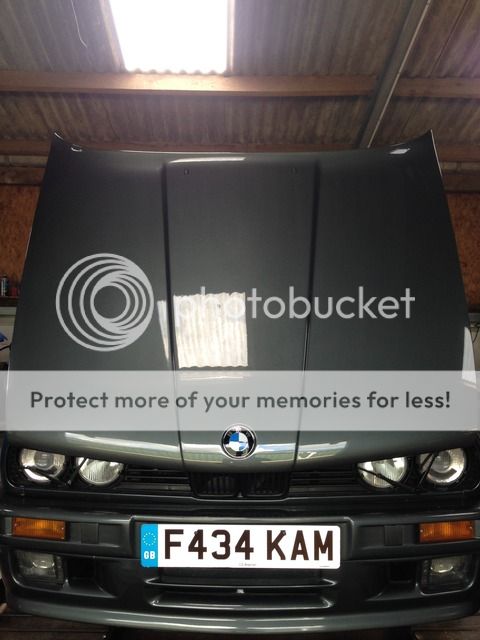

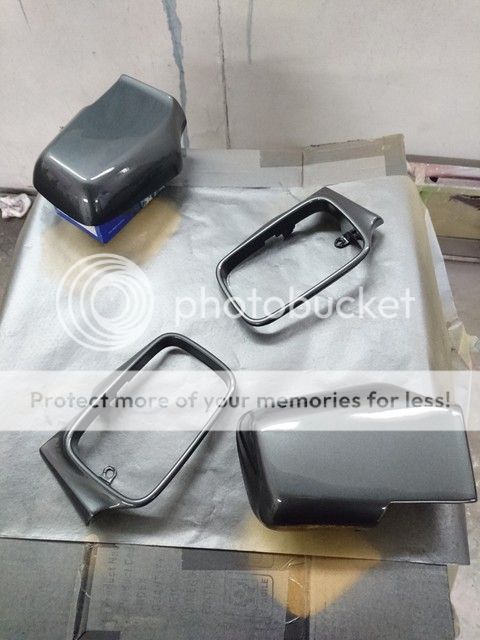

I had kind of rushed the paint work on the wing mirrors in order to get the car MOT'ed, and frankly they looked terrible in the nooks and crannys:
So i picked up a spare pair, stripped them completely and did a proper job of painting them up:

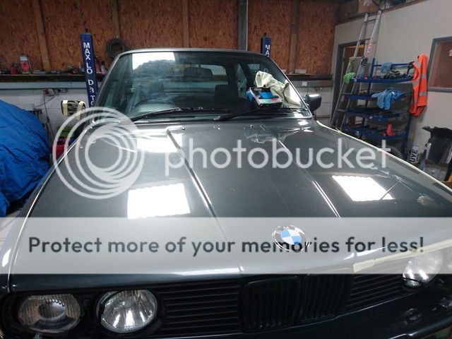

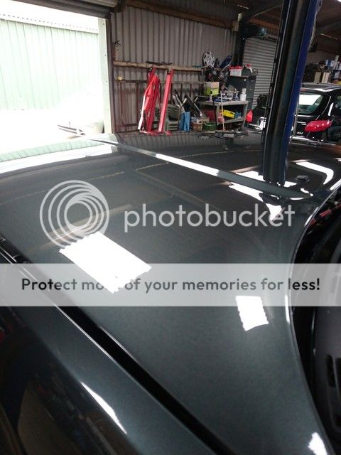

I then started to give the car a detail/mop/polish/finish the paintwork off, here iv done the passenger side 3rd of the bonnet.
Here the bonnet is finished off:
And started to get a nice shine down the sides:

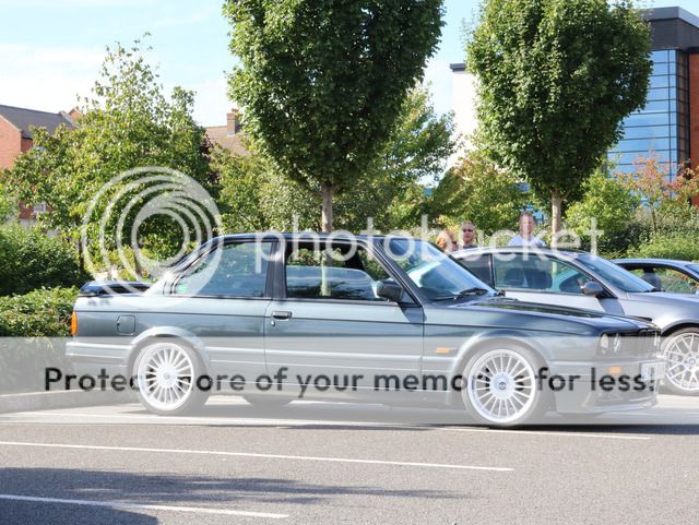

I use the 3M pads and compounds, have done for years and i guess people stick to what they know. I treated the car to a coat of meguiars wax and took some shots in the Murky June weather:
Before the alpina hate begins...they are only on whilst i get the BBS's refurbed.....although i have to admit they are growing on me

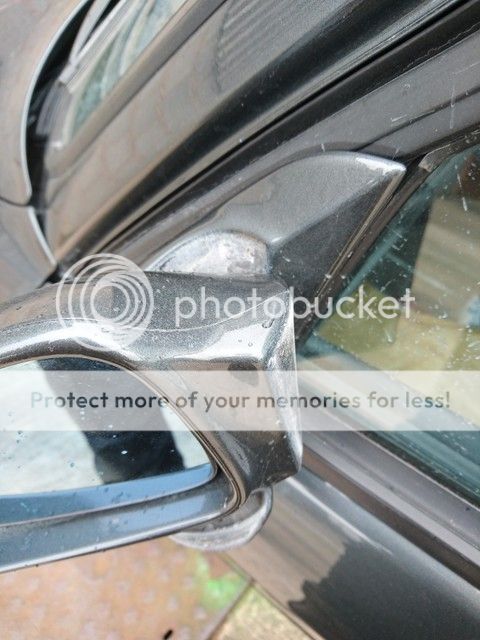

Nice, kept up with this over the years, Always wondered about the painted mirrors - looks to me as if it would scape off paint where 'head meats the base' as you fold them in/out?

No there is plenty of clearance. They are a bit of a faff to strip down into component form, so the old set i simply painted the best i could, whilst they remained complete. Obviously you cant get a lot of paint into the 'hidden' areas though so it looked scrappy.
The second set i stripped which involved removing the plastic rivets that hold them together from factory and then finding a way to re fasten after the paint.

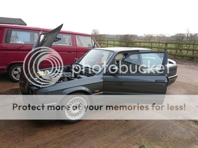

If you pop out the mirror glass you can see 5 plastic rivets which hold the mirror casing to the metal structure of the mirror itself.
I ran a 5 mm drill bit through the plastic rivets to break them free, and when it came to reassembly, used a strong PU bonding adhesive between the remains of the rivet and the metal structure. Bit of a faff but i only intend on doing it once!
Wired the fans in at the weekend so now have two speed fans working off the temp switch. Runs quite warm in traffic so may swap to a lower temp fan switch.

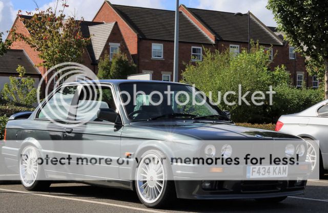

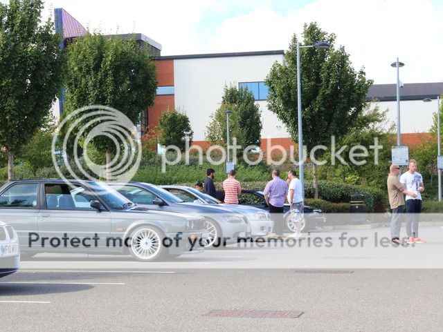

Toward the end of last year we managed our first BMW meet, which was local to me and advertised on one of the M3 forums.
The car got some very kind comments, and a snapper took these:

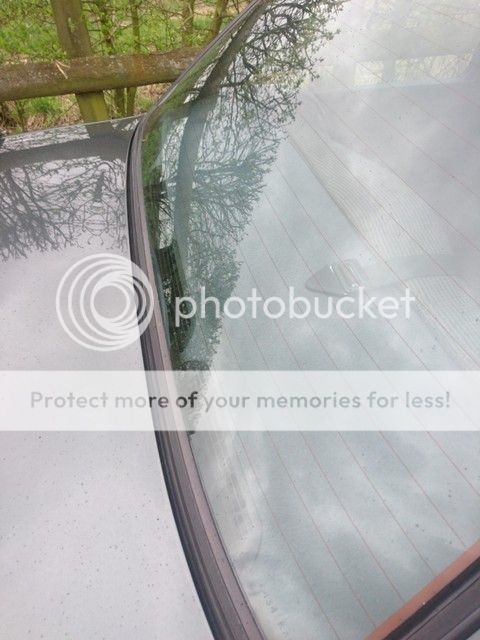

We all know these cars are never finished, so spent the last few weeks tidying up a few issues with the car. Now clocked up 1k miles since it returned to the road!
Had a small piece of luck in tracking down one of the missing pieces -
So pleased as it really made a huge difference to the car, funny how sometimes its the small things.

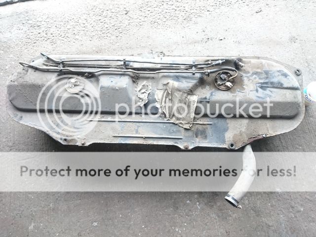

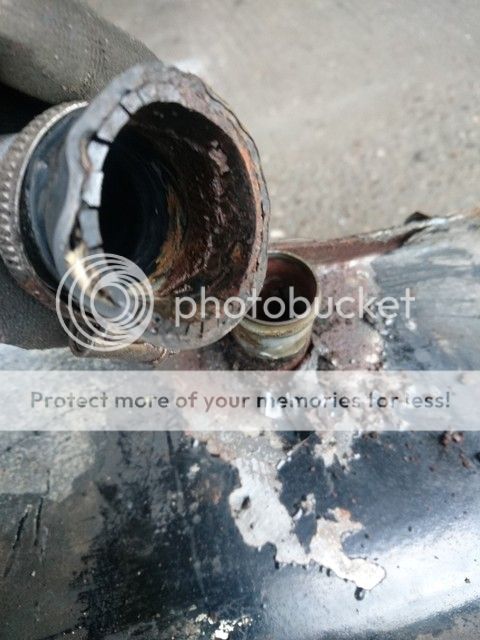

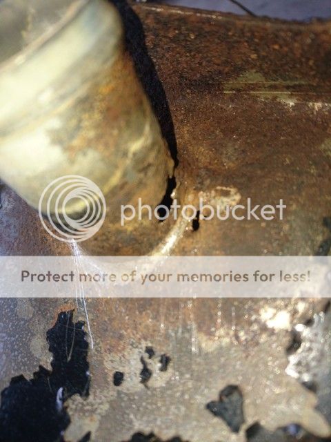

And whilst stopping to take that picture, noticed the smell of fuel and a nice puddle forming under the tank.
Back in the garage and tank out, sadly the build sheet was unreadable
Filler pipe has obviously seen better days,
And a nice hole in the tank filler
So parts ordered, awaiting delivery.
