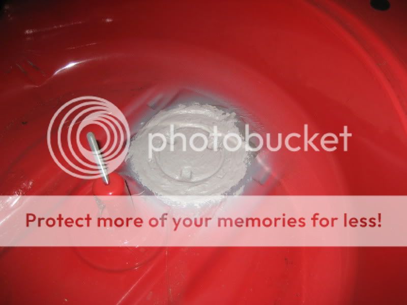

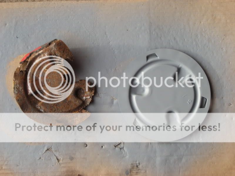

All three of the metal circular bungs found in the rear passenger footwells and spare wheel well were absolutely fooked.
Here's the best one of the old crap against a nice newly painted one, these bungs didnt look to bad on first inspection, but the factory underseal around there was goosed and was letting lots of water in over a long period of time i would say, one gentle nudge with a screwdriver and it was all over.......

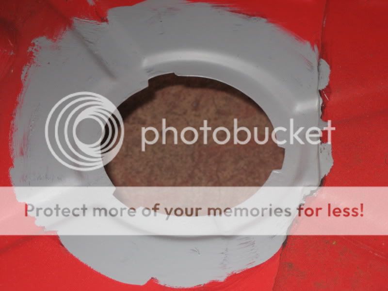

Hole prepped for new bung
Ready to go in
Seam sealer applied, i put a ring of seam sealer around the hole first to bed in the bung, twist in, then apply the rest of the sealer, both internally and externally underneath as well, simple....
One of the boot as well all finished ready for primer and top coat...

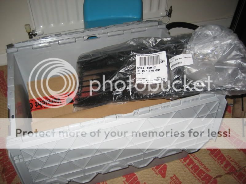

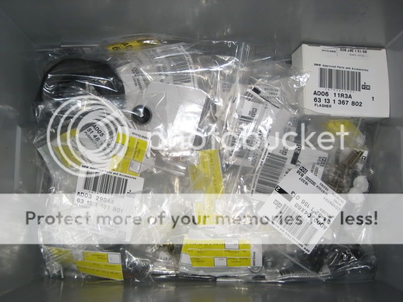

Picked up a crate of parts from the dealers on Christmas Eve.......
With a few goodies inside, some teasers for you, cant be arsed to photograph all the parts, would be here till next new years eve.

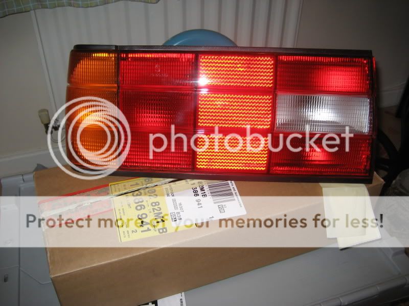

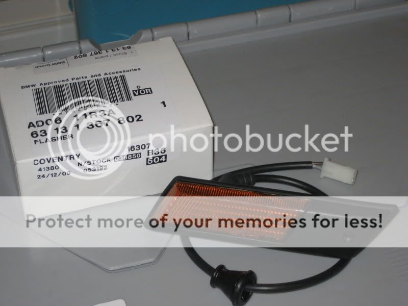

Nice new lights, i did get full sets of course.........

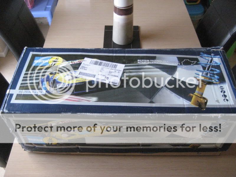

B12 Bilstein suspension kit arrived just before Christmas as well...

I thought side repeaters were NLA?

Royalratch wrote:Niiiiiiice.
Nope got both, dont know how many they had, but it was Uk supplied, didnt have to get them from Germany :D
Royalratch
Posts: 4921
Thu Dec 31, 2009 8:11 pm
Order placed via email! Dude, you HAVE to show all the parts man - parts threads are hot right now!
I got the side repeaters from the dealer this month and the indicator lenses, scuttle vents, washer nozzles, door handles and every item that can be replaced on the outside.
It's all there still from the dealer 8)
