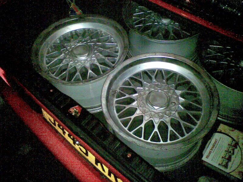

ACT 8.5j r16 et19 alloys, in need of a refurb but still for next to a song i'm pretty chuffed :cool:

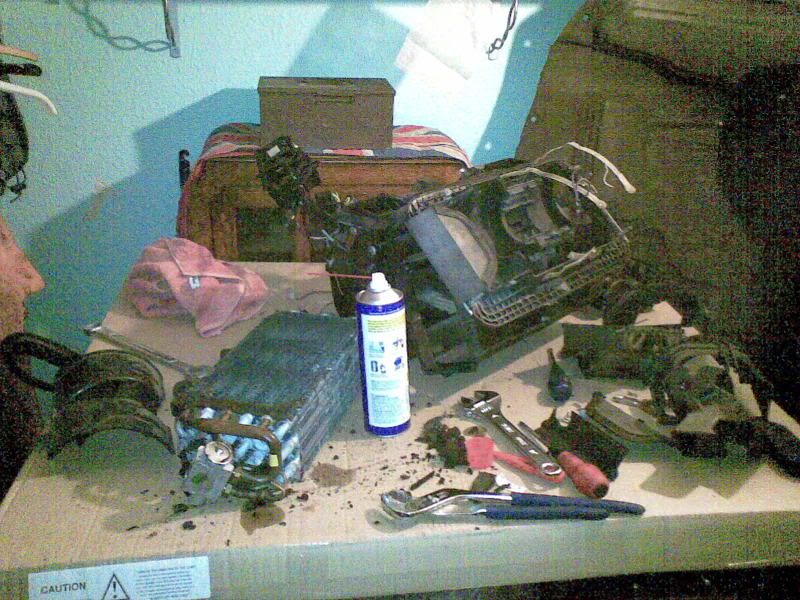

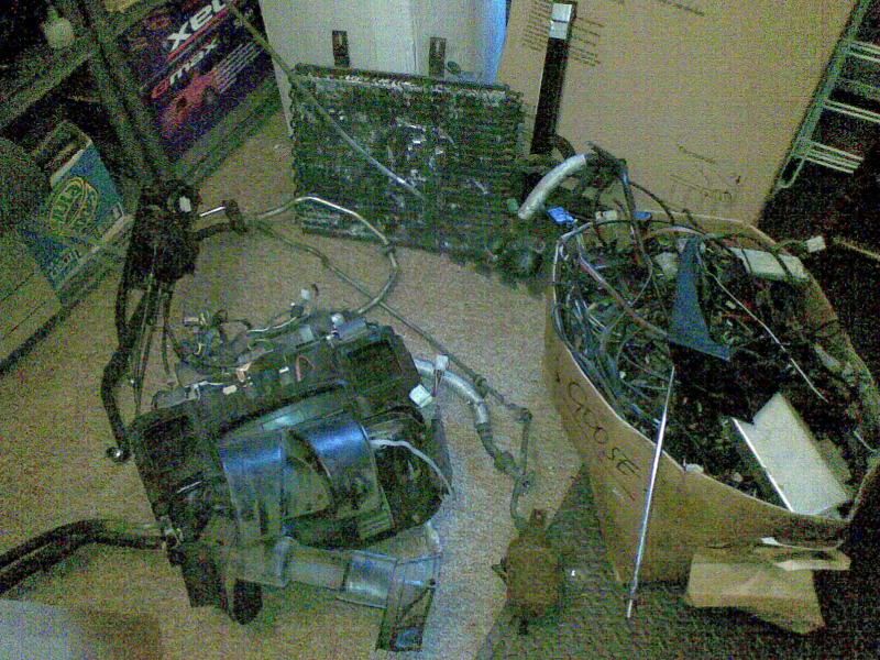

Here is mission control (my middle bedroom rammed full of sh*t)
Full aircon rhd loom -Thanks BBB

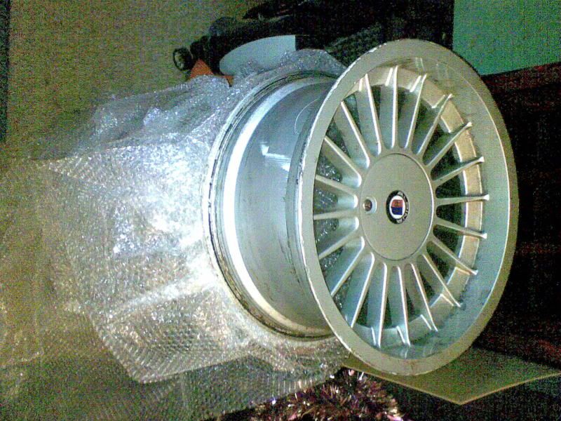

And a nice staggered set of 'pinas 8.5 and 9.5j
And after 20 minutes a scene of council bodgery!
I promise that shell pics will turn up soon! :D

Just getting started with stripping the aircon components down, do you have a part number for the gas conversion kit or do i have to order all of the seals individually?
Totally in awe of your aircon install dude! :cool:

Post Mon Oct 11, 2010 9:18 pm
82 31 9 067 394
r134a conversion kit does not include o-rings for every join, so you will need to get additional o-rings in the correct size.
Posts: 24532
Post Mon Oct 11, 2010 9:21 pm
Why thank you! :D
It was the bain of my life at one point though! :-x
The 134a conversion kit has about 4 O-rings and not enough for the whole system.
What you need to do is measure all the external diameter of the pipe joins and order the relevant seals.
Retro fit kit, 82319067394
Seal sizes and part numbers (item 21)
http://www.realoem.com/bmw/showparts.do ... g=64&fg=60

It's also worth noting that the various o-rings are sizes which are used in many other air conditioning systems, you can get them much cheaper from a local garage who do work on aircon.

Cheers! A question for you and Mr 13, how do i go about ordering a new set of locks, keys and caps for the alpinas?
I fell in love with these alloys as soon as i saw them and i think with the brake setup only 17"s will clear the calipers so it may put paid to the 16"ACT's. Im sure Jhonno can clarify...
