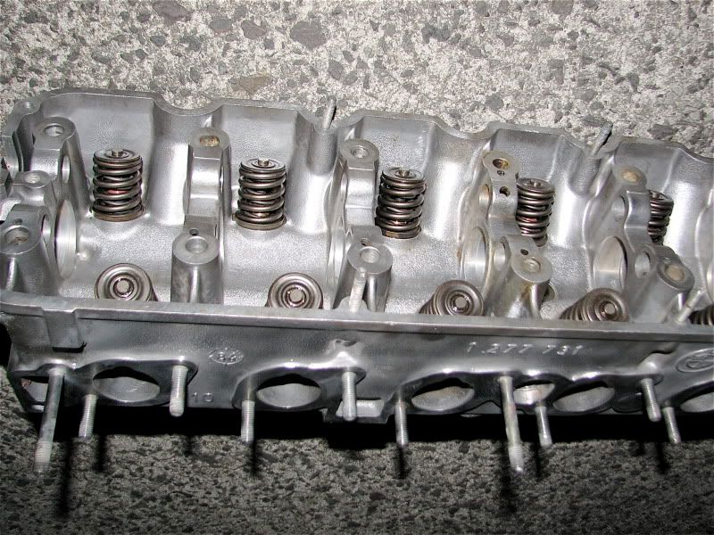

Todays update is....
T piece to go in place of original oil pressure switch, this lets me run a oil pressure gauge aswell as retain the oil pressure light (idiot light) in the instrument cluster
Double valve springs have arrived, thanks Ade.
And I went to the cylinder head shop to see how the machining is going on my head. He has given it a quick clean (not finished) and welded up that crater that was in the combustion chamber.
He has to weld up the porosity in the weld.. Happens when welding up alloy that has had oil on it.. The oil causes porosity in the weld..
Cylinder head should be finished mid way through next week. Now I have to wait on people to send the rest of the parts.
Mike
Mike

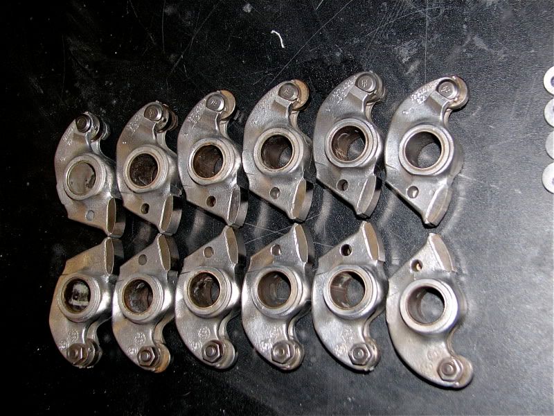

Todays little update.. Rockers.
I sent a set off to be cleaned and this is the difference.
I ordered some of these and since I am running out of things to do while I wait for the inlet manifold and T/B, I thought I might fit them up...
Rocker eccentrics
New eccentric Vs old eccentric..... Cant see the difference except the oil I hear you say? Yeah me either.
12 refurbished rockers ready to roll.
Rocker eccentrics
