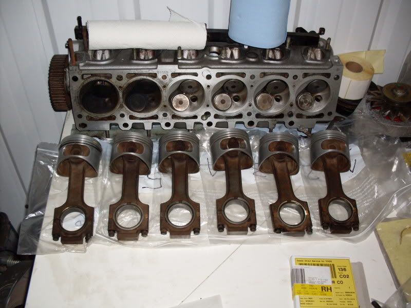

Over the past wee while I've been mainly buying parts for the engine to get re-built and been cleaning things up, and tonight I should be receiving my parts order from BMW. My step dad Colin works for the Eastern Western group and has managed to get me some discount on the parts I've ordered, although they still came in at around £550 8O Was a bit shocked when I found that out!.lol.
Anyway, I've sent the Crank and crank pulley away to Engine Services in Rosewell for a new spigot bearing to be fitted and for two bolts that sheared off in the lower pulley to be removed. So I should get those back later today. Also the rocker cover is all finished and ready to go, just the inlet manifold to laqure up, block's painted, pistons cleaned, so once I get all the parts It'll be time to get the thing built up, can't wait.
I'll post up some pics tonight, before we get underway.....

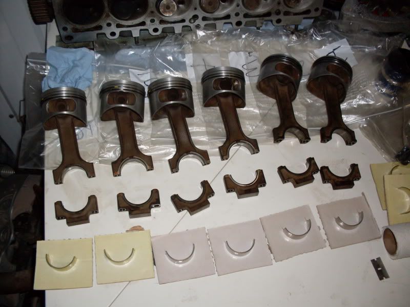

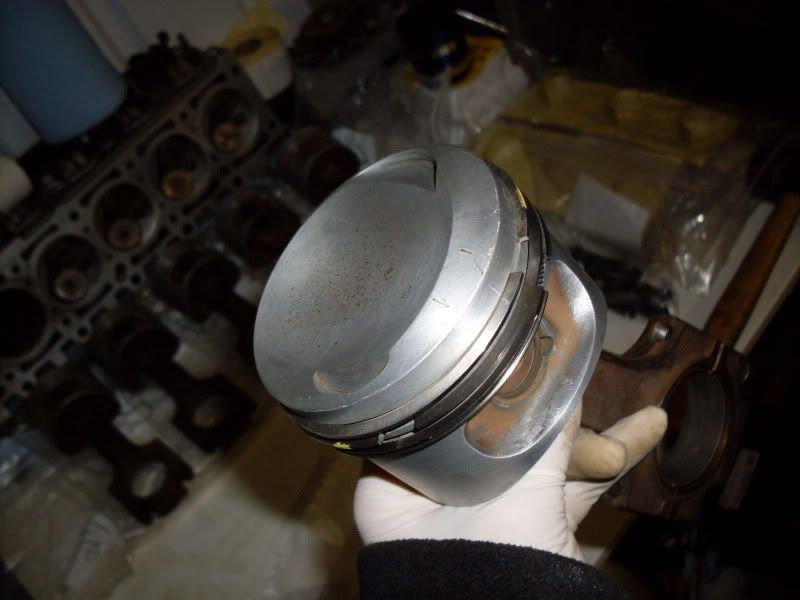

BMW Dealer Parts....
Guide shells...
New Piston rings...
So it was all new Hoses, new seals, Head gasket, o-rings, new con rod bolts, shells, HT lead cover and various other gaskets.

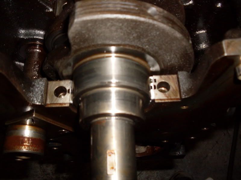

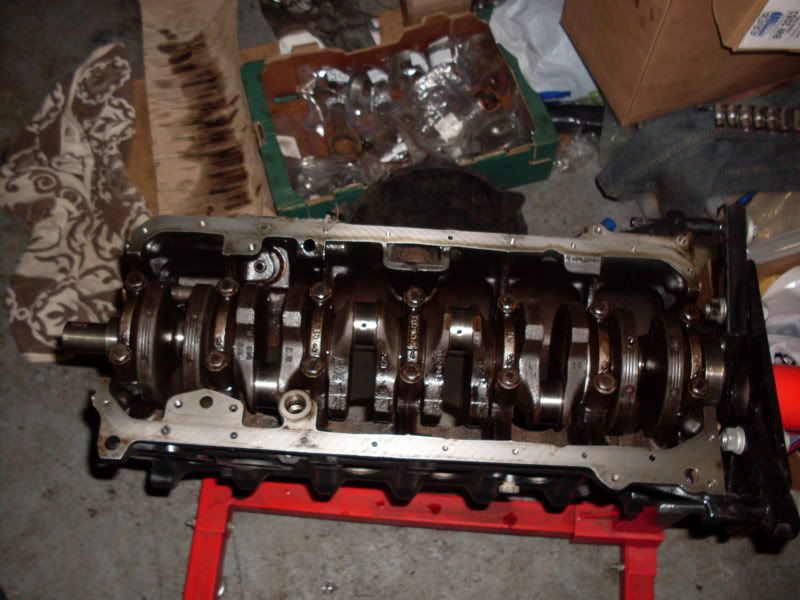

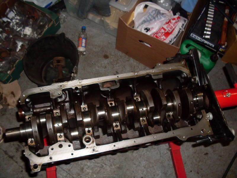

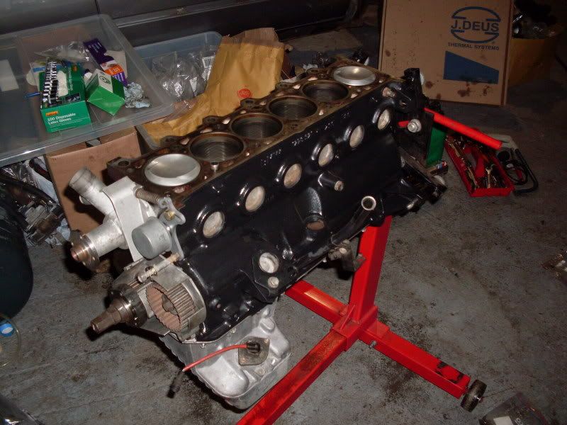

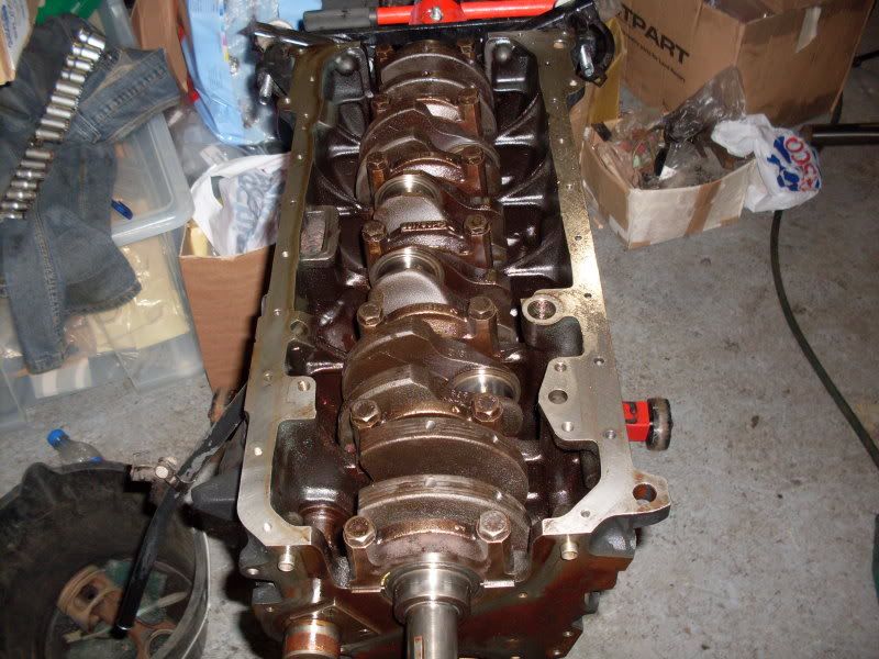

Right another update. After the fiasco of figuring out if I had the right crank main bearing shells(cheers Simon and Chris), of which It turned out I did, I thought I"d better start building it back up. Since I had all of the right parts for the engine, at about 780 odd quids worth and thats with discount from the stealers, and a lot of parts from Toby at New Car Parts Ltd( or Parts Auction) who was great, with quick delivery and greats service as usual. The rest of the parts I got from Euro car parts.
First off, get the crank in with those new shells

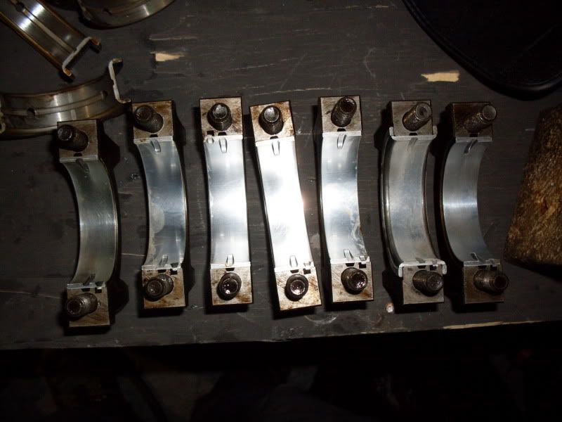

The new shells in the caps...

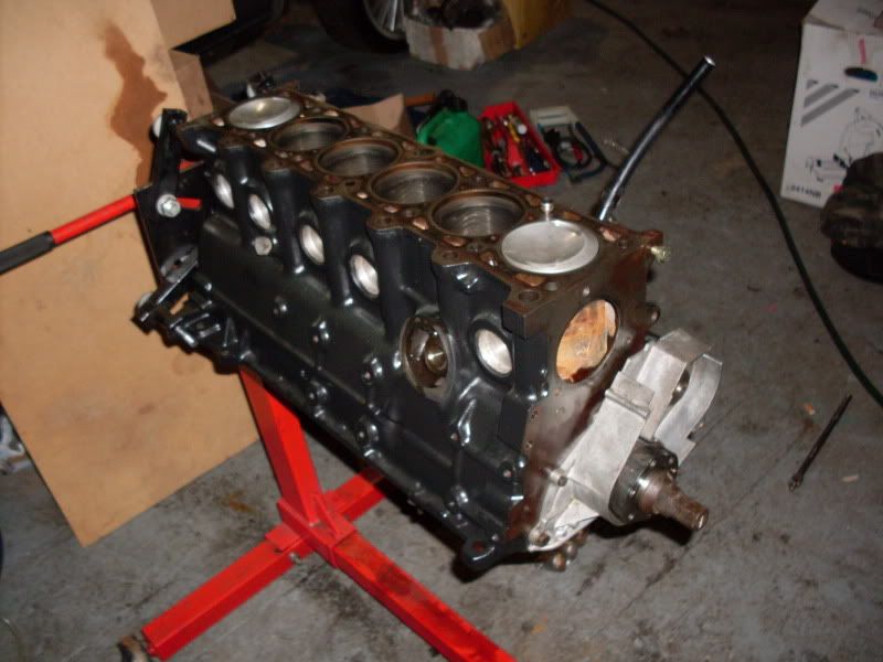

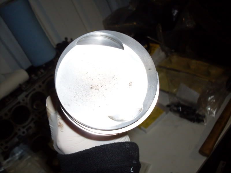

Next up, pistons, all cleaned up and with new rings, shells and bolts....
Pistons in and caps all torqued up, strange things them stretch bolts, just don't feel nice!!

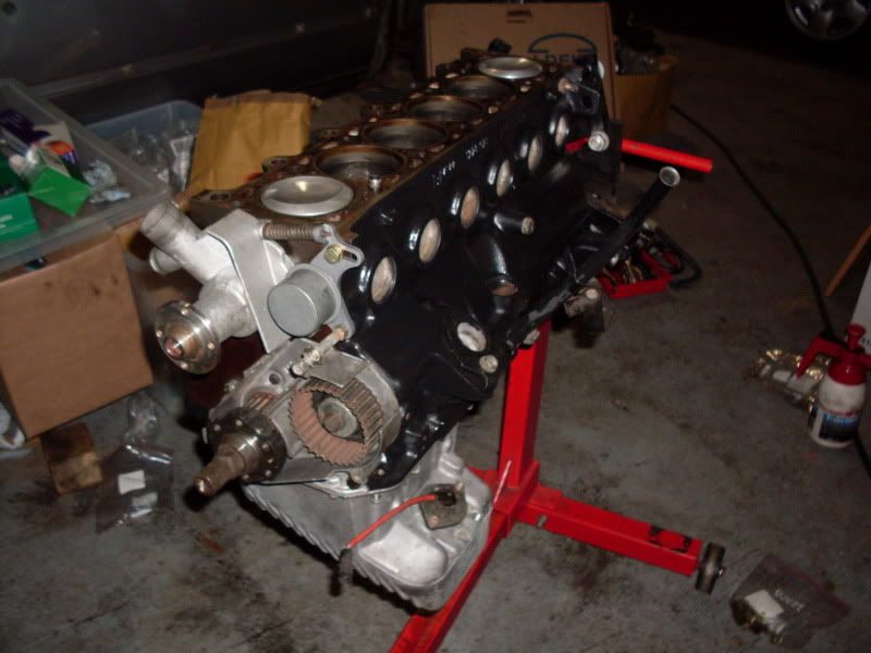

then the front and rear oil seal casings, and front crank pully and bolt....
then the Oil pump and thingy next to it....
then time for the sump...
And last for tonight, the water pump and tensiorer. I decided to usse my old water pump as it had not long been put on the car and still feels very smoth
So there we have it, next up is to finish off cleaning up the head and face of the block and get the head on. Just got to finish laquring the inlet manifold and we're done :D
Paul.

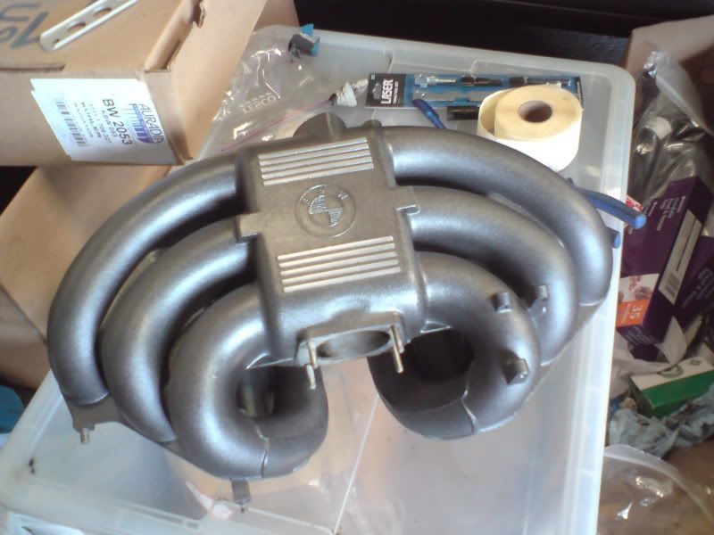

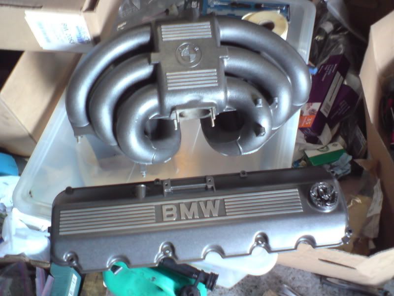

Finished my rocker cover and inlet manifold.....
Came out nicely :cool:

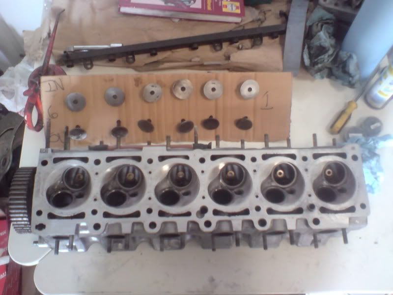

Also realised that the valves weren't seated right, so I've got them out and re-lapping them....
Inlets are done, just the exhausts to go, so thats where I'm off to just now, should be finished and back together tonight.

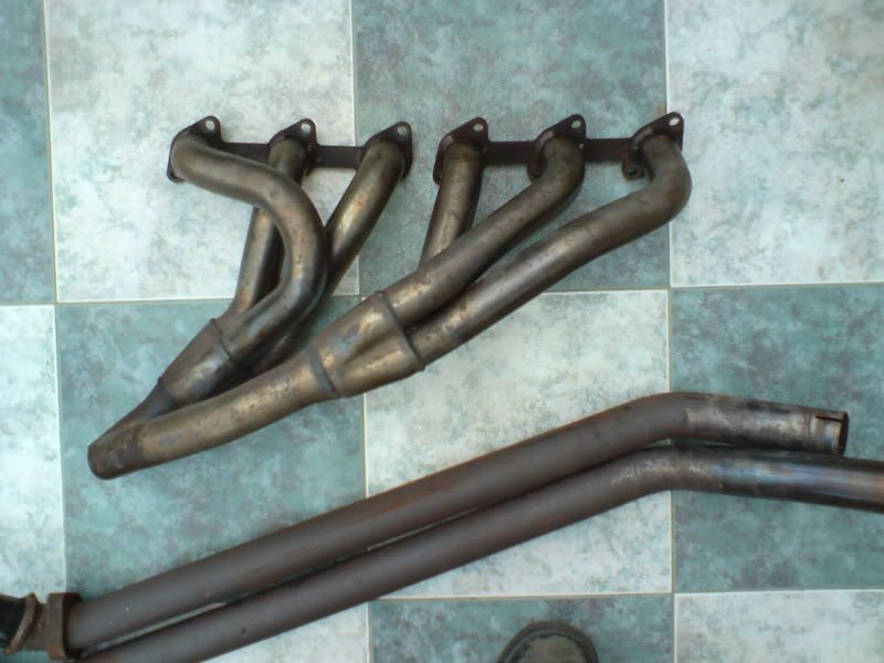

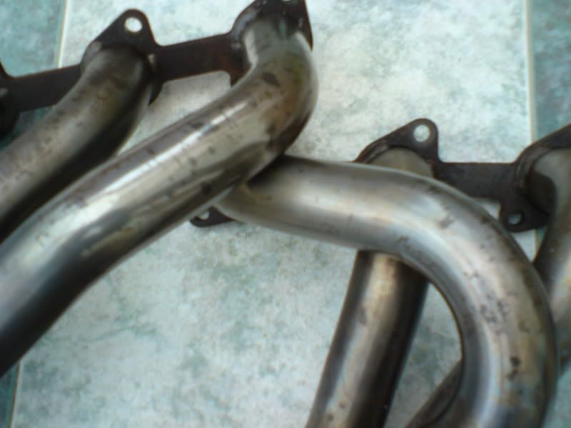

Also got this from Spadge ( cheers mate :D) winkeye
Had a wee go with some wire wool and some metal polish and it should come up nicely...
And before anyone starts going on about "you should have bought a BTB2", I didn't buy it for the performance, just the looks!! :D

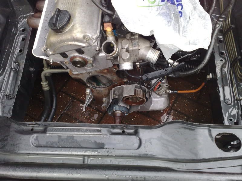

ricey46
Posts: 983
Location: Edinburgh
Mon Jun 29, 2009 6:01 pm
Cheers guys,
just noticed I haven't put up any photos of the completed engine, just the wiring loom to be attached now...
Also the gearbox has been cleaned up...
linkage dismantled, cleaned, re-greased and rebuilt...
I've got the input seal off at the mo, it's been replaced and is awaiting refittal...
the output seal also is to be replaced but it's a strange size bolt holding the flange for the prop on, something like a 28mm, so I'll have to speak to the guys next door and get that done.
After that I need to fill the gearbox up with new oil, fit the flywheel and new clutch, replace the prop center bearing and it's ready to go into the 316 for running in!:D:D
vroom vroom!!ImageImage
