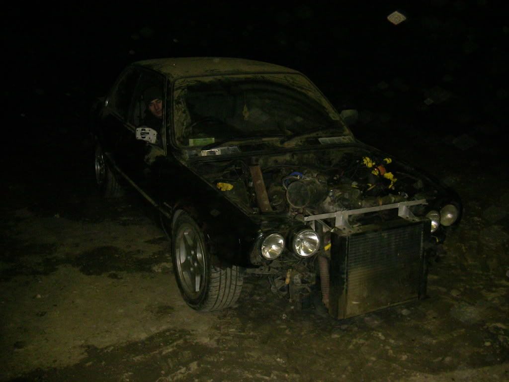

well its alive :) got pics and a movie just uploading them now :mad: still lots to do but it starts, moves and drives winkeye

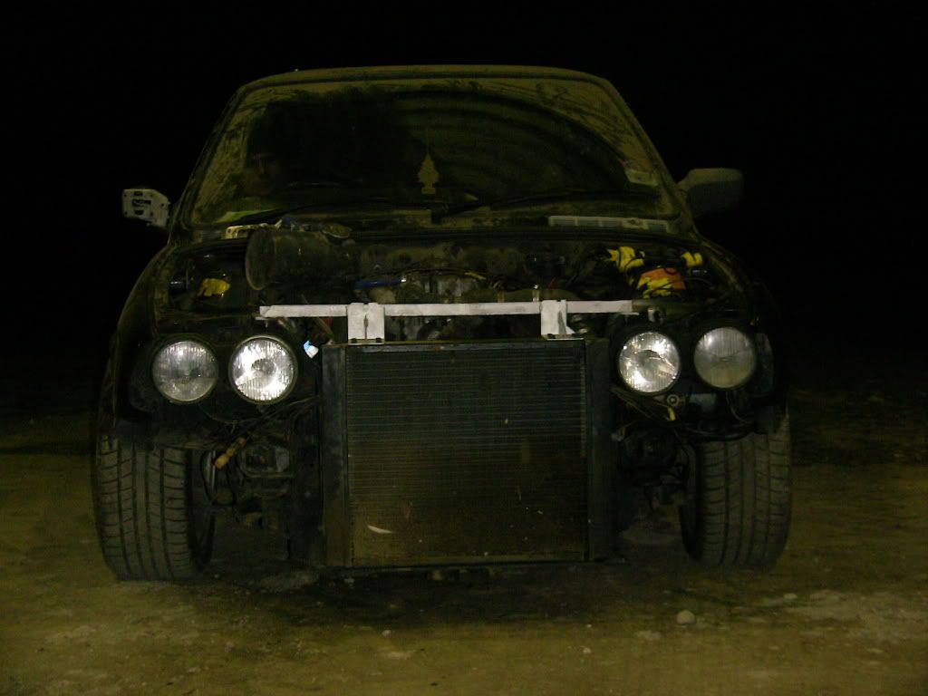

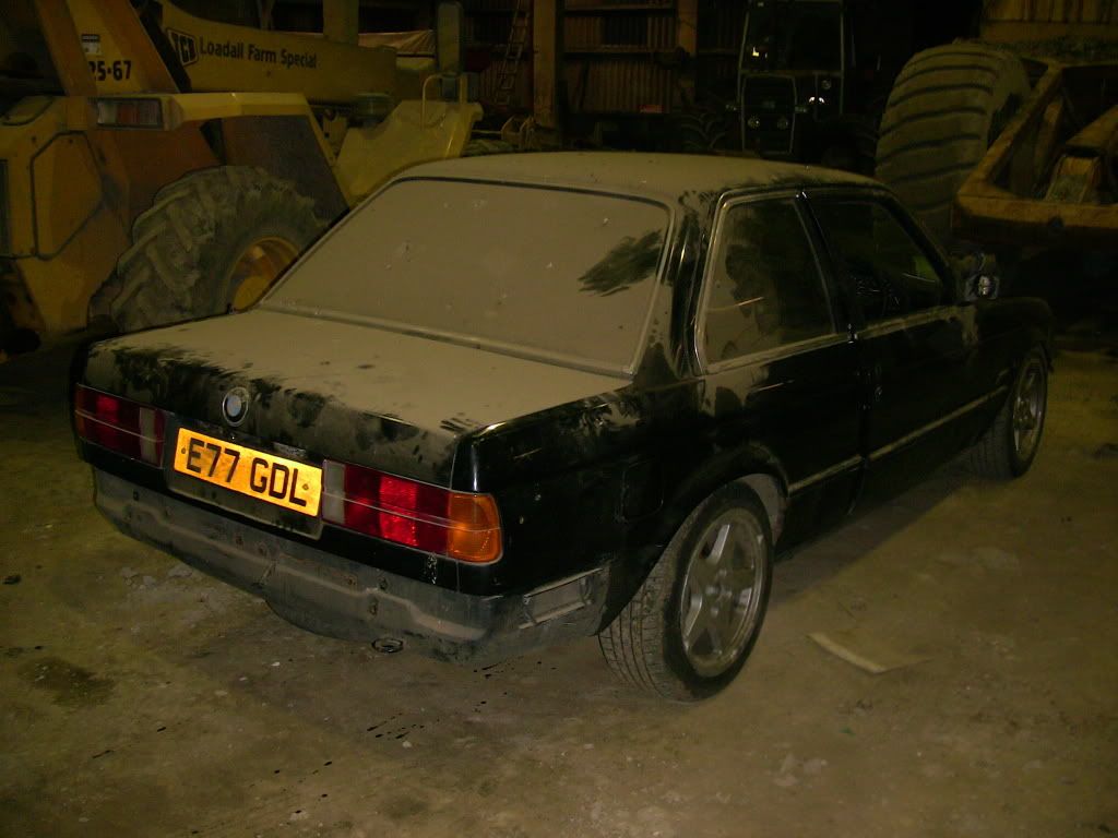

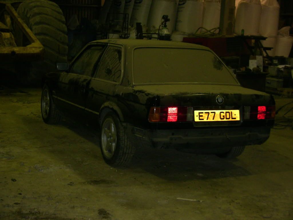

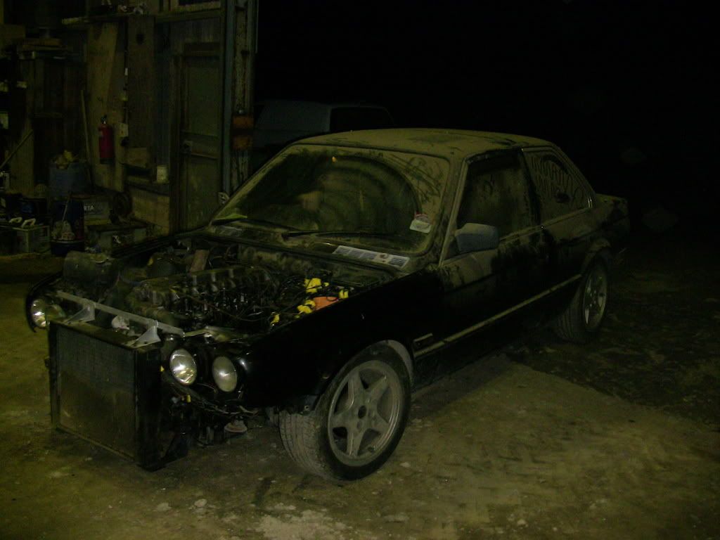

well movie is in hd and wont load to pc :( il take another in normal mode next week. ive spent the last 2 hours trying to load it up but no go a few pics anyways

You'll need a RRoyce grill to cover that rad 8O
I cant imagine what the front end will look like with the bumper etc all back on. I'm sure it will look evil though :twisted: :twisted:
Its gonna be one grunty e30

just what i was thinking a nice chrome grill and the shark nose look like an old corvette :)
first time today shes turned a wheel under here own power for 3 years, brakes dont sound good tbh but there mega rusty :cry:
