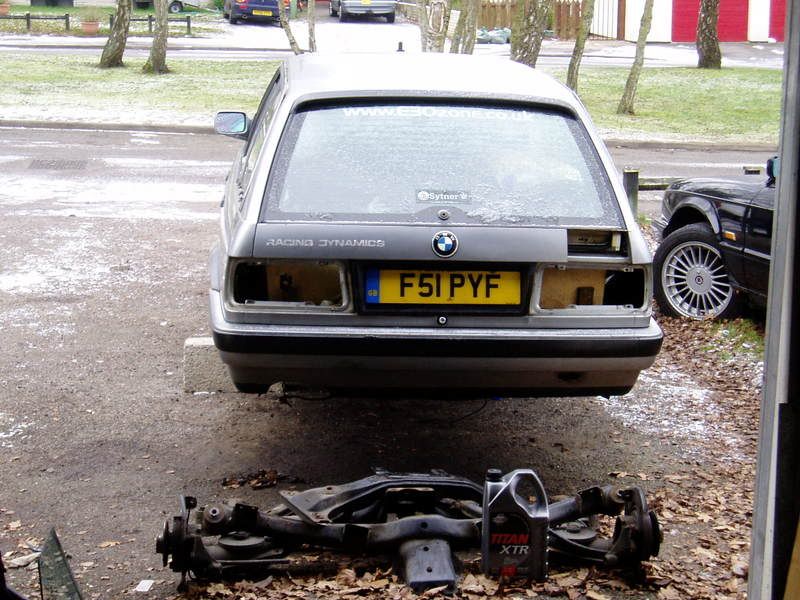

Well today PYF went to the scrapper farewell old turd!

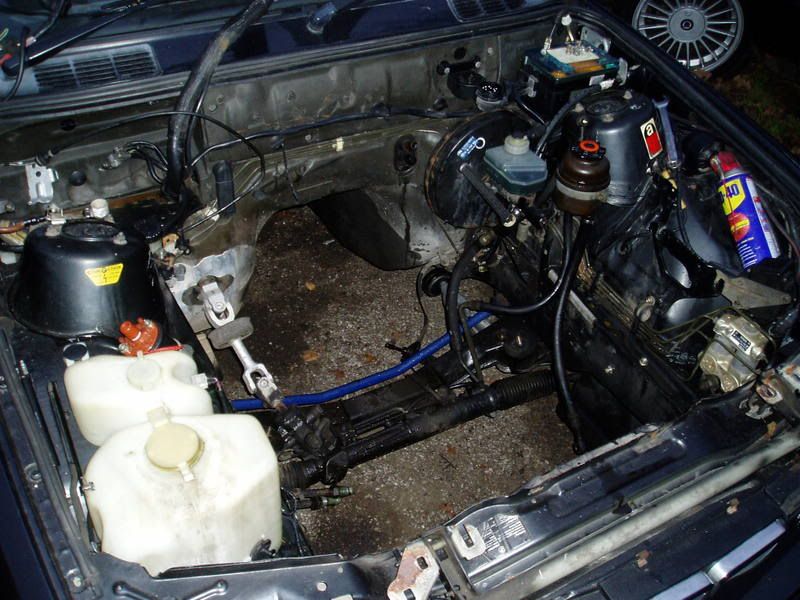

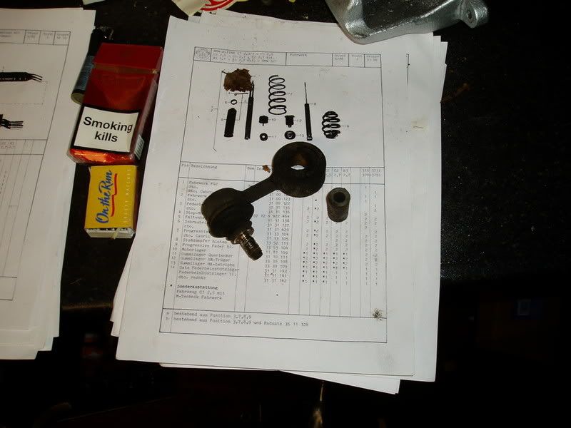

So this cleared the drive to get stuck into the pina, starting off with giving the front suspension a well earned overall. So i've pulled the struts out, front roll bar and wishbones
Heres what we found
Front drop links out of their brains more than i thought! big reason why E30's drive like a double bed when these are shot
Alloy wishbones still fitted which i knew! All the boots aren't split so i hope there is life left in them as they feel fine. The same can't be said the the lolipop bush! Both sides originals with 92 stamped on them. They where really shot and saggy. These where a f**king bitch to get all the ball joints spit with out killing the rubber boots, sometime they fall off not today. WD40,Heatgun,splitter,large hammer and swearing prevailed today!
Original alpina front springs, part number is still on this one, but it's not on my alpina data sheet. But it's only 1 number out and the sheet only states saloon and cab part numbers. I've got the rears too.
I may get these powder coated in time

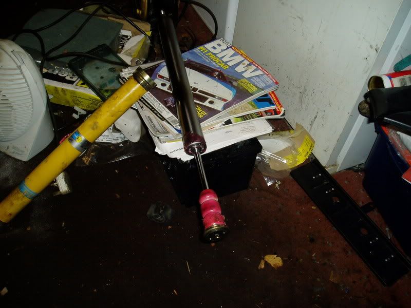

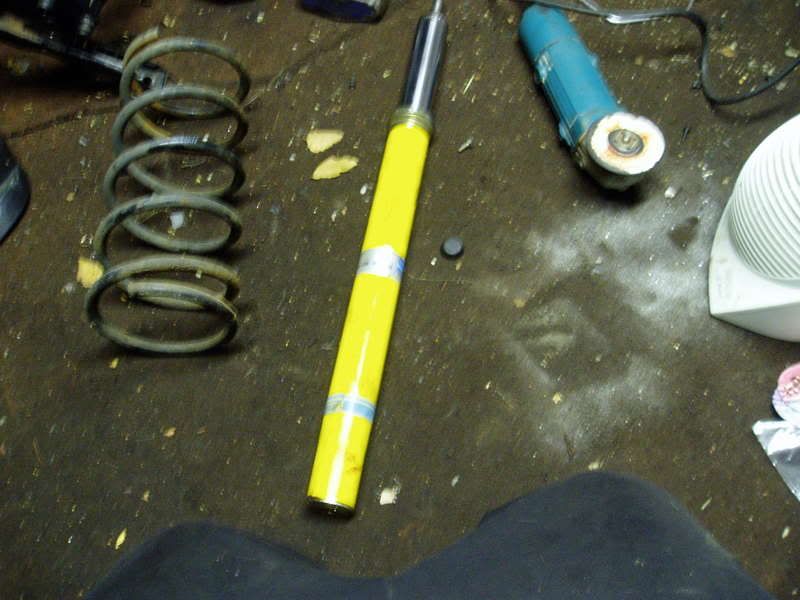

Some very new looking B8 dampers also. I can't see anything alpina on them so i guess they are stock B8 replacements

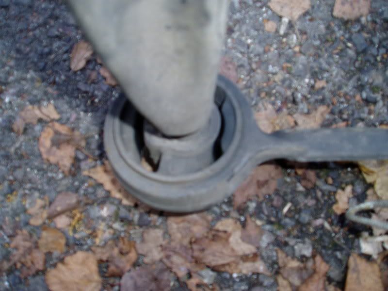

So this is what an inverted damper looks like without the casing on. It came off when i tested the damper rod! Can see the bump stop at the bottom. Really is a normal shock upside down
Hopefully get the new control arm bushes pressed in 2moro and get this puppy built back up and driving closer to how it should
Heres what we found

Do you know what the crack is with the inverted type of dampers and what the advantages are supposed to be?
Saves me getting curoius and taking mine apart
- Posts: 22697
i don't know exactly Lee i've read about it before but i've forgotton tbh, they are good enough to be factory fit on mitsubishi evo's they don't handle bad!
They are fitted to a number of E30 coilovers, but think the B6's are used in them. Demlot, Everett know more than i do on the ins and outs
Jon_Bmw
- Dangerous when thinking
- Posts: 7606
- Location: Salisbury
I think its to do with less rotating mass. Imprezas have inverted shocks as well. You haven't got the big heavy part of the shock attached to the hub you see. Well thats my understanding of it anyway?
Ant
- Retired Team Member
- Posts: 10496
- Joined: Tue Dec 21, 2004 11:00 pm
- Location: PD+E dept :D
^ in a nutshell Jon
less unsprung weight as the bulky section is supported on the top mount not carried by the lower arm.
RIP PYF !
Looking Schweeeeeeeeeeeeeeeeeeeeet Simon

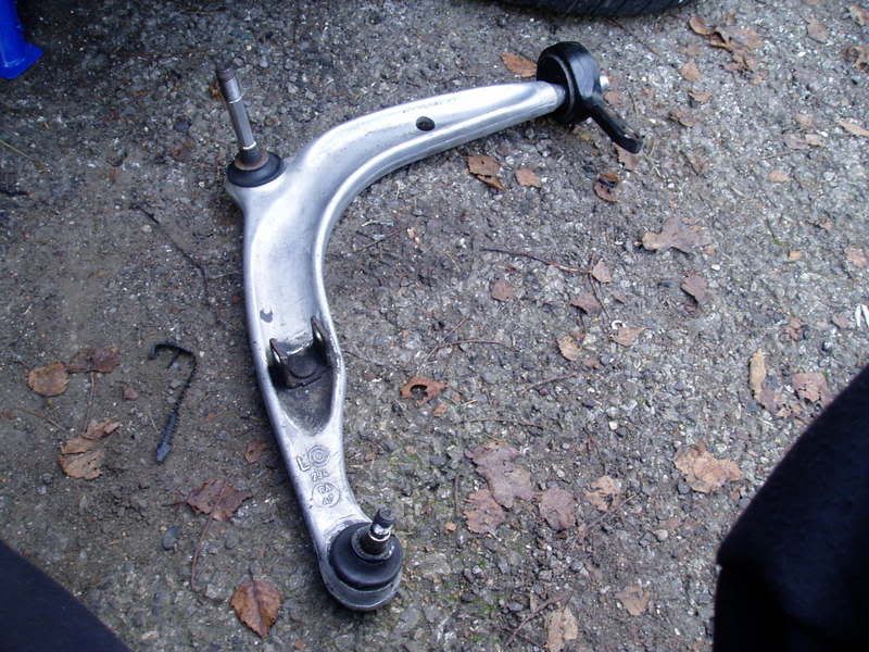

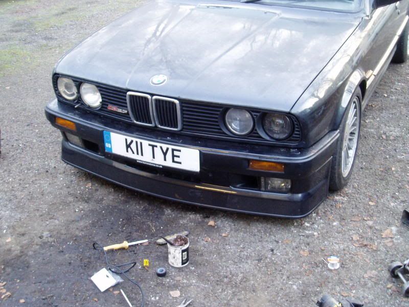

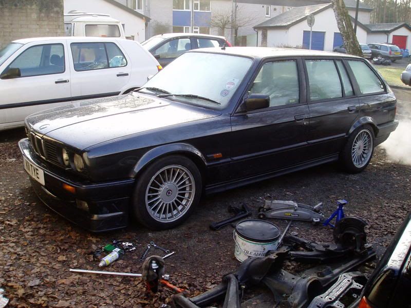

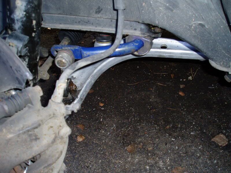

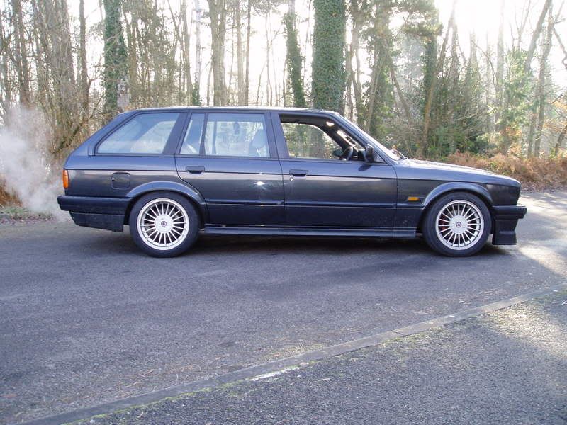

Well front end mini overhaul done now
Gay i know but i light buff for the ali arms! M3 solid bushes on also
Bolted up, strut in, Hartge 22mm 3 way adjustible bar on also. I like it on the stiffest setting although it gives the drop links a hard time! Drop links (bmw) are only a few months old of PYF
These cupkit springs have shrunk i swear!
Clears the speedhumps on my road by 20mm or so
The perfect ride height imo
I can't go for a real spin as the diff is only held in with half the nuts and it's not mine and theres no tax but feels bang on the money again
More council tat to appear v.soon!

That is looking so good, laden with morsels too.
What's happening with the headlight washers?

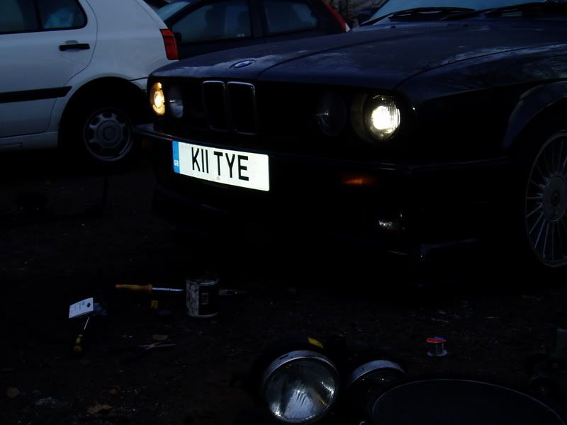

- Posts: 22697

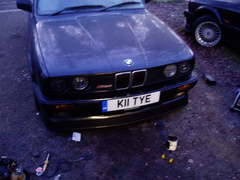

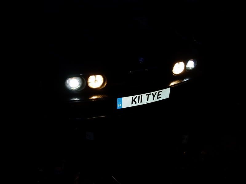

It's got a black eye!
You can see the white light
So now we can see where we are going at last! It's a boring job and nothing really to see
- Posts: 15846
Looking good mate. Ride height looks the nuts. I think I'll have to address my headlights to HID's.

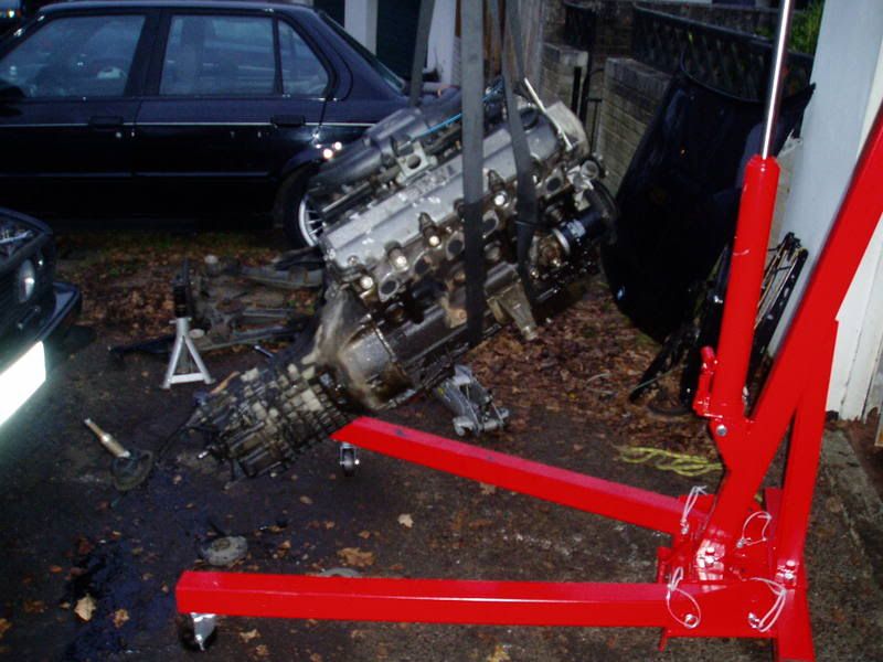

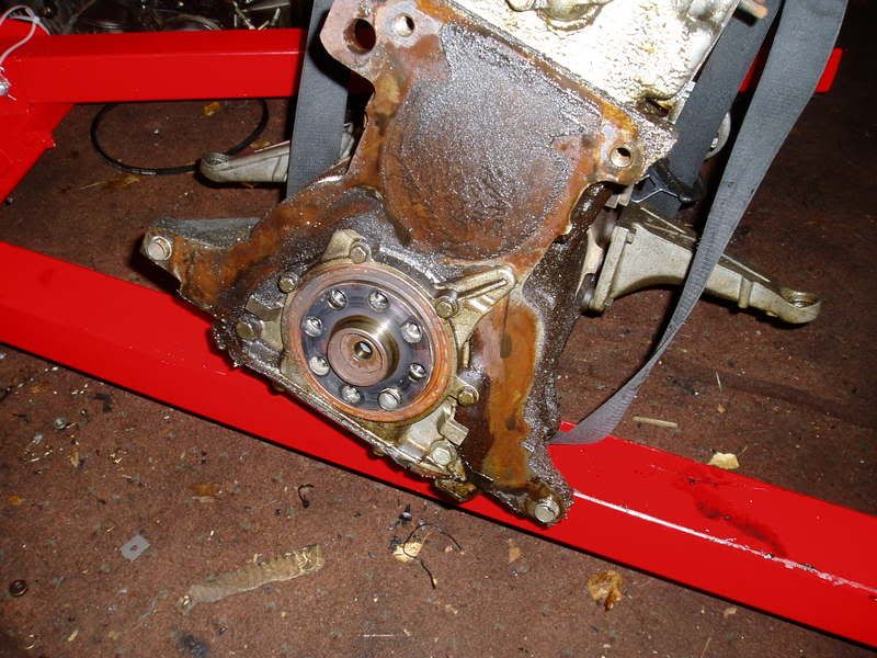

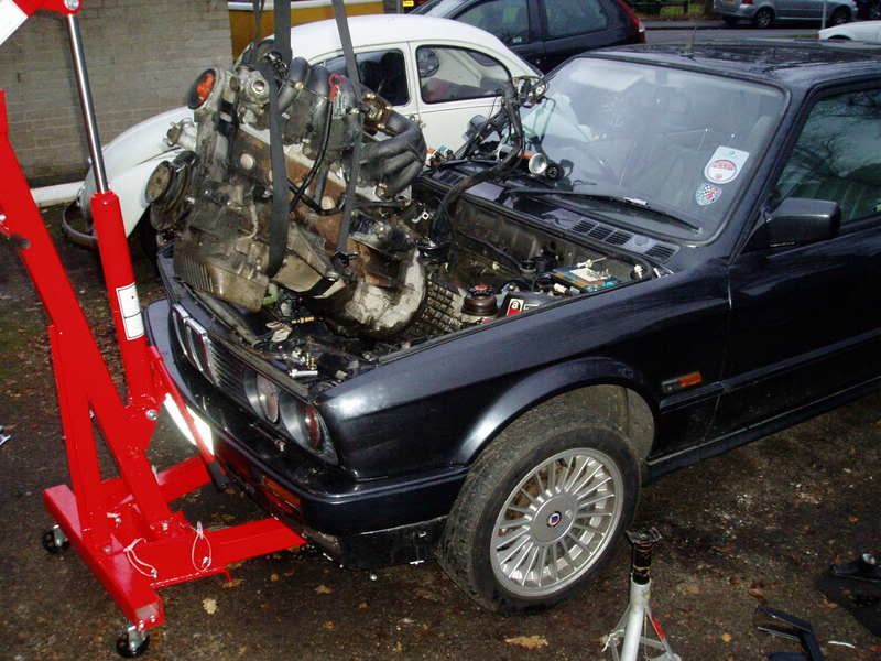

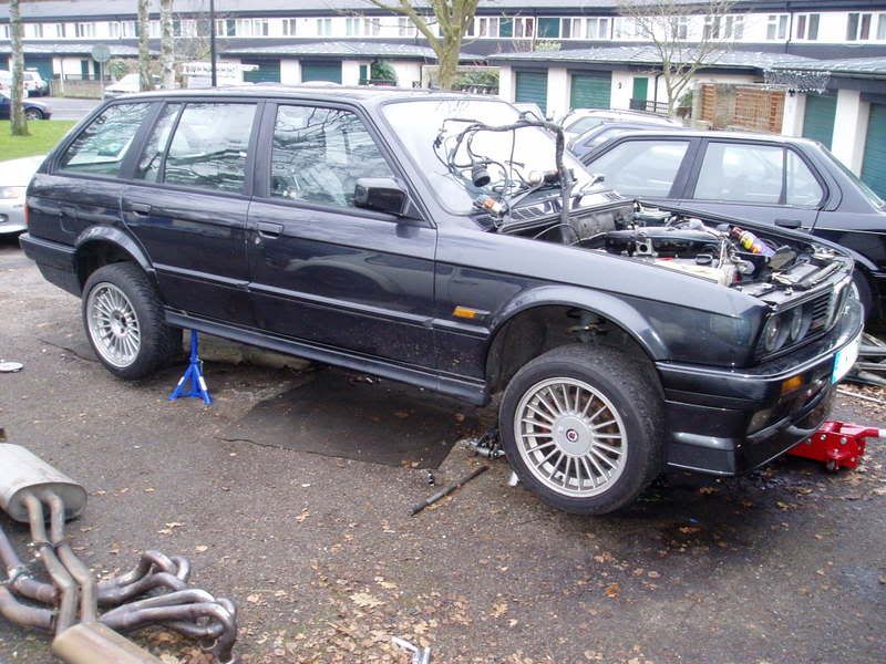

Cracked on today and it was nice and warm!

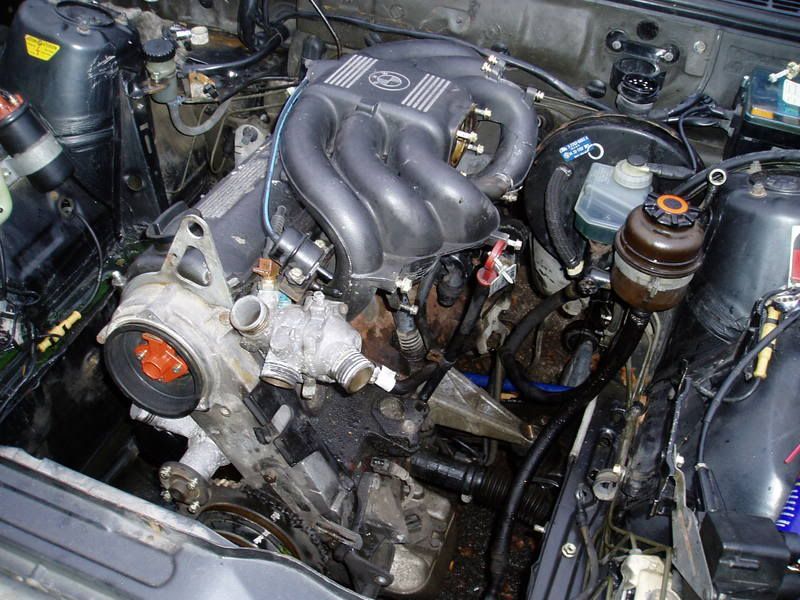

Engine ready to come out, some bad oil leaks and iffy clutch being my reasons. I know it could of stayed in but i've got my reasons
nearly ready!
nearly out!
large void
boat anchor

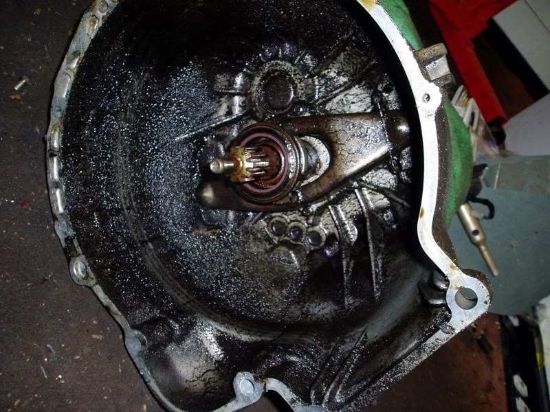

Nice oil leak, bloody gearbox is covered in oil it's coming out of every seal nearly!
Clutch still had life in it was getting close though!, flywheel is ok. But the slave looked a bit grim and leaky, master isn't better so we need to replace the whole clutch system imo. So thats what we'll do!
Another oil leak!

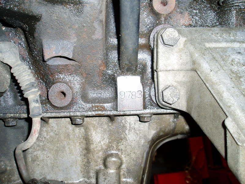

See this is where normally the pina engine number is stamped........not there
But this is the build number on another face, this is the same one written on the build sheet and written on the ecu

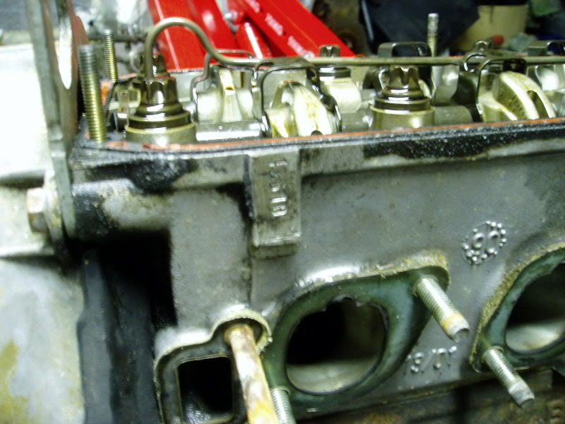

Here on this raised flat section is where alpina stamp the head, normally it's 4 numbers but this one has 5?! Who knows

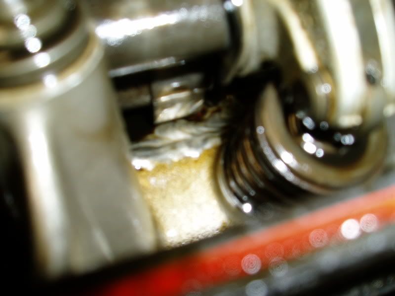

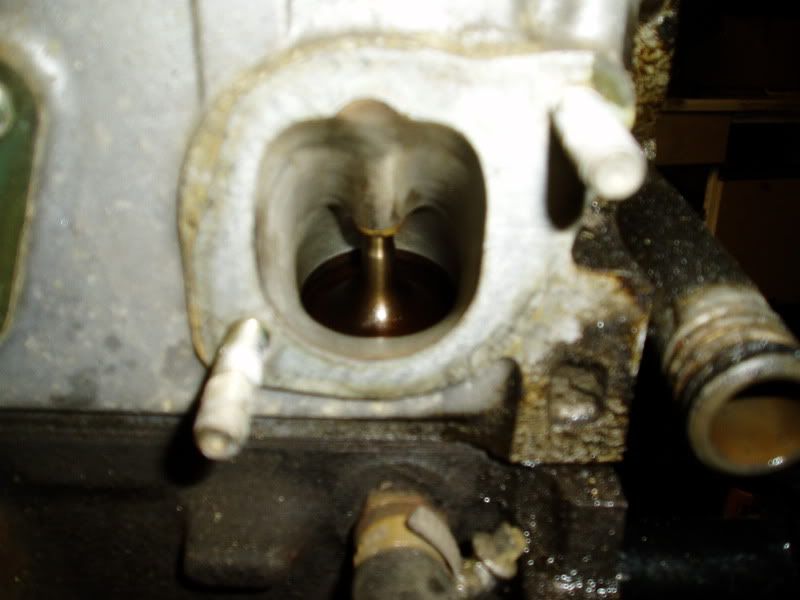

Heres the weld then, runs from number 4 to 6. The engine was over heating in 2003. This is noted in the history and the refurb on the head came to £700 alone, new valves, valve guides, stem seals ect total overhaul on 130,000 miles
Nice and clean still

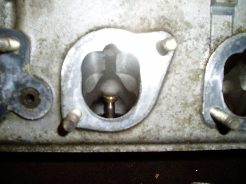

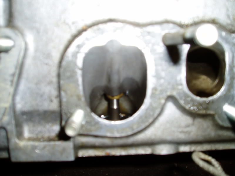

Now this i can 100% confirm has been fettled on the ports. Exhausts ports look a touch bigger but i'll come to that later. Now the inlet port side is bigger than the gasket stock ports are the same size, it's been smoothed out and they've smoothed it out around the bottom of the valve guide. The overall shape looks very similar to stock in my eyes
This is a standard 2.5 inlet port
This is an inlet port from a non BMW aftermarket 2.5 head and it's different again.
So very interesting so far, and more to come 2moro when the sump comes off. Hopefully the shells,crank won't be knackered and i don't have end up with a bottom end overhaul!
Engine came out with no dramas i deliberately over stripped it, and no mullering of the front panel either. The refit is more difficult though so fingers crossed.
nearly ready!
nearly out!
large void
boat anchor
Another oil leak!

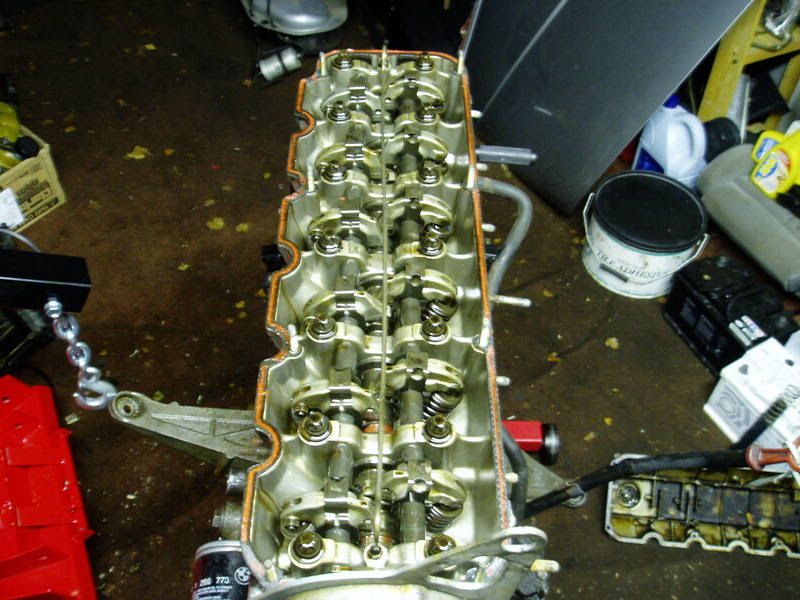

- Posts: 24536
- Location: London/Surrey
You pulling the head off to see if the combustion chamber parts of the head have been modded to a hemispherical shape?
- Posts: 22697
i'll eat my hat if they aren't, i don't really want to spend more on a headgasket + bolts to have a look really When nothing is wrong
- Posts: 24536
True, would be nice to have a look though, and measure the valves.
- Posts: 15846
When was the head done? Just wondering re stem seals. Agreed not worth pulling the head just to check the chambers BUT it would give you a chance to do the valve stem seals and give them a little lap for good measure.
- Homo Hair
- Posts: 20362
Well I have to say I wasn't expecting that, but keep on it Si
- Posts: 24536
This guy doesn't mess about eh?!Jhonno wrote:Well I have to say I wasn't expecting that, but keep on it Si
- Posts: 22697
It's only done 40k since this top end rebuild, i'm just sniffing around on the bottom end. Cleaning up the rest.B7 wrote:When was the head done? Just wondering re stem seals. Agreed not worth pulling the head just to check the chambers BUT it would give you a chance to do the valve stem seals and give them a little lap for good measure.
It's tempting to take the head off as the gasket is leaking by the main oil gallery from the block on the exhaust side front corner. They all do it, but demlot told me a trick to stop it!

Do tell....Simon13 wrote:They all do it, but demlot told me a trick to stop it!
- Posts: 22697
just some special sealant on the edge of the gasket before torquing the head down thats all.

Yeah!!! Come on share the love, mine does it even after a fresh head gasketbss325i wrote:Do tell....Simon13 wrote:They all do it, but demlot told me a trick to stop it!
