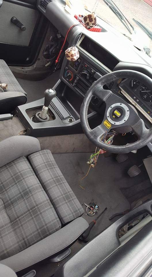

Got it home and it's rock solid so E36 went with intention of fitting the M52 to it and hammering it round croft.
However after 6 years of odd weekends messing with it and rebuilding it I can't do that to it so a couple more jobs and it's MOT time finally.
It's m52 with m20 flywheel and manual conversion, m50 inlet and ecu tweaked by Dante and manifolds the same, cannot recommend him enough and wish had just had loom conversion done by him as it was a right sod.
325i brakes and suspension and exhaust with a tailpipe hidden to look like standard 318i
Bodywork has couple scratches and marks but will get sorted maybe next year.
Have few pics of it from first collecting it to how it sits now, even got hold of fibreglass bonnet (off M3 racecar) to make it easier to work on in garage lol
