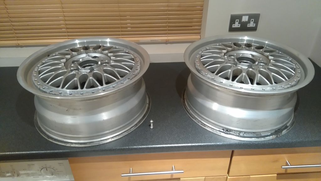

Bought some Hartge splits for the M3
Steve
Posts: 13151
Sun Dec 23, 2018 4:47 pm
Perfection !
Nothing more anyone else can say :thumb:
