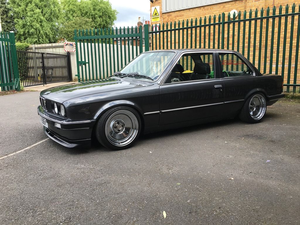

Few latest pics of the old girl before it gets taken off the road.

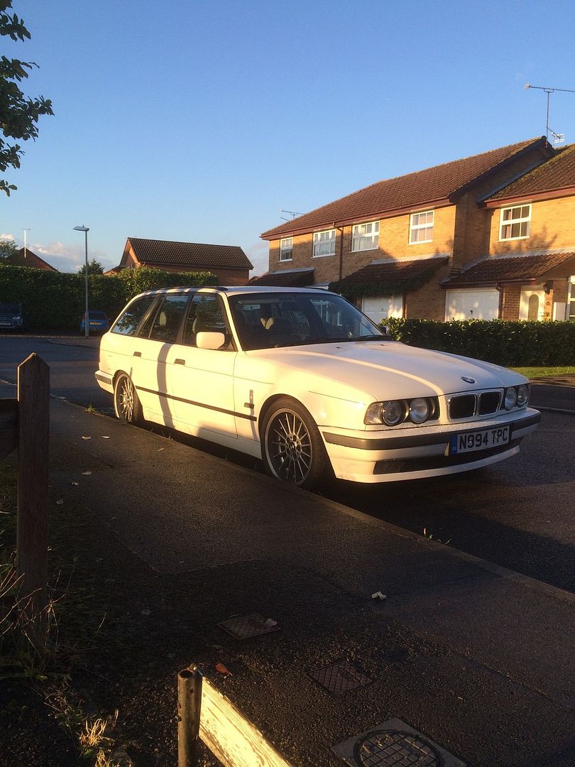

May well end up with this

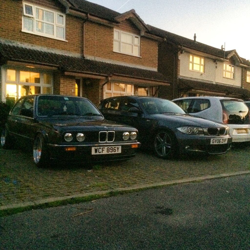

And bought another car for the mrs, 130i. I'm quite impressed as modern isn't really my thing

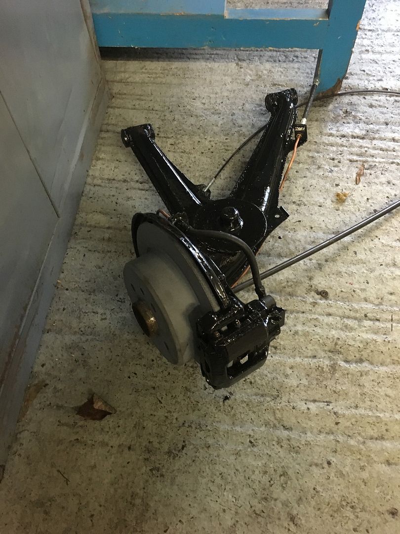

Firstly it had rear drums which had nothing wrong but I'd rather disks so picked these up complete for £50
Gave them a good clean up, lick of paint and new brake lines and cables.

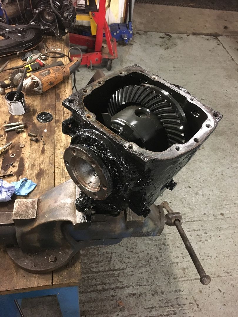

Then my poor little open diff finally gave up from the abuse and went pop in traffic on a Monday morning. Seemed pointless putting another open diff back in so I found a 3.91 LSD on the bay and snapped that up, again new gasket, oil and a lick of paint after an internal inspection

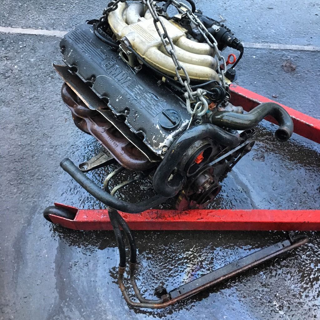

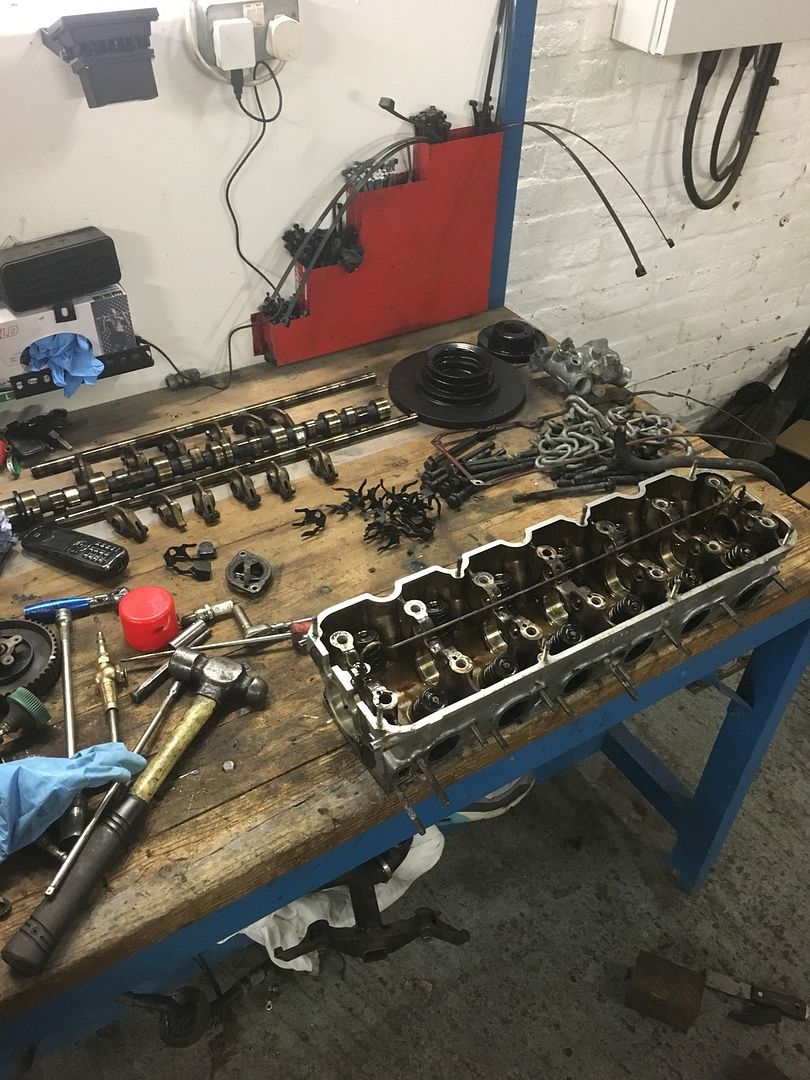

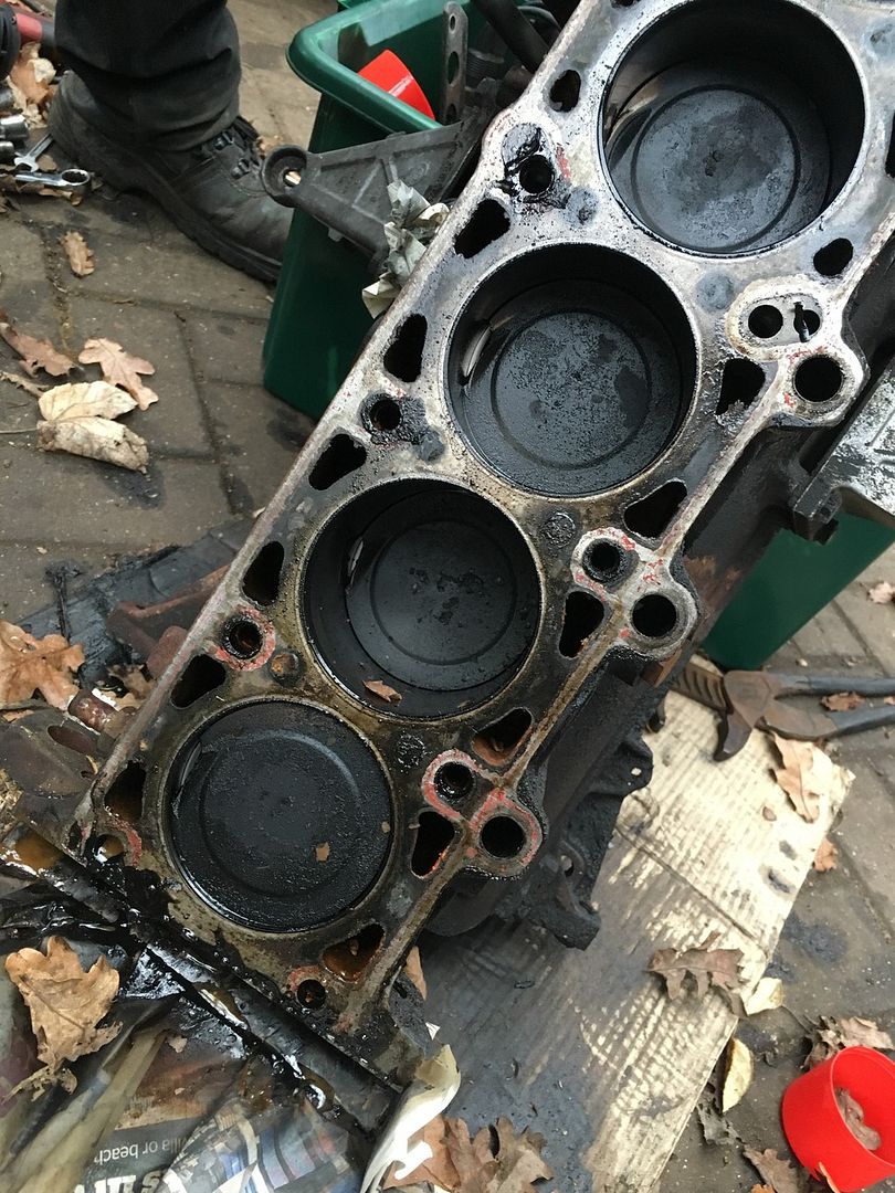

After fitting all that and it driving ten times nicer I thought about upgrading the power side of things, although the trusty b20 still pulled well, just wasn't enough. Went shopping for a b25 as I want to keep the bay looking similar to original. I bought what I believed to be a b25 and turned out to be 2.5 head on a b20 block. Never mind sold that on and dropped it off at pacers for him to then find I'd been stitched unknowingly and turned out 3 of 6 Pistons have holes in them and bent a majority of the valves

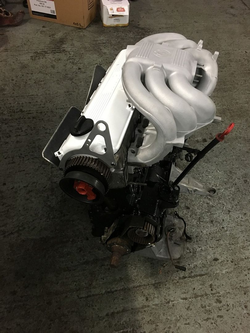

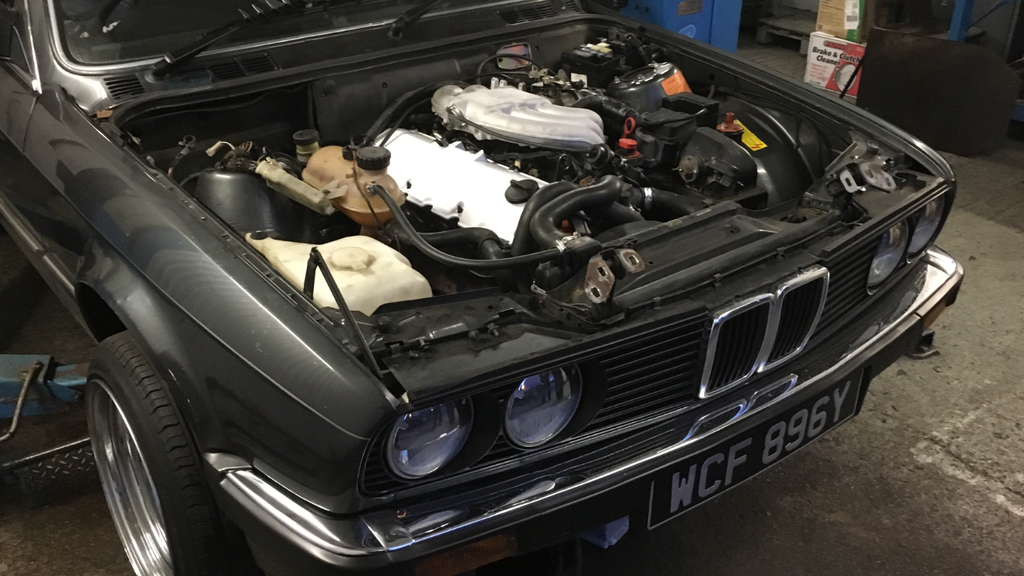

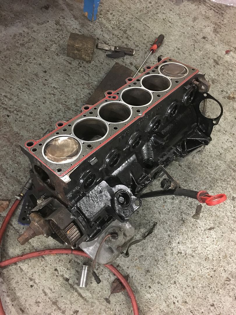

After that I bought an 87 b25 that I thought boom chuck a belt on it and throw it in, the belt but didn't really happen, I after taking the belt cover off I got carried away. Well here's before and after
Before Image
AfterImage
A couple of in between pics Image
So at this point and only taking half a day to swap everything over, it went wrong. Early loom and I had bits missing and all sorts being wrong, here's where I got too
I've been back to pacers again and bought everything facelift, spliced the looms together last night so all being good it'll be back on the road tomorrow.

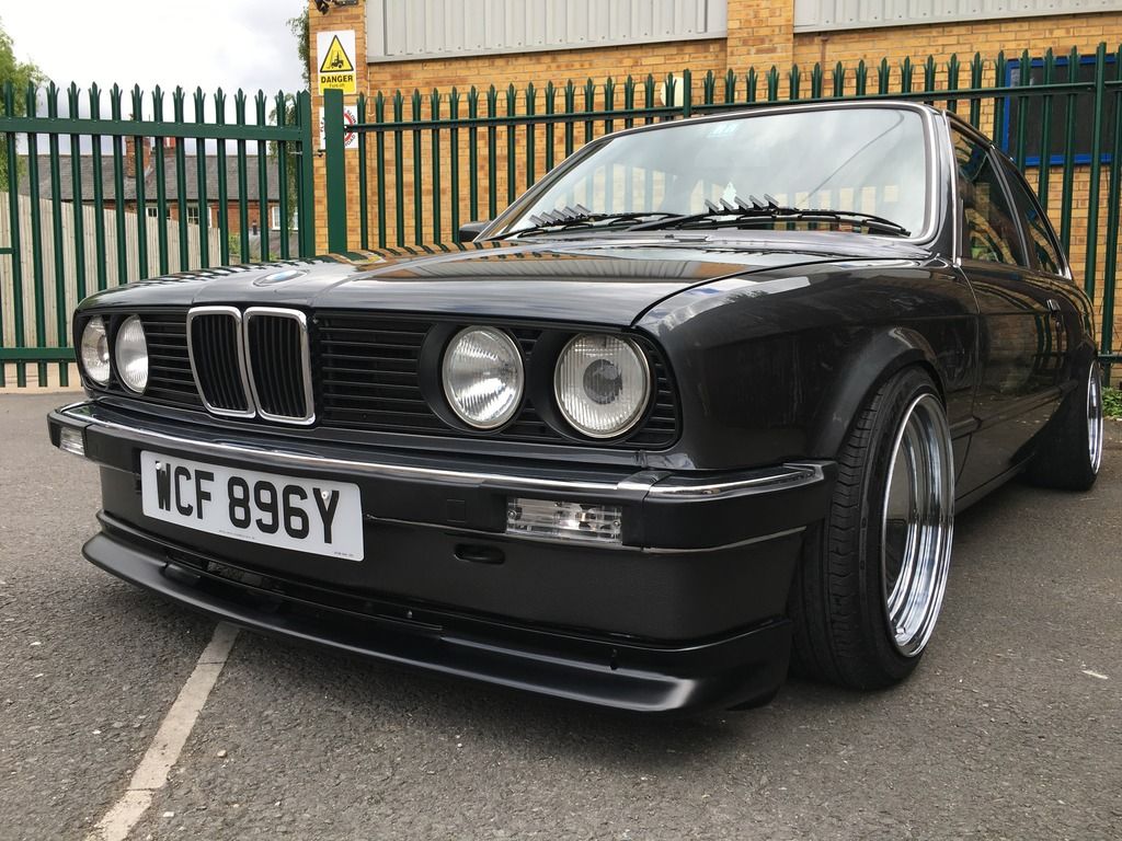

I also spotted this on eBay for a nifty and couldn't resist really as I think the original looked boring

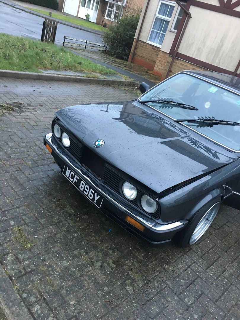

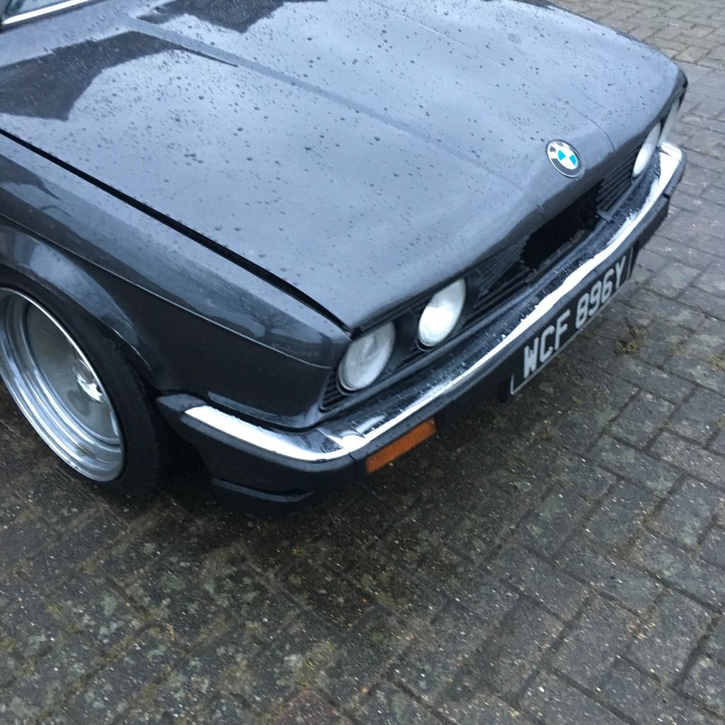

Nice work, but the silver on black plates are absolutely rank. It's not a seventies Marina, it's an eighties BMW and needs the correct plates (the ones it had before....).

Thats the money shot! 8)
Also I cant stop staring at them headlight covers haha Are they from a beetle?

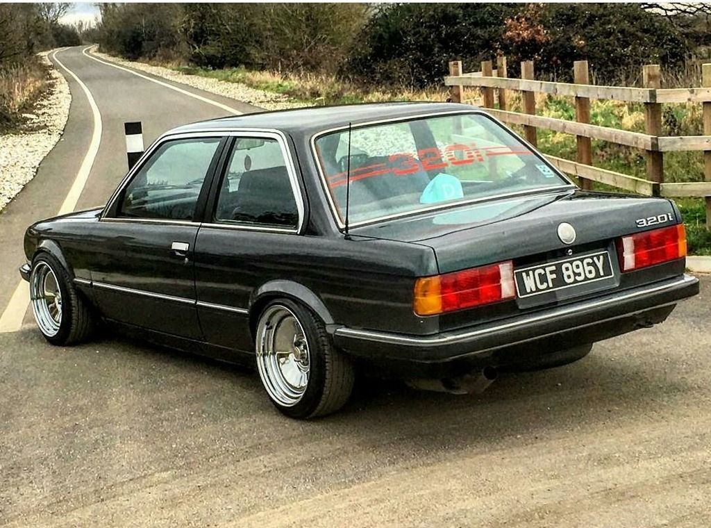

very cool chromie :cool: the new wheels really suit her! i also love the period correct 320i rear window decal! keep up the good work she's looking A1!

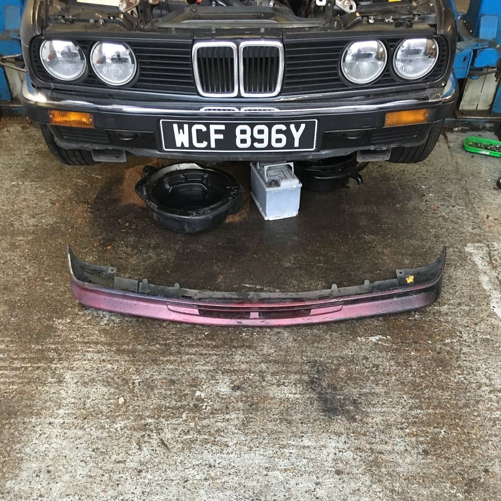

I decided to 'modify' an old valance, I've made it an inch deeper, welded up the fog light holes and the random square dent bit in the middle
This is as it stands, I have new wings and waiting on paint

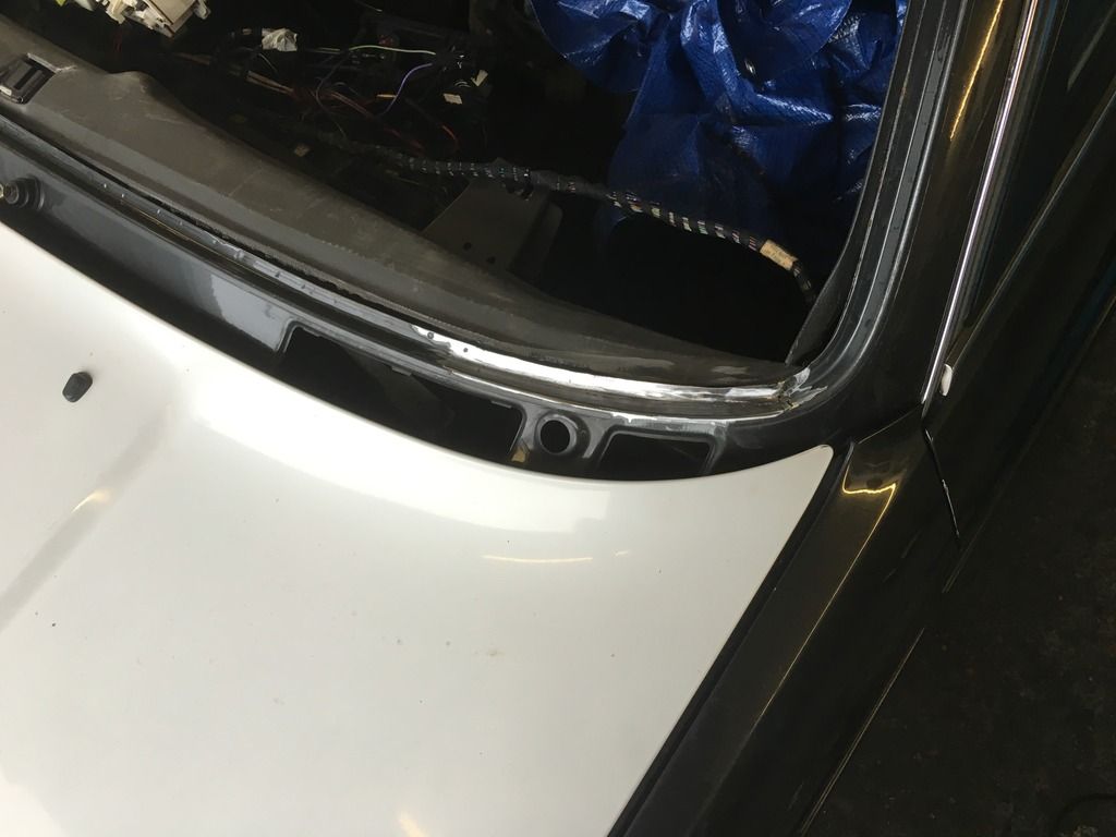

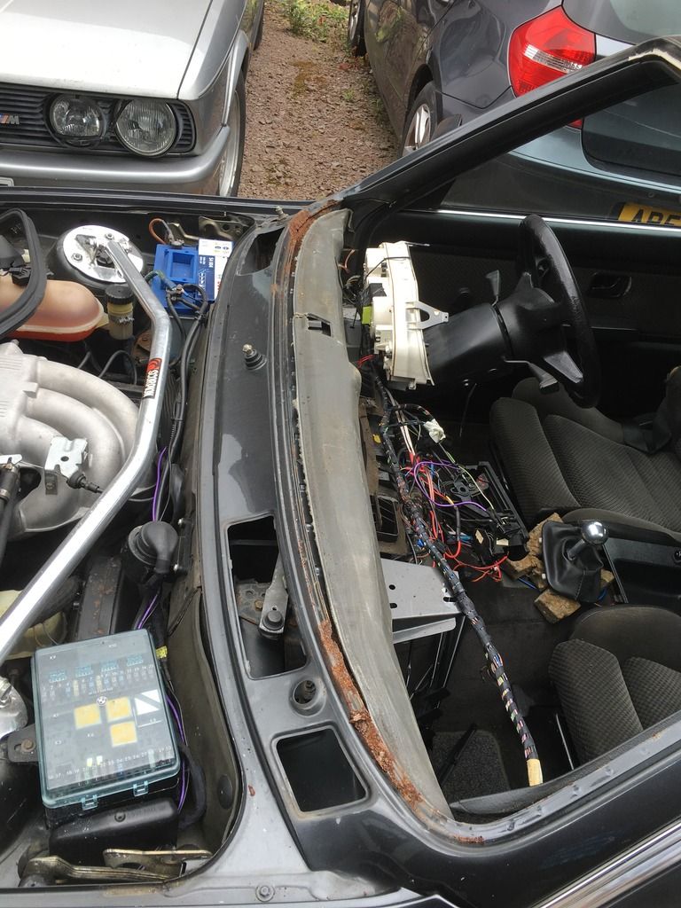

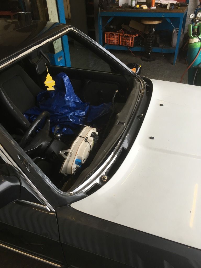

Well. The time has come for the bare metal respray. Took the screen out... Guess what I found.
Two hours work later
Off for paint and a few more mod's and I'll get some more pics up

Good post, this! An inspiration to others of what can be done to turn a mess that might make some owners lose heart, into pristine metal again, in just a couple of hours, using the tool we can see in the background of the third pic.

Brianmoooore wrote:using the tool we can see in the background of the third pic.
A swivel stool? :?
steve_k
Posts: 8044
Sat May 28, 2016 7:54 pm
A swivel stool? :?
i was thinking that :D
think he means the gas welder just off to the right.
MrHines
Posts: 139
Joined: Wed May 28, 2014 11:00 pm
Sun May 29, 2016 10:33 am
That swivel stool is a m20 crank I welded to a flywheel and a clutch plate at the top, cheers guys
