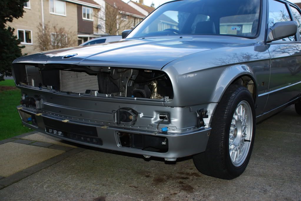

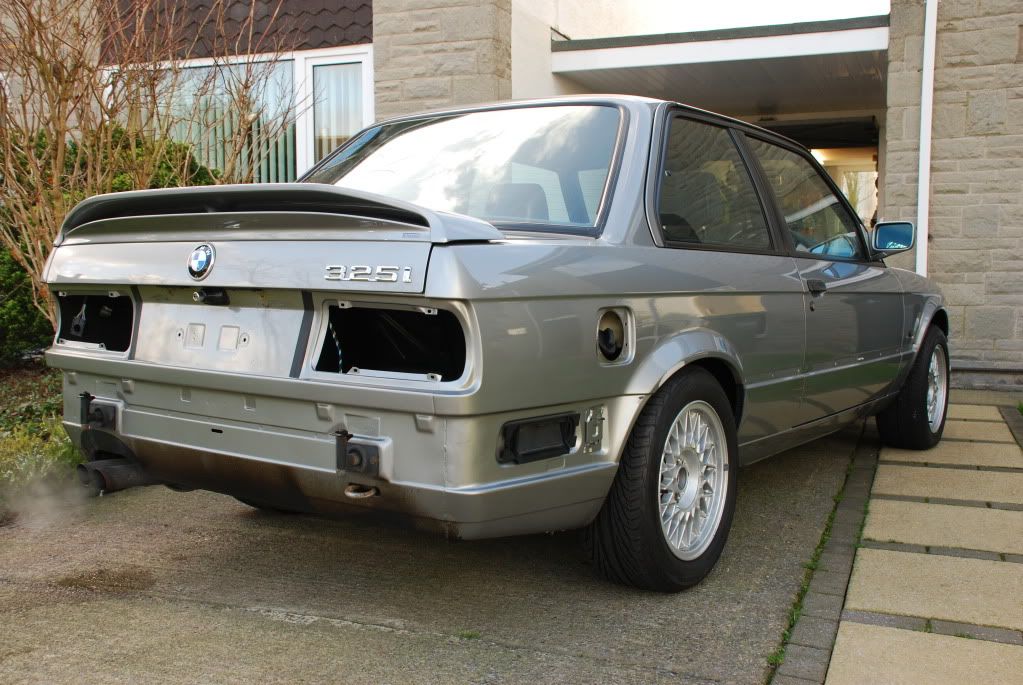

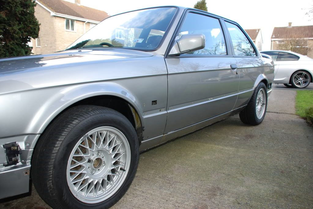

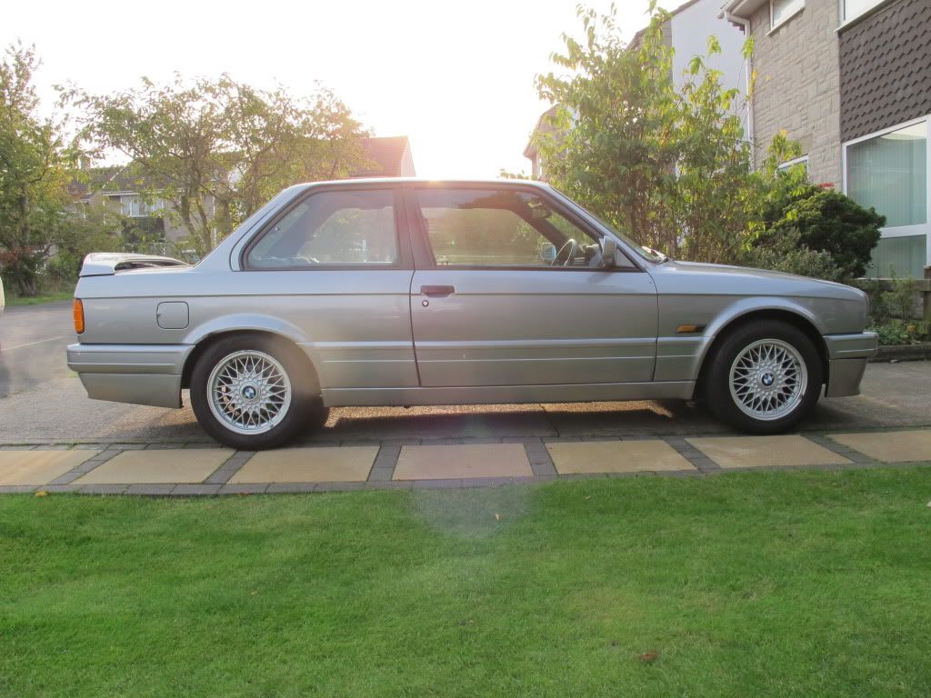

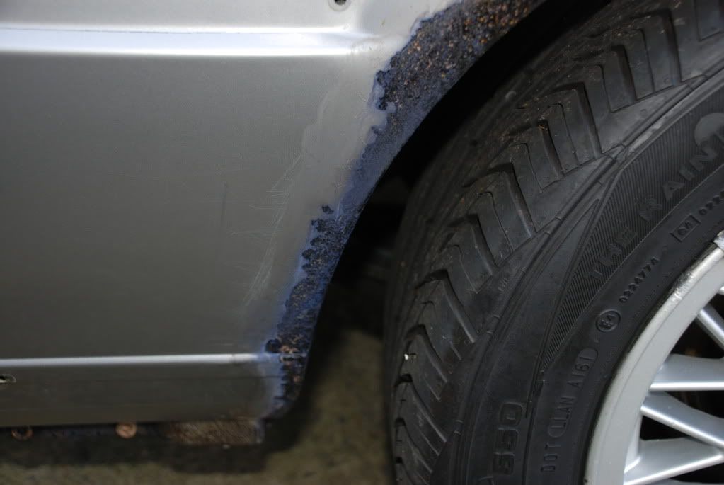

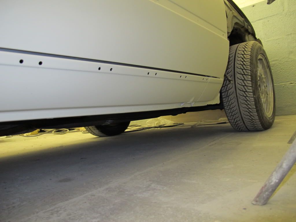

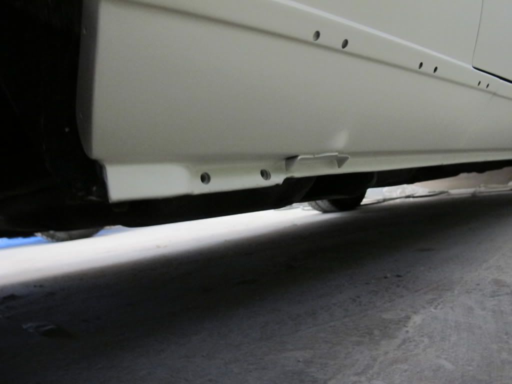

Well after many sundays my car is now ready for the paint shop to do their magic.
All jacking points seem good, but we found some rust as expected.
[/img]Image
Many thanks to Bass for the tip on removing the under bonnet sound insulation it saved a lot of time.Image
The car will have a complete re spray in the orignal colour 203 Lach Silver the body shop have estimated about 4 weeks.[/img]Image

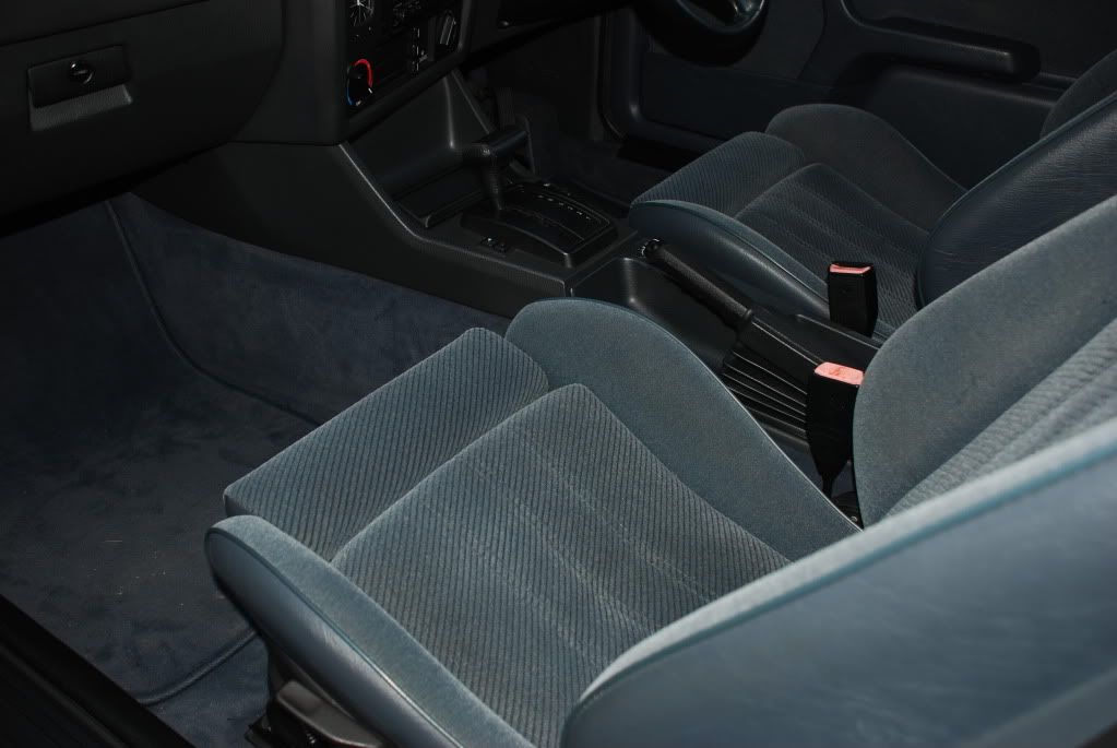

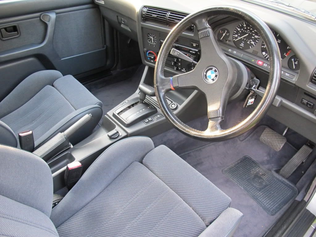

I bought the car last year from the original owner, who kept every invoice ever spent on the car, he had it for 22 years when I went to collect the car it was in his garage under blankets a very lucky find.ImageImage
[imgImage[/img]Image
[/imgImage
I have been thinking about changing the interior to leather, and fitting an Alpina Steering wheel.

The car is most certainly an unmolested looking car and quite a find in this day and age.
If you want a leather interior i take it you want an indigo blue one as that's what colour trim you have now but if you want another colour it means a carpet swap.
Either way, finding a nice original BMW leather trim in any colour in a nice condition to do your car justice will be nigh on impossible.
Nice original BMW leather trims are like hens teeth now sadly but they are all 20+years old.
I'd be inclined to keep the cloth as it looks to be in mint condition.

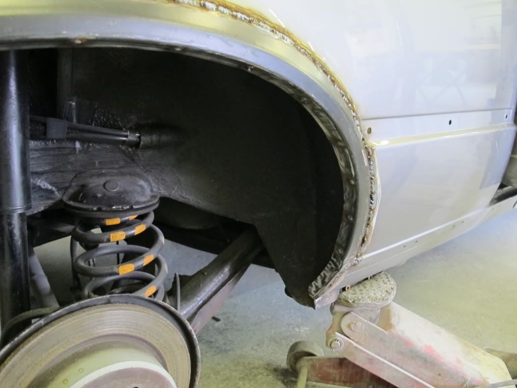

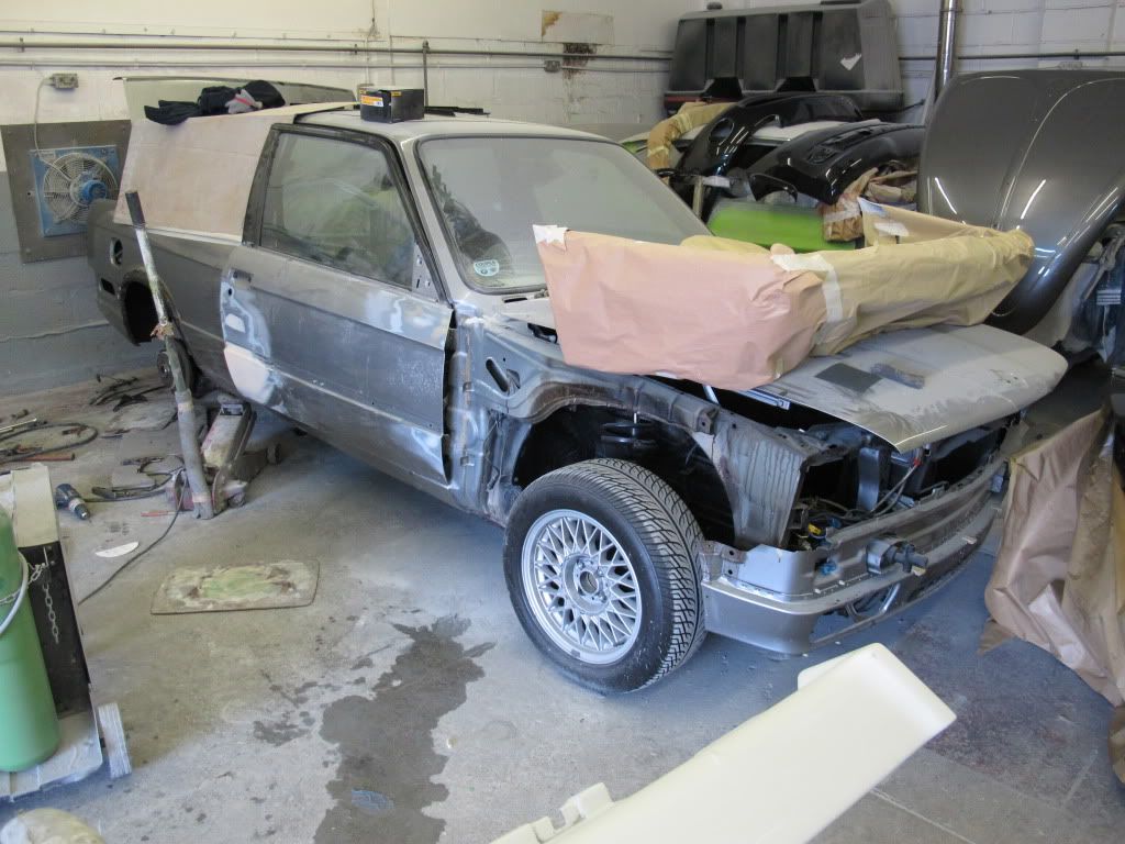

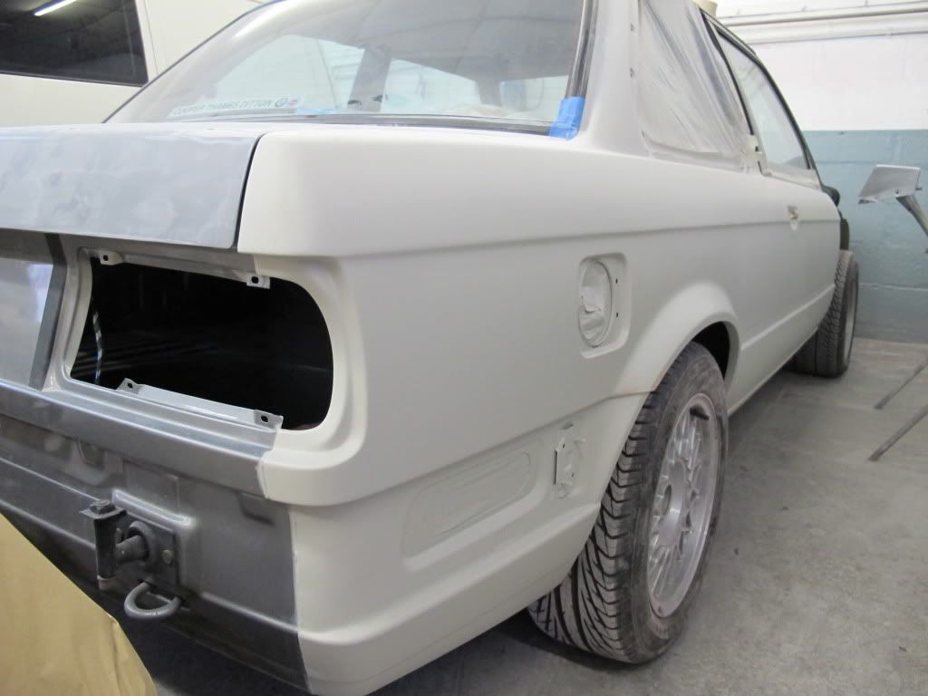

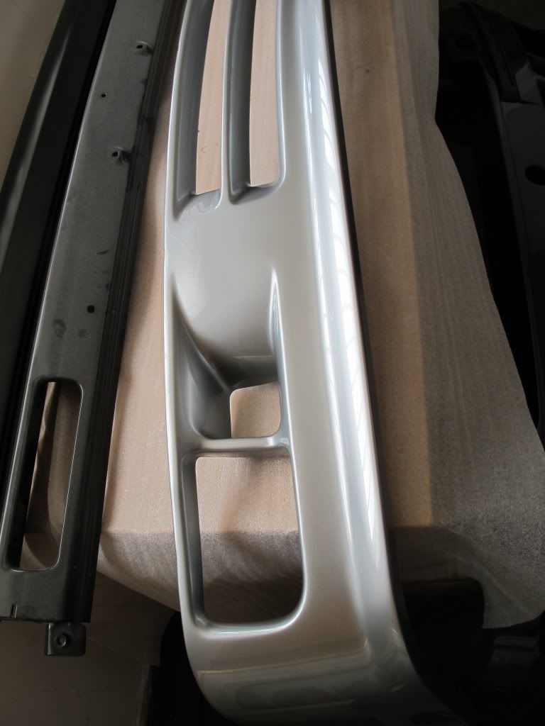

My E30 has now been in the paint shop for four weeks so a update of the work is overdue, all bumpers and side trims now painted, wheel arches cut out and replaced, boot lid repaired and now straightImage

Nice work :cool:
Fri Apr 13, 2012 7:43 pm
Proper original car there :cool:
Dont hold back with the waxoil when your putting it together 8)

Thanks for the interest, most of the body work is now finished and the car is sat in primer in the work shop waiting for a new bonnet to arrive from Germany, which unfortunately is out of stock.
The front of the car has also been removed to be sand blasted and painted, also the radiator is coming out next week to paint around the inside.
