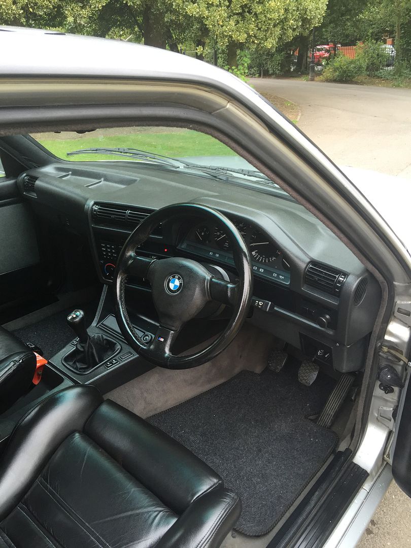

Little update of my e30 sport Sort EXTRA ECU STRIPPED OUT
SAP1
Posts: 466
Joined: Mon May 27, 2013 11:00 pm
Sat May 02, 2015 10:20 pm
Parcel shelf looks great, what dye did you use?
h2ggv
Posts: 384
Joined: Sat Jul 27, 2013 11:00 pm
Sun May 03, 2015 3:22 pm

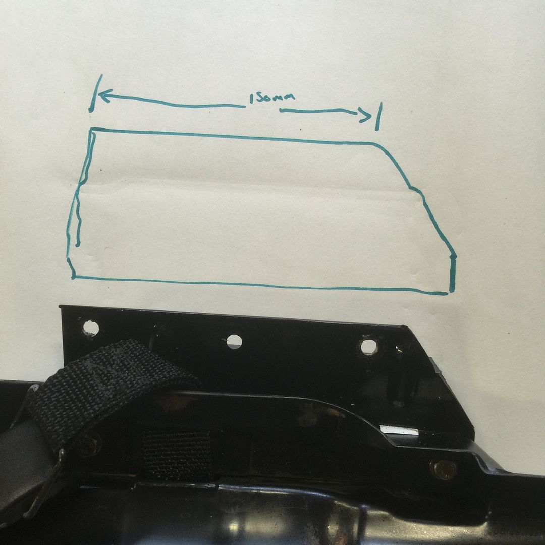

I just used two tins of pound shop spray paint any spray paint would do been painting car mats for years with the stuff :o :o
As for cutting the headliner i will do it Monday had a heavy weekend drinking so thats on the back burner.

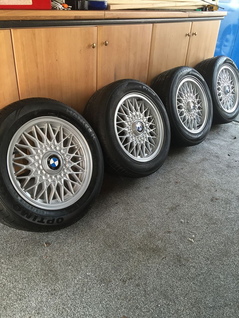

I have another set of bbs wheels with new hankook tires to go on will drop the wheels off to get powder coated tuesday

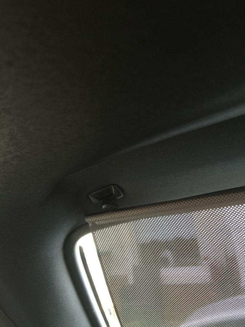

Got the clips fitted the other day was a nervous time cutting the headliner but all worked out well.
Just picked the wheels up all freshly powder coated look amazing

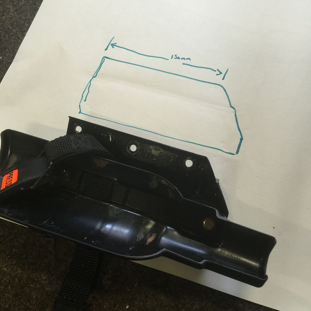

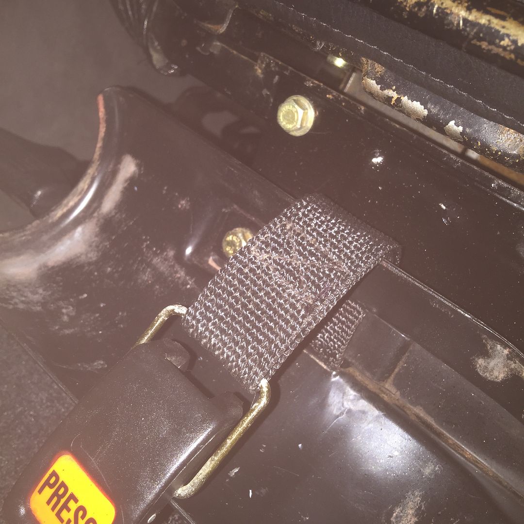

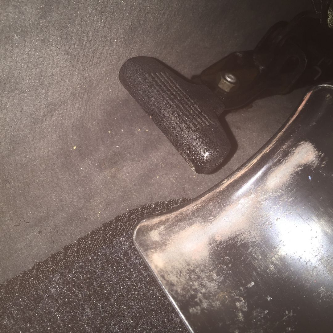

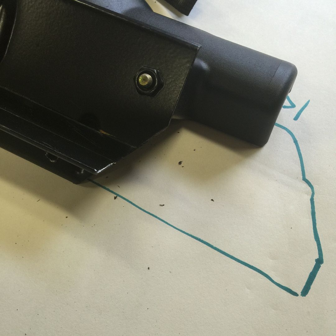

How did you attach the extinguisher to the recaros? I have the same seats and an extinguisher/bracket but there are no mounting holes like on the sports seats.
h2ggv
Posts: 384
Sat May 16, 2015 1:35 pm
Cloggy Saint wrote:How did you attach the extinguisher to the recaros? I have the same seats and an extinguisher/bracket but there are no mounting holes like on the sports seats.
I just cut the bracket down a few times measured so i could still use seat handle to move forward drilled holes in seat frame. The bolts that came will the extinguisher are like self tapping ones so just tapped screwed them into holes.
if you need pics of how i cut it i will take off and take some pics when i get some spare time just let me know.

Pics would be great. I've made a bracket to hold the extinguisher cradle but I'm not convinced it'll be strong enough once the extinguisher is in place.
h2ggv
Posts: 384
Sat May 16, 2015 1:45 pm
Cloggy Saint wrote:Pics would be great. I've made a bracket to hold the extinguisher cradle but I'm not convinced it'll be strong enough once the extinguisher is in place.
When i went to fit it the first time i was gutted so just went a bit made with saw to make sure it fitted worked out well in the end it was going in no matter what.
will get pics today

Sun May 17, 2015 6:30 pm
Hope these help
Cloggy Saint
Posts: 8024
Location: zummerzet
Mon May 18, 2015 9:37 pm
That's great, thanks!

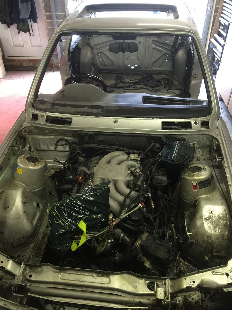

Wed Jun 17, 2015 6:23 pm

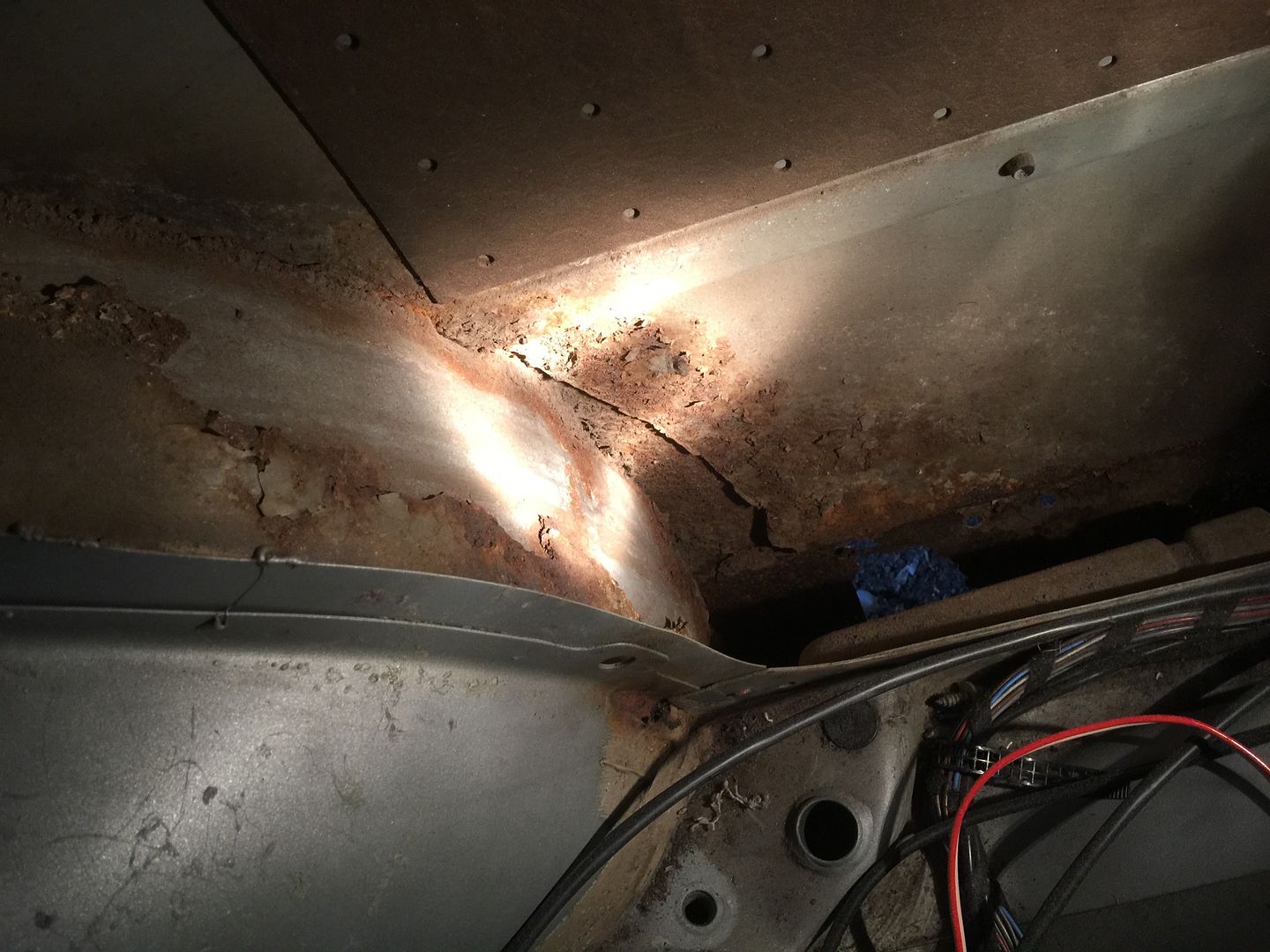

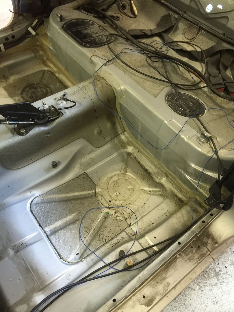

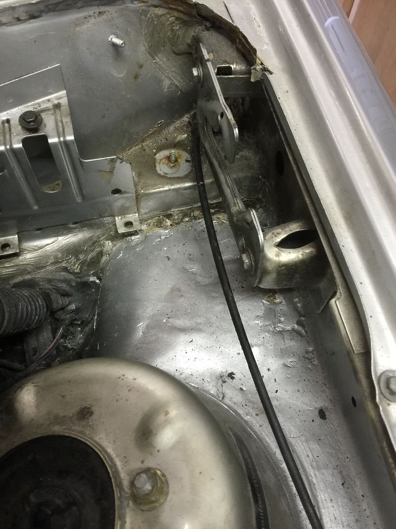

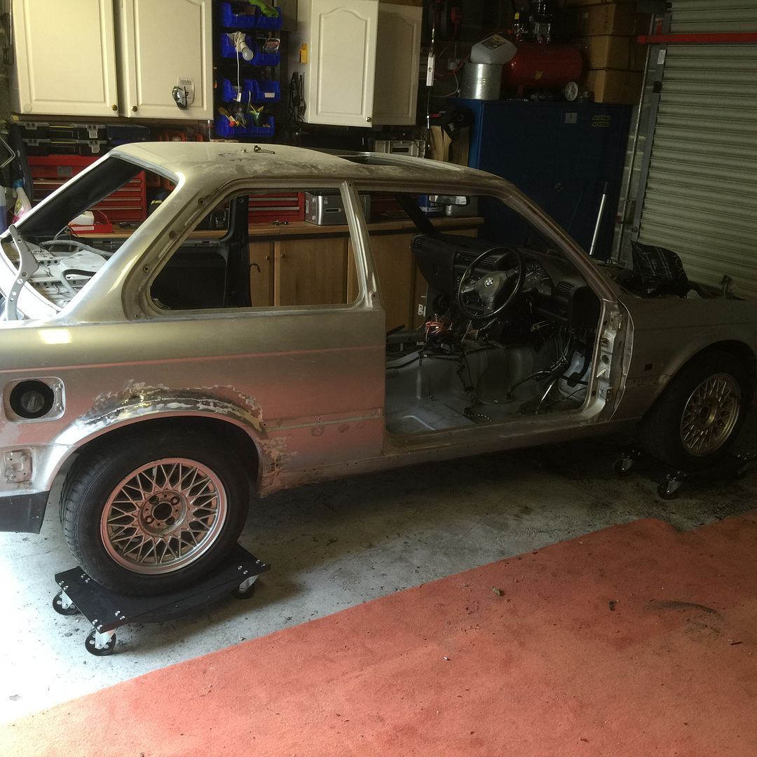

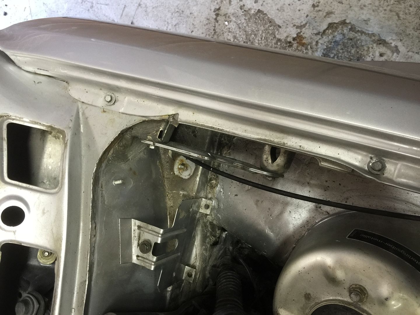

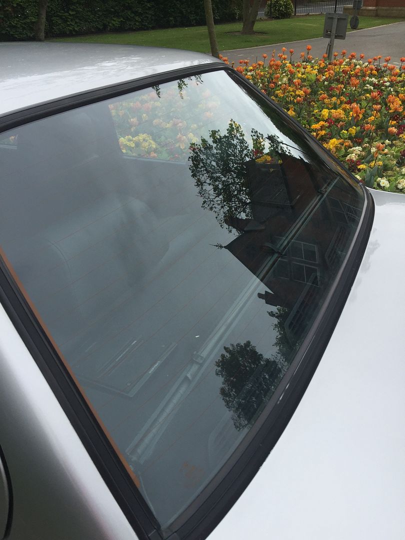

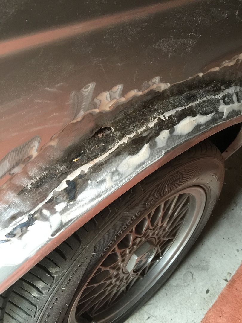

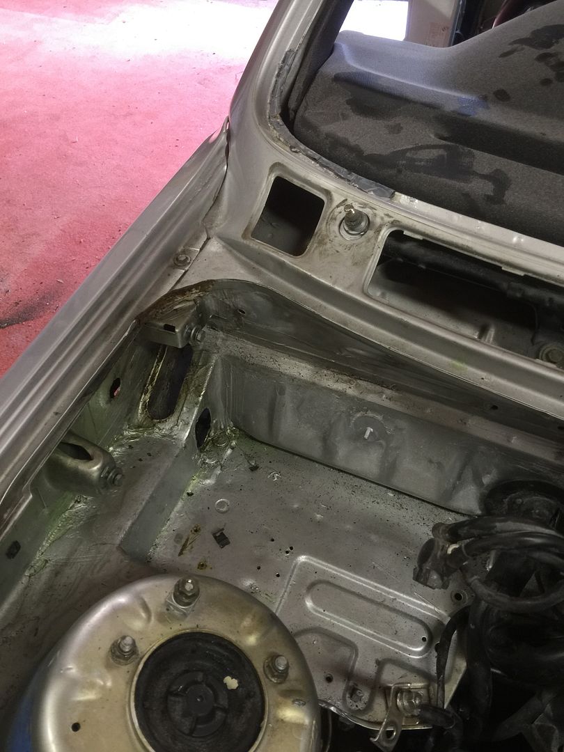

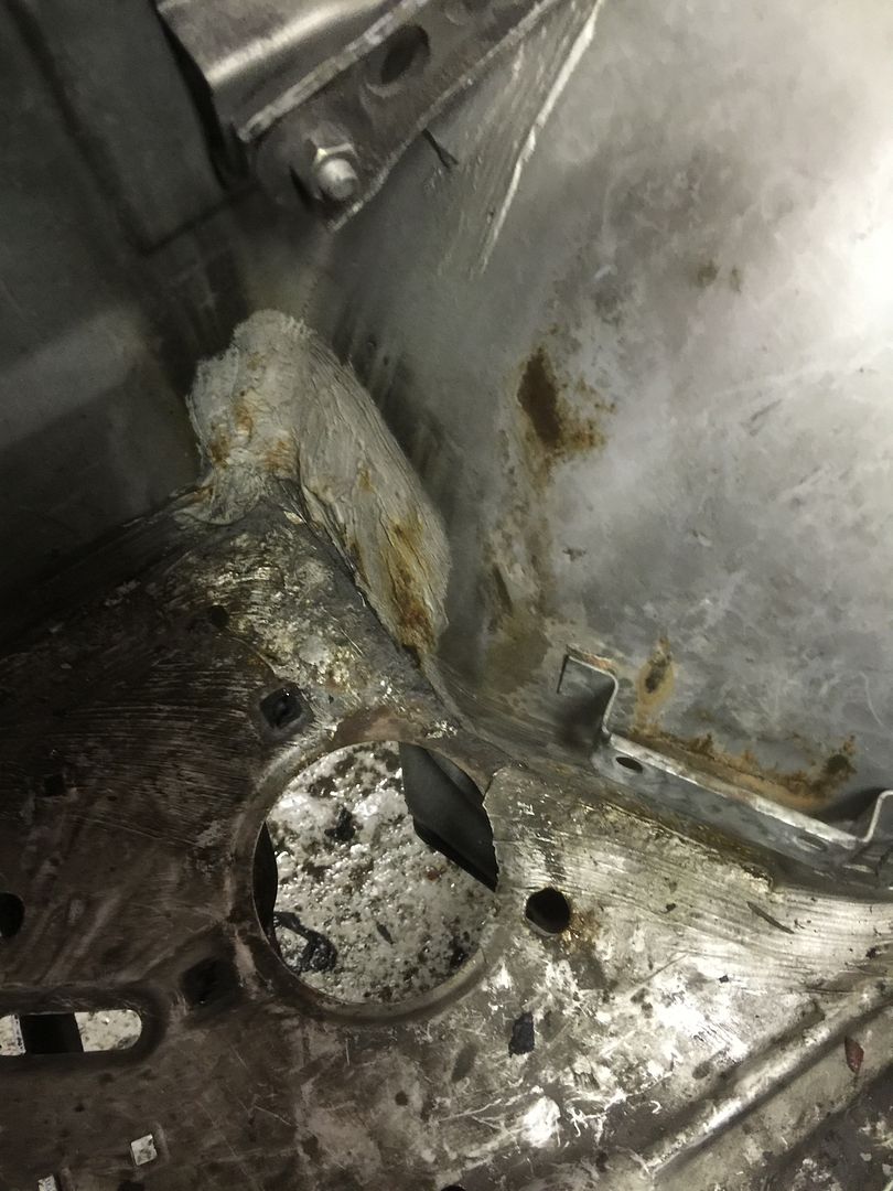

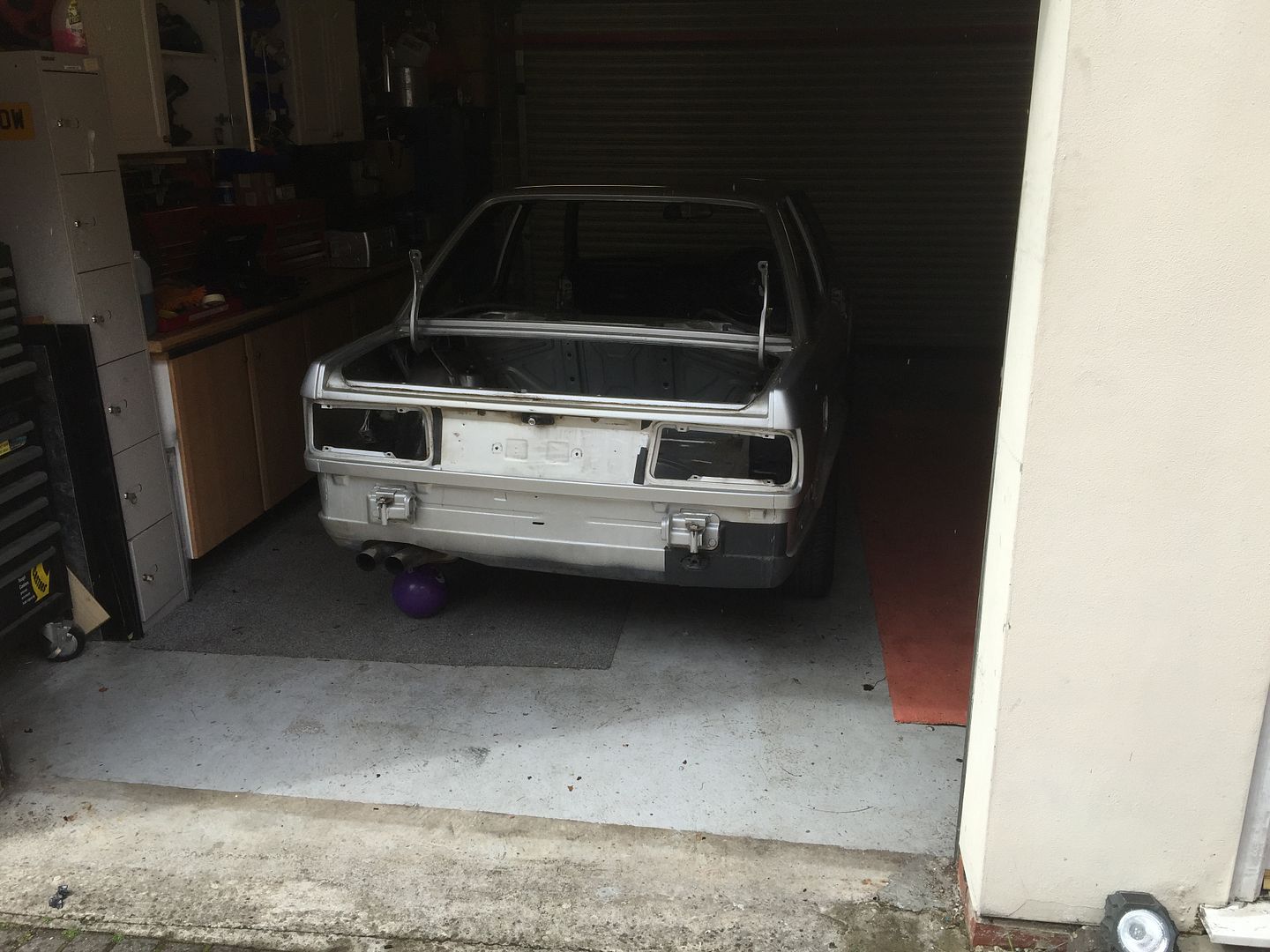

Started stripping the car down on Saturday all went well got to the point now im happy with for the welder to start.
I knew the back arches had been patched up over the years but now i know it wasn't a good job. Other areas aint too bad the front looks solid jacking points may need a bit of fab but the carpet was bone dry well happy with that.
It must of had new wings the front panel is solid. Got a guy starting the welding tomorrow so i will just let him hit everything that needs doing. Got a few holes that have been parched up before that look bad but overhaul could have been a lot worse
This is as far as im going i think with the strip down needed to get to this point to check all areas.
so looks likes the guy is going to be busy for a few days

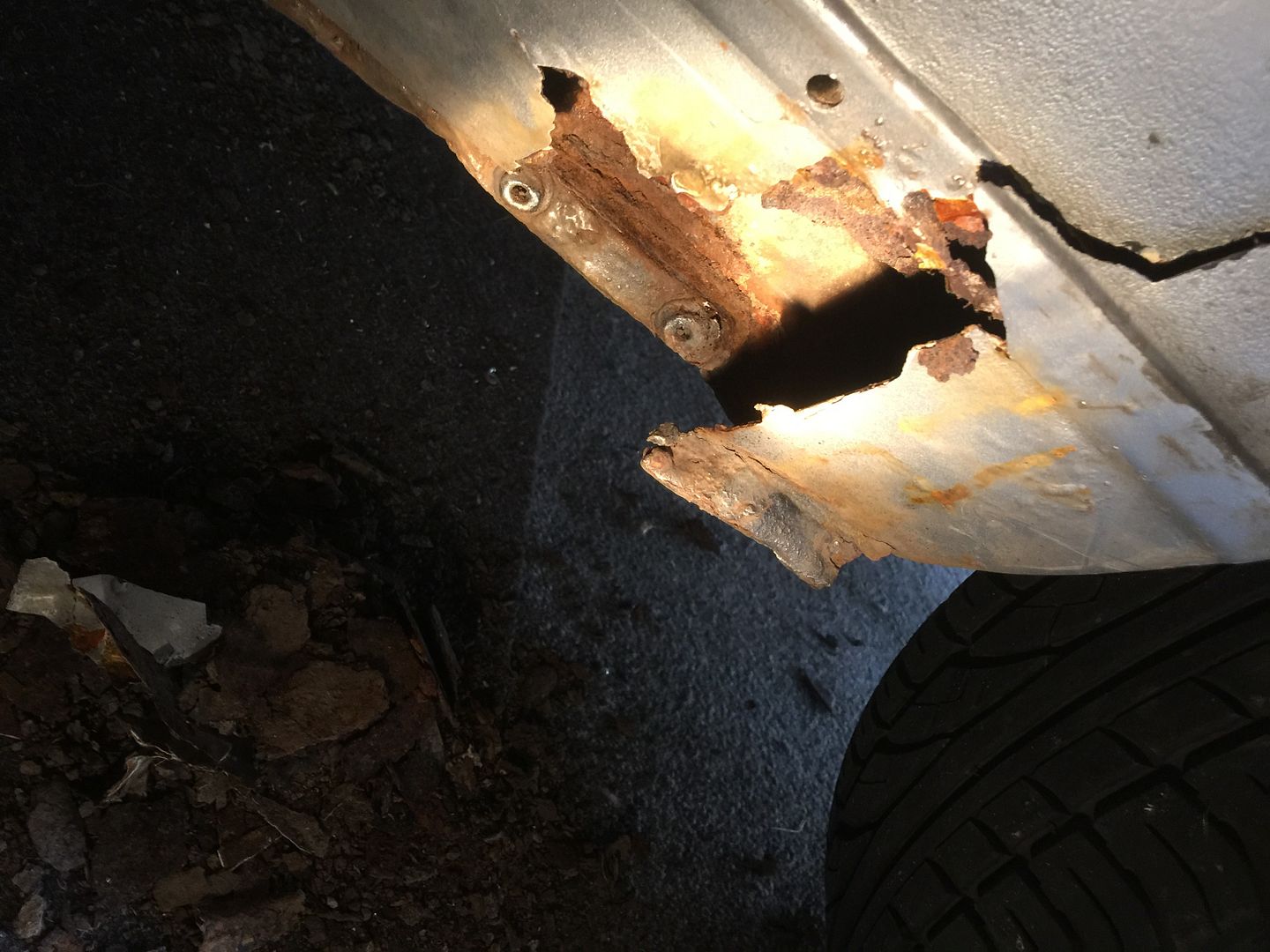

I knew the inner wings at rear needed looking at but the states of the repairs have been shocking. Every area that has rusted had already been repaired before just badly.
Will all be cut out replaced this week. Got a moblie car welder doing the work he knows his stuff so by Wednesday the car should be back to being rust free and solid unless any more areas pop up.
Sun Jun 21, 2015 4:30 pm
Wow that is bad! 8O
Those rear arch repairs are epic!
h2ggv
Posts: 384
Sun Jun 21, 2015 4:36 pm
bss325i wrote:Wow that is bad! 8O
Barry the welder said he aint seen anything like it been repaired on two different occasions the welder said. the inners what people in past had just made up was glued to the outer panel was always going to rust.
Thought the game was up after looking for inner arches for 3 days could not find them anyway ordered them from bmw so both sides will be new inners and outers. front footwells front of car two holes in boot and them ares near suspension top.
Is them square holes at front of car on floor not jacking points as the welder is saying not as this as been cut out 2 extra layers of previous reapirs. should i just leave the box out?

Sun Jun 21, 2015 5:13 pm
Points used by bmw at the factory bud, not jacking points.
