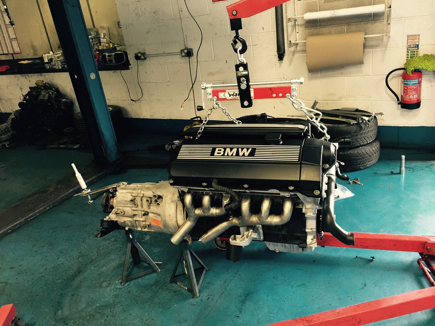

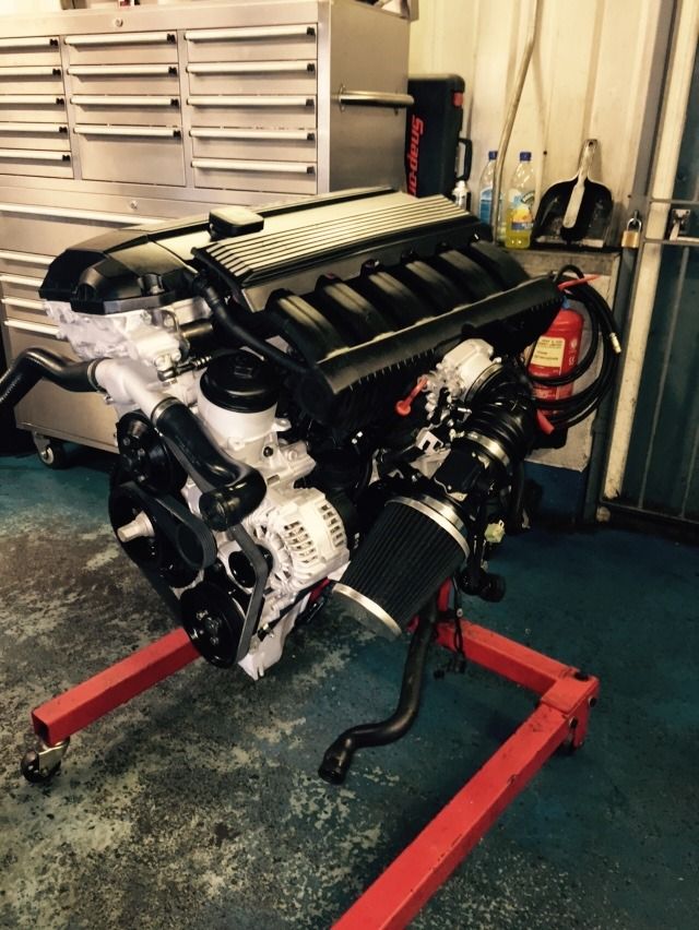

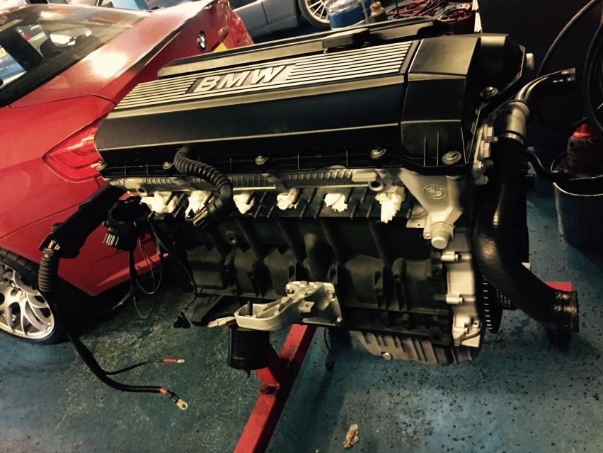

So the engine is finally ready to fit. The final stage takes longer then expected. Fiddly bits like Fabricating brackets for the fuel rail, dipstick and breather etc.
Here she is

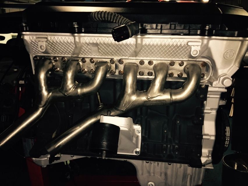

And thanks again for help from Ollie. Here he is cleaning surface and fitting studs ready for Danthe manifolds winkeye

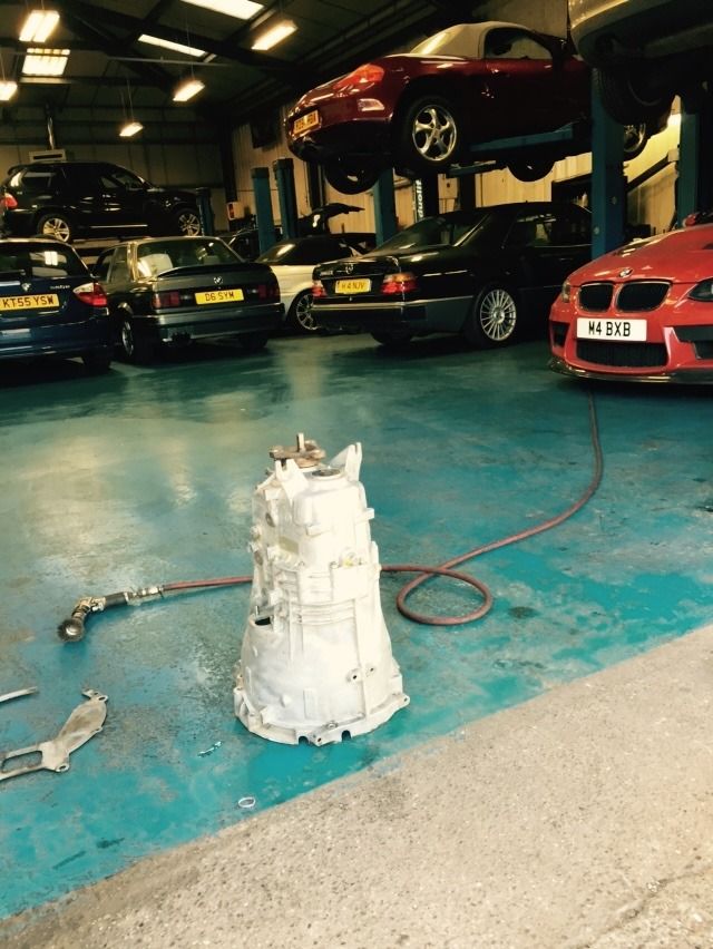

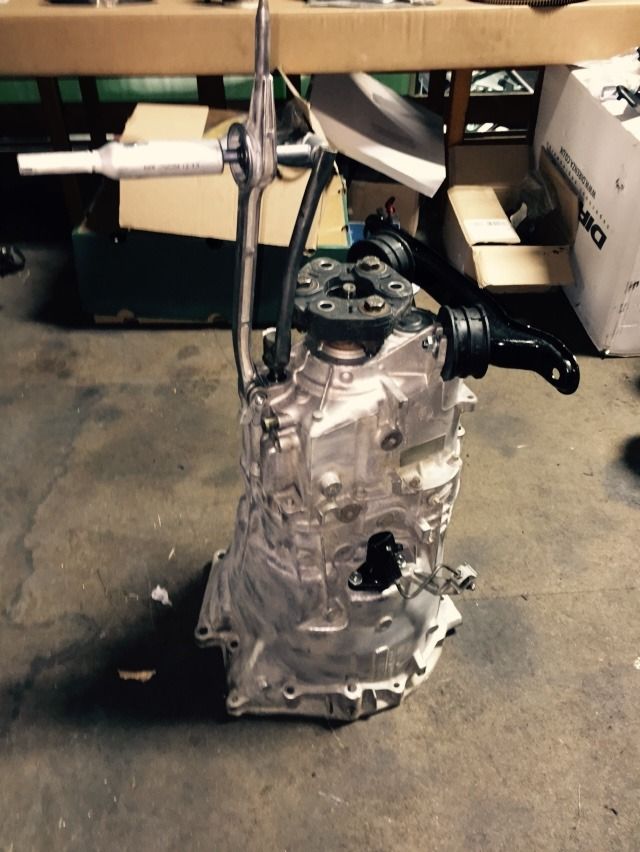

Also made the most of the sun. Got the gearbox all cleaned up and fitted new selector seal and output shaft seal
I also cleaned up my 323 flywheel ready to fit. Had a issue with the clutch kit though. As per the e30zone wiki guide I orderd a m20 clutch kit however the shaft is different on the e36 box so need to order m52 clutch kit. Presume I need to use the m52 release bearing also but I'll have to weld some spaces on to account for the smaller flywheel? Anybody shed some light?

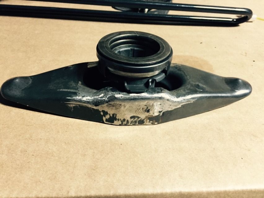

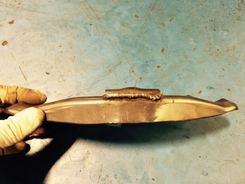

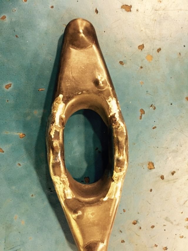

As I am using a m20 flywheel instead of the original dual mass. You either need a e21 323 release bearing or modify the original. I didn't like either ideas....
E21 bearing hard to come by and expensive from BMW.
I don't intend to have to change the clutch again but if I do I don't want to have to weld the bearing every time.
So my solution. Using 2 forks I added 5mm to the height. Took lots of measuring and re measuring to get it perfect...
Pleased with the results :D
Gearbox is now fitted with new seals. New slave cylinder. New prop coupling. New mounts
Plus new z3m selector and new bushes... Feels really nice and sharp

My manifold arrived from Dan. I have seen photos of these and heard they are good quality. However after seeing them in person I have realised the photos do no justice. These manifolds literally are a work of art. I was going to do the manifolds myself but would of taken hours(which I don't have). I am so glad I got Dan to do them. I would not be able to get them close to the job he is done. Cheers Dan

Nice job on the clutch fork, much better than the usual slab of 5mm plate! :D

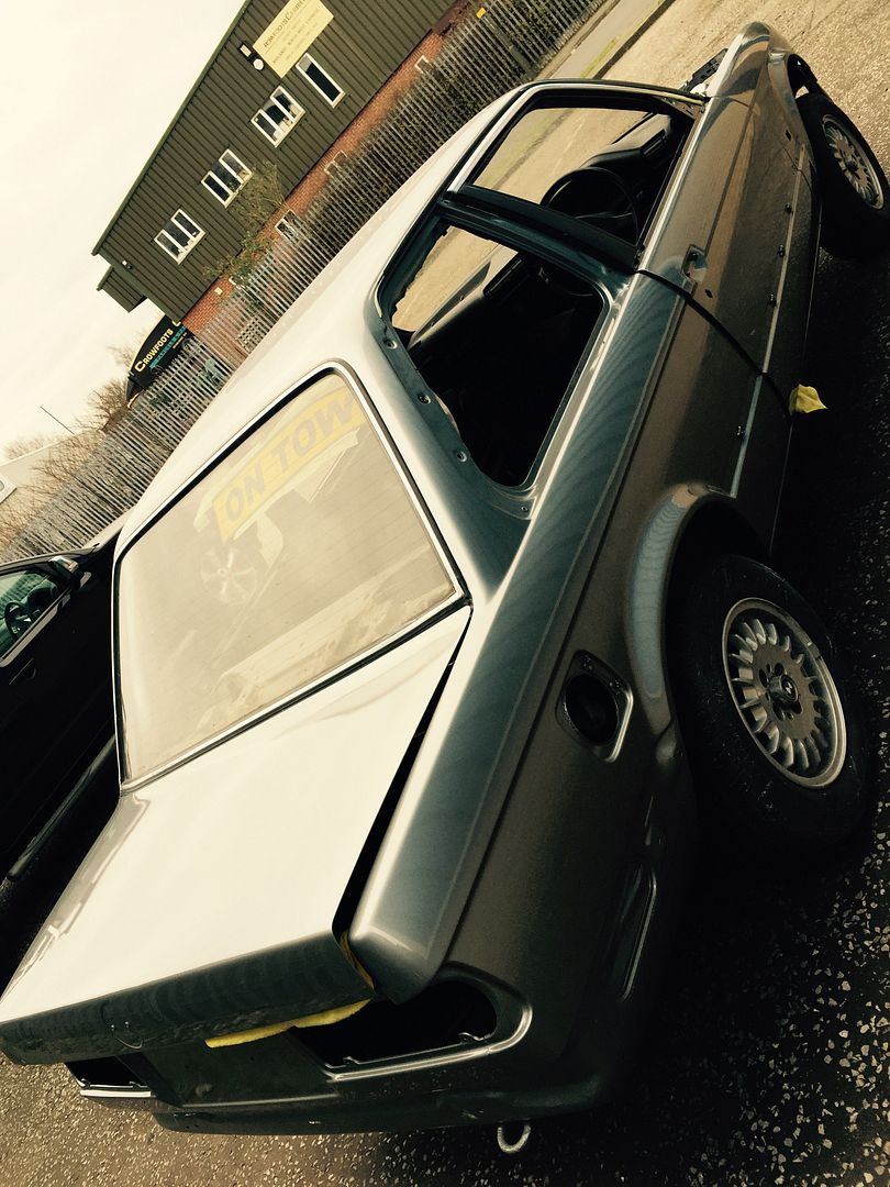

It's looking pretty mint now :D

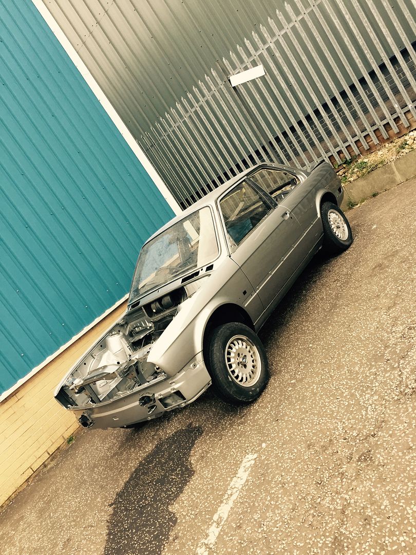

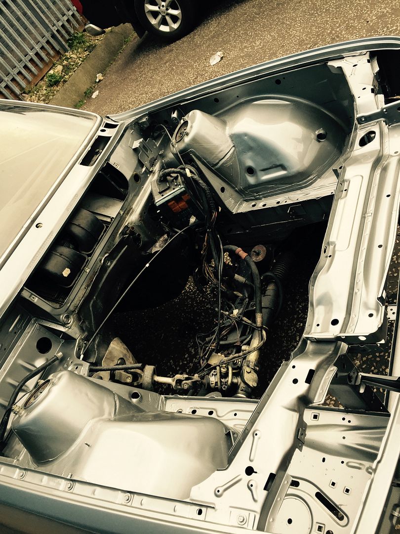

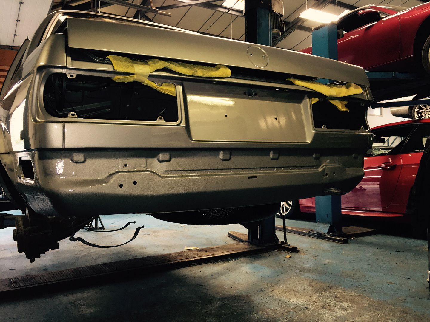

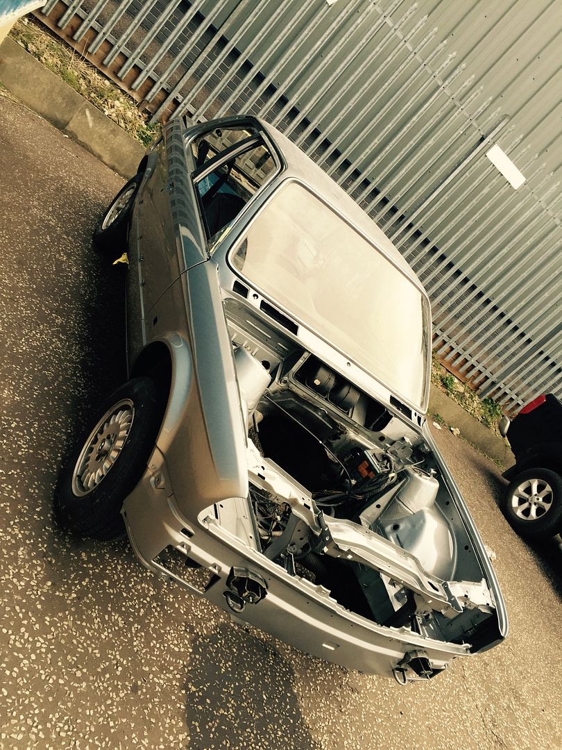

All painted and looking awesome. Few small bits to finish like the sills to stone chip black etc and still needs polishing. But finish straight from the gun is mint. One happy man.

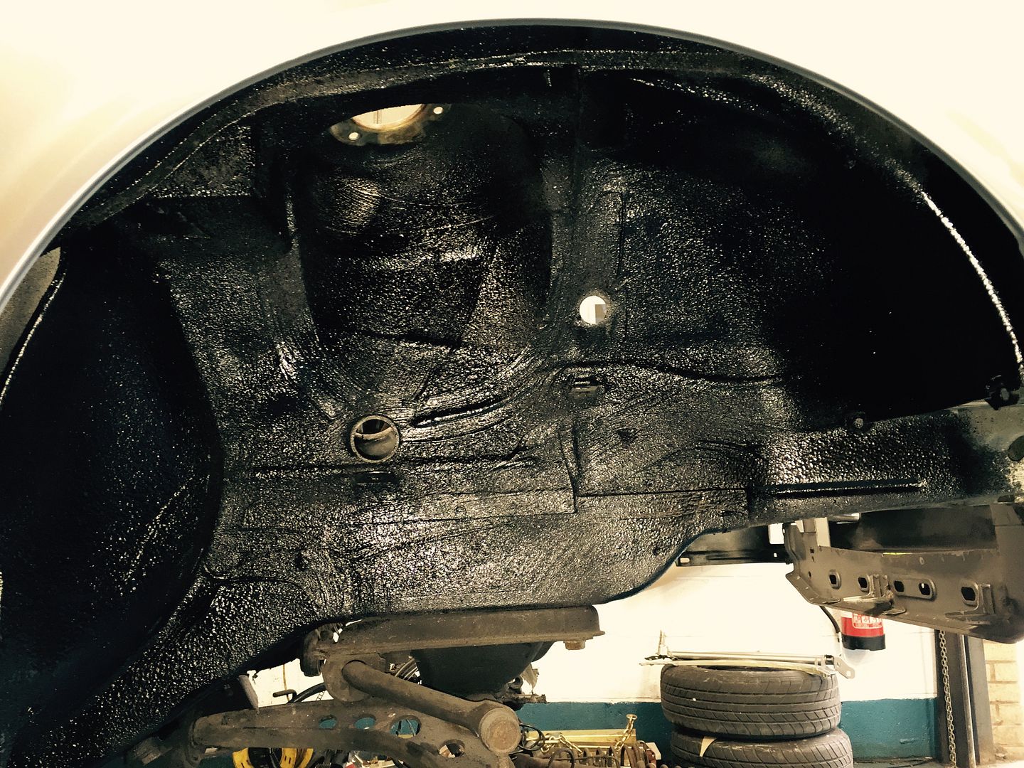

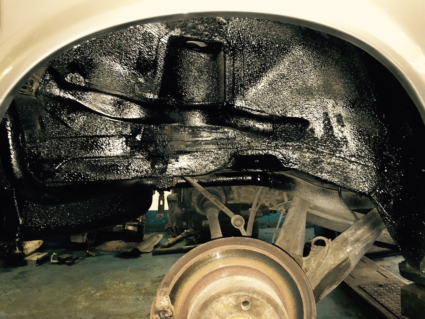

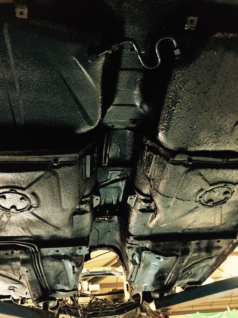

All arches and underbody cleaned and protected...
Engine going in tomorrow 8)

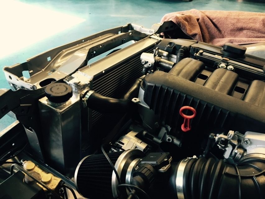

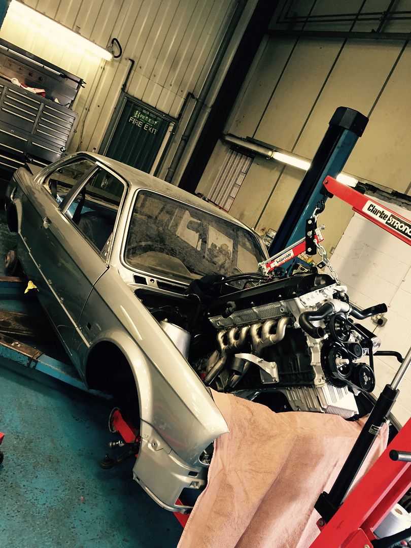

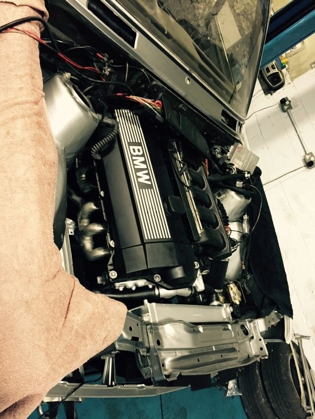

Dropped the engine in today...

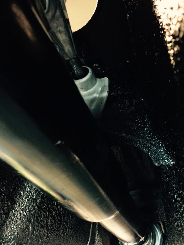

Fired it up briefly. Got a few issues to sort out tomorrow. Z3m shifter hits the prop :(
Alloy rad doesn't fit with the facelift mounts I purchased so will fabricate something. Also 318ti fan switch is too small to fit the boss on the rad.
Slowly making some progress though
P_VIDDY
Posts: 426
Joined: Fri Jan 06, 2006 11:00 pm
Location: Derby
Tue Mar 24, 2015 5:32 pm

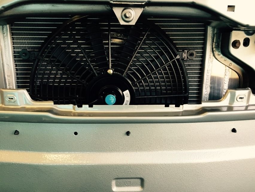

Had it running longer today and runs sweet. Can't drive it yet though as clutch master cylinder that came with the manual pedal boxed leaks :(
Modified the gearbox extender mount to allow z3m shifter to clear prop. Not touching not but hardly any clearance so will have to try it on the road.

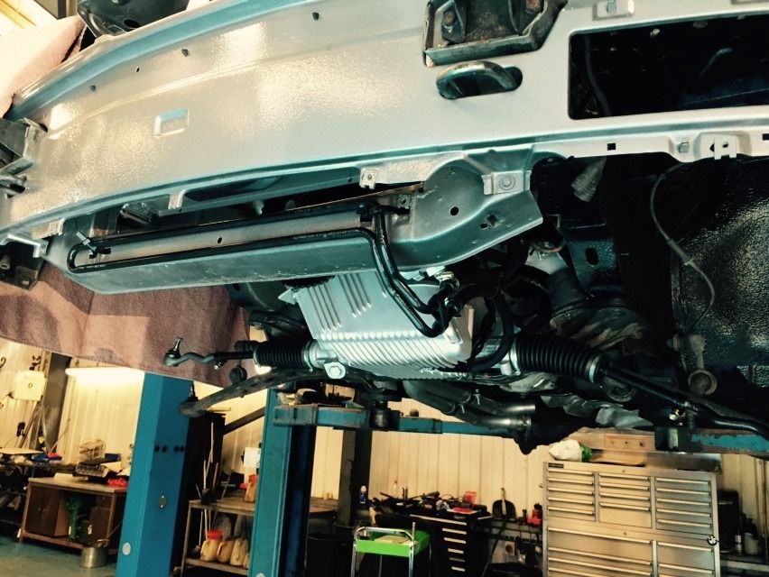

Made some power steering pipes and a cooler. Need to make some mounting brackets. Copper cable tied at the min
Alloy rad and cheap fan fitted (will change fan at later date)
Still got a few issues to resolve such as Rev counter isn't working! And clutch master cylinder leaks!

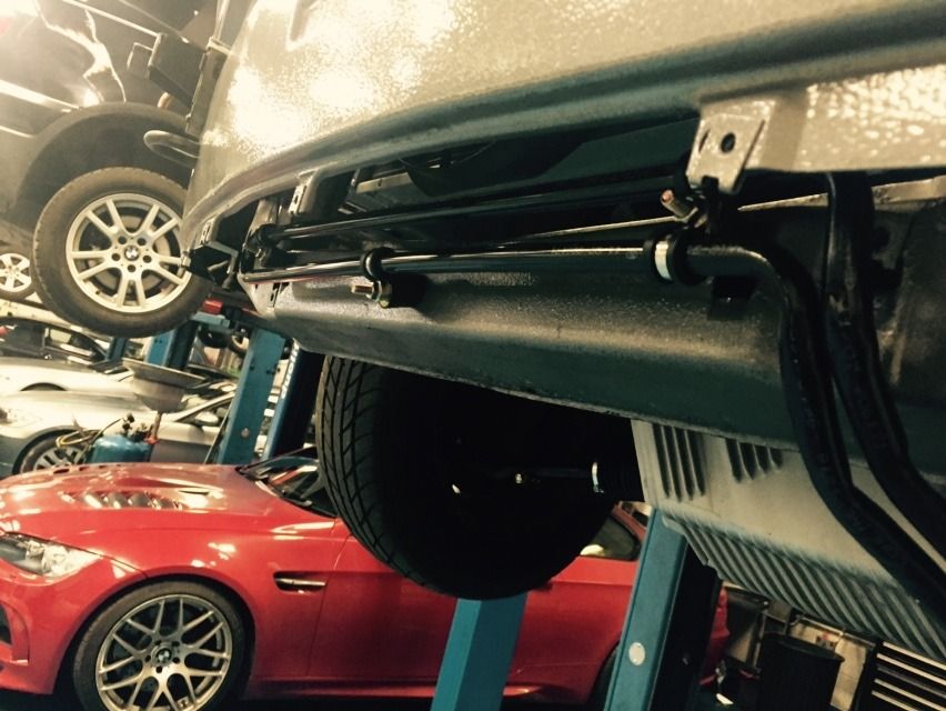

Mounted power steering cooler using some rubber bobbings and stainless p clamps
Sits nicely behind the vent in the spoiler

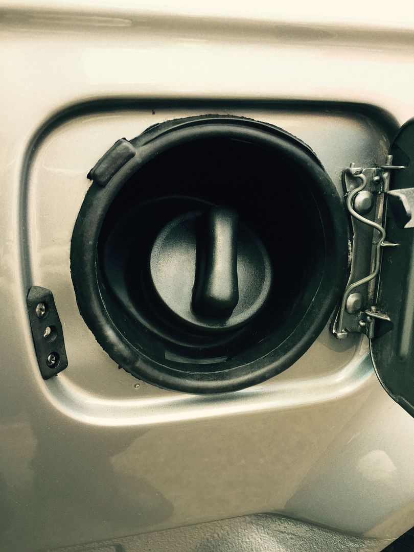

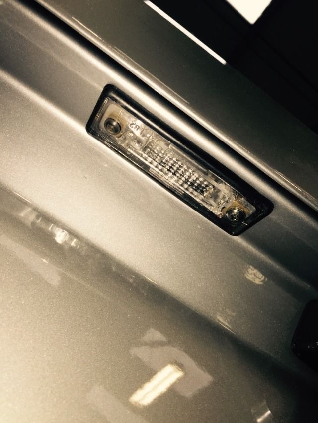

Replaced the worn petrol flap rubber boot

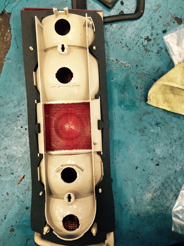

New rear lamp gaskets

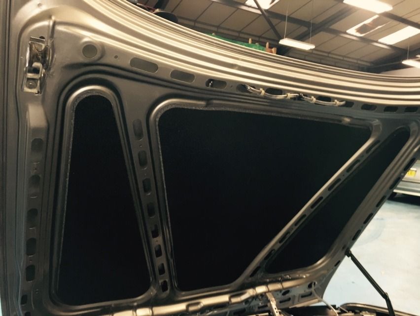

Replaced the corroded old number plate lamps for new

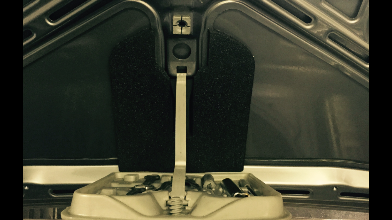

New toolkit foam
New bonnet foam

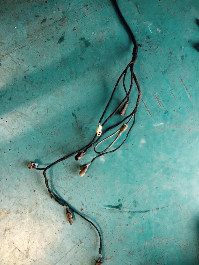

Tidied up the wiring looms in boot and engine bay using OE tape
