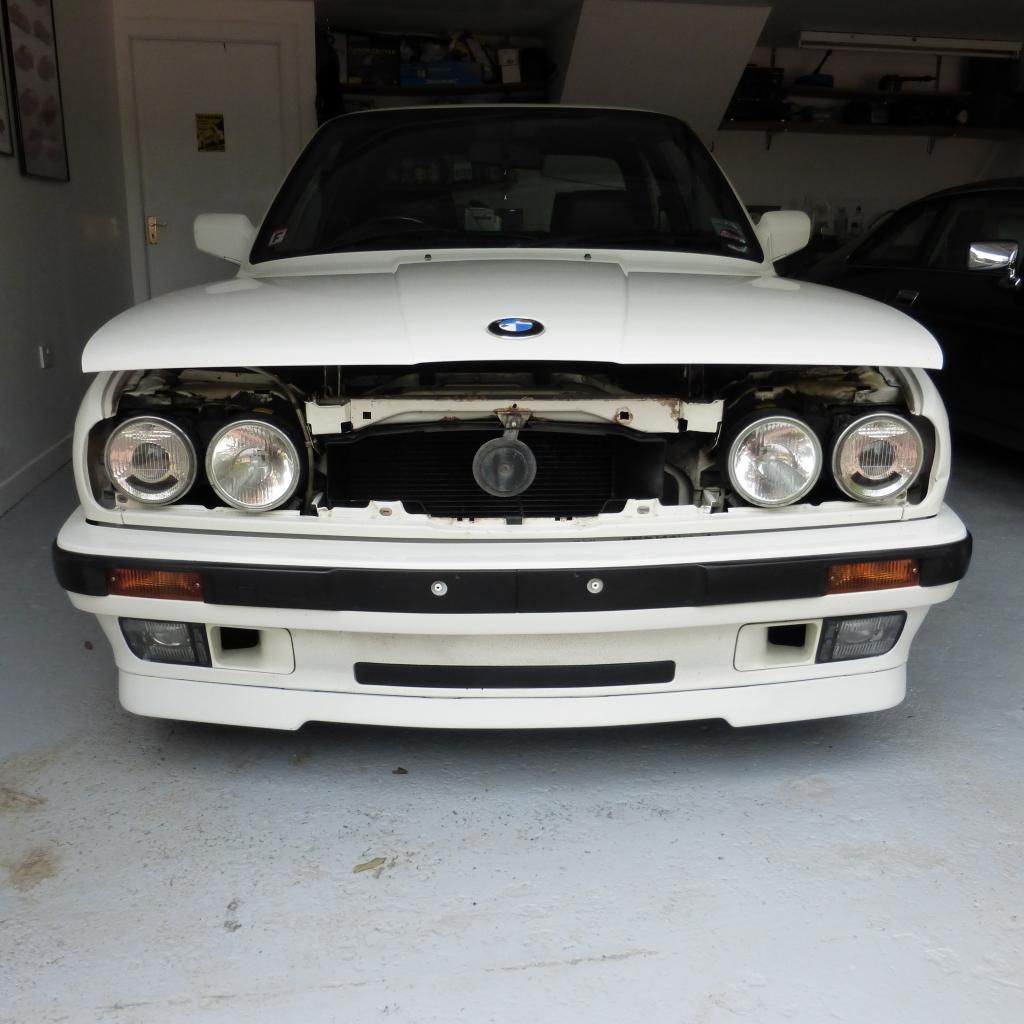

A couple of before's 1st - although, cos its white, pics don't really show how much it did need a "full Monty" - I took my time with this, bit by bit over two weeks.

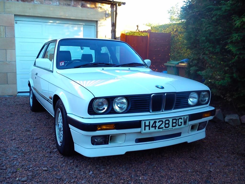

Heres the afters, sorry, gote none of the process.

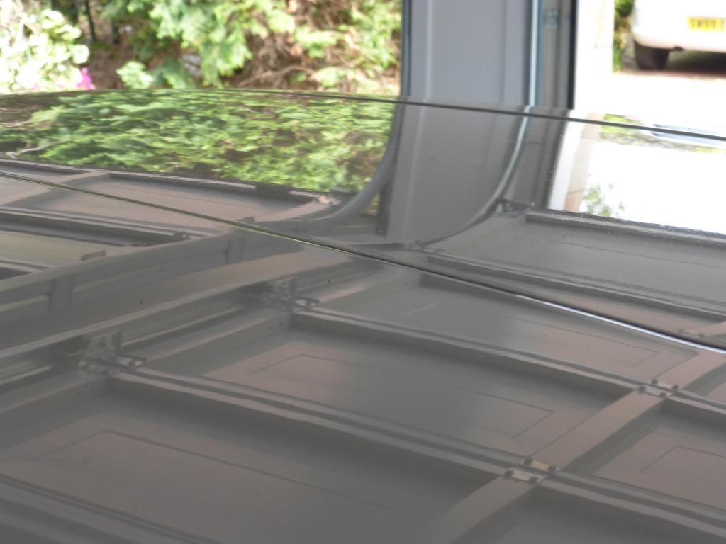

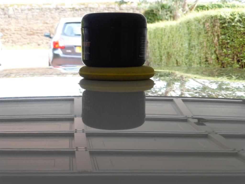

Some reflection shots,

Still have a couple things to do, front & rear valance's need re-painting, wheels need done again, with Sonax Xtreme, I will take them off 1 by 1 to do, then sills need a proper going over and finally the engine bay to do !

thats a nice combo, black leather and white car. white looks great with body coloured bumpers.its a little underwhelming with grey ones. sweet ride.

Cheffy great work!! Really nice job getting that reflection from a white car, I know how much hard work goes into it. Even brand new white cars are a challenge. I have never used deep crystal before, going to have a butchers at some now winkeye

Thanks - First time I've used it, had it for ages, but I wanted something else after the megs 105 & 205, and the deep crystal seemed to give it that next /further step I was looking for, followed by the Bouncers StF of course :D

Awesome. That's like new, man!
