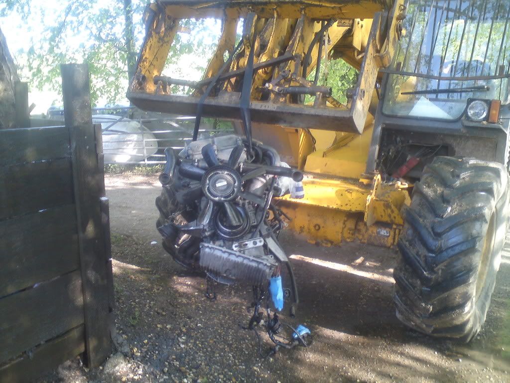

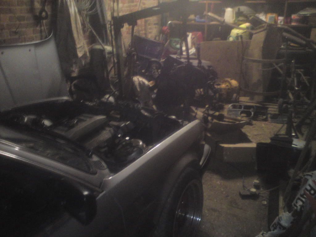

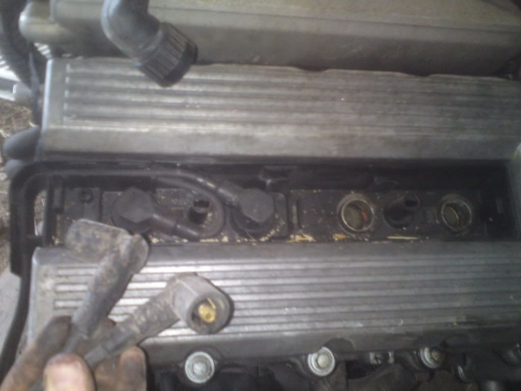

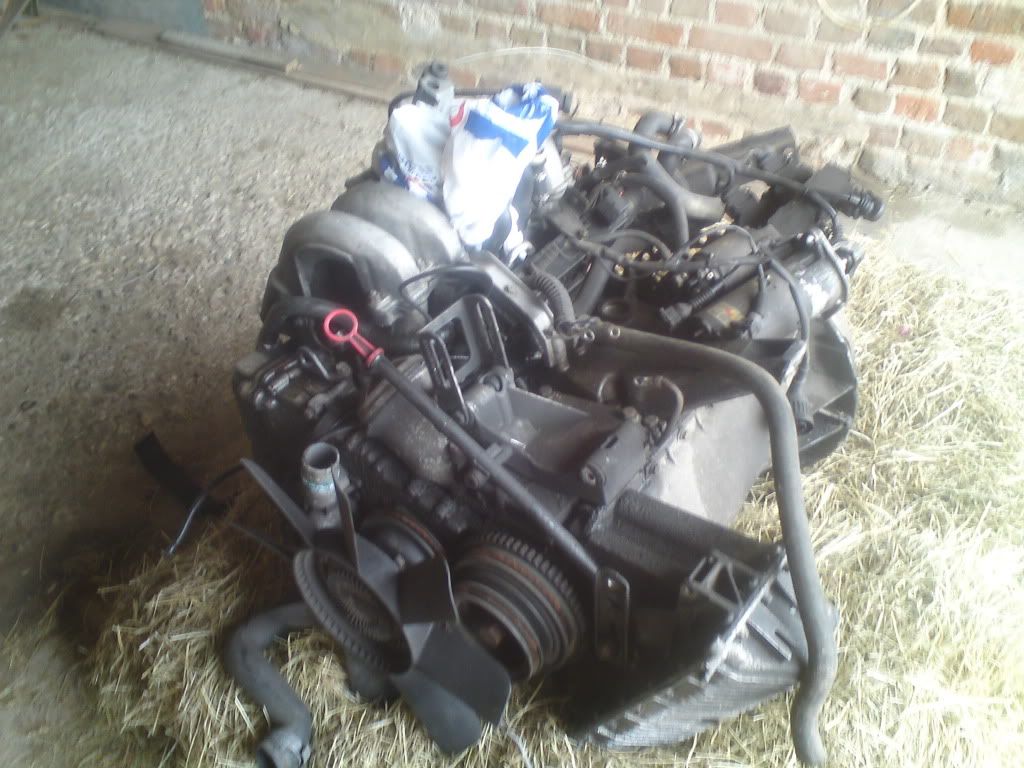

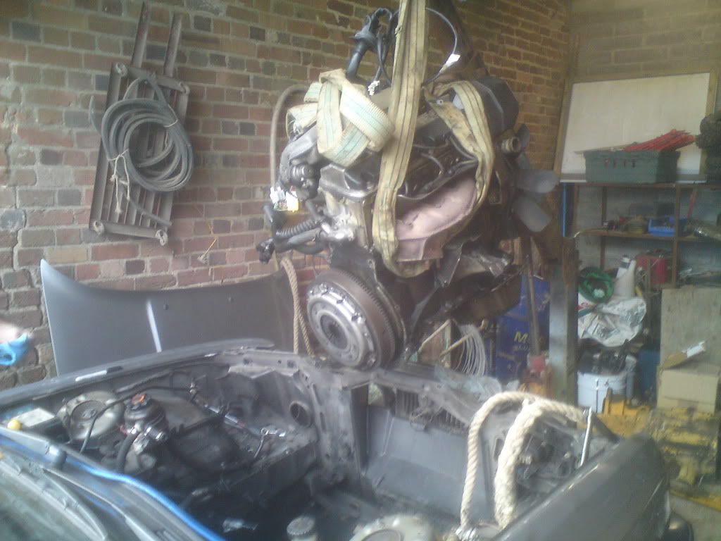

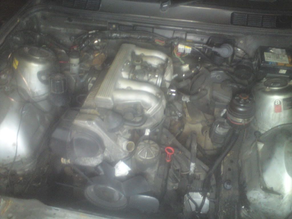

Finally got my ass in gear and put the m42 in. Took 4 evenings and a satarday morning to do which I didn't think was too bad! Not all of it is standard as well which hopefully makes it a better than a standard 318is.

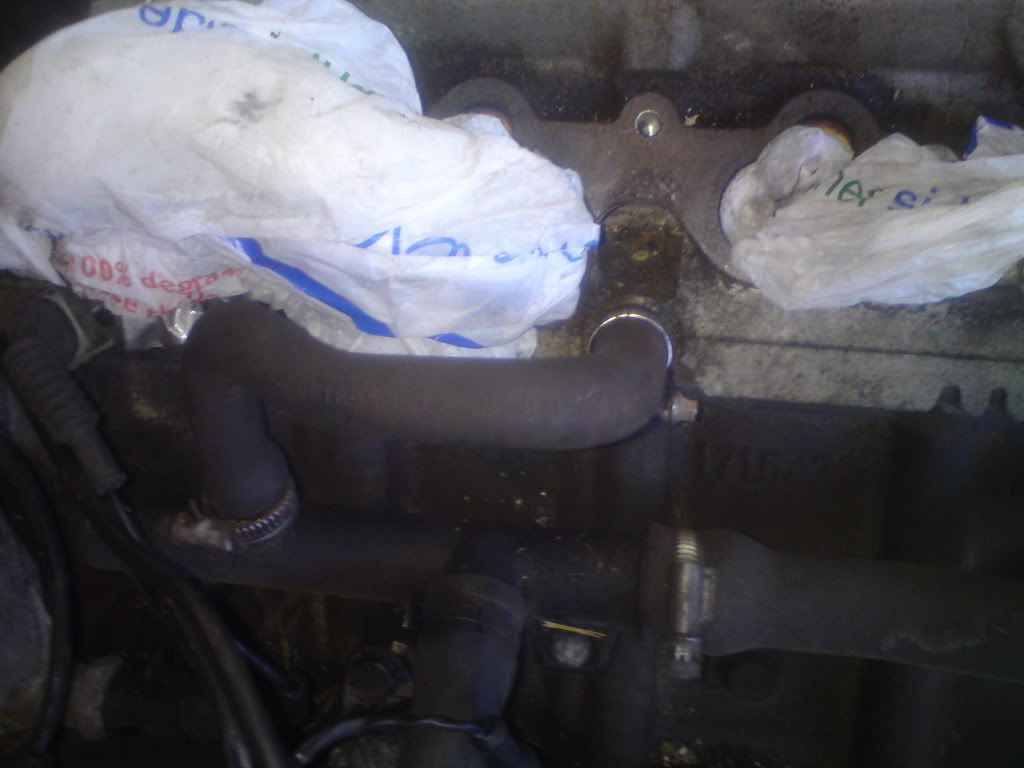

Whilst the engine was sitting about I did the throttle body heater delete and managed to use all oem 318i pipes as I had them sitting about. I got my engineer mate to lighten the fly wheel up a bit. Only about 5mm was taken off from the outside, but as the outside makes the most difference i think it has helped a lot. I'll post pics as soon as i get them off my old phone.
When I took out the old engine i realised that one of the rubber engine mounts had ripped apart! After searching on the net I was told to get m5 mounts as they are stiffer. Unfortunately they were over £30 each compared to the £10 that standard ones cost. I got them anyway as i figured it could help in the future with a e36 rack swap? Was a bit of a challenge lining them up but all was well in the end. They are rock solid! Im sure its helping the throttle response. The car shakes on idle which I dont mind at all, looks cool if anything haha. Also the mounts have raised the engine by about 15mm which is very helpful considering the amount of sumps i've been through!

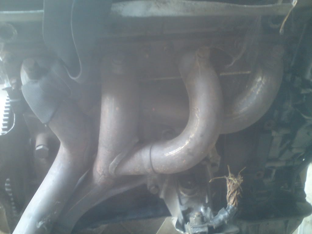

Next is the exhaust. Got hold of a whole exhaust from manifold back off of a fellow member. The front section is standard iS with 2 small powerflow stainless boxes out back. I wasn't a fan of the tips, plus they wouldn't fit the cutout in my bumper so they were hacked off. The exhaust is pretty dam loud considering it has 3 boxes! I'm hoping its mainly from not having a tip and the exhaust noise echoing round the underneth of the car. It also looks a bit dumb without a tip so one is on the way!

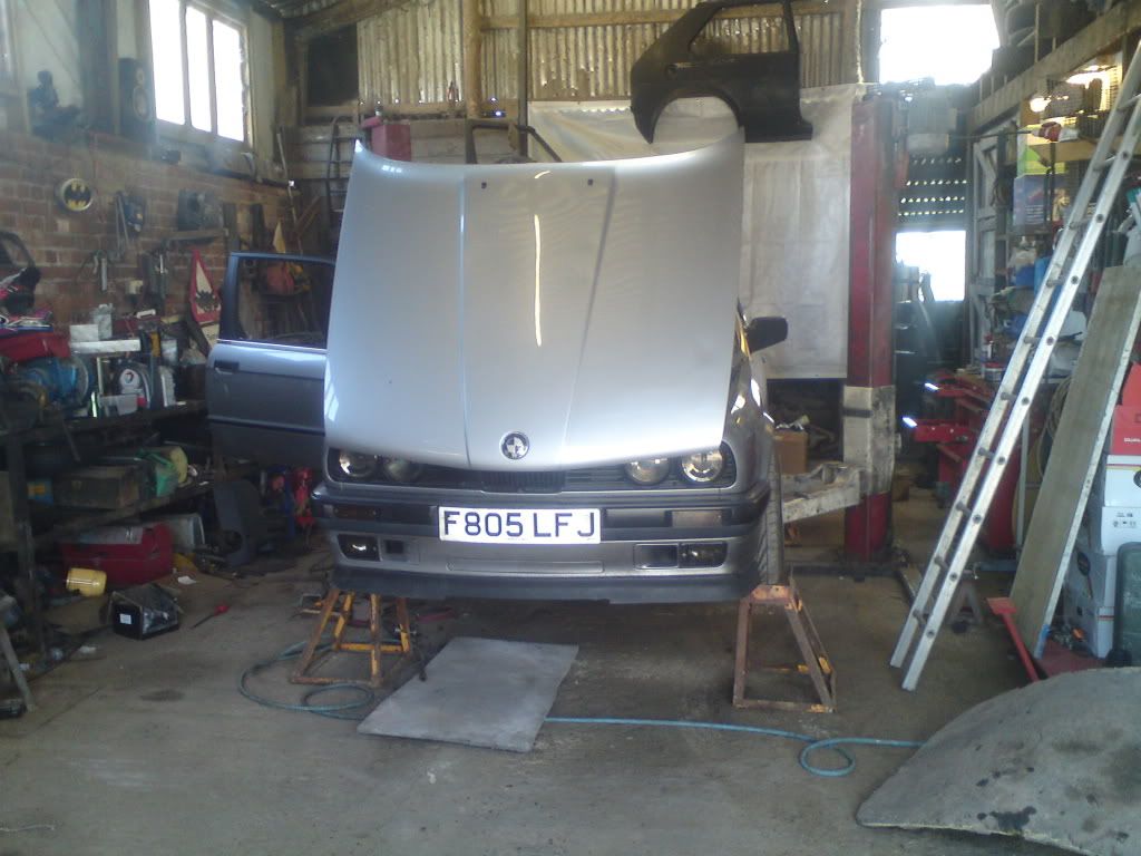

Engine swap in progress

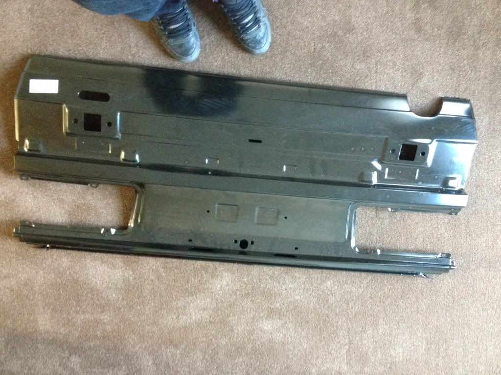

joeseth wrote:Nah haven't got it sorted yet, really need to. My prioritys are a bit random I know!
you can buy a pattern rear panel for about £40

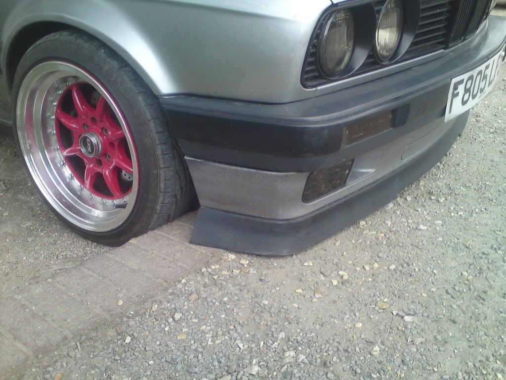

So have fun with that splitter lol
Haha yeah does scrape a bit, luckily it's held on pretty well and is relatively bendySweety wrote:So have fun with that splitter lol

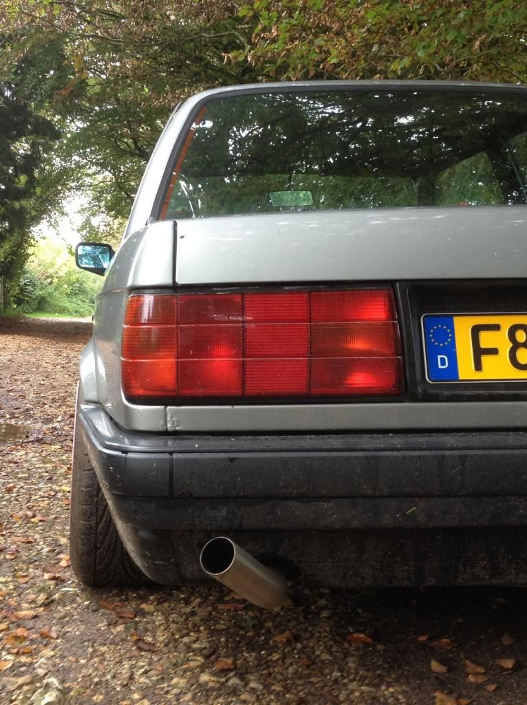

Few updates.

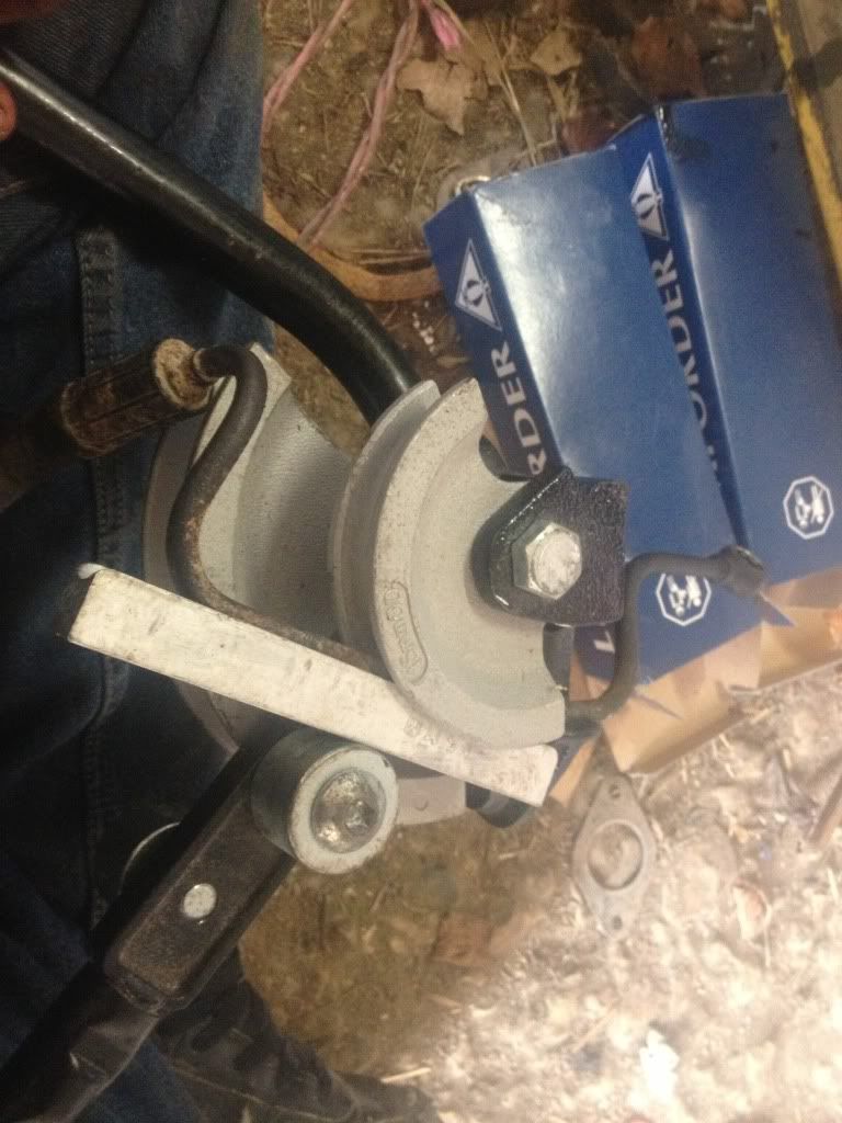

After a month of driving round with no exhaust tip it was starting to annoy me. Its was pretty loud at low rpm which just sounds stupid round town. Did sound kinda cool on idle though as was very burbley cos im pretty sure it has an air leak in ther intake. It was also looking a bit dumb without a tailpipe. I wanted something a bit different and I quite like the sticking out sideways look of mk1 golf gti's. Managed to find a piece of stainless with a decent bend in it and the same 2.25 inch bore that the rest of the exhaust has on ebay.
After a couple of cuts and trial fits I got a mate to weld it on for me. Didn't have enough time to take the exhaust off so at the moment it hasn't got any weld round the top. I wasn't sure if it would quieten it that much but the difference is amazing. Even with it slightly blowing round the top.
Here's the finished item. Makes the back end look a bit more interesting as I had been thinking it needed something.

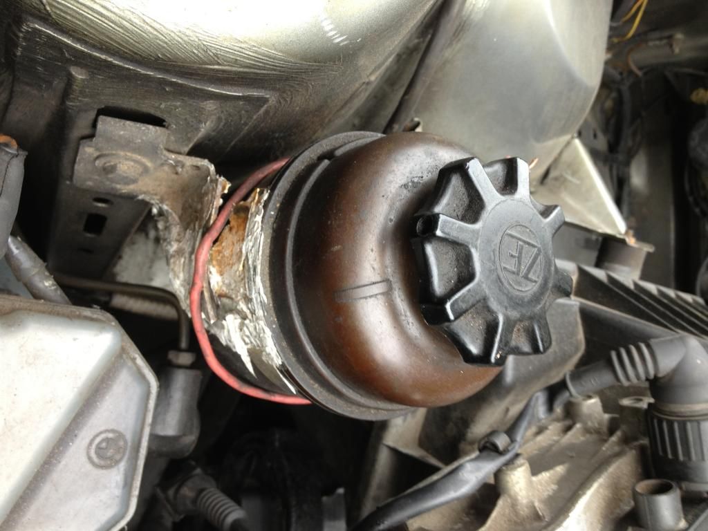

Since I bought the car the pas fluid bottle has been held on by a bit of wire. So replaced that with one from the scrapy.

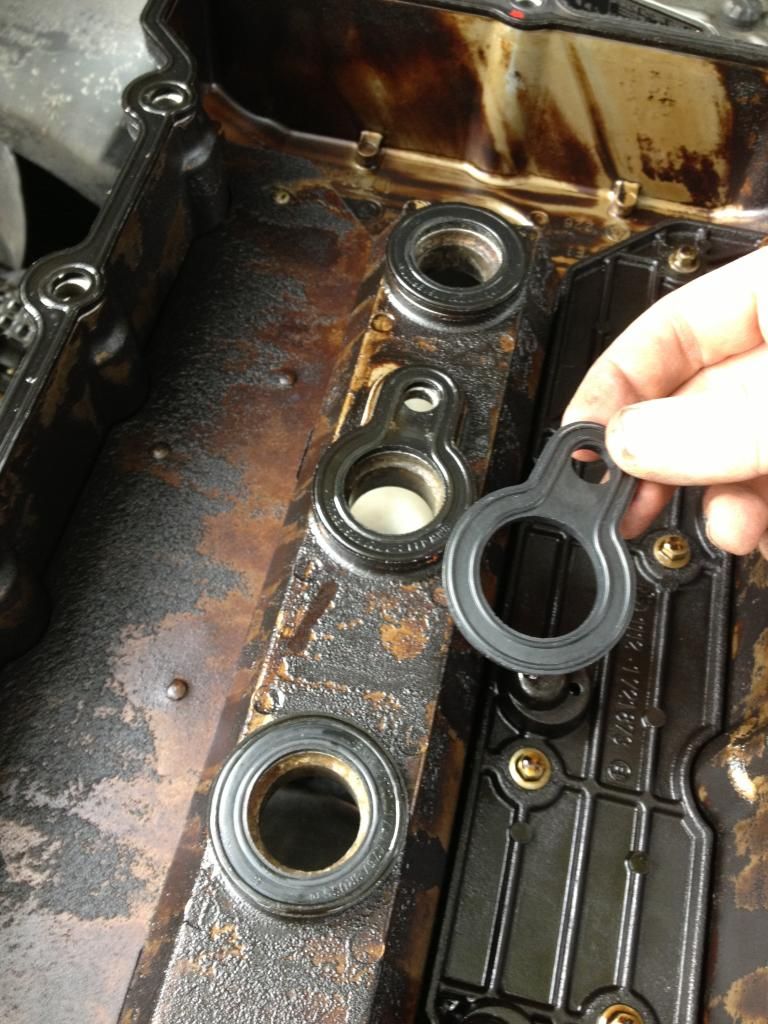

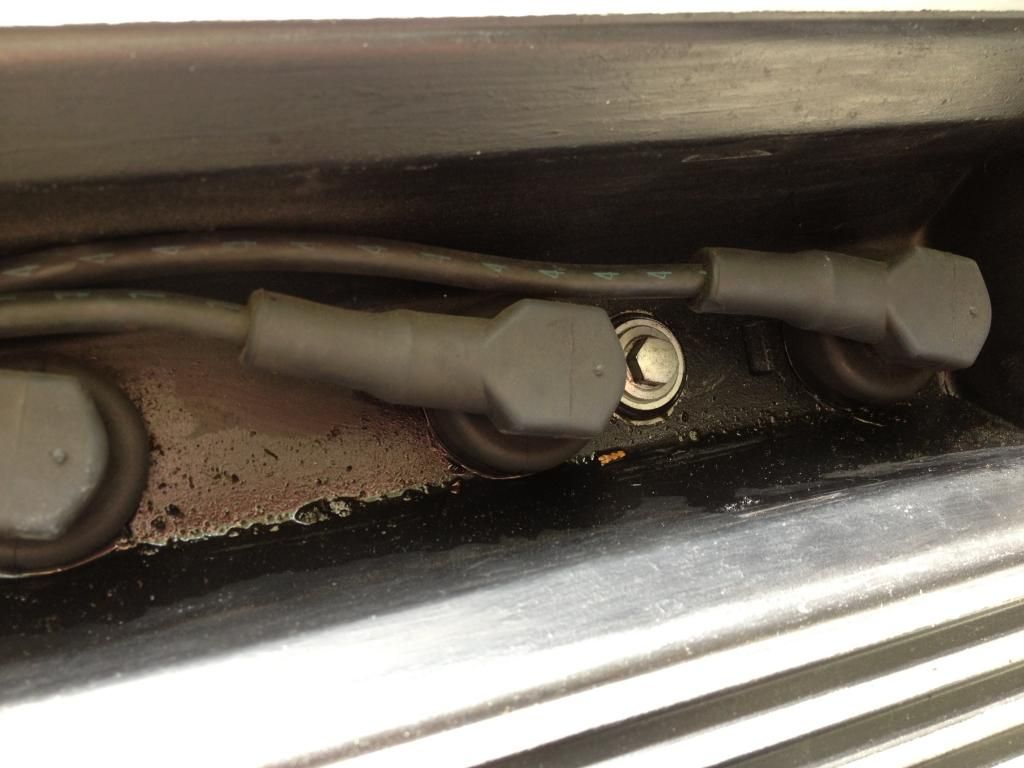

Had an oil leak from one of the bolts holding the rocker cover down.
Luckily eurocarparts sell the new gasket I needed for £3 something! Also changed the oil filler cap for one I had laying round as this was also leaking slightly.

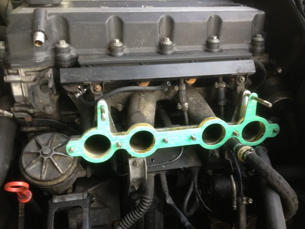

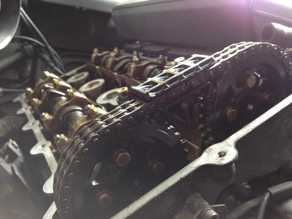

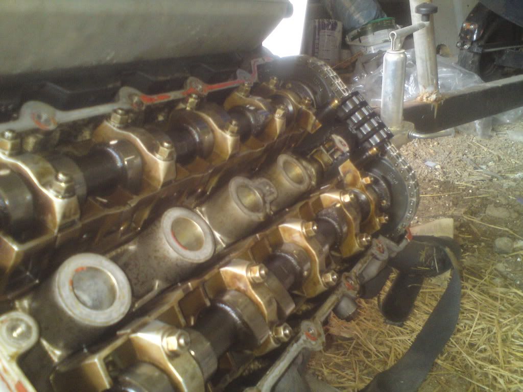

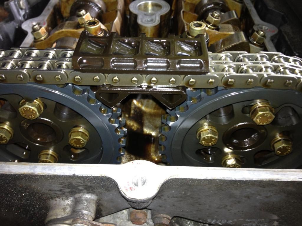

Can any m42 geeks tell if mine has been fiddled with from this pic? It looks like the cams have been adjusted but im no expert.
As you can see the intake manifold literally touches the bonnet! Good for a low car!

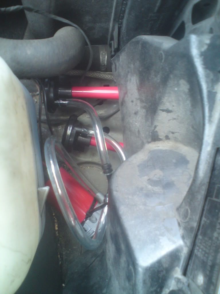

Fitted some air horns from halfords just for fun. Good for making people jump haha

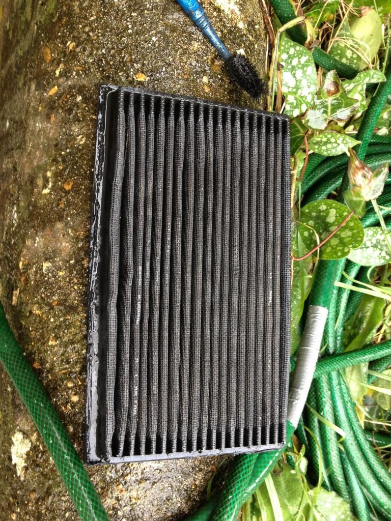

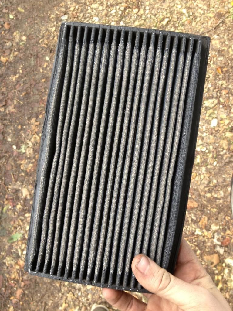

Even after water and a bit of a scrub the k&n filter was still pretty black.
Used some of my brothers motocross air filter cleaner on it and an air line to dry it. Came out much cleaner. So much crap came out!

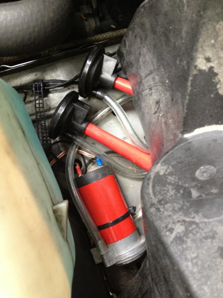

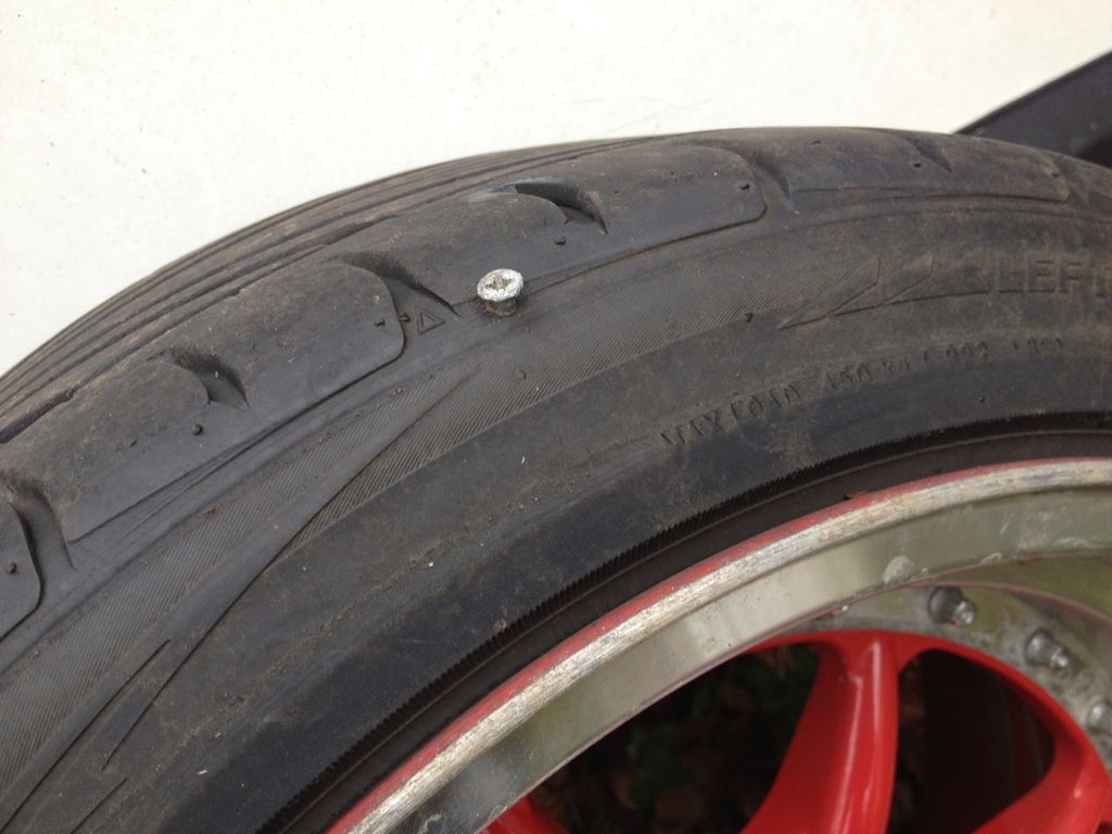

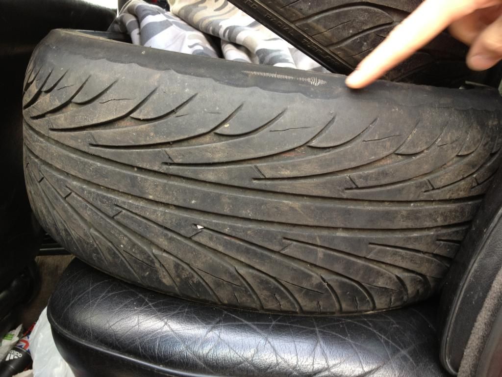

Isn't it annoying when you soon need to change you front tyres and then you get a screw in one of the rears! The tyre still has plenty of tread left
. Luckily a couple of months ago I took the tyres off my girlfriends dead ibiza gti. They are exactly the same size and are toyo proxies, same as mine which was ideal!

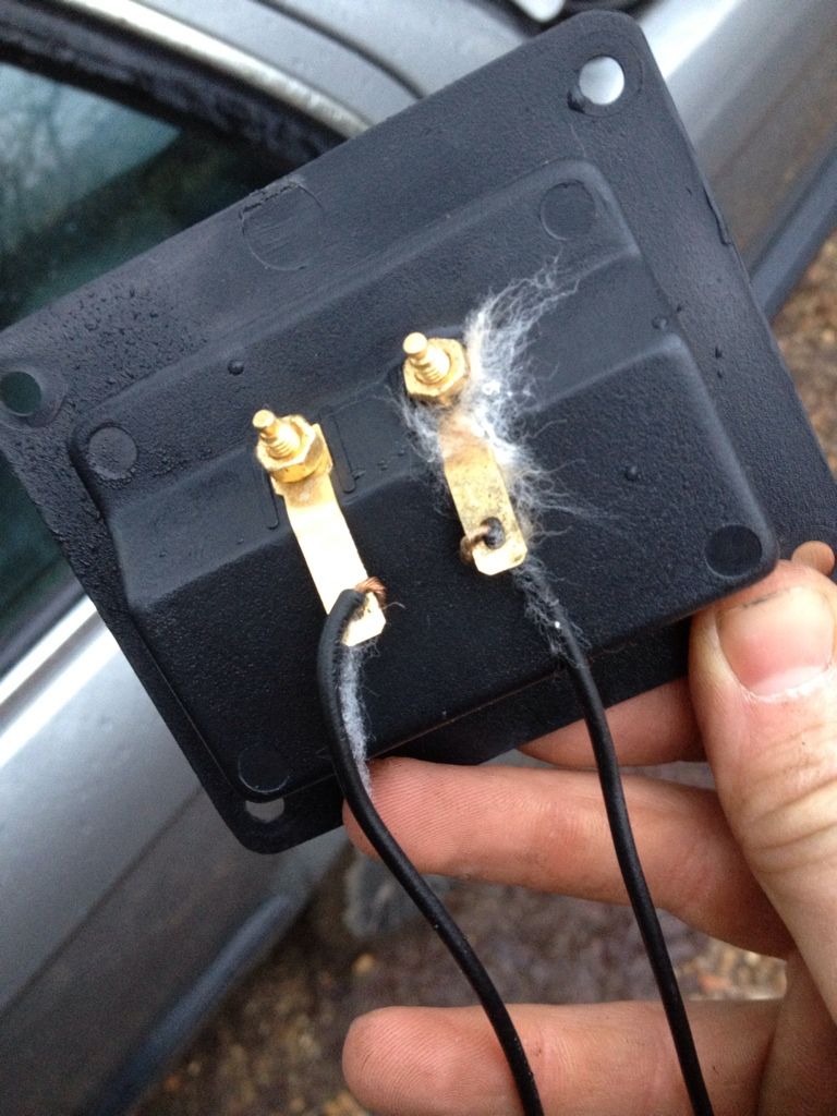

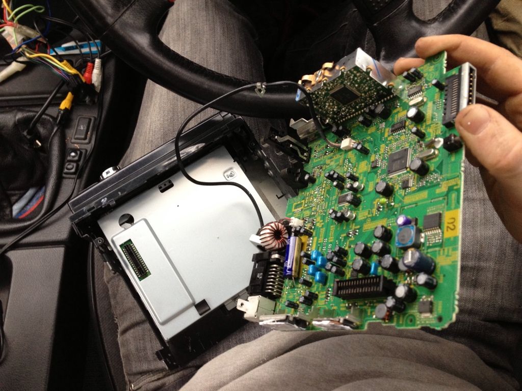

Back on point, my sub stopped working. All the wires at the sub end seemed ok so I went to the radio end. After making the whole radio not turn on anymore and after an hour of fiddling, I started to take it apart
After this i was sure it would never work again so was pretty pissed off. Put it back together an plugged it all in just incase it miraculously would work. Thats when i realised I hadn't been pressing the on button!!!! Turns out was just a wire loose inside the sub box all along...
How these two wires haven't come off before in the past 3 years is a mystery. With everything back together and any dodgy connections sorted, the speakers and radio in general seem much better. So all was not lost, and I now know how to take a radio apart haha.

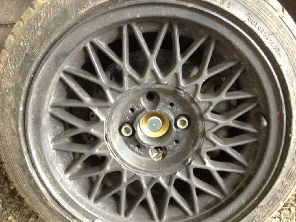

Since I put steelies on the back I've had a really bad droning/vibrating at 70mph. I gets so loud I avoid 70 alot. I gets better above 70. Tried putting some old alloys on the back (pic above) and it did make it alot better. But when I swapped the steels round with other steels it still made the noise? Could they just be badly balanced or really noisy tread? Or could a rear wheel bearing be on the way out (has been making a slight noise since I bought the car) and the steels excentuate it?

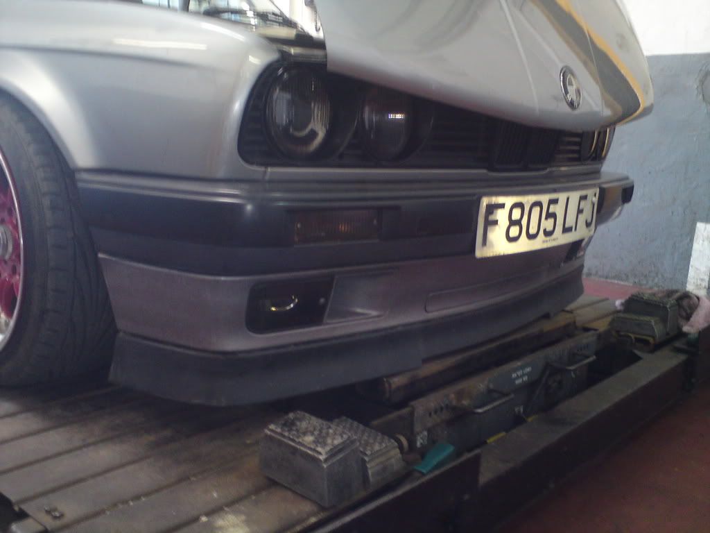

Getting used to new splitter

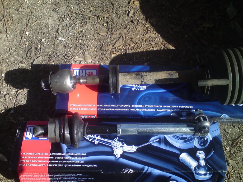

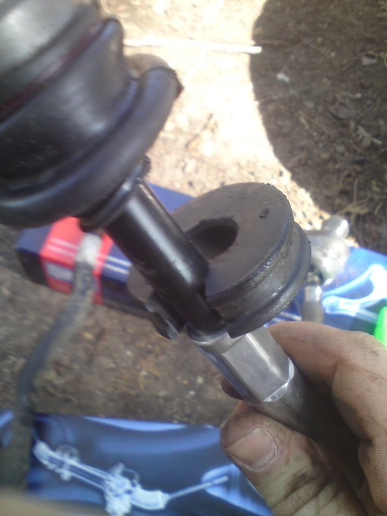

New inner track rods for mot. Quite different from the old ones but seemed to fit.
The new rods had nothing to fix the steering rack boot to so I cut the old rubber off and used that.

Fitted some air horns for a laugh. Were good for bout 6 months but then died, dam halfrauds.
Air horn switch.

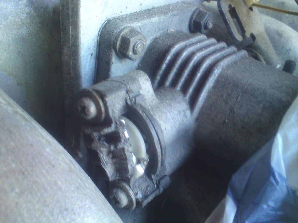

Broken throttle position switch

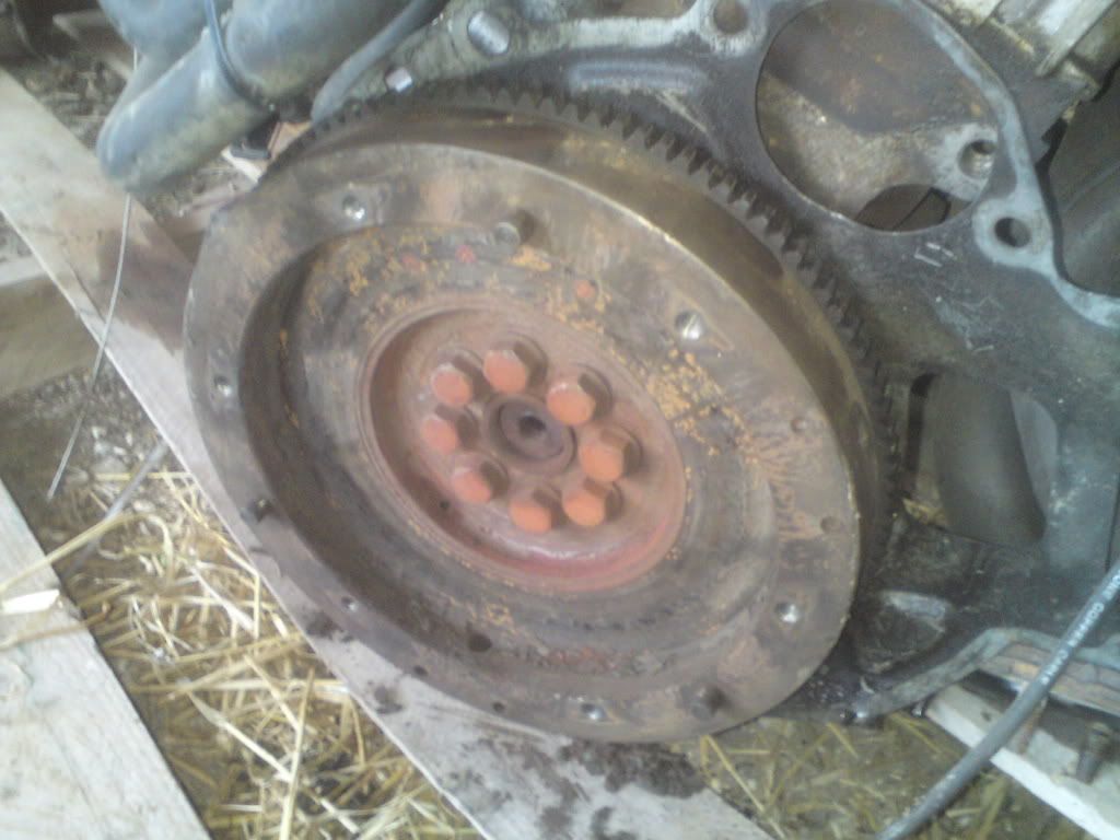

Fly wheel before lightening.
And after. Nothing drastic but hopefully makes a bit of difference as is all from the outside edge.

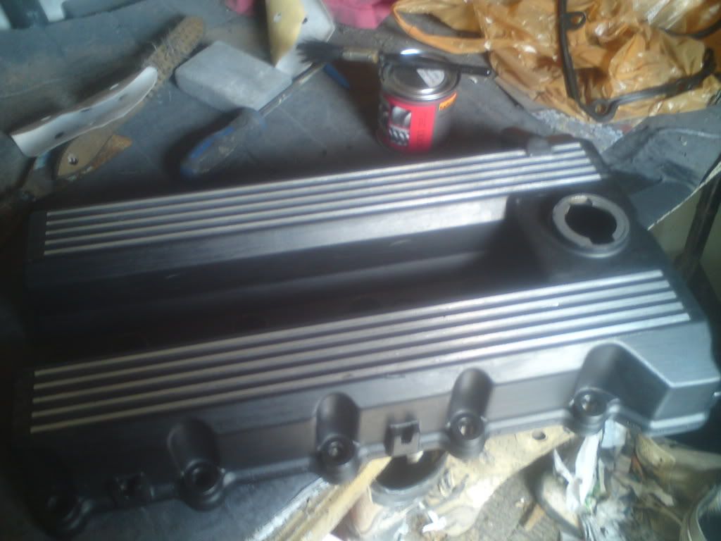

Rocker cover before.
And after. Used some high temp satin black paint and sanded the lines back.

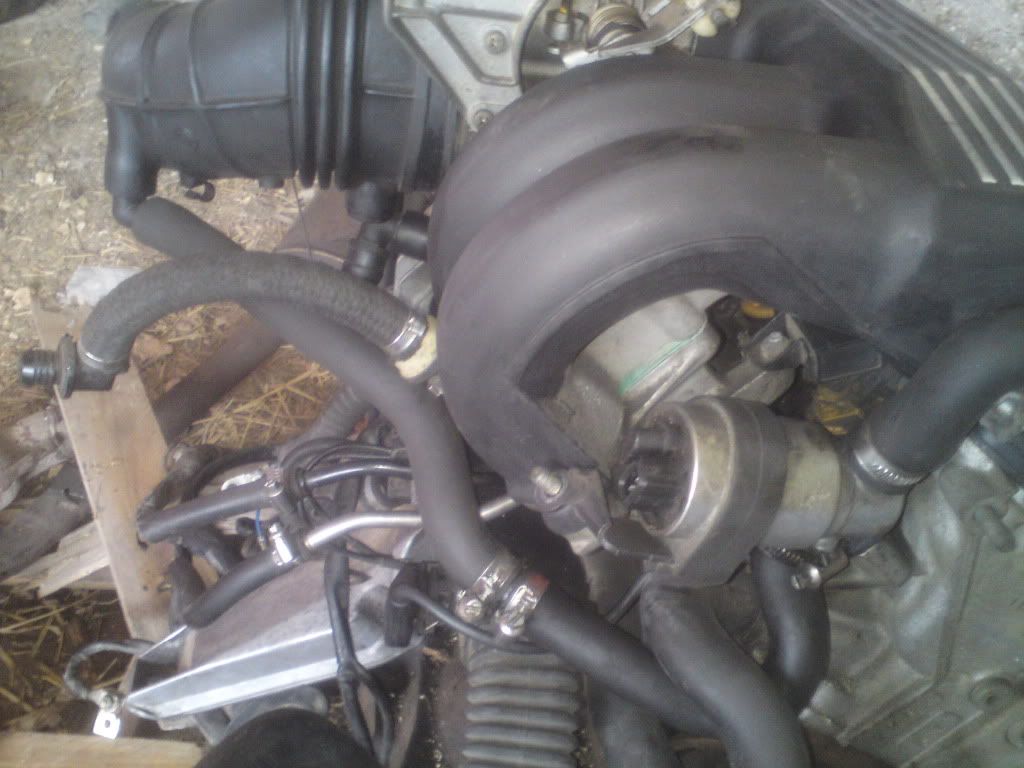

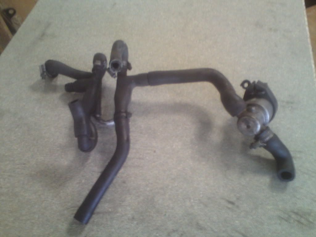

Read about the throttle body heater delete and thought it sounded like a good idea.
And getting rid of most of this tidys the bay up a bit.
I reckon this is the perfect time to do the TB heater delete as I used only pipes from the old m40 engine which was lucky.
This pipe was perfect.

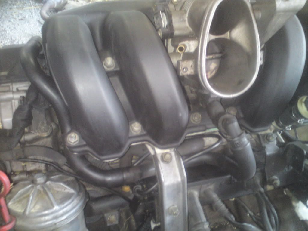

Painted the intake manifold whilst it was all apart. This shows the routing and pipes used for the rocker cover breather to the TB.
And the intake to icv pipes.

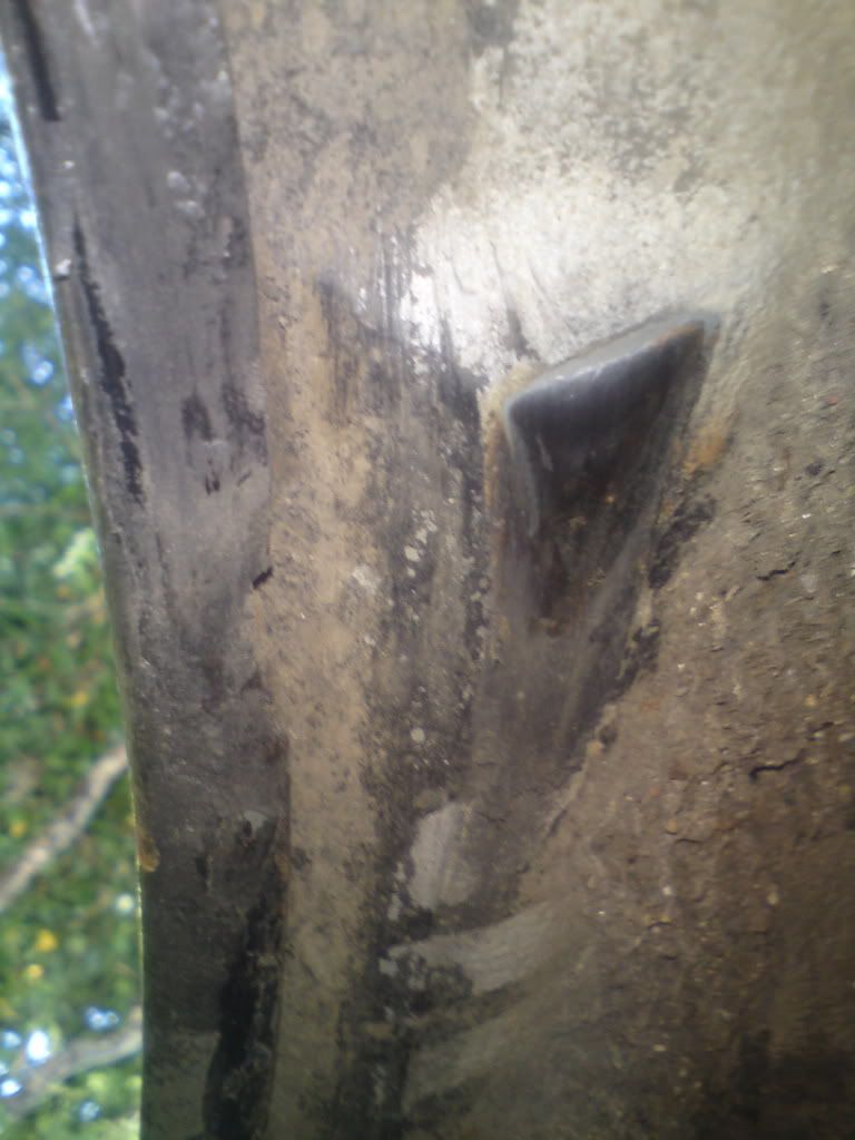

Was rubbing a bit on this random lump but it soon hammered in

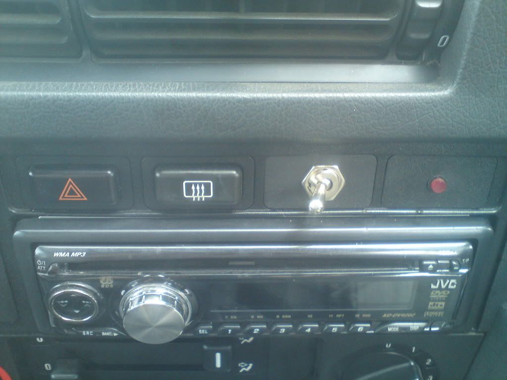

Air horn switch.

M42 engine arrived

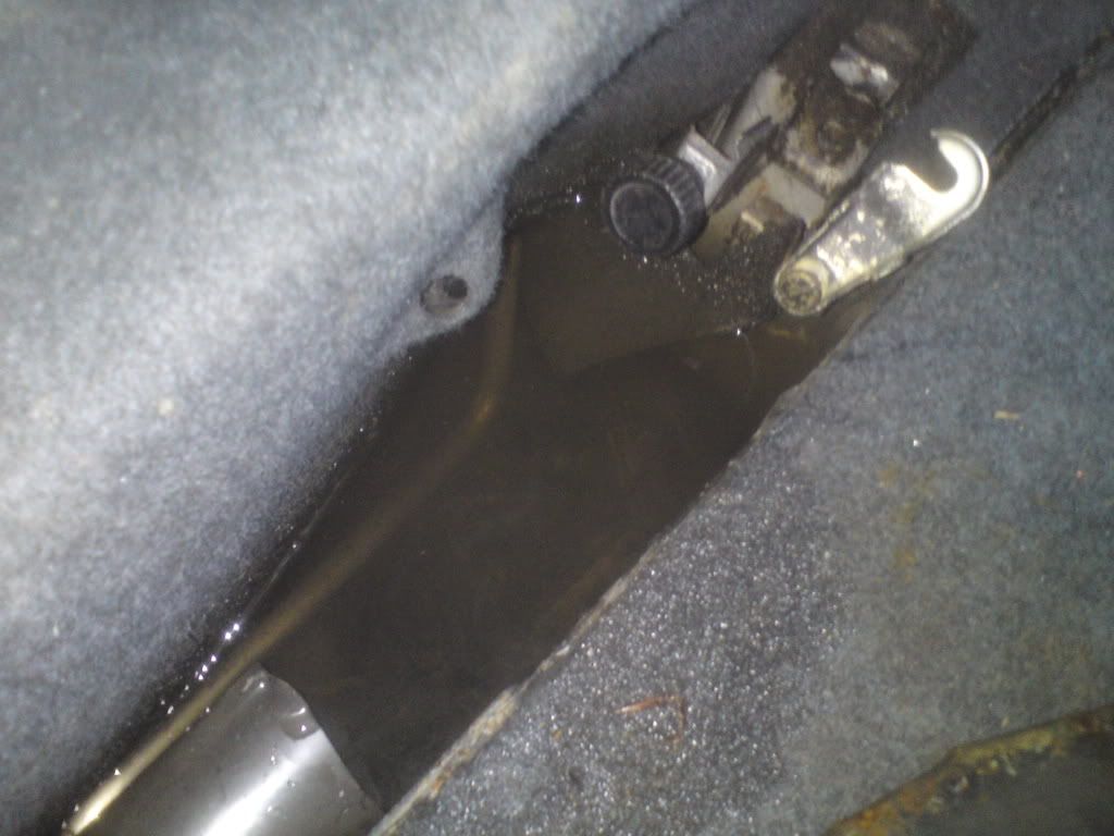

Suspicious swimming pool in boot.

Goodbye m40

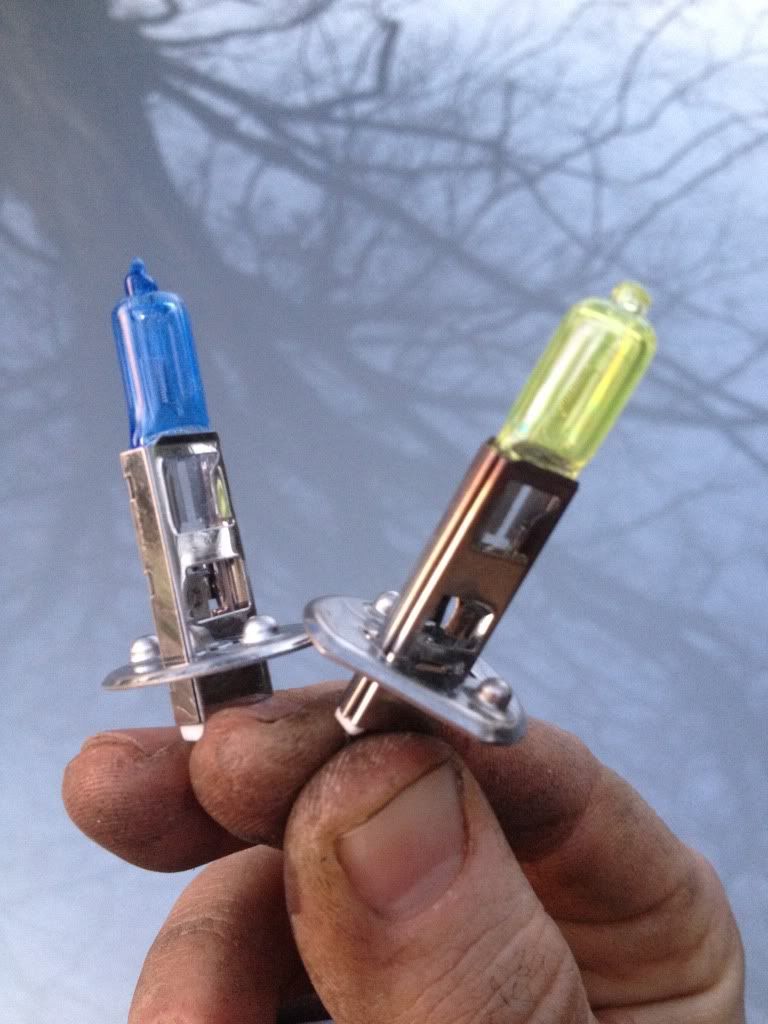

Changed from blue/white to yellow bulbs for awhile, but they were rubbish with the tinted lights and I couldn't see anything!

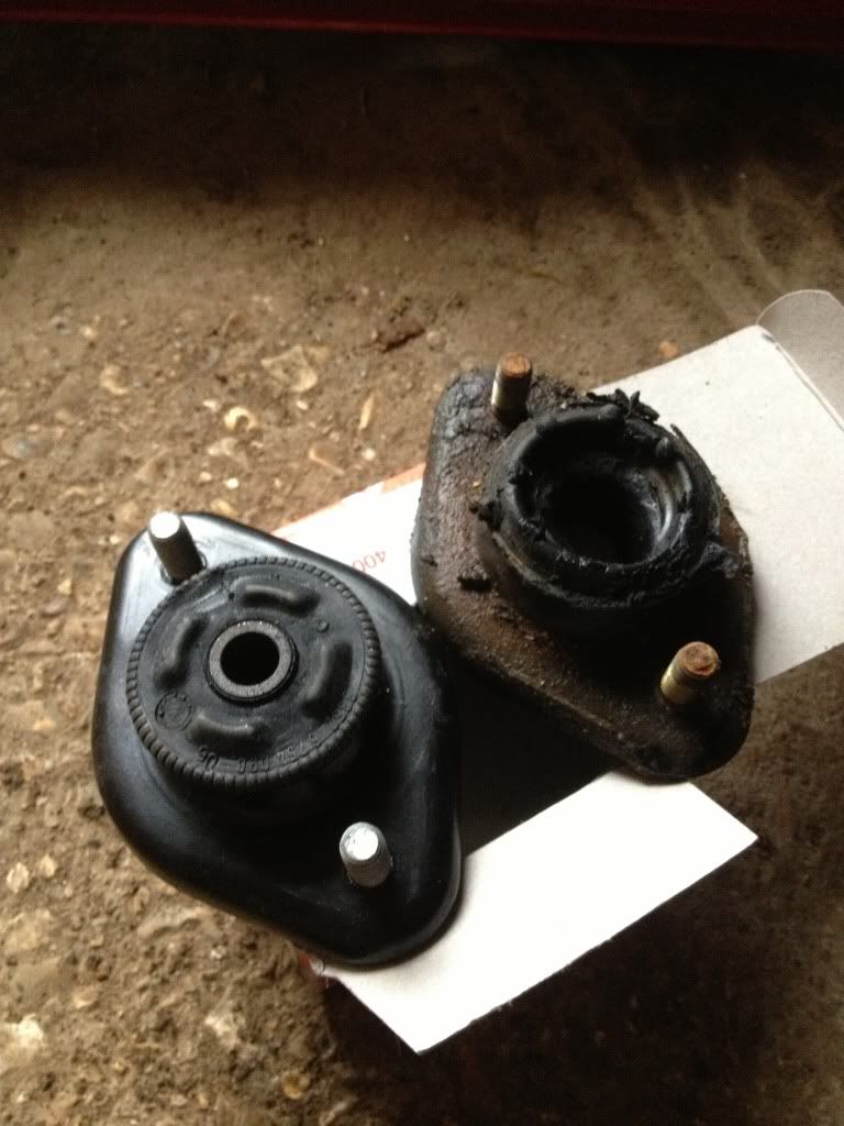

Changed my completely knackered rear shock mount for an e46 cab item.

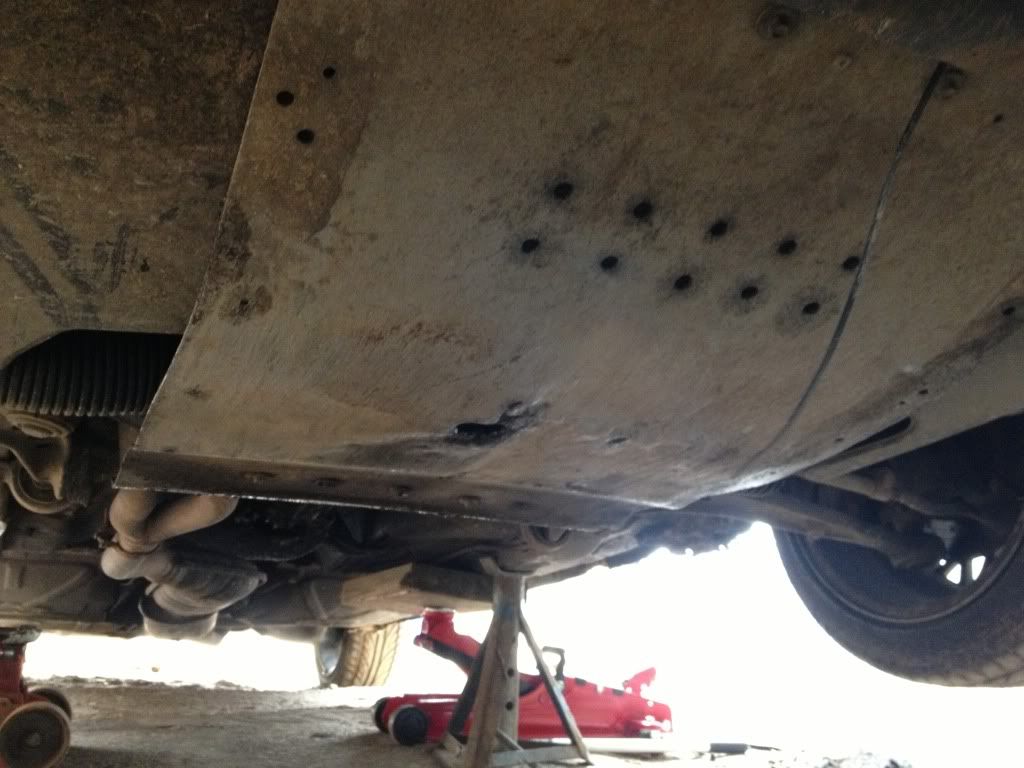

Sump guard still doing its job.

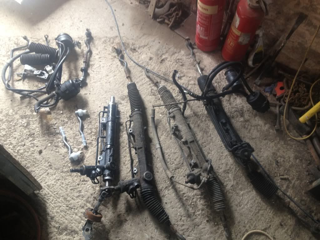

Armed with loads of spares I finally felt up to tackling my z3 steering rack. Rack on the left is the z3 one, then 2 e36 racks, and on the right is the old e30 one. Took me a whole day to fit it but I manage to get it all up and running without any problems at all. So much nicer to drive with the 2.7 turns lock to lock!! Great mod!
Used a plumbers pipe bender to bend some of the e36 pipes to get the steering rack going. Worked well and didn't link it once. Was very tight and fiddly though!

Had fun whilst trying to sort the emissions. Changed the inlet manifold gaskets and checked every single vacuum hose!

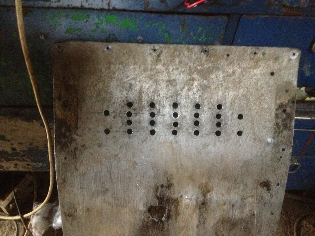

Drilled few more holes in the sump guard when I changed the oil and filter. Could do with a bigger drill bit/core cutter.

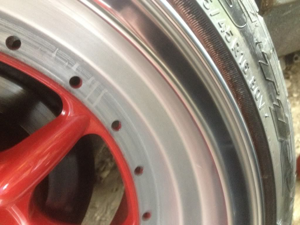

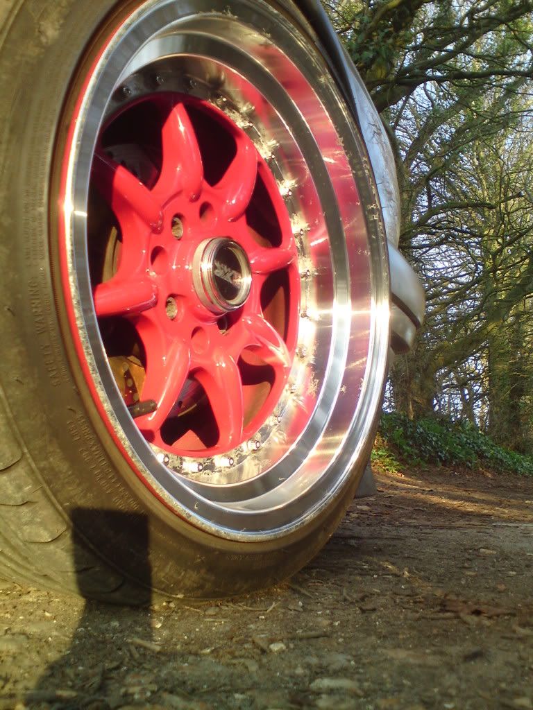

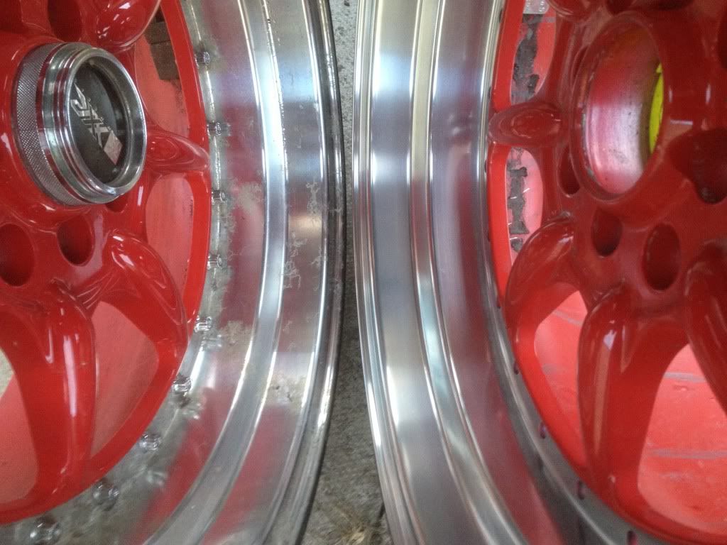

The laquer had suffered at the start of winter. This was the worst wheel. The bolts came out quite easily which was good.
Started taking the laquer off and polishing.

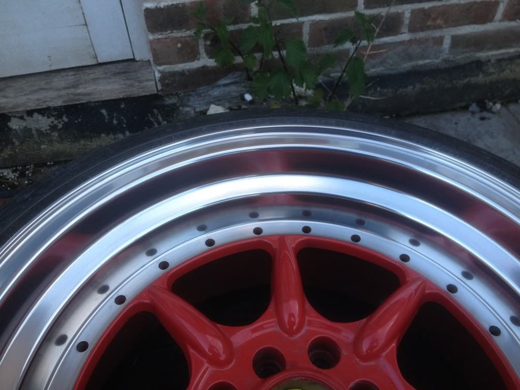

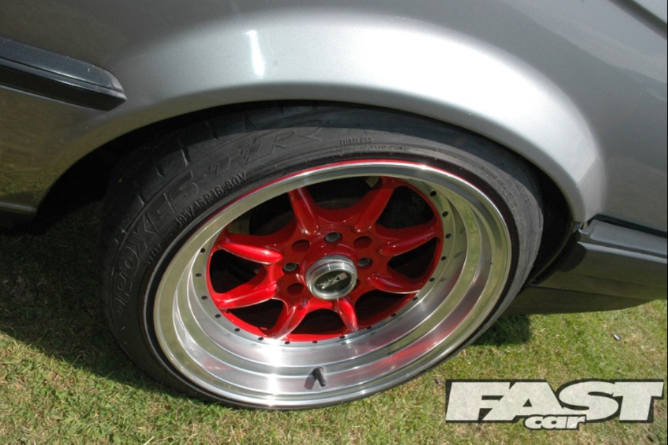

After absolutely ages polishing they came up super nice! Well pleased! Did the left hand 2 wheels before I went to run to the sun. Luckily the other side isn't as bad.
Got a few pics with the wheels back on and after a good wash and polish.

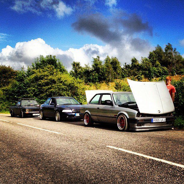

On the way to run to the sun. Not much sun mind!

All my polishing paid off, got a pic on the fastcar website! Left the bolts out so the are easier to clean now that they are polished. Think I prefer it without them anyway.
