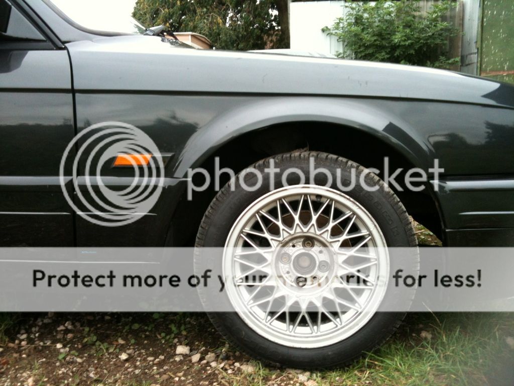

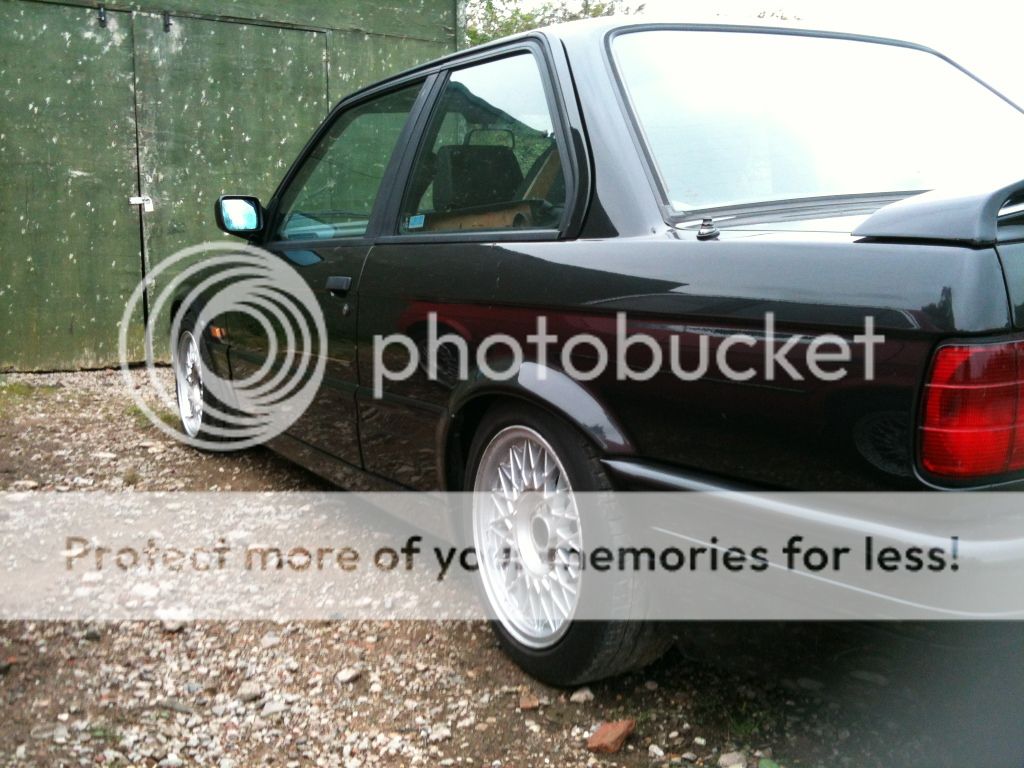

This will still look good for years if you do nothing apart from sorting the susp. and engine!! Sod fragging it, do that when it gets preoperly bad. Drive it and enjoy it :)
Kedge
Posts: 7702
Sun Sep 23, 2012 9:29 am
To be fair it does look fine when you step back a few paces. There's plenty of MOT left on it so may as well use it. 8)

Kedge is correct with the bubble on the scuttle, the picture doesn't show it up very well, but I think it's because there was condensation on the car as it was morning. When it's a good day, I'll give it a wash and polish and get some detailed pictures. The scuttle, I'll get the vents out and have a look from the other side, I'm extremely tempted to put my finger throughn it but then it will look worse :mad:

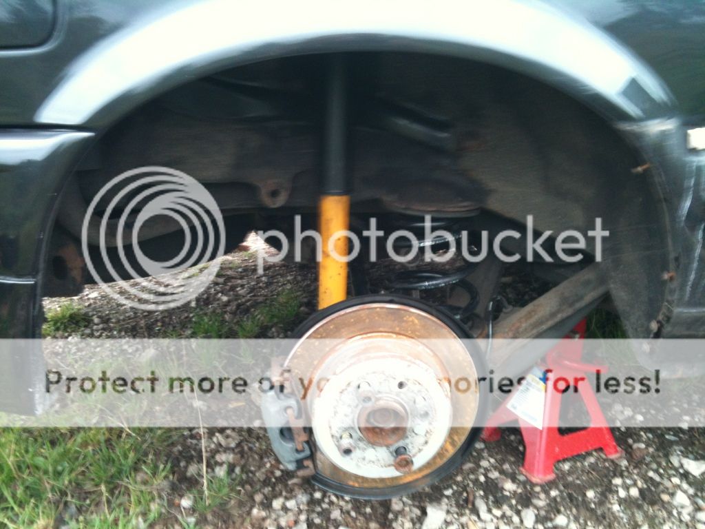

This is how it sat on the Rear Driver side before I started
Jack wouldnt fit under for a start :?
Its had new disc and pads all round with new flexihoses and rear backing plates on the rear too which is nice :D

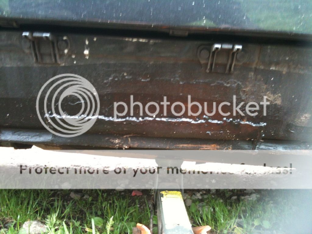

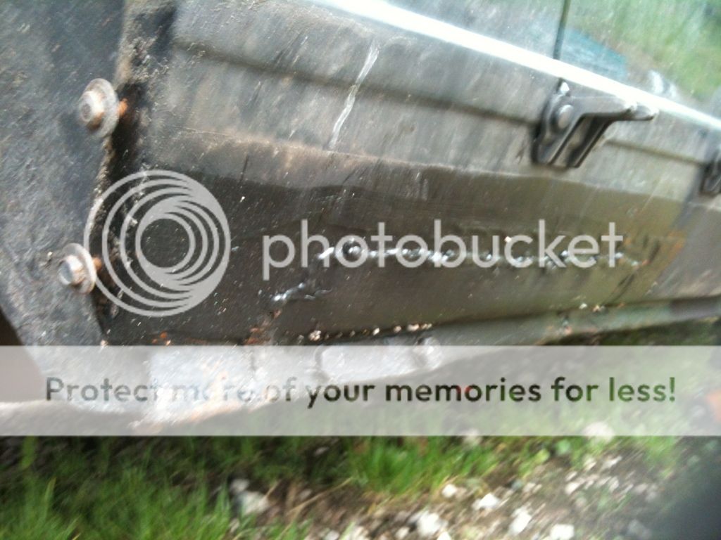

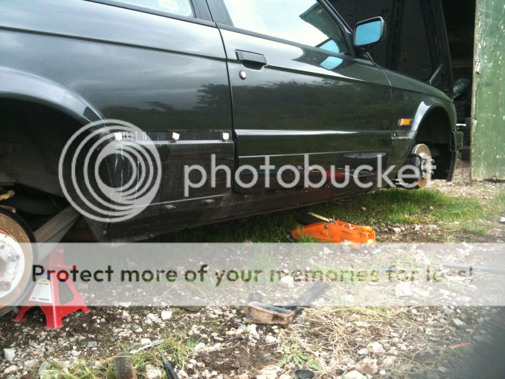

I then got side tracked and thought i'll get the side skirts off and have a nosey...
It isnt as bad as I thought :D Although I have a feeling the horrors are on the inner sill

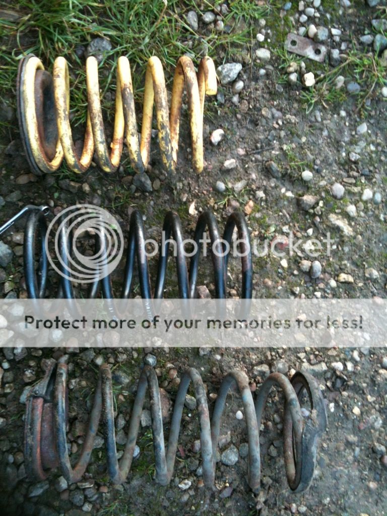

Springs that came off next to the Eibachs. Didnt look for any brands or markings but I will when I go out next

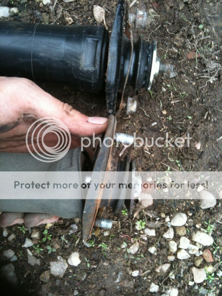

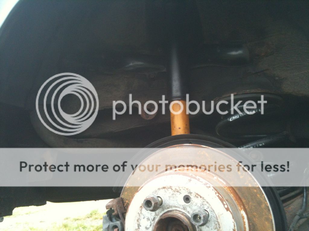

While I was there I thought I would switch the rear shocks for some Bilstein B6/8's (One or the other) which I was saving for the chromie but might aswell use them on this...

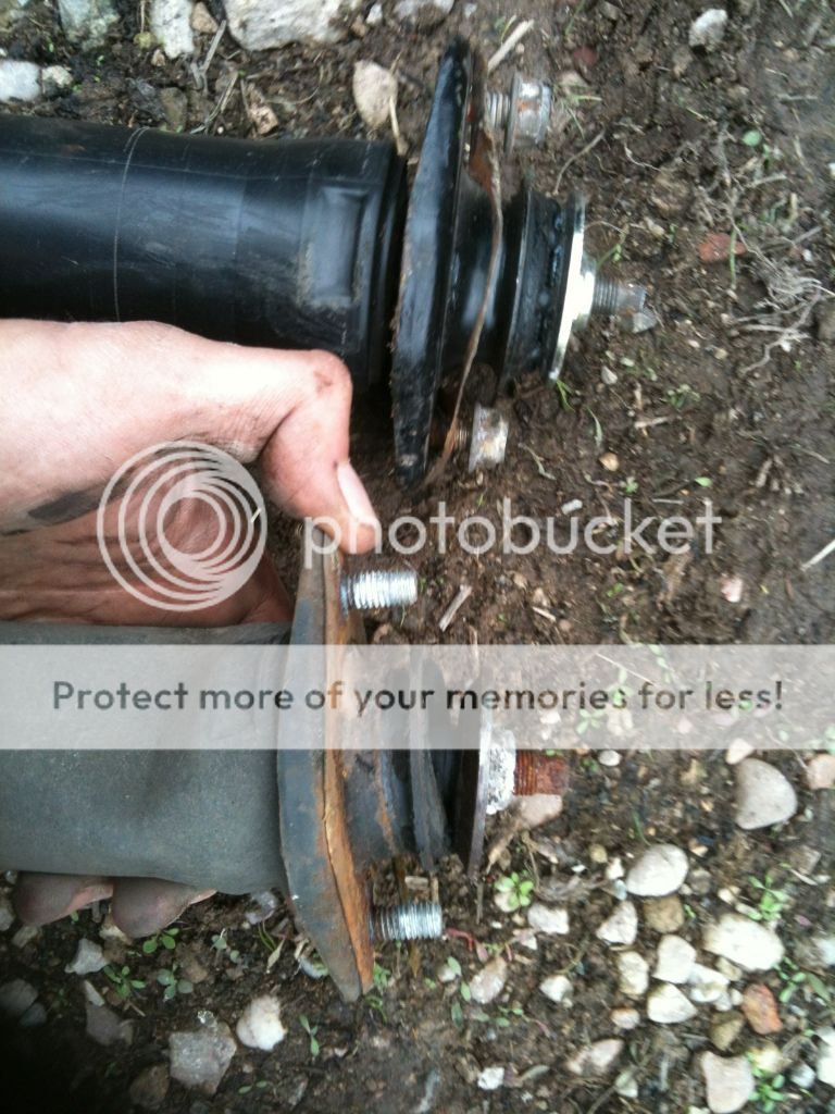

The top mount parts that were on there had some play 8O
Both in :cool:
The hook eye thing next to the shock has some rust on it and there are a few places in the arch where they usually have some scabs, but in all its not that bad! The arch lining is solid enough for me

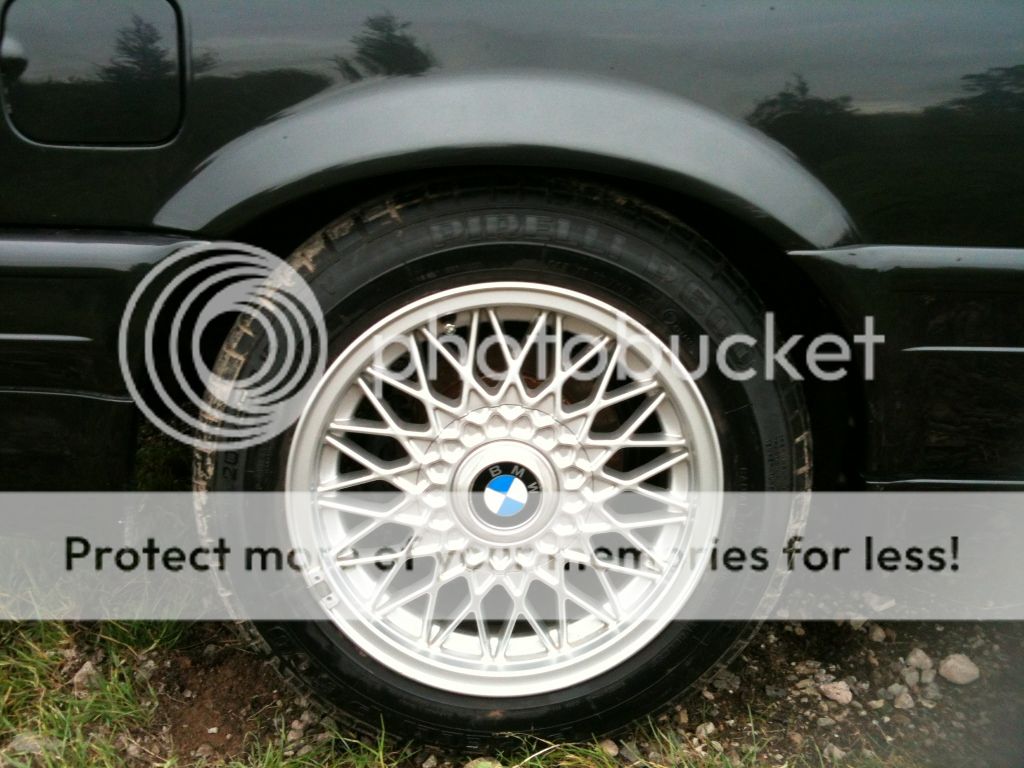

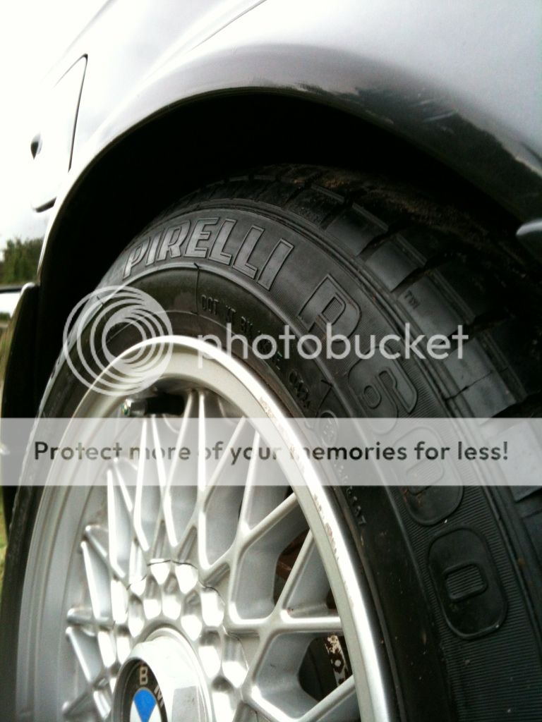

Wheel from the Chromie on her, tyre size is 205/55 where as the the ones that were on it were 195/50 I think :cry:
Ebay special dustcaps because i'm council :cool:

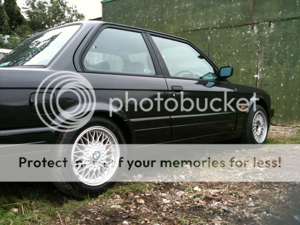

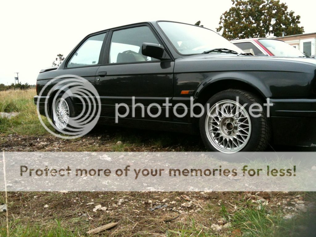

Anyway, put the wheel back on and dropped it and it sat like this :?:
Nothing had been changed on the front but im guessing it will settle and fall back on it arse again.
But even like this... It looks a little better than it was :cool:
The other side still on the dropped springs
From the rear :mad:
Camber... Innit...
Still think some bushes need changing but looks a bit better
In all, I think it will handle and look a million times better once the springs have all been switched.

Whilst I like low cars, that will look 100 times better with a sensible drop 8)
The front right will sit higher than before as the rear left is still stupidly low, when you raise the left rear, the front right will lower a little.

Can't believe you dared take the skirts off, I see it wasn't fitted with the proper clips though!
Good stuff getting the rear shock and spring swapped, looks better already, now just need the sell the scrap ones to Verde winkeye

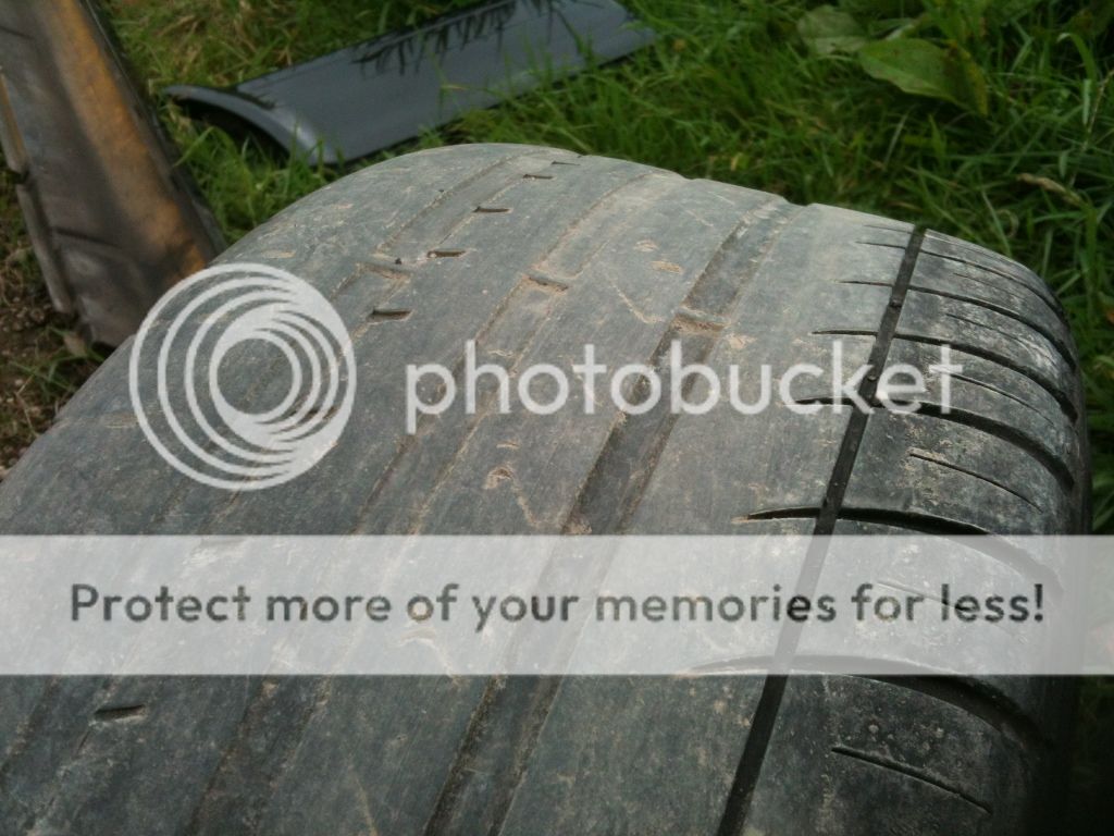

Wonder how long he'd been driving it around with tyres that bad, mind you looking at the 14s that came with it they'd have stayed one for some while yet.

Which clips do you mean Dave? The ones along the bottom and on the body were all the correct ones, then end bits were screws and 8mm bolts, wasnt sure if they were fine.
Front wing looks very solid too :D I was gonna have them off to check under but will do that when I have the front lights out and swapped as I couldnt be arsed to remove them earlier.

The end jibs Jim, should be those plastic pop rivets like on Matts, screws will just cause more rust and are another certain sign of bodyshop bodgery! Bet there's no protection on the bodywork under the kits likes Matts sport either.

The front struts that came off :o The shock itself looks to be a B6/8... But the thing is fully decompressed and doesnt move, not sure why, or what could be stopping it but it wouldnt budge. The springs, I have got a picture of them from my phone which is the only photo I got with that.
Yellow are what was on it, middle are the Eibachs, the end are standard E30 springs for size
They also didnt have any bump stops in and when fitted the springs fully compressed so it actually had no suspension up front :cry:

Yeah, the insert shock is fooked by the look of it, its fully decompressed and doesnt move freely like normal. Thats why I just used the front struts from the other car...

Poo... One might be alright but one definately didnt push back out :(
Jim320i
E30 Zone News / COTM Team
Posts: 10627
Wed Oct 03, 2012 11:17 pm
Need to get the other side off and see what that one is like as might only need to replace the one with the spare I have that does work?
Kedge
Posts: 7702
Wed Oct 03, 2012 11:30 pm
You should replace them as a pair, especially as they'll be different types. I'm sure the other side will be shagged out anyway, both sides had no give in the suspension!
Instagram - Kedge85
Wed Oct 03, 2012 11:34 pm
Don't throw them away!!!!
You can have them revalved Jim by Bilstien.
It's worth finding out a price.
