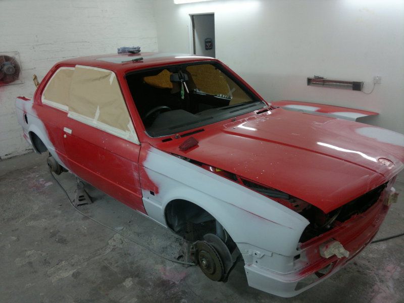

yep brilliantrot hopefully have my paint and laquer by the weekend so i can mix it up, i just put some coats of red oxide on them topped with a red

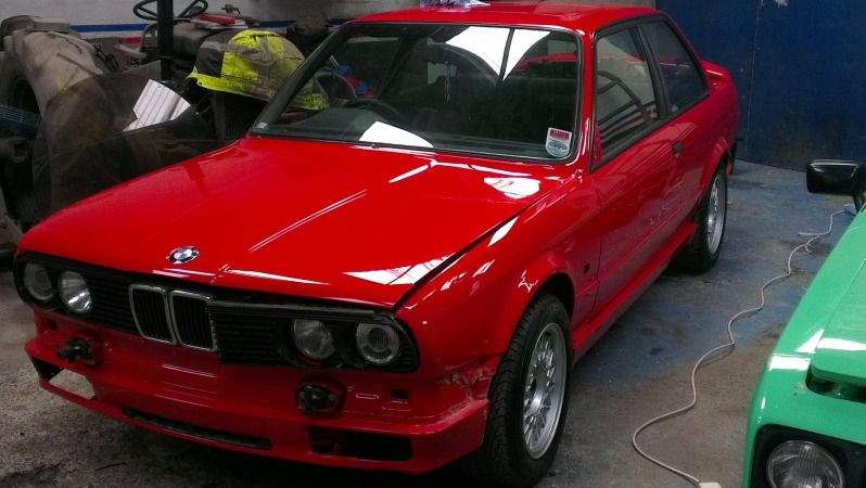

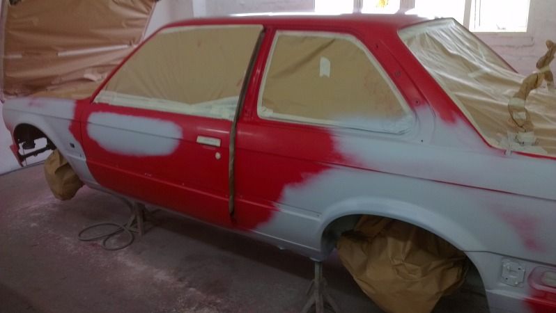

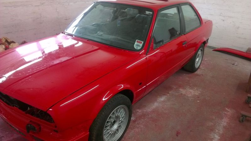

got the car under coated end of last week, so left it for a while and rubbed it down tonight, took out the windsceen and gutter trims, just a final flatten and mask over the whole thing, sort a few chips and finish it up for painting
hopefully next pics it will have lipstick

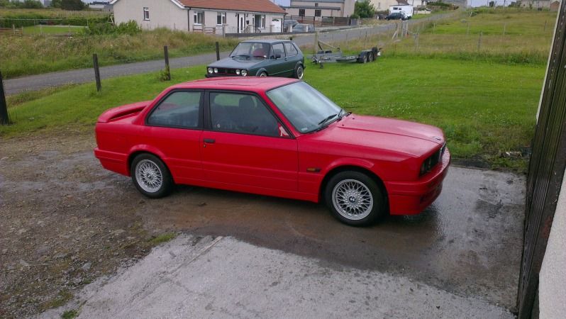

yep using a base coat so hopefully it will stay nice and red, if i keep it well polished.

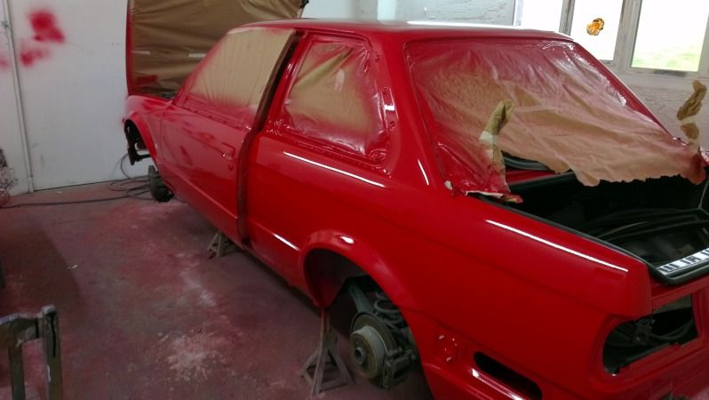

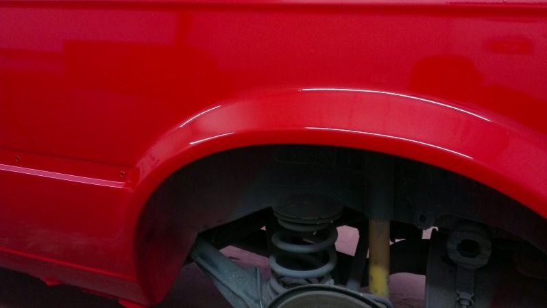

thats it painted just on the flatting down, then all the plastics can get prep'd

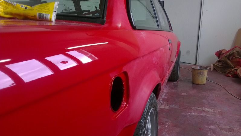

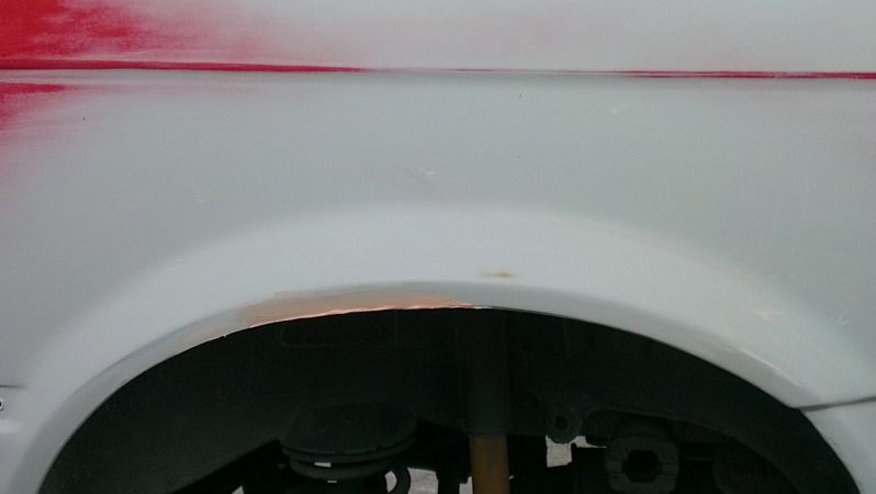

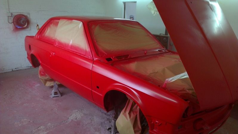

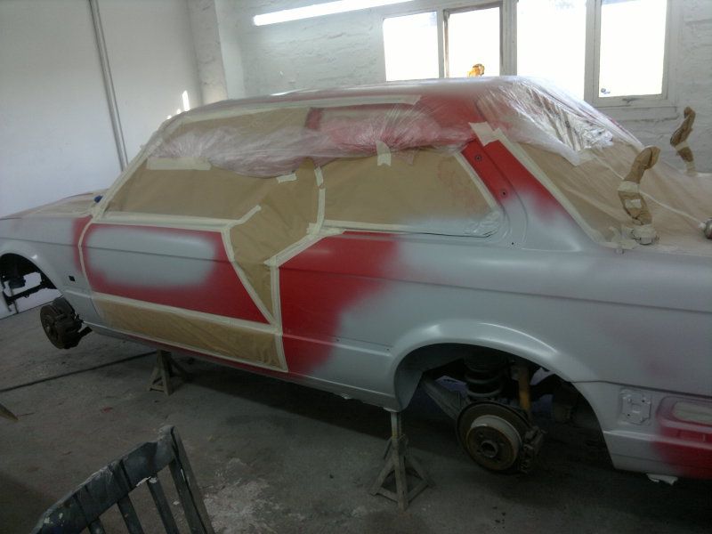

had a wee dink in my back arch- i dont think it was noticable but i knew it was there so repaired that
ready to go
base going on
and painted
back arch
glass placed in and now just working on the flatting down

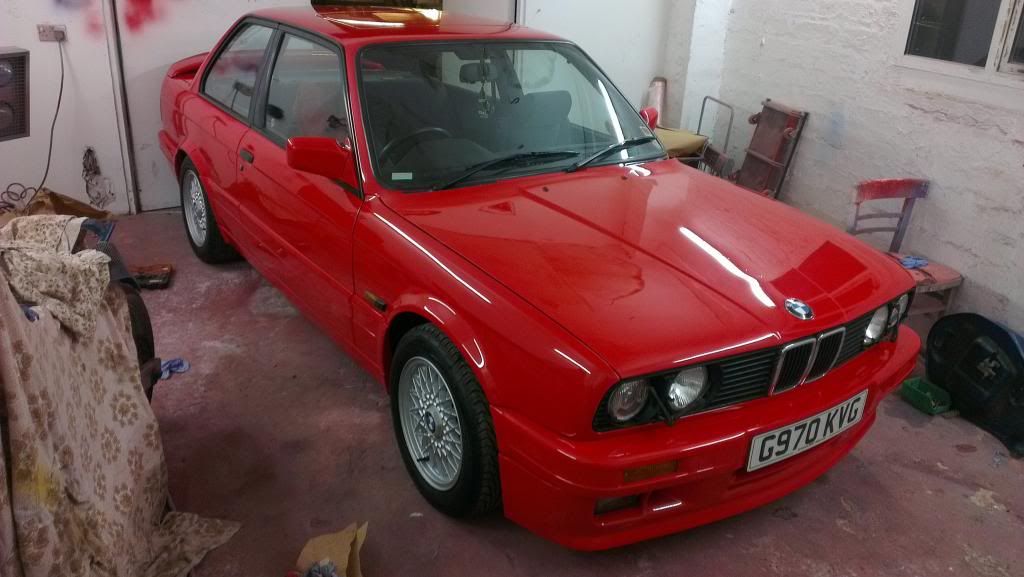

scottnomie
Posts: 47
Joined: Tue Mar 09, 2010 11:00 pm
Location: sunny stornoway

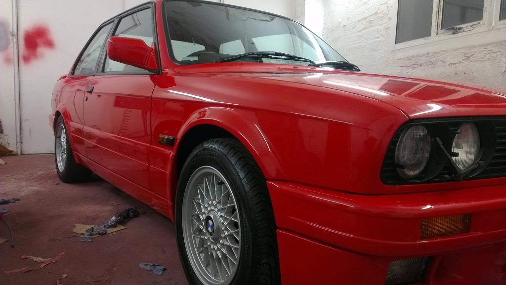

Tue Jul 10, 2012 7:36 pm

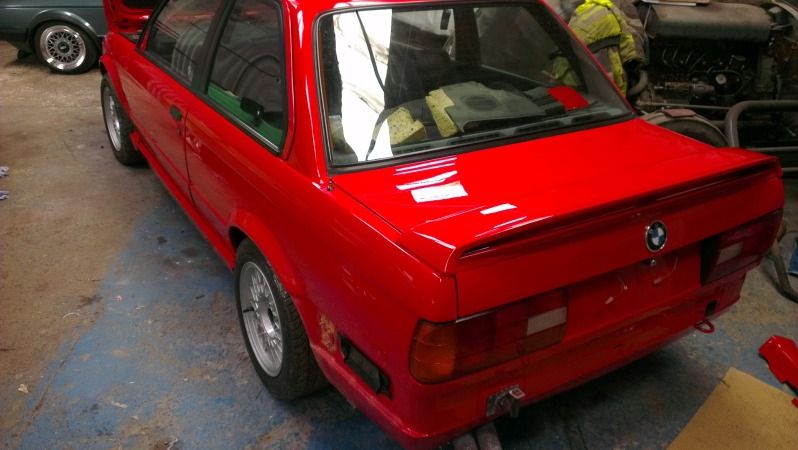

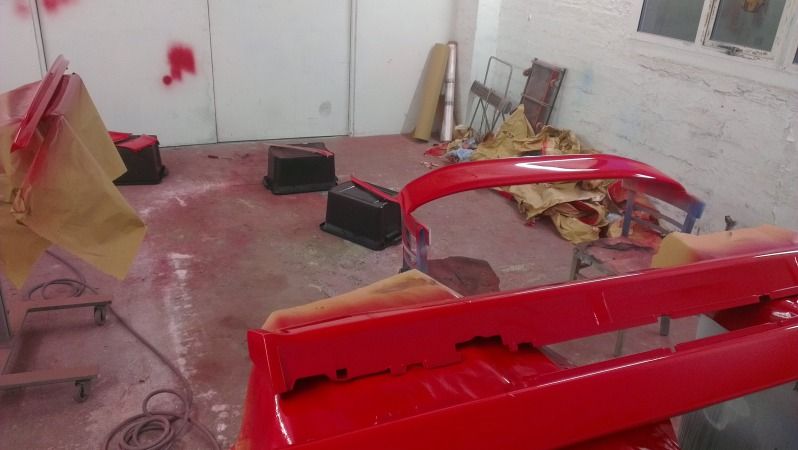

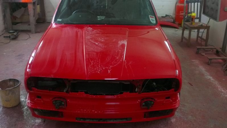

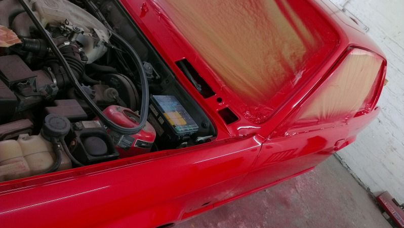

thought i'd put up pics of some more paintwork
started polishing the car up
prep'd up some plastics and painted them last night- since i dont have enough impliments to hang everything off to paint in one go
and so far we have

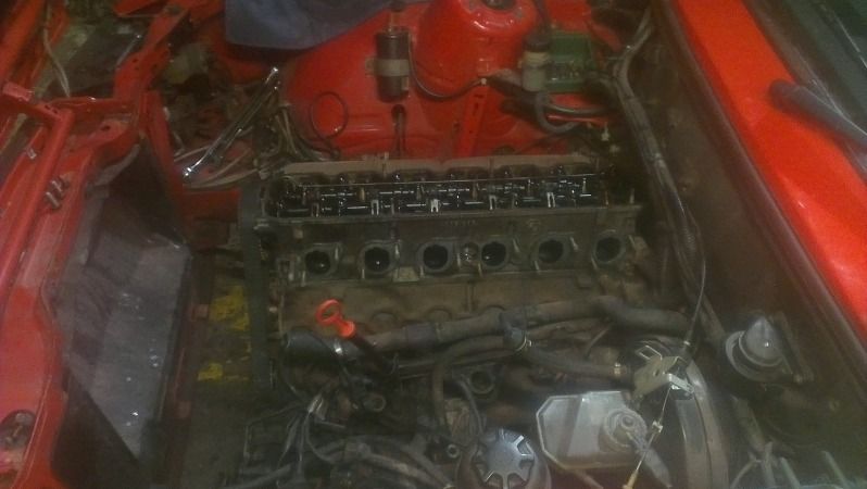

currently got engine stripped partially to do water pump, timing belt etc, flushed out top off cam cover and breathers, intet manifolds off to do gaskets and a good clean, so got a pile of service bits on there way and then onto the re-assembly.

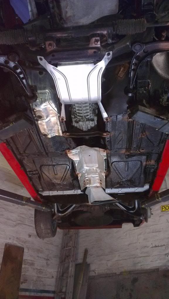

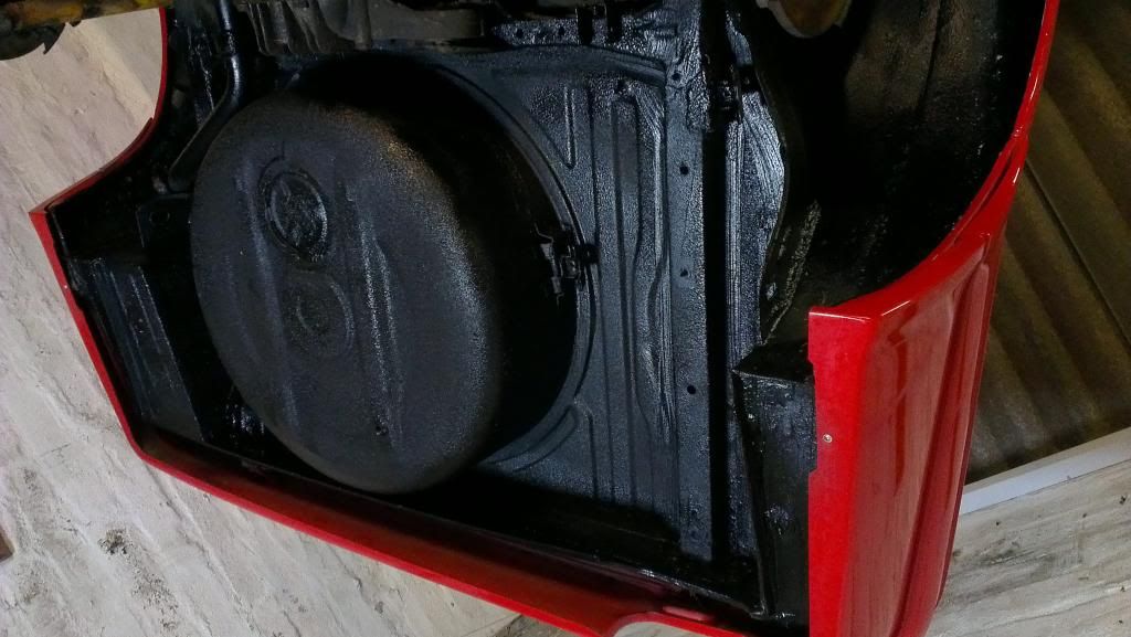

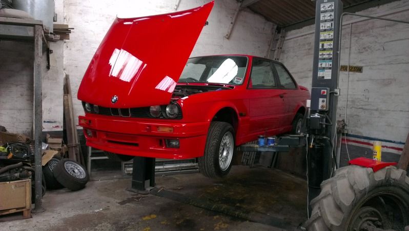

underside cleaned and coated with 3m sealer
new tank got a coating of the stuff aswell got a new pump in there anall
just need a few bits of bmw for the exhaust and rear heat sheild and then get it on. all brake lines done, new fuel lines, new goodridge flexi's, calipers cleaned and checked, new clutch fitted and box blasted.

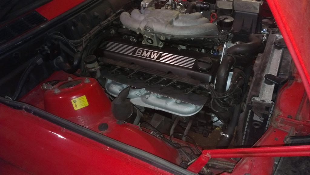

and engine all back together, after water pump, timing belt, inlet and exhaust manifold gaskets
hopefully with all my preventitive work it'll be nice and trouble free!! :mad:

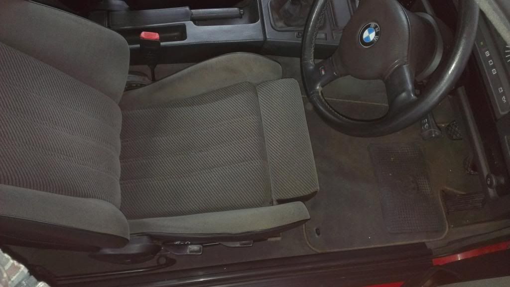

got better seat fabric, so re-did that one day i was bored
