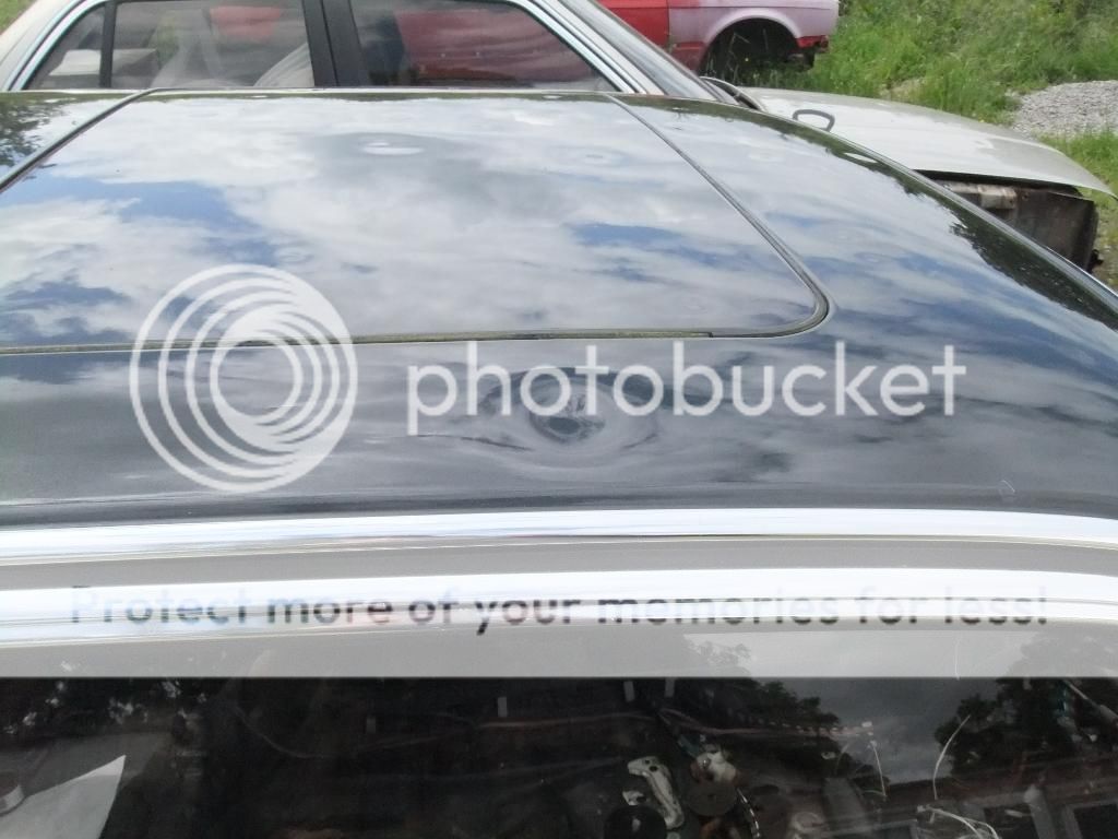

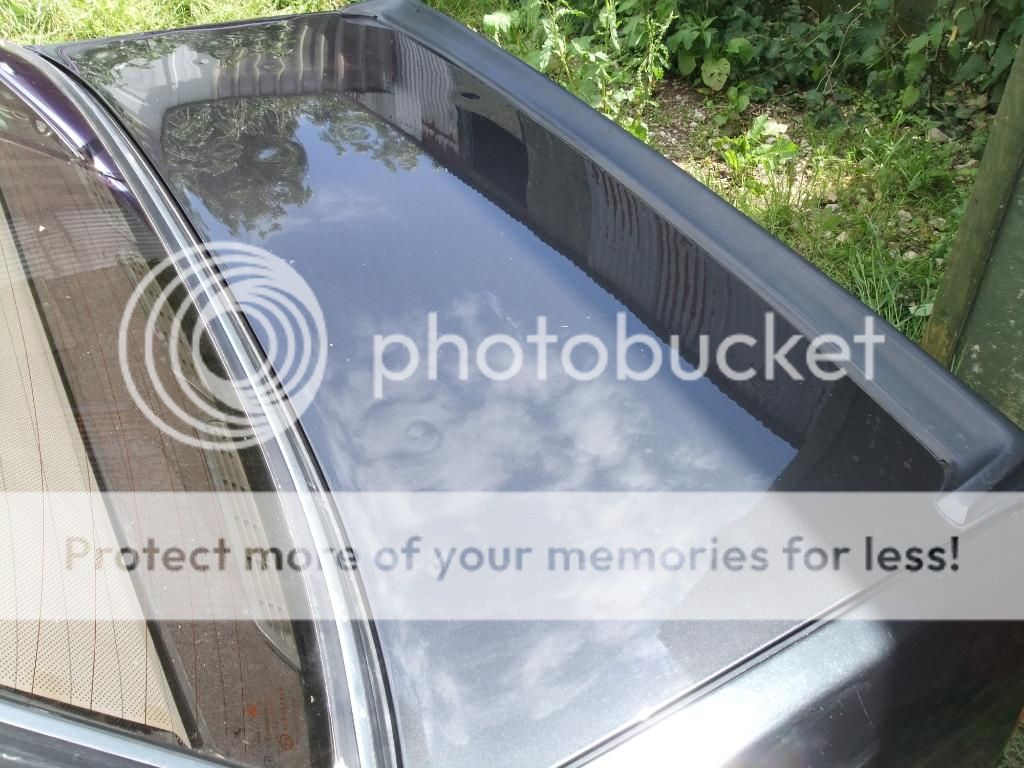

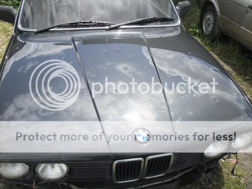

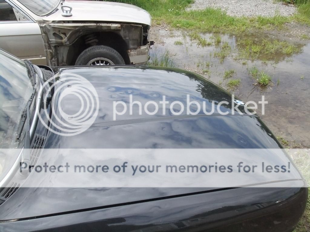

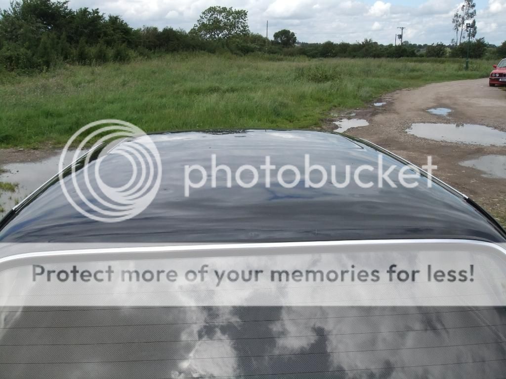

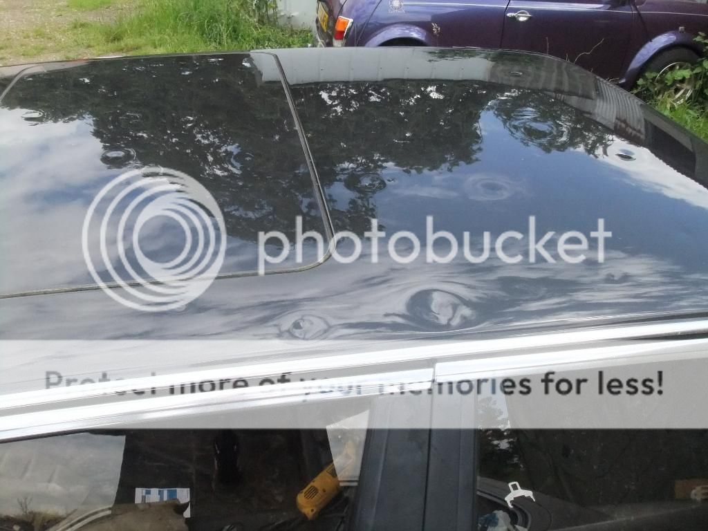

Few more pictures from the other day after I gave it a quick squirt with shinny spray to take the dirt of it so that I could see the damage a bit more... Usually I would wash it down before just spraying it covered in dirt and wiping it off, but seemed pretty pointless

Gutted for you mate :( I would not even bother to try and fill the dents in the roof yourself. Swap what ever panels you can and get a dent man on the roof first and what ever he cant sort get a bodyshop to finish. A roof is a nightmare to get right and a black one is even worse.

Panels, I'll wait for a breaker to come in next with some decent panels as obviously, all mine got damaged at the same time so no panels without dents unfortunately.

Trust me and the others Jim, you need a dent man on that roof. Pugging it up will end badly, never mind the fact that the materials will cost more than the dent man, let alone the time.

It is not the time involved but the skill!! I worked at a bodyshop about 8 years ago when we had a similar hailstorm here. Most cars had new roof skins and the ones that did not where all repaired by the same panel beater because no one else wanted to touch them.
Number plates where used to apply filler and a meter long block to knock it down :eek: It will look and feel fine until a shiny coat of black goes on then it will look a total arse :(

I may give a dent man a ring then and see what they say, how do they actually remove them? Just a puller? Rick bought a puller thing but it didnt work on his, didnt even bother on mine.

That roof needs a dent man on it 1st, as has been mentioned. You need to get it as smooth and dent free as possible so you can have the smallest amount of filler as possible, otherwise it's a bastard of a job to do, and after time deep filler can often shrink back and start to show dents again.

They use all kinds of levers and pullers combined with shit loads of skills and experience.
