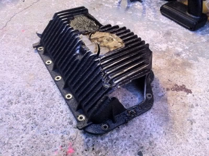

first problem! doh! (picture of nackered sump!)
dubownerbilco
Posts: 192
Joined: Fri Dec 17, 2010 11:00 pm
Tue Oct 11, 2011 9:40 pm

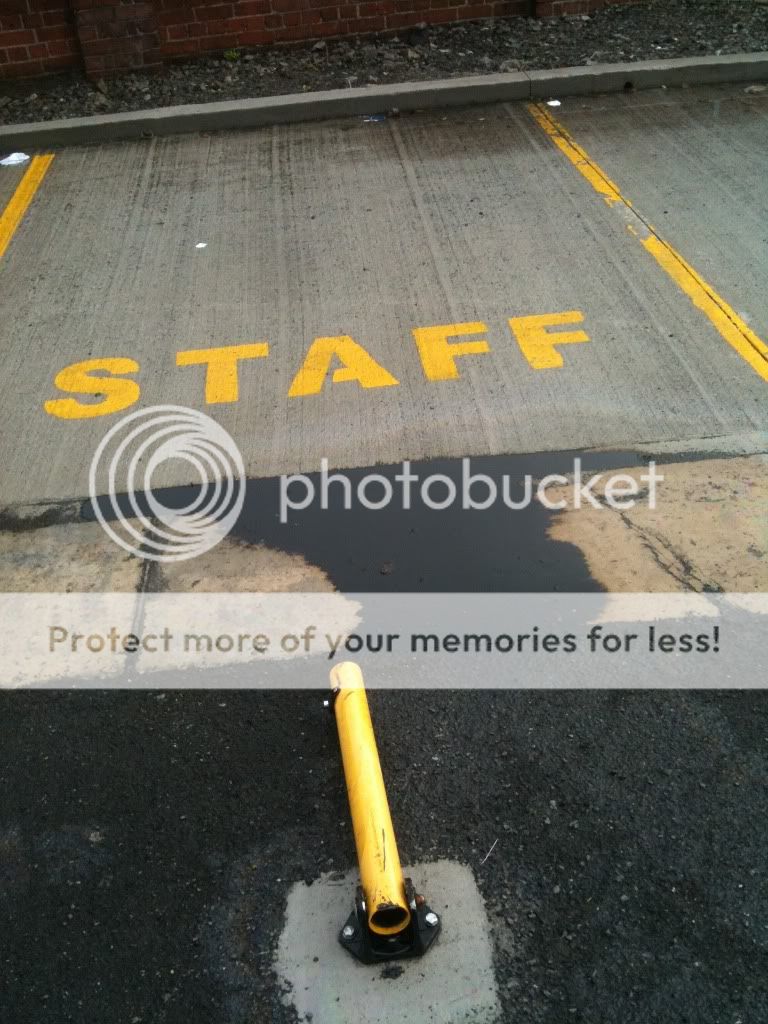

the offending article:
the reason why!

My cars lower than 60mm, with small tyres... Havnt had a issue in a year now, stanched ftw

This shit happens man, I don't run a sumpguard because theres no room for one. Just gotta be super careful and observant. Plus every sump you smash gives you 10 scene points :D

lift the engine... mine was lower than this.. use thick washers to lift the engine. i had some under both the mounting arm and the rubber mount. must of gained 15mm.
doing this made the cross member the first thing that hit rather than the sump... i have a m10 sump with 10mm ally plate welded on the bottom if you want it for a small fee....
