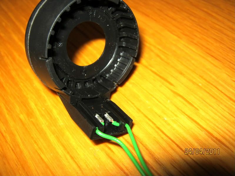

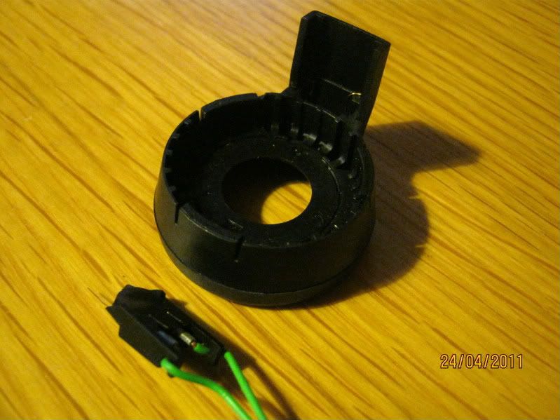

Well EWS all in...I say all in but really I mean most is in but ive managed to break the fooking antenna ring somehow :cry:
Do you think it might still transmit a signal or is it doomed?
It has a strand of wire poking out of the left side but non visible on the righthand side.
I have got another antenna ring from an M50 EWS kit but not a simple as plugging that in is it?

Not sure if the EWS ring from an M50 will work but another one from a similar age car will work. They are not unique to the set up like the EWS module, ley and DME.

Surely its only a fancy coil of wire? Im sure the m50 one would work. If it doesn't - borrow mine?

Ill try the M50 one in it.
