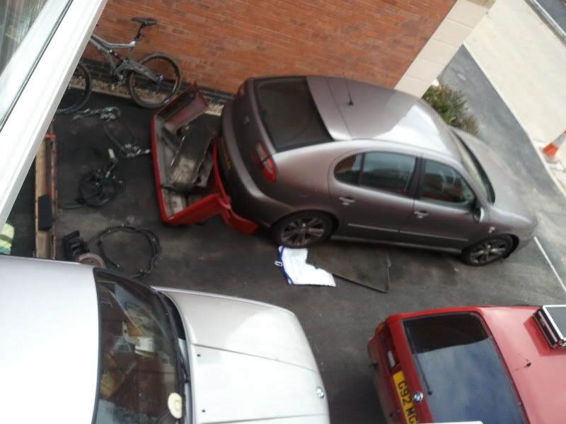

Well since Lee has been on a thread revival mission tonight i thought i'd have a flick through mine and dig it out.
Not touched the car since April/May time last year other than to move to my new home and shut it in the garage. Now i've got a few things out the way i reckon it'd about time to finish the loom swap and get a move on, had it out the garage the other day sorting through all my frag to see whats worth keeping and what wanted chucking and it's brought a little motivation back.
Had to take a quick pic of my driveway hogging action, really don't want anyone to move in next door :shoot2:
