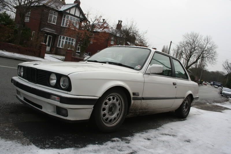

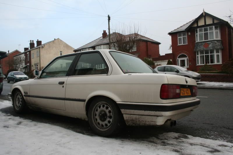

I set the BM up for the snow on Monday.
It turned up yesterday but by the time it came to going skidding in it.. it was all ice but its snowing (ish) now so fingers crossed for tonight

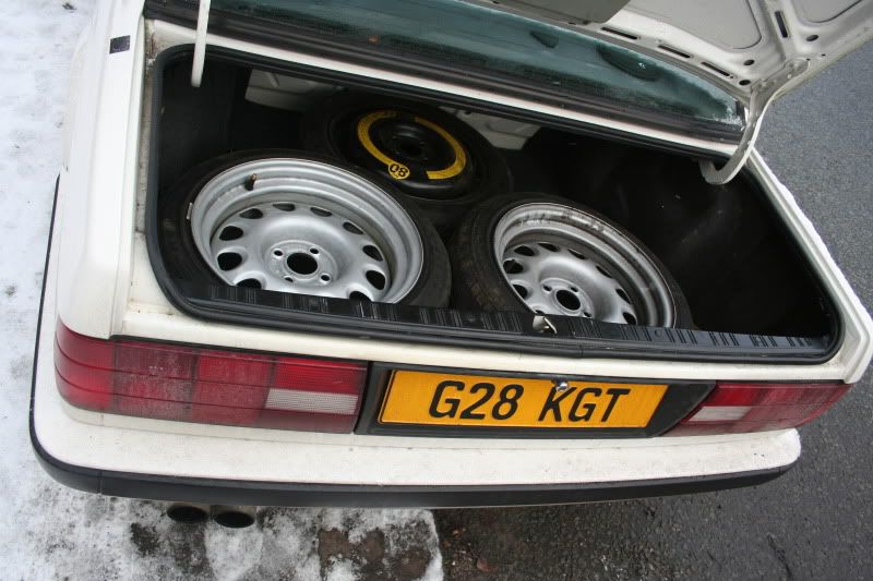

I fitted some non banded G60 steels (what a difference 2"s makes eh!! ) with nice balloon tyres.. Its not been washed for a month so looking rather slagish..
3x weighty banded steels and a spacesaver to aid traction lol

Looks cool mate nice and low, did you cut the front springs on standard shocks :mad: ? Is that a dubmeister metal legal no. plate? Debating getting a set ready for show season :cool:

Cheers Kemix.. Its on G-max shocks all round but they are past their best and haven't handled the chop to well lol.. whats yours lowered on?
The plates came on the car... but im guessing they are uk font pressed plates from dubmeister.. These ones are not legal as they have no stamps or postcode etc
No problems with rubbing on the 8's... only when i fitted my 5mm spacers

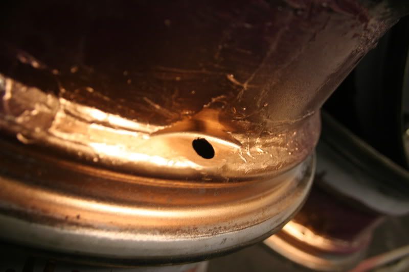

I removed the banded steels because they were leaking air.. After taking them to my mate at ATS to be inspected it turned out it was the valves that were leaking and lucky for me not the bands.. After stripping the tyres off it was clear to see that the welds were not allowing the valves to sit flush and get a full seal, so they leaked air when the valve was moved..
This was simple enough to cure with a little grinding.. Im also going to seal the valves in with silicone before I have the tyres refitted just to be on the safe side.. I can't wait to get them back on, it looks so s**te and skinny on the 6J steels.

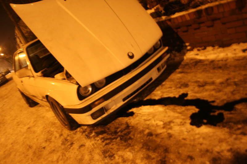

Trimmed lowering springs + dodgy English roads + 2.5" sump clearance = Merry Christmas Winston
Fingers crossed i can work my magic with some Quicksteel, it was due an oil change anyway lol.. I will have a closer look on monday

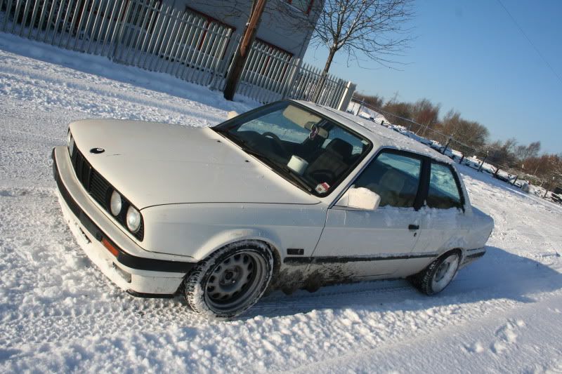

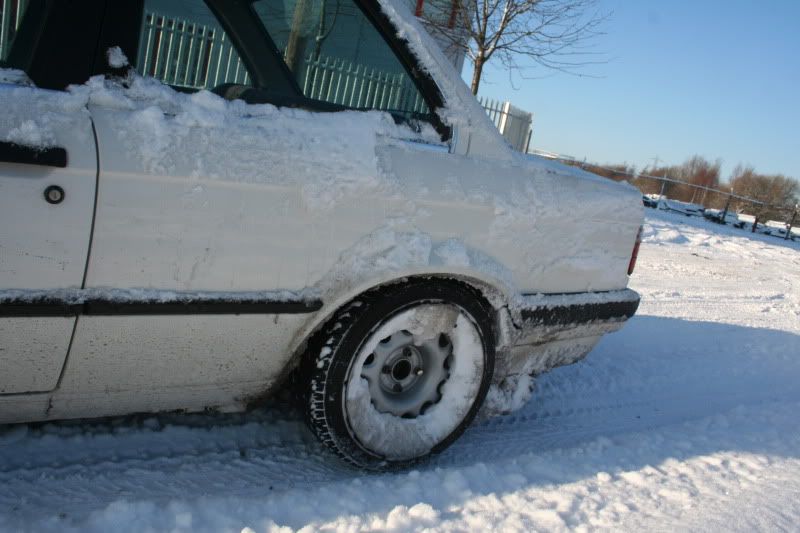

A couple snow pictures to lightern the mood :cool:

That's the only problem slamming a e30, hope it a easy fix :?

i think a sump gaurd might be needed

lift the engine up... both mine smashed sumps, raised the engine up on spacers on the engine mounts and not had any issues since!
